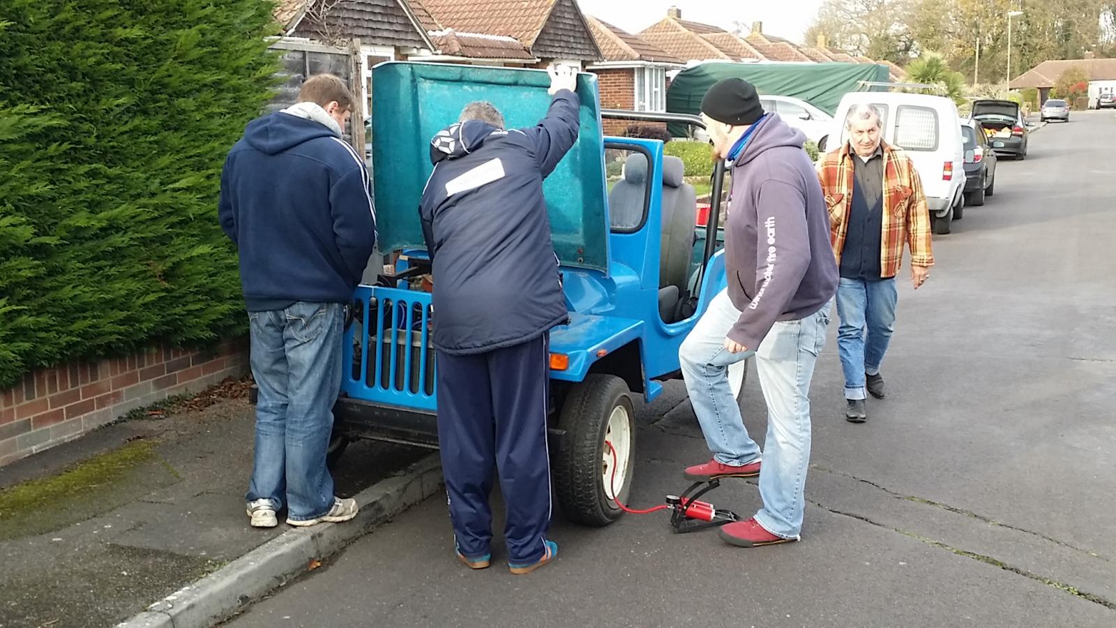

Action shots from the Geep collection !
The collection part of it was so uneventful 2 tyres being pumped was as good as it got . We should of at least pushed it to the nearest fuel station for a pretend first juicing but I think 800 metres was as far as we could of managed .

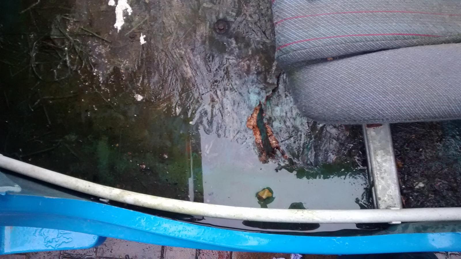

As I've got lots of enthusiasm for this currently I went out in the pissing rain and wind earlier this morning to extract the seats and move them somewhere dry. As you can see, there was quite a bit of rain last night, but at least all the holes let the worst of it drain out

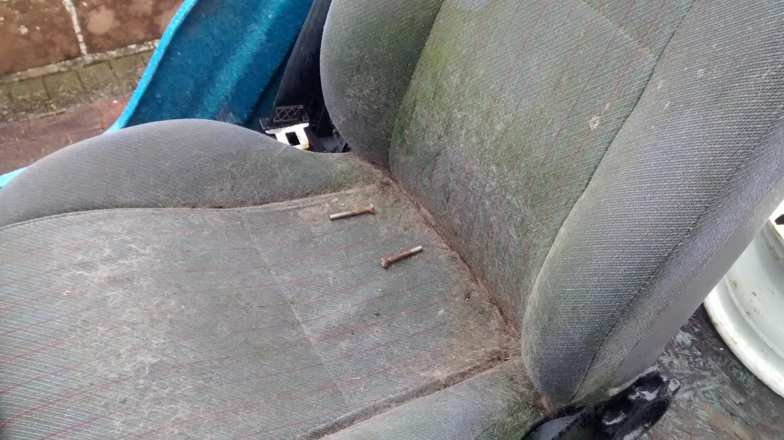

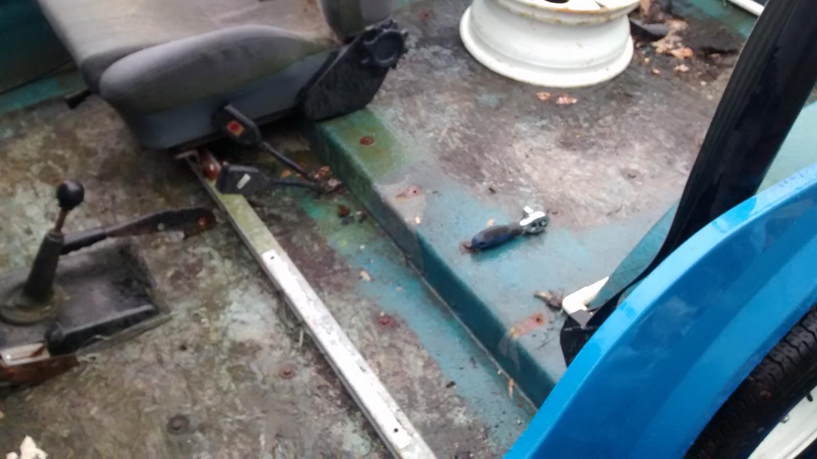

The brackets and runners are held in with really long threaded 7/16ths bolts through the floor into the chassis. The holes are threaded so no corroded bolts to worry about - in fact it all came out with almost no fuss at all.
This is after removing the passenger seat and part-way through removing the drivers one. The bolts undid with no problems, I packed the bolts into a tin, labelled it and put it with the seats. I moved them into the garage which is mostly dry, at least more dry than out the front of my house.
Now, it looks like a local cat may have discovered the Geep on the previous owner's drive, as both seats are COVERED in ginger fur. It might have been a fox, or some other nightmarish beast but they are distinctly fluffy
Wearing gloves, I scraped as much of this off as I could - I'll have another go as they dry out a bit then hit them with a wet n dry vacuum. Beko, you know I gave you that Renner sump key? Want to return the favour? :mrgreen:
Apart from being wet, fluff-encrusted and slightly mossy, the seats are alright in a chunky kind of way. We'll see how they tidy up - I need a warm, dry, windy day or six and there is no chance of that this side of April.

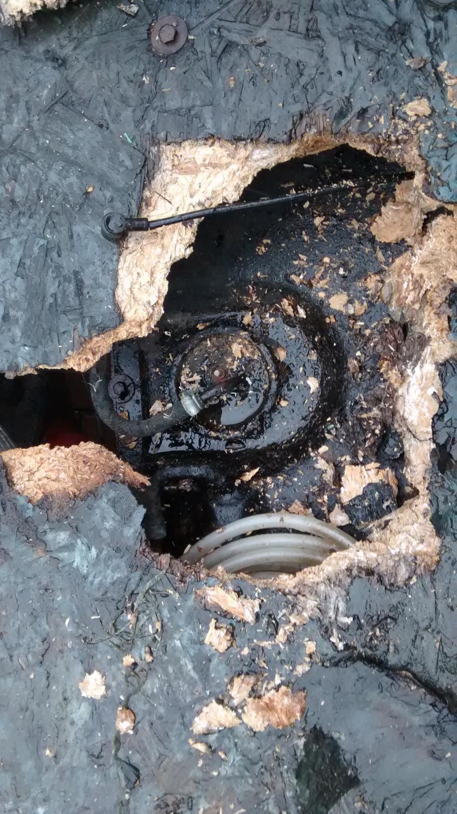

With both seats out, I stuffed a plastic bag in the fuel filler neck to prevent any more water getting in and had a look through the rear floor at the fuel sender to see if I could get it undone and see what the tank contained.
More cars should have flipping massive holes in the boot floor for this sort of thing.
Anyway how is this meant to undo? I tried rotating it anticlockwise and there was no movement, then clockwise with the same result. Then I tried to see if it just popped up like a paint tin lid, also no good. I didn't want to b0rk it totally so left it alone. Any suggestions?

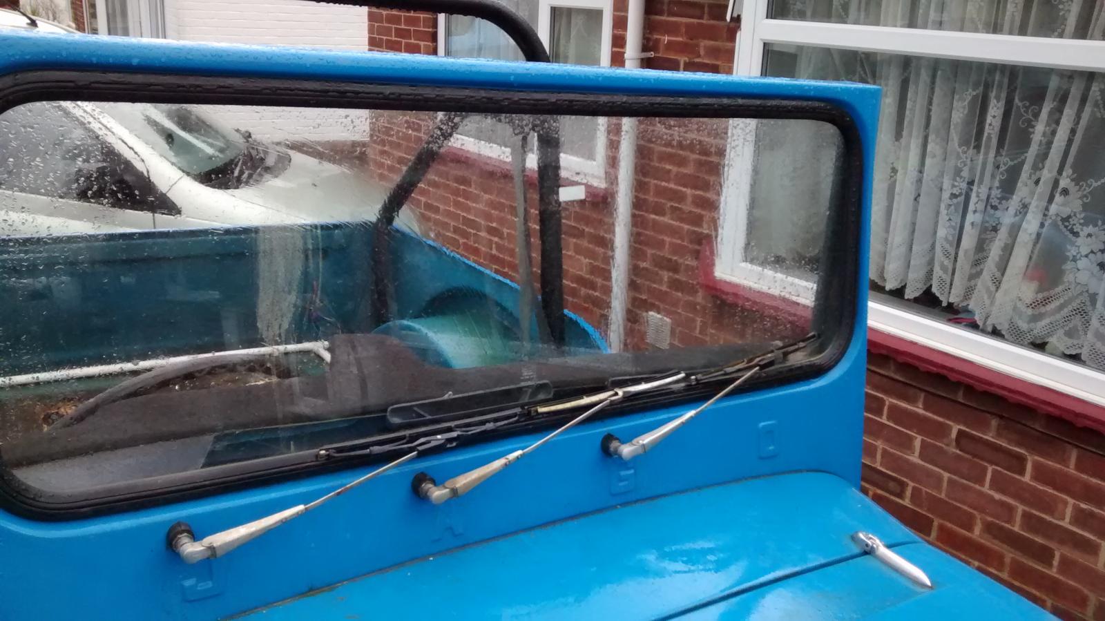

Finally, I dug out the TRIPLE WIPERS M8 from their box and fitted them to the arms. Check this out
to be honest the spring in the right-most one snapped so it hardly applies any pressure to the screen but the other two are fine. I just love having three wipers!

Or a lump hammer and a chunk of metal . Strike anti clockwise on the inner ring if I remembers right
Those seats, which are almost certainly out of a later mk2 XR2, are probably worth a handsome amount even in that condition. Amazing considering how many of the bastards were around at one point and you couldn't give em away.
Ah, thanks - yes there are 4 cutouts at 90 degrees to each over - so it does unscrew but needs some effort to do so?
Has anyone local-ish got the right tool, or I'll revert to percussive maintenance with a bit of wooden dowel.

My Capri tank has the same fitting, it's unbelievably tight to undo. I just use a hammer and a blunt metal punch to tap it around to undo it.

Assuming you can get the level sender/pump wiring out the way, you can use 2 crossed screwdrivers to lever the fuel fitting out

If I remember rightly the terminals or fuel pipes come out of the middle of the sender unit and the crossed screwdriver trick might break something if it slips . I used to use a socket extension bar and lump hammer , a couple of good whacks o each of the lugs should do it . They don't have to move far .
Tap the petrol gauge ring with a screwdriver anti clockwise, Am sure there are 3 lugs, do each in turn.
It's not an actual screw thread, there are sort of tapers that lock it up.
