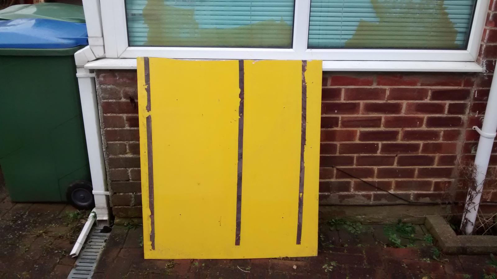

Bit of a win on local freecycle tonight, 2 sheets of 8' x 4' Aluminium di-bond sheet which is sort of two sheets of thin ally with a 'core' in between. The stuff they made a big fuss about in Grenfell tower? Yeah, that basically.
Its about 4mm thick and will become the new floor of the Geep, laid on top of the existing plywood. It used to be part of a 8' high sign for a local carpet warehouse, they re-branded and were getting rid, as they couldn't take it to either the tip, or the local metal merchant. It should be ideal for the floor as its light, strong and easy to cut to shape.

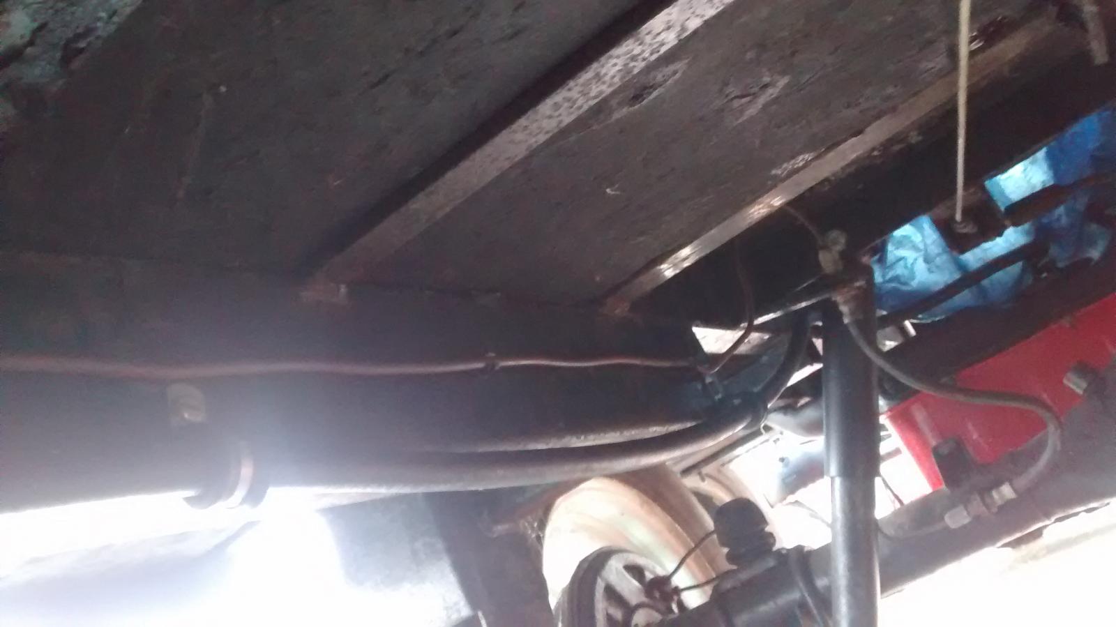

that 'tube' is indeed a solid bar.  the action of the cable actuating the lever on one side, also pushes the rod, which actuates the other side.  i think you already have this figured. t he bush, whilst desirable, shouldnt have too much bearing on the operation of the rod.  that rod will, however, get right in the way when you want to top up the diff oil lol
however, what you may not know is that those arms in the drums are ratcheted.  when you take the drum off, you need to reset them before you put it back together.  you can do this with a flat head screwdriver.  i'll see if i can find a how to.
Lee
Thanks! Yes thats exactly the setup I have (pic #1) - mine looks to be the opposite way around though, the cable from the handbrake lever goes to the right hand (drivers) side as you look at it from the back (whereas it goes to the passenger side in this photo) and then there should be some kind of actuator that mirrors the movement onto the other drum (that disappears off the right hand side of this photo).
this is the bit I can't figure out yet. I'm sure it'll become clear when I'm watching exactly what happens with it when someone operates the handbrake. It might be that the clamp thing (just to the right of the spring in the photo) has come off, or is corroded.

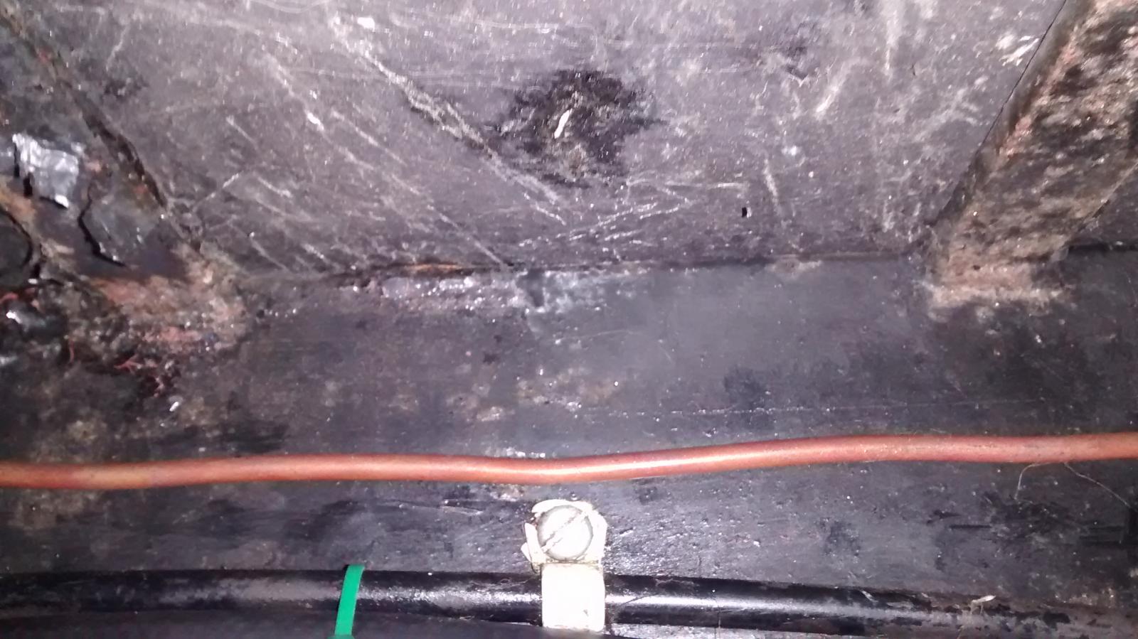

Following the work on the Saab, I set to with a few jobs on the Geep. First up was to remove the old fuel line entirely and attach the new line with decent p-clips. Up to this point the new line was held on with cable ties to the old one.
The plastic ties were screwed to the chassis rails, so it was relatively easy to undo these one at a time, cut the cable ties and then put the p-clips around the new fuel hose and use the old screw to do them back up again. There are 5 in all, and they did eventually come off!
its a fiddly job, but I got there in the end. Old fuel line removed entirely and saved in case I need it for something else, or lawnmowers.

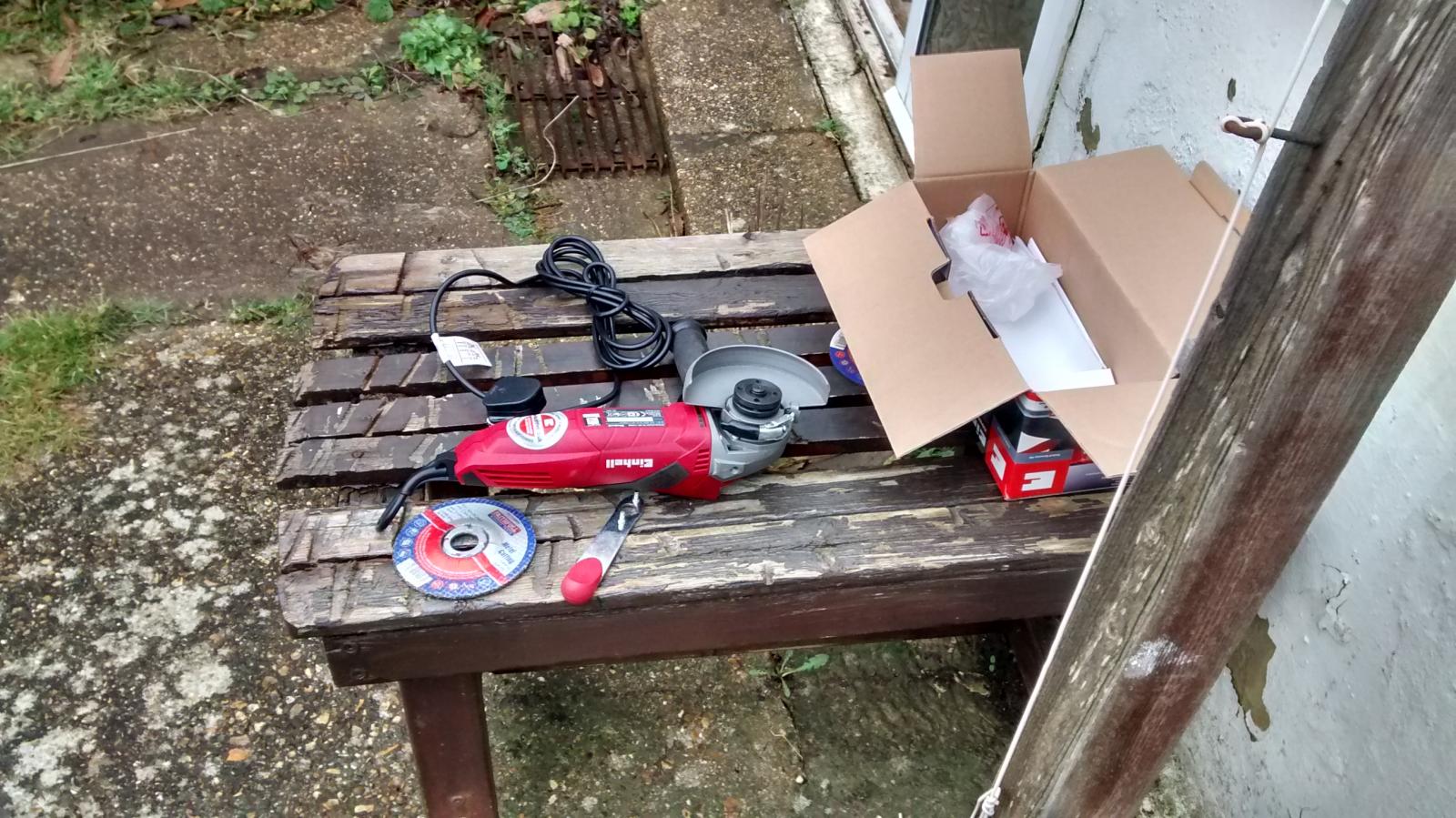

Next up was using my christmas present to cut the dibond sheet to make a new boot floor

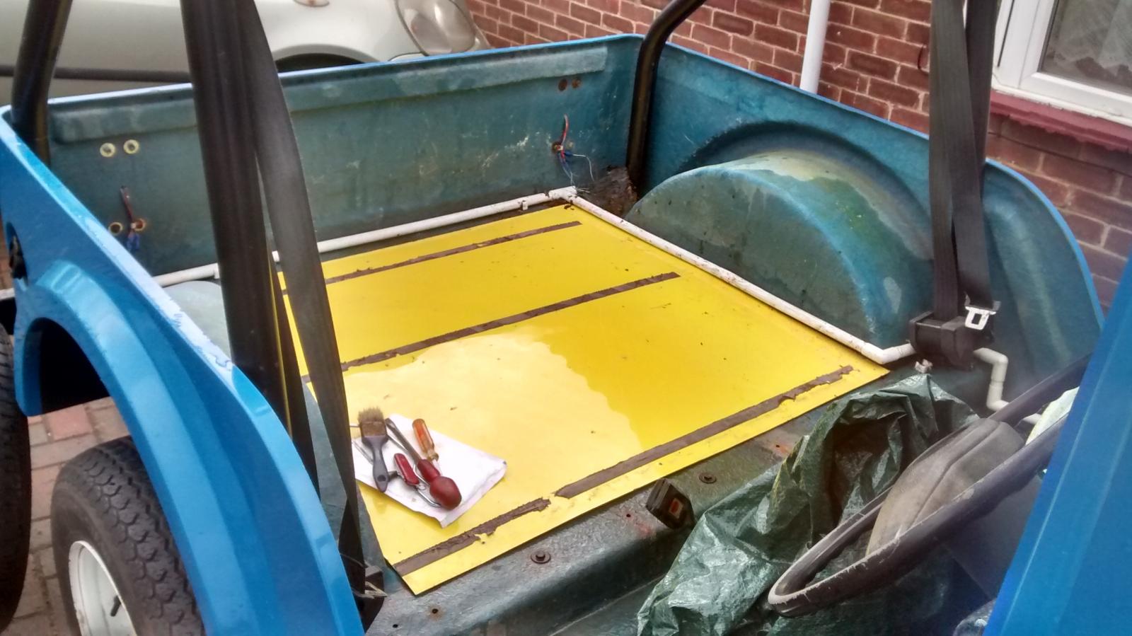

I'd not used one of these before, I think the cutting disc was a bit too fat but I managed it in the end, making a section 41" long and 36" wide to go in the back of the Geep
I filed the edges down as it will need to come out again eventually I'm sure and I don't want to slice my fingers off doing so!
It needed a bit of fine-tuning with my tin snips to fit, but its in and working now. A seamless repair, I think you'll agree?
Its got a few holes already drilled in it, and I've not bonded it in yet, though i will eventually. For now the giant hole in the plywood is a useful access hatch for the fuel tank and handbrake mechanism so this will just sit on top of that. I'll also need to make up two sections for the front footwells but this will take a little bit longer, and I might invest in some thinner cutting discs for the disc cutter. Since all my fingers are still attached I count that as a successful first attempt.
That stuff looks just the job for this. Much better and longer lasting than wood anyway!
How you going to attach it? Adhesive or you going to 'glass' it in like the old wood was.
I'll bond it in with sikaflex or something around the edges where the glassfibre pokes out I think, though if anyone has any better ideas I'm all ears!

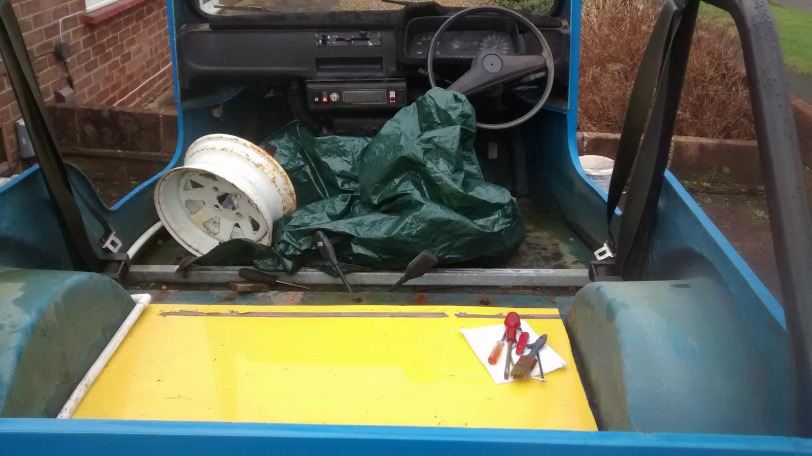

As it still wasn't raining I snipped the leftover bit of dibond to shape to make a cover for the front drivers footwell which was easy enough. I did manage to nip my beer gut in the tinsnips which smarts a bit but this couldn't take the shine off the day.
