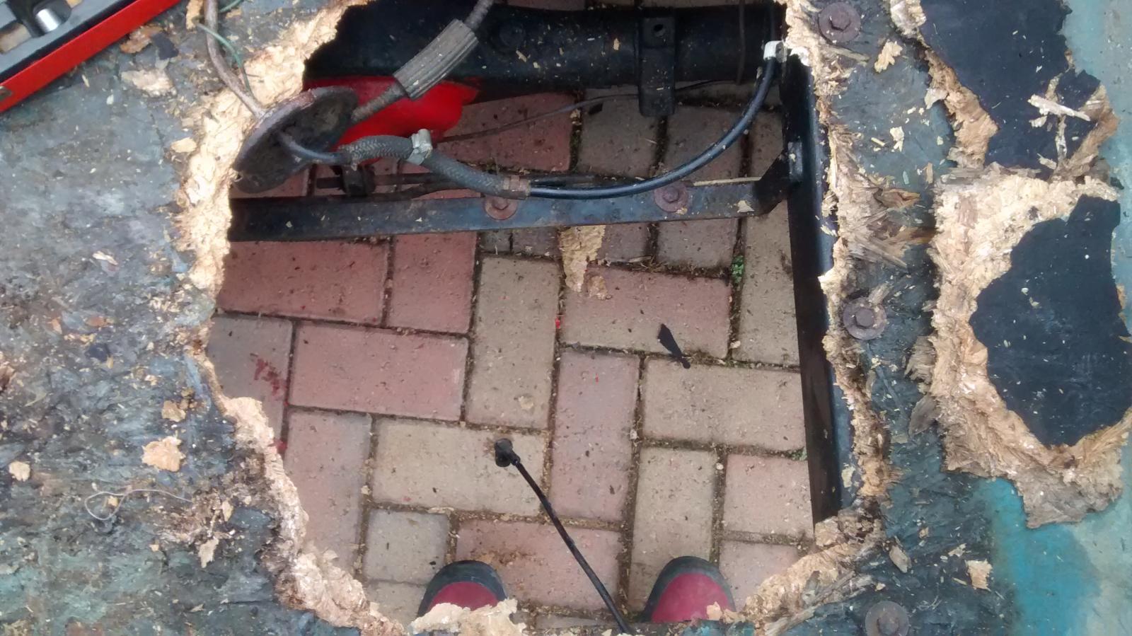

Through the hole in the boot floor I could see what I was up against

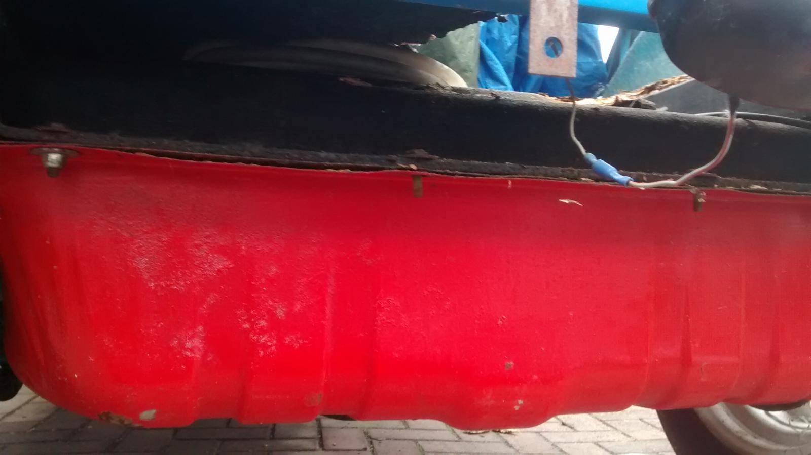

There are two 'rails' that go horizontally across the boot floor, each drilled with 4 holes. The tank has 8 holes drilled in the lip where the top and bottom bit join (easier to see in later pics) and a bolt goes through the rail, through the tank lip and a nut does up on the other side. I broke out the socket set, and slid underneath. This is one of my favourite things about the Geep - its nice and high up so even a portly chap like me can slide underneath and work easily.
This is the trailing edge of the tank, you can just about see the 4 bolts. The nuts undid very easily and I lowered the tank out enough to undo the jubilee clip on the filler neck and untwisted the fuel pickup/gauge and eased that out then slid the tank out from underneath.
This left me with a hole
And a fuel tank

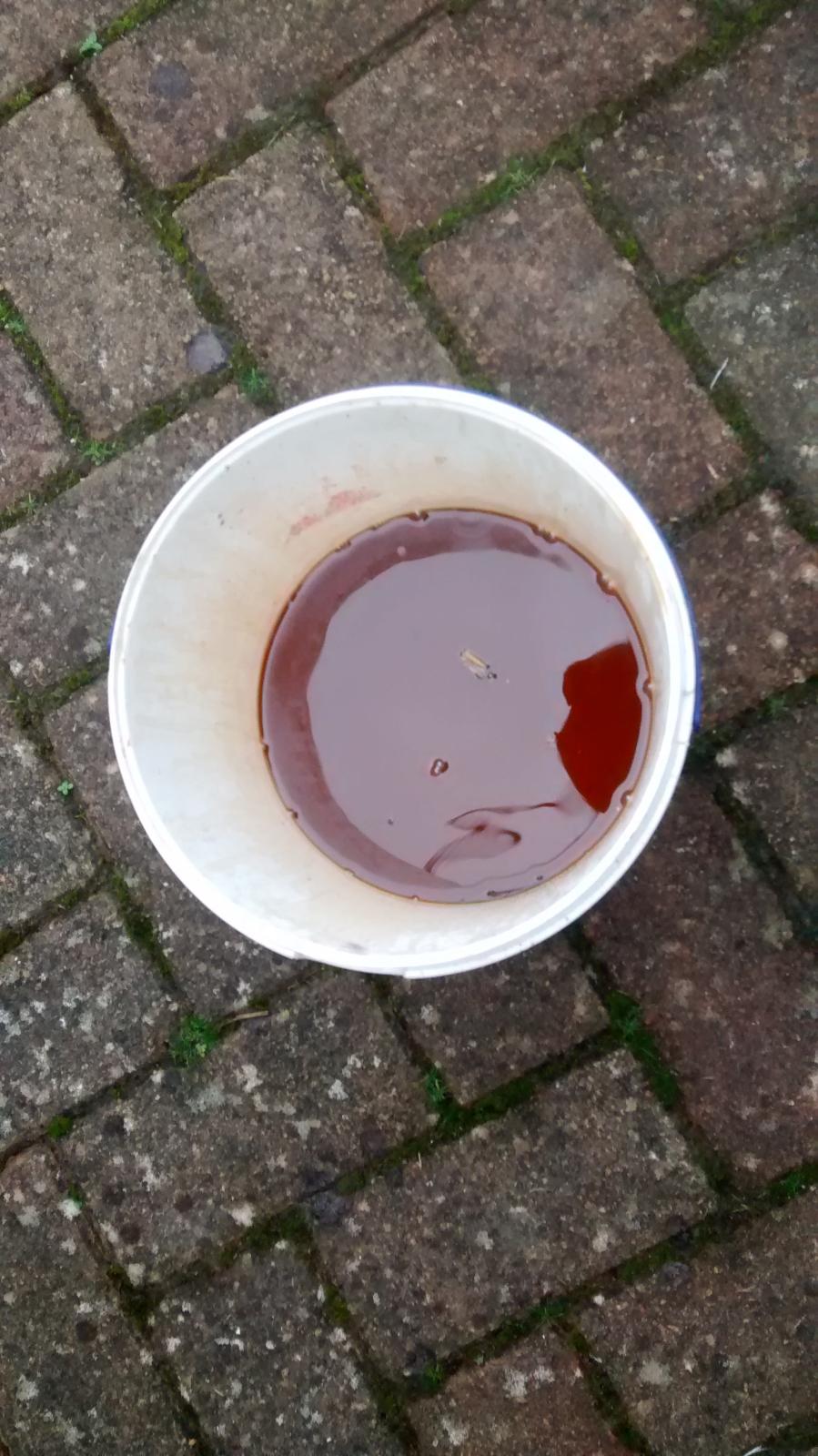

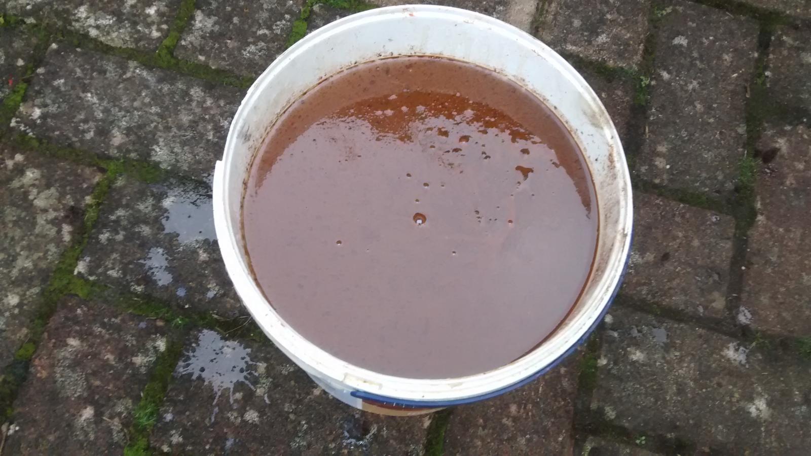

After 10 minutes my arms hurt so I stopped, grabbed and bucket and tipped the contents of the tank out

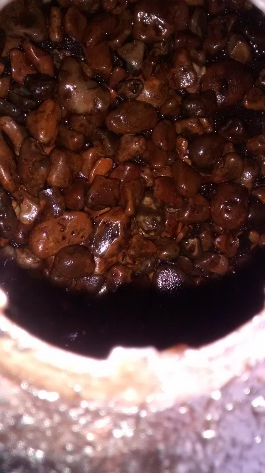

This stunk. And was very brown and oily. I poked the camera in to see what it was like
Oily gravel
Actually, a lot better. Next up I used the hose to put another couple of gallon of water in and repeated the process.
Then this came out.
Still brown, but less so than the first time.

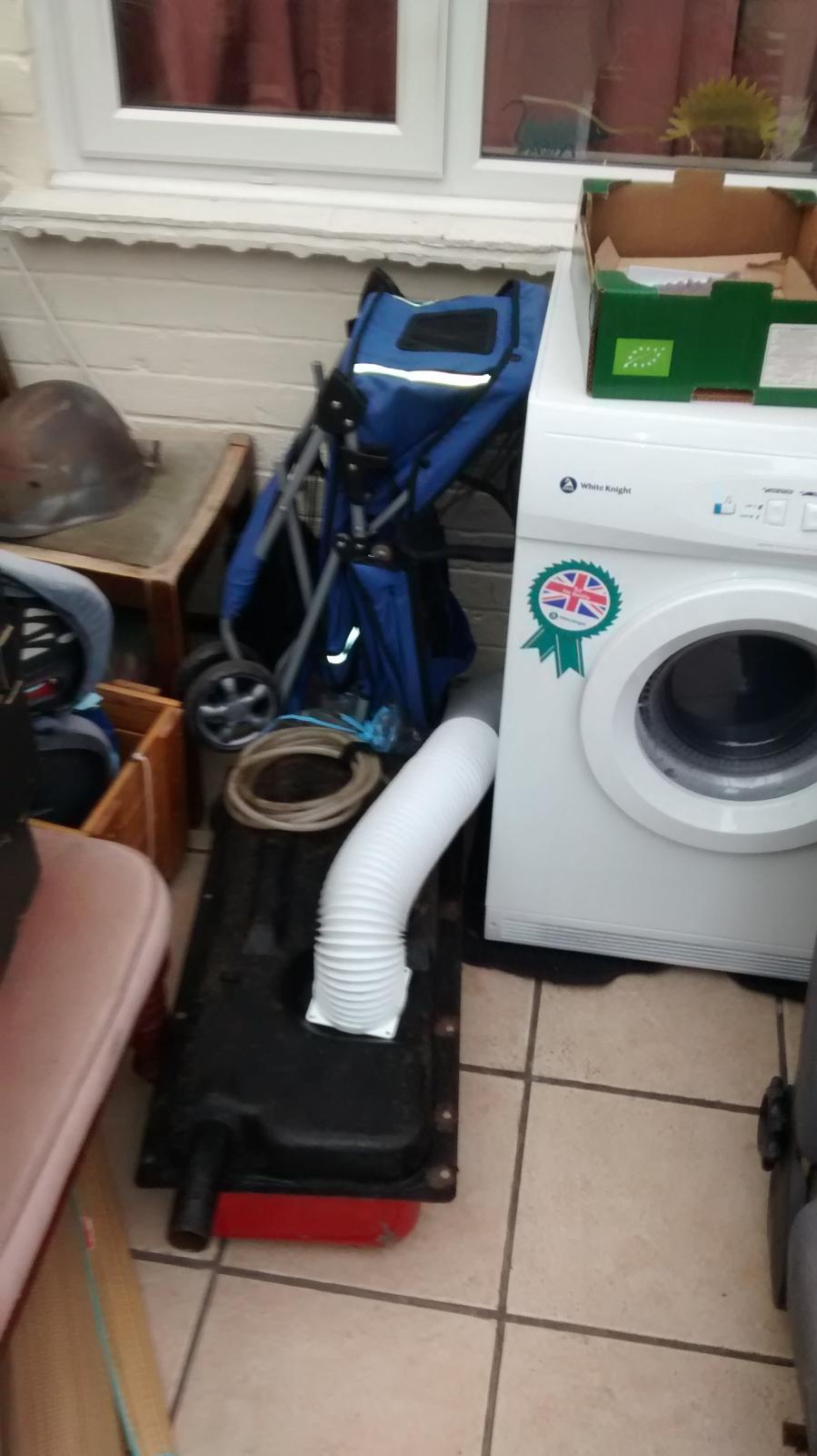

Then I needed to dry it out, or it'll just rust again. I hoiked the clothes out the tumble dryer, turned it on and wedged the outlet pipe over the pickup hole in the tank with a flip-flop.
this seems to be working - its still going now - and is blasting the damp/ming out the conservatory door currently. I left it on for an hour so we'll see where we're at in 20 minutes. Seems to be OK - its not caught fire yet anyway.

Now the tank is fully dry (the tumble dryer trick works brilliantly btw - it took about 90 minutes to completely dry it out) there is a bit of grit still in there - you can hear it if you shake the tank so I'll wait for the paint to dry and then stick the hoover nozzle in there to hopefully remove as much grit and muck as i can before slinging it back on. I need to get a universal cap rather than the plastic bag that currently seals the filler neck too.
