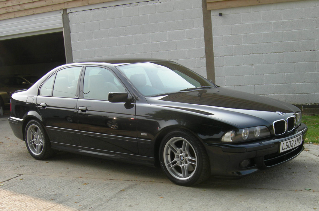

I'm thinking of chopping in my Inshite. Bear with me, it's awesome, but I have my reasons. I'm doing 120 miles a day commuting, which is why the Insight makes sense. However, I'm looking for something a bit bigger and more comfy for sitting on the motorway every day. Something that needs a little less input, less road noise, which I won't feel quite so fried after sitting in for an hour and quarter.
Got to be 55-60mpg or the fuel bill will be too high, auto, comfy, stable on motorway, quiet, reliable i.e. (impending doom won't be acceptable). I'm thinking of an older BMW 5 Series, diesel, early 00s, high mileage that won't matter if I rack up a lot more miles on. Will this fit the bill or have I made a major oversight here e.g. wildly out with the mpg, parts prices, actually going to die, £1Million+ for tyres, £550 road tax bracket?
Tell me about these. What engine etc, what do they even have? Or what else I should be looking at...

I don't think you'll see 50-60MPG from anything older, automatic, big and diesel.

I had a 2003 E46 320d Touring a few years back, motorway MPG when sat at 70mph was ~50MPG if you were careful. That was a manual too. First turbo went at 130k but when the company got rid it was on ~230k without any further issues other than a rattly DMF. E46 are very comfortable in SE spec with leather, an E39 would be much better but keeping one on the road cheaply now is impossible.
530ds and 525ds aren’t that great on fuel.

Six pot diesels do not give anywhere near 50mpg. Our vectra does 40 mpg - but at 40 mph in top.

As already said , unlikely to get 50+ mpg from a six pot dizzler BMW ( no UK 520ds in e39).

2010 BMW 530d. 43mpg

2003 BMW 525d man. 48 mpg
2002 BMW 530 auto. 37 mpg

My M47 engined 320d does 50mpg on a run, and not beating the shit out of it.

I used to have a 1994 manual 525 tds e34, the same engine they fitted in the 1996-8 tds 525. shite power off boost,fuel 32-39 mpg. It saw 253k miles and I sold it as a runner.
I now have a 530d touring manual and engine is revelation, do not confuse the two. Bag of go from about 1300 rpm, goes like a (smokey) rocket on boost. Dash Lie-O-Meter claims 47mpg overall but the truth is 38ish local, 45.5mpg on a 300 mile cross country run this spring. Still very quiet and comfy at 260k, I be sorry to see the scruffy old bugger go when the tin worm gets it.
We also have a 530d manual saloon in the family that has gone from 120-210k with us, the only time the engine has flickered was when a moron filled it with red out of a dirty can. Not as strong as the touring but it doesn't smoke and has slightly better mpg.

A brand new 6 pot BMW diesel isn't going to get anywhere near 55-60mpg, never mind an old E39/60. I'm afraid you're going to have to trade off either your power or mpg requirements. Just definitely avoid the 525d, all the power of the 4 pot with all the fuel economy of the 6 pot. (unless it's 2012 onwards twin turbo 4 pot, which From what you've said I doubt it's going to be)
TBH I doubt there is going to be anything from Munich that fits your criteria (the mpg part of it mainly)
