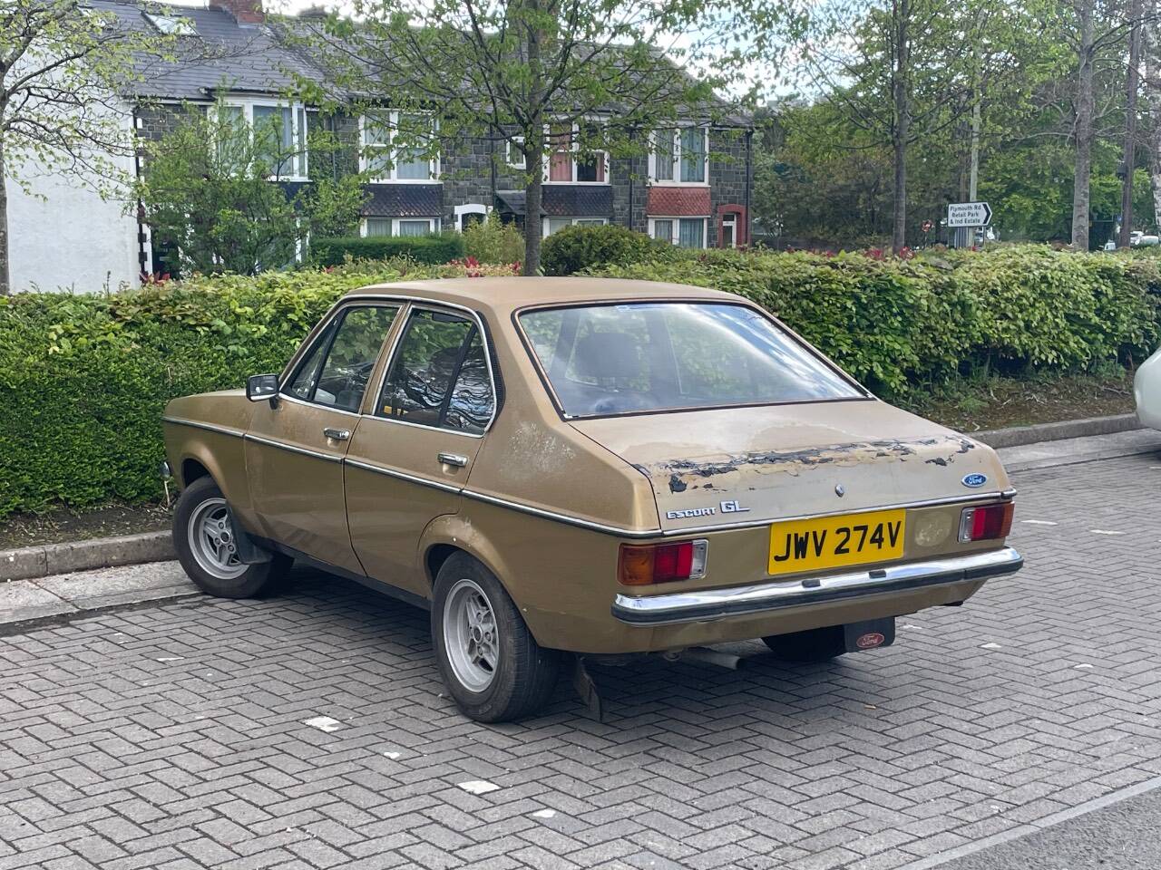

A small detail……
Tax due back when a scruffy looking escort mk2 was often seen at the supermarket car park….
Ive removed the spoiler which had been stuck on (not very well) just need to tidy that.
One supermarket related bonus is that the extra weight having gone from the boot lid means it now holds itself up.

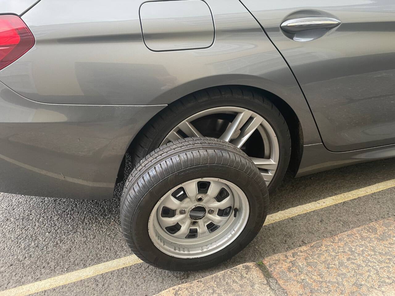

Gregor just dropped off the wheels.
I had them next to a neighbours car, and they look like little toy wheels by modern standards!

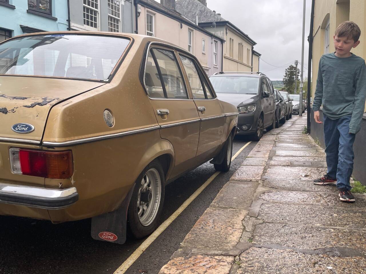

Ill fit them tomorrow so for now its the last of the MOTORSPORT vibe on the old rims

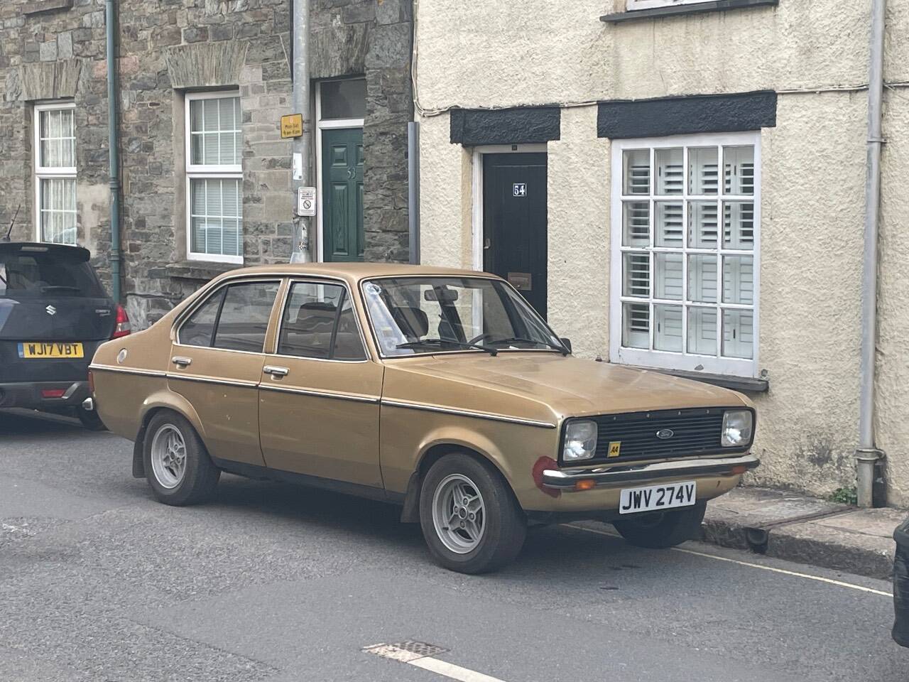

Not driven anywhere yet, i presume the wheel bolts need to be different steel vs alloy wheels?
Link to comment
Share on other sites
Looks that way, yes.
Much nicer on the steels - good choice!
That looks a million times better than the Capri alloys!
There are different wheel nuts. The alloys nuts are a bit bigger and usually have a tapered washer type thing on them. Nuts for steels are usually a longer closed end type nut without the washer. These are usually chrome plated and sometimes come with little plastic nut shaped caps for the ends.
This sort.
https://www.ebay.co.uk/itm/360511576949?fits=Car+Make%3AFord|Model%3ACapri&itmmeta=01HX1BFEE905NX7RZJRRHK7HZR&hash=item53f02a1b75:g:05QAAOSwQQRjoFl6&itmprp=enc%3AAQAJAAAA0B0uzuxOssX%2B8tvxmRnrEi17JQW%2BSEWIcRvY7yT7eSHUPnatzHmuOuSxlnr7Jz8DwYutC18LCpQBioVvBML%2FXDKtLHcgjthIn00%2BJdo%2F3I5bn3IF8ym2fs0753i7Flq0Wa%2FCQzyFARAz03u%2FLZWmqc7hgcrsgjBLXukVqJA5qOnlM31TYfxSGCCwTZ0vBe47M7sGK4UdtqpQ9EpVR3jSWXjieYfD%2F2JP2dK62y6OgoFTZp%2BkxVLWsBRFBa1z4oTSP8Hu2l%2FgnGBCcVOXel2adjo%3D|tkp%3ABk9SR6DnvavoYw
Im not sure it’s absolutely essential to use them though, as long as the taper and thread is the same it shouldn’t matter. The proper steel wheel nuts are slimmer though and do look better.

is that mudflap drunk?

I'm not sure I can recall ever seeing a MK2 with an oversized rear plate...  Now that I  have, I can say it suits it!
