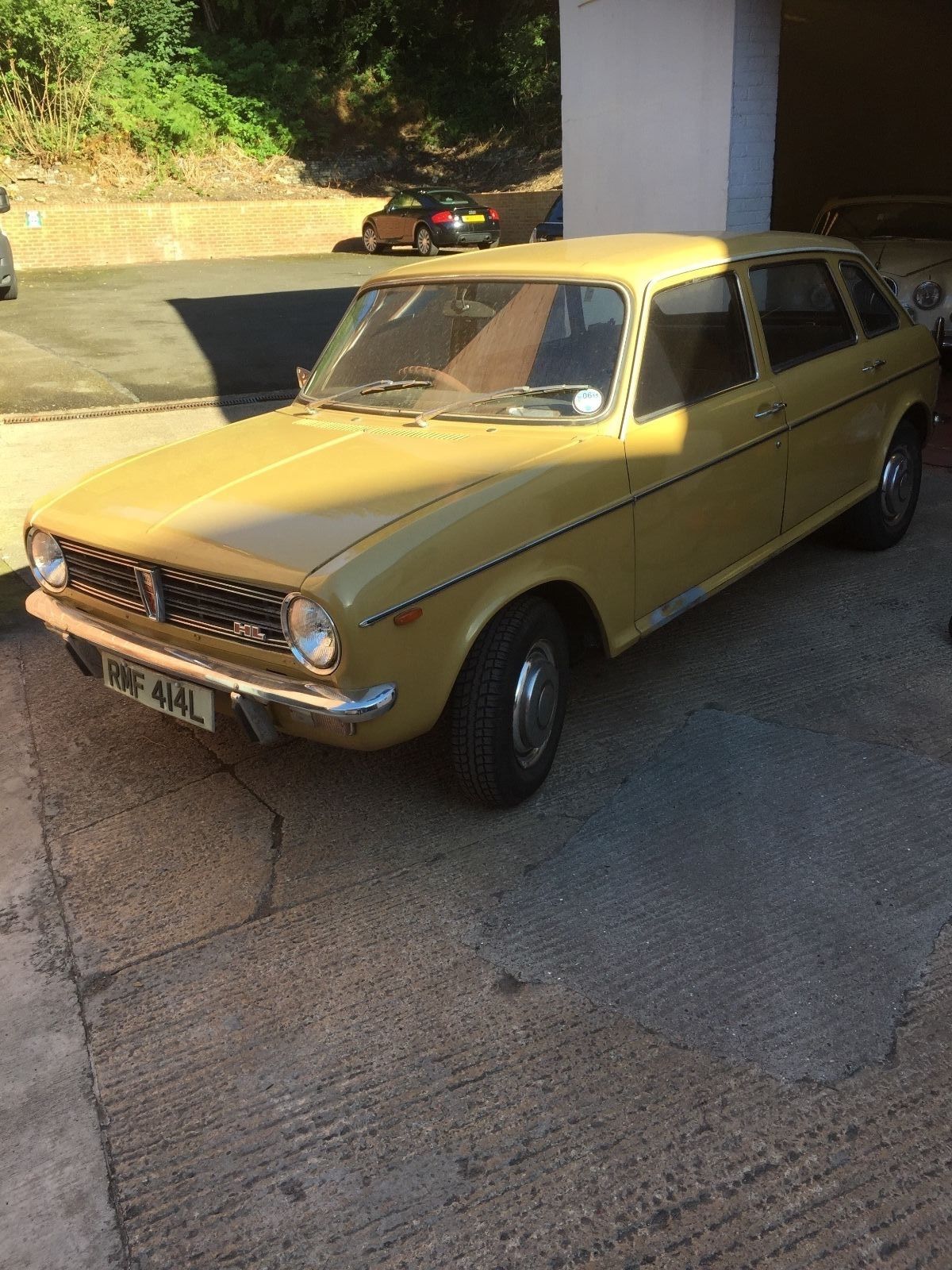

Thanks guys. I was reckless and bought it on e-bay unseen. Mainly because it was 200+ miles away and I couldn't be arsed to go and view it before end of auction  :-D
It has 8 months MOT but the tester must have been blind because there's holes in the sills, the exhaust is blowing, various bulbs didn't work, etc

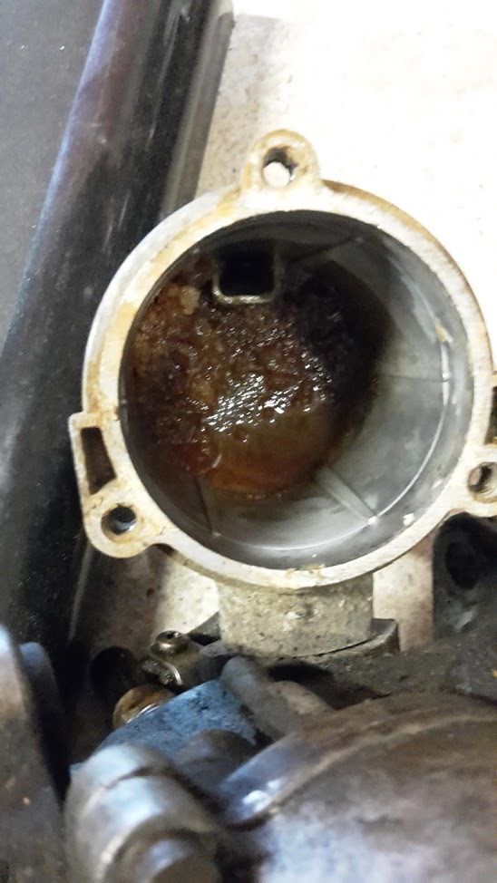

I attempted to drive it home because the seller insisted it was running well, but after a few miles it conked out, refusing to rev up. Once back in my garage I believe the reason is the float chambers/jets are all gummed up with sludge.
That's a stunning opening statement to the rest of the forum! Respect and welcome!
It looks pretty good in the pics, what's wrong with it??
 It was described by the seller as being in good condition and running well. It was located over 200 miles away so I couldn't be arsed to go and view and paid the price because it was in fact in poor condition and barely running.
I can see you've grasped the forum perfectly almost straight away.
Excellent purchase!
And on the plus side, that was the last MOT you'll ever have to worry about on it.
That is some serious carb sludge there mind.  Restecp.
Yeah I noticed I probably won't need another MOT. I have mixed feelings about that. Its great that I won't have to get the sills welded and exhaust fixed to a deadline. Of course, I will sort them, it just means I can take my time. OTOH, there are probably other issues lurking that I won't know about...

Thanks! Main problem is that it doesn't currently drive. It will idle, but won't rev up. I'm hoping that's down to the carb sludge, but until I put the carbs back together and refit them I won't know. If that doesn't fix it then I'm guessing it must be loss of compression in the tired E-series  :?
I'll post another update once Carbs have been fettled and are back on the car :)

Looks lovely from the pics. Apart from the sills, how is the rest of the body?
The upper panels are ok, apart from the odd micro blister here and there. Its the lower bodywork that needs TLC

Yeah it's got the sporty HL steering wheel and Vinyl Dash. That was part of the appeal as it was a bit different to the average Maxi I've seen before
Massive soft spot for a Maxi (it was my first car and was brilliant) Respect for taking one on, esp. bought unseen, though I think they're solid, reliable motors and once you have the running issue sorted, it'll turn out to be a honey.

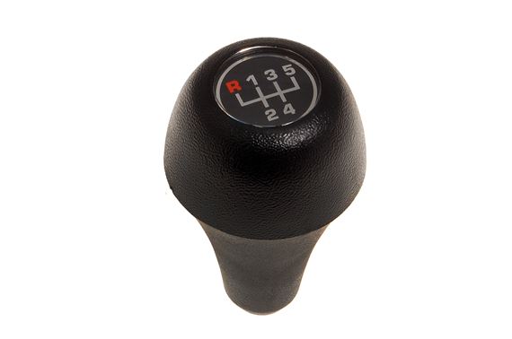

a strange thing with these kwaidee BL gearbags is after a suggestion by my mate i put a larger (1980's) gearknob on my mini which made it easier to select the actual gear requested this was also successful on my dads allegro 1500 5 speed!
and the late mini one was similar to exhibit 3 post-17711-0-87751900-1506121968_thumb.jpg
and the late mini one was similar to exhibit 3 attachicon.gifmaestro nob.JPG
This probably deserves a thread of its own, but many years ago I was told something very similar by a bloke called Tim Bishop. The greater the weight of the knob, the easier gear selection became. He told me that old Jaguar sports cars knobs are ludicrously heavy. To this end, my T2 with its fourteen foot long gear linkage is now fitted with the original tiny plastic knob which has been packed with lead, sealed in place with epoxy. It weighs four times as much as it did. And are the gears easier to select, I hear you all cry.

Morning All, latest update is now with the sludge cleared from the carbs, a new jet fitted to replace the leaking one it now drives again. Yipee  :mrgreen: Although its not perfect seems to chug a bit at part throttle, but pulls like a train if you floor it. Carbs probably aren't setup right and being twin carb seems I need rev counters, balance meters and the patience of a saint to do that!
