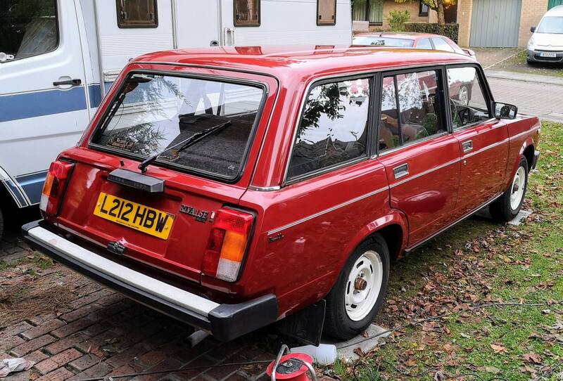

So the Lada was dragged out from under the tree yesterday.  Figure if I'm trying to sell the thing, looking like this isn't really helpful...
I'd abandoned it over there and basically forgotten about it for a couple of months after I had a member of the public who knocked on the door having seen the for sale sign turned ridiculously aggressive when I wouldn't accept his offer of £250 with the new wings fitted and painted.
It obviously isn't going to just miraculously sell itself...so time to tidy it up.  It's due an MOT anyhow, so I want it to be tidy when it turns up at the garage.
After a couple of hours it had been thoroughly de-treed.
Now clean, but the paint is as dull as a documentary about the history of the colour grey.
Yuck.
Had to give the engine bay a going over too as the scuttle drains were unsurprisingly full of tree.
The interior at least isn't bad...just wants a few bits of rubbish removed, a vacuum and the plastics given a wipe down.
This afternoon I decided to continue with the tidying and attacked it with the machine polisher.
I knew from prior experience that the paint on these cars despite being cheap, actually comes up pretty well.
Yep...takes a nice shine.
Still needs the fiddly bits I can't get into with the power polisher around the mirrors etc doing by hand and then to be drowned in as much wax as I can make stick to it.  That might be tomorrow's task if time and the weather co-operate.

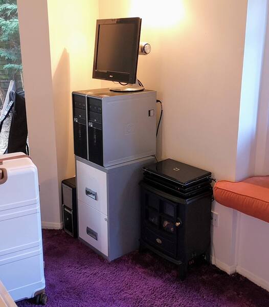

Last task for the evening was a bit of IT wrangling.  Our household makes quite a bit of use of a digital "vault" on which pretty much every movie, piece of music etc has been backed up on.  This then can be accessed over our local network by anything anywhere in the house.  However the drive involved has been getting close to full lately...and there was no easy way to add another one as the drive was simply hooked up to the USB port on our wireless access point.  This also make file management rather clunky.
Recently two old HP servers were added to my network, and it made sense to me to utilise one of these, as they're up and running 24/7 anyhow running distributed computing research clients.
These are really tidy little machines...hard to believe these are from 2007.  Especially being so clean.
The lower hard drive is the one I've just added which has our media archive on...need to track down a right angled SATA cable (I've got one somewhere) as aside from being miles too long it means I can't refit the side panel at the moment.
Glad to report that despite all my previous attempts ending in abject failure, setting up the DLNA server this time worked first try.

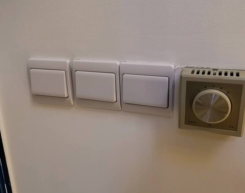

Finally lost patience with the stupid electronic touch dimmers in our dining room & lounge which simply do not play nicely with anything other than incandescent lamps.
So they got pulled out today and replaced with conventional switches.
The thermostat for the heat pump fans was also hanging off the wall, so I took the opportunity to properly secure it.
One round the corner needs further attention...for one the back box isn't fitted properly so the whole mess sits squint...also the three gang switch which handles the lights around the stairwell being of a different style is bugging my OCD, so have ordered a replacement in the same style.
Five minute job took five times longer on account of two things...Firstly isolating the supply took fifteen minutes of randomly flicking unlabelled breakers (we eventually discovered that the lights in the kitchen are on the ring main...yay...)...and secondly that whoever fitted the previous switches left about 3/4" of cable in the back box and have plastered the rest into the damn wall.
Should have expected as much given I know they were fitted under the orders of the interior designer who had the place before us.  She has a long history of having very shiny ideas executed by the lowest bidder.
We've been in this house since 2014 and I'm still fixing things messed up while they were here...still finding them too for that matter.

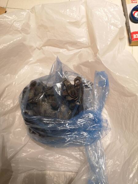

In terms of car things, I've got the carb from @Mrs6C's Invacar in my care at present.  It will be subject to a more or less complete teardown and thorough clean tomorrow, this should hopefully put an end to the problems she's had with the car refusing to idle.
Know quite a few folks seem to be unnerved by the idea of stripping a carb for cleaning, so I'll do my best to document things step by step here to show that it's nowhere near as scary as it might seem.

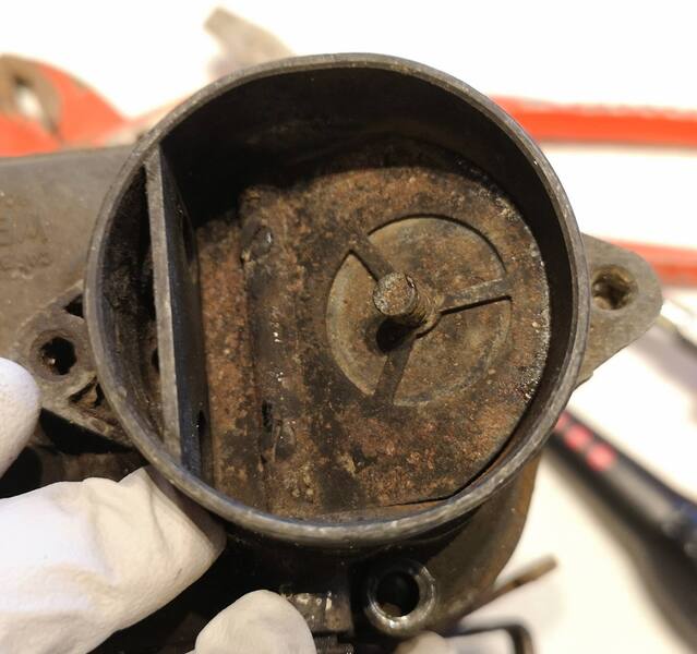

I've had a rather sick carburettor from Mrs6C's Invacar waiting patiently for surgery all week, finally managed to actually get the thing on the table.
The description was that the car was more or less running but wouldn't idle for love nor money.  Most likely a blocked idle jet, especially given I knew from having had my own carb apart that the idle jet in particular has a miniscule orifice.
Here's the patient.
A rather grubby Webber 32 ICS 10.  Quite a simple little carb and I wasn't expecting it to really cause me any problems.
It was maaaaaaaanky though.
The tarnishing on the choke butterfly and amount of soot in the throat suggests to me that it's been on fire at some point...which given the fondness of these engines for backfiring when there's anything resembling a fuelling issue doesn't really surprise me.
Okay...let's start the teardown.
First up let's take a look at the fuel inlet strainer.
Mmm...Crunchy...
Given the amount of scale in there I was expecting the fuel inlet itself to be impressively manky.  I wasn't disappointed.
The float bowl tells the story really doesn't it...
To be fair, I've seen worse...but it definitely needed some love.
That little nick in the gasket (the witness marks tell me it's been like that a while) won't have been helping anything either as I'm pretty sure that will have resulted in little or no fuel being supplied to one of the fuel circuits...without digging out a diagram I believe this also part of the idle circuit so yet more reasons she won't idle.
Shame as the gasket is otherwise in decent shape.
Here's what fell out of the float bowl.
So let's get on with it...
"Normalising" jet I believe it's described in the manual...
It's not too bad...but it's also pretty huge so no surprise there.
Main jet.
Aside from being covered in scale, this was internally roughly 85% clogged.
Idle jet - this one was the main suspect for the trouble reported.
This was completely blocked.  Spoiler alert: Even after half an hour in the ultrasonic cleaner, unloading half a can of aerosol carb cleaner into it, blasting it with 140psi compressed air, I still had to resort to attacking it (carefully) with a few strands of electrical flex to get it clear.  So no...not a chance she was going to idle.  Nor was a bit of RedEx in the tank going to make any difference.
Next up, the idle control needle valve (I think).
Pretty manky.  Made horrible screechy noises when it was unscrewed too.
Accelerator jet itself...
This was probably 50% full of gunk...Though this is the orifice it's fed from...
...Which was actually totally encrusted and you couldn't even see the hole.  Some of it chipped off when I was unscrewing it.
Now I'm not a complete idiot...I kept a note of what came out from where.  Mostly by shape as most of the jets were sufficiently encrusted that there was no chance of reading numbers off the...though to be fair this is a carb where I don't think much will actually physically fit in the wrong places.  The diagram also gives me somewhere to note down where the adjustments were set.
Oh, and there was a not inconsiderable amount of scale stuck to the floats too.
There was only one thing left to do at this point...dump it in the ultrasonic cleaner.
...And send the dogs skittering madly across the house the moment I turned it on.  This sucker is waaaaaaay louder than the little one I used to use.
Oh...just went with 35C and 15 minutes.
Plan was to rotate the carb in there after the fifteen minutes as the cleaners about 2% too shallow to get it all under the cleaner.
Definitely doing something...after about sixty seconds the cleaner had already started to go cloudy.
While everything was submerged I gave the accelerator pump a good workout to help get as much gunk out of it as possible.
30 minutes later...
Eww.
The next step doesn't have photos because I needed both hands.  This was to fish everything out of the cleaner, take it to the garage and dry everything off with the compressed air gun.  This gave me the opportunity to blast through all the jets as well - which is where I discovered the idle jet was still clogged.  Cue a good twenty minutes faffing about to get that cleared.  Definitely worth doing that step as I'd easily have missed that without the air line as the jet is so tiny you can't see through it.  This also helps make sure that all the channels in the carb body are clear (make sure not to point it at yourself...carb cleaner stings when you get it in your eyes).
Gave the casing and choke butterfly a decent scrub as well as there were some heavier deposits there which didn't come off in the cleaning bath.  The choke plate still looks manky...but it shouldn't actually affect operation.
So here we go...one clean(er) carb jigsaw puzzle.
I would have liked to remove the float so I could get the needle and seat out... however the retaining pin was utterly disinterested in moving without resorting to unreasonable amounts of violence...so I decided to leave it well alone as the valve seemed to be seating properly and free moving.  Likewise the accelerator pump cover, the screws were mega tight, so I left it well alone.
There's quite a bit of staining and pitting in the float chamber, but it's a lot better even if it doesn't look pretty.
Looking down inside the various drillings (you can see down into the one for the accelerator pump in the upper left of the float chamber in the above image) shows things to be nice and clean rather than full of "sand" as they were before.
The fuel inlet stub was probably the worst before...still not pretty again, but way better.
Reassembly as they say is the reverse of dismantling...albeit with an additional step...which wound up taking half an hour to do.  Remember that dodgy gasket?  Yep, that had to be replaced.  Sadly I didn't have a new one on hand, so had to make one.  Fiddly is the word.
"Ugly as sin" is the result...but it should work.
This was before I went over to tidy up some of the burrs and such, but you get the idea.
All back together!
Quick test was done then to make sure that you could blow through the fuel feed with the carb upright, but not with it flipped upside down, telling us the float valve was free to move and was seating properly.
Then it was packed back up, ready for return to its owner.
