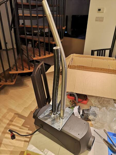

Starting point...a box of bits.

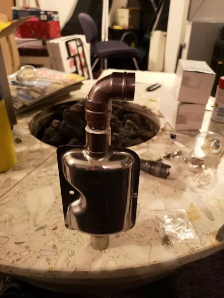

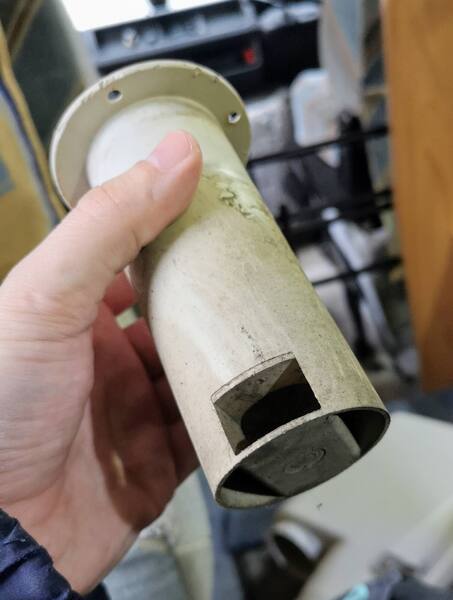

The teeny tiny silencer for the burner exhaust pleases me far more than it probably should.

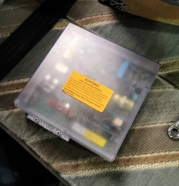

Plus its little control box.
Control unit was removed first.  Helpfully everything plugs in, no hard wired nonsense to worry about.

Leaving the little concentric breather/flue screwed into the floor.
...Which was then unscrewed and removed.

I figured that it would be way easier to get the baseplate fitted and to attached the air intake and exhaust lines before taking things outside rather than in the sea of debris strewn all over the floor in the van.
Dropped it in (glad to see that my measurements were right and it fit.
Getting the fuel line back up through the hole would have been far easier if I'd just done it from underneath the van...but it was tipping it down, so instead had a right faff of a time trying to get the blasted thing to co-operate.
Fuel pump added (it will probably wind up in a padded box in due course to the clicking doesn't drive everyone mad)...
Obviously the exhaust and intake lines will need to be routed and secured...but this won't stop things working for a test run.

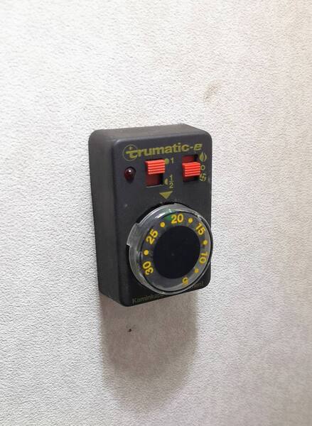

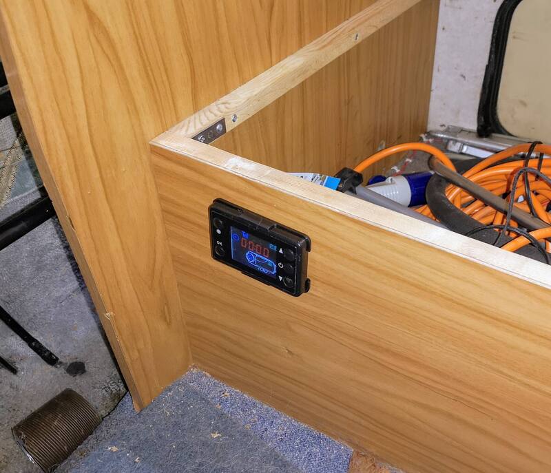

I had kind of hoped to fit the new thermostat/controller in the place of the original...however that was not to be.  The connector on the wiring won't fit past a batten just behind the panel it needs to run behind.  So just went for a spot on the face of the locker for now.
Went for this location so it should still be possible to reach the controls while in bed.

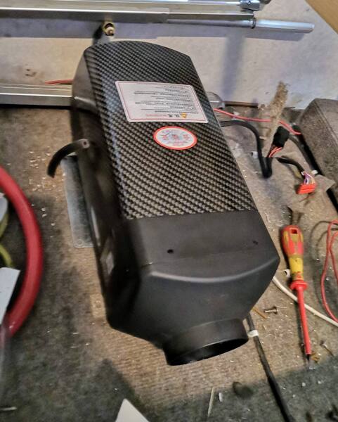

While it's not currently producing heat due to a lack of a fuel supply (that's one of the jobs for tomorrow), it has now been test run.
Couple of observations at this point:
1. The fan is virtually silent...Only real noise is actually the air it's moving.  Obviously the burner itself will make a bit of noise, but it's waaaaaay quieter than the old unit.
2. Power draw.  The documentation states that the maximum running power draw is 40W.  Yeeeeeaaahh...About that.  This may be the case once the unit is up and running, but it pulls a hell of a lot more than 40W when the glow plug is energised during starting.  Digging further through the manual reveals one tiny paragraph which mentions that the starting current may be up to 12A.  This will be getting its own dedicated feed to the leisure battery as the existing wiring gets worryingly warm during startup and shutdown!

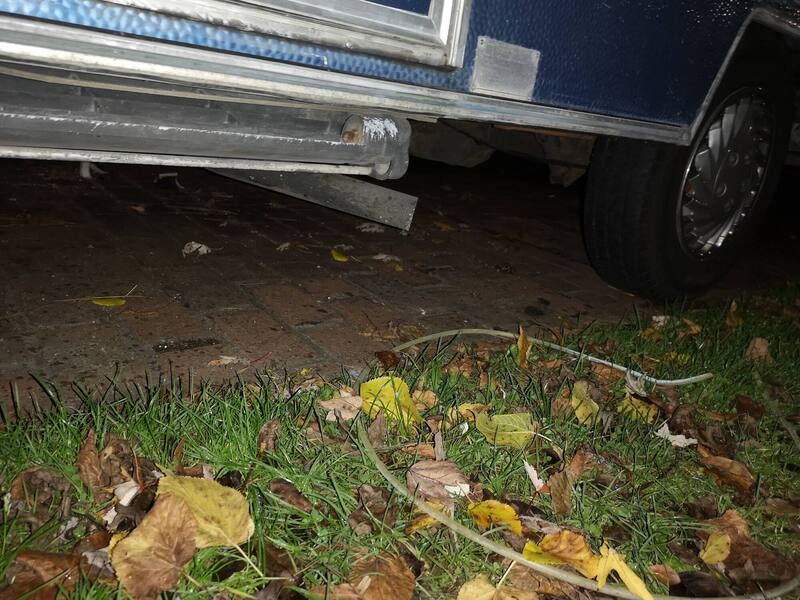

Oh...after a brief check underneath to ensure the fuel hose isn't touching the exhaust.
I'll be going back in there with some reflective foil tape to line the floor around the hole to protect it as far as possible from the heat, and the hole around the fuel line will be sealed with Sikaflex (not doing the baseplate itself yet as I do want to move it at a later date).  Not too worried about the lack of a grommit given it won't be able to move once it's sealed...and it's marine hose which is nigh on indestructible anyway.  Plus I don't have any grommits the right size.
Can't actually tell much from inside aside from when heat starts being thrown out of it...but it's quite obvious from the exhaust side when the burner fires.
Apologies for the loud buzzing towards the start... annoyingly this phone doesn't silence the notification vibration when recording video.
The smoke initially (unburned diesel actually) I think is mostly because it will have dumped quite a bit of fuel into the combustion chamber while I was trying to get the pump to prime properly.  I don't think it will probably smoke quite so much on future starts.
Yes, it does sound like you're standing next to a teeny tiny jet engine...it's quite loud actually (outside, is really quiet inside the van), and I wasn't expecting much from the supplied silencer really.
Impressive... didn't expect that to do anything...much less pretty much totally eliminate the exhaust noise.
Next steps will be to find a T-piece and reducer so I can plumb it into the vehicle fuel supply (probably a check valve too, so a failure of the heater fuel pump can't allow air to be drawn into the vehicle's supply) and to tidy up the piping under the vehicle.  Fit the intake screen/muffler and the exhaust silencer while I'm there.
Seems to chuck out a really decent amount of heat (not surprising I guess given the 5kW rating!) and run really quietly, impressed so far.

While I was down there I also added some heat shielding around the exhaust pipe to protect the floor around it.
The intake hose has also been fastened in place and has had the muffler attached.  I've tucked it in behind the fuel tank so it should be pretty well shielded from the elements.

Irked I didn't get the thermostat straight...though it will be going back on the wall when I pick up the Afterburner kit anyhow...
As currently there's a hole where the old stat was.

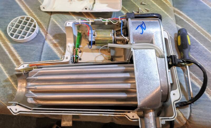

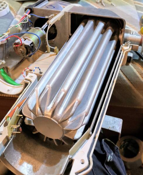

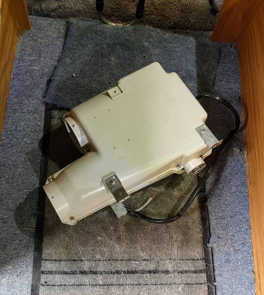

So this does leave me with something I need to find a new home for, the old heater.
That is a funky looking heat exchanger...
Looks like something out of a nuclear reactor...

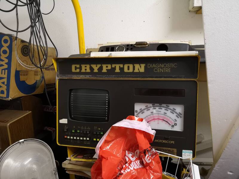

A couple of years back I rescued this old Crypton Motorscope 335 from my local garage.  They had it buried on its back half under an awning.  They hadn't had the heart to bin it after many years of faithful service.  Who says mechanics aren't sentimental?
Sadly the only photo I have to hand right now is of it slightly buried in the back of my garage.
Despite currently being buried in my garage, it's actually proven really handy on a few occasions...though practicality aside, I knew I had to rescue it the moment I spotted the huge rank of flipdot buttons.  The Panaplax digital readout above the analogue meter was an unexpected bonus.  I'm a bit of a display tech nerd and it was the first time I'd seen that technology in person.
Essentially it's a very specialised multimeter with a scope and timing strobe attached to help diagnose ignition and charging system issues.  A CO% meter was an optional accessory...sadly not fitted to my unit.
She needs a little love as the button contacts are scratchy as hell and a little percussive maintenance is sometimes needed to wake it up...I suspect it needs a decent dose of contact cleaner and the various card edge connectors similarly cleaned.  Given I spent about half an hour reviving it and it had been half exposed to the weather for God only knows how long it's doing very well.

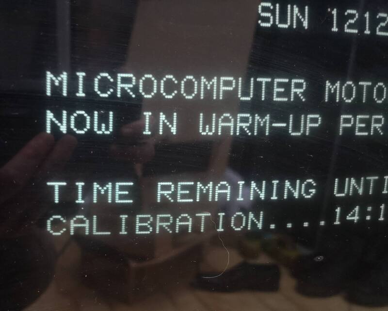

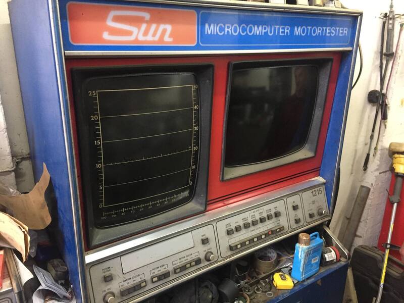

However, I stumbled across something which has been on my wishlist ever since I saw one a long, long time ago...
Functionality aside...LOOK AT IT!
I'm a complete sucker for that flat smoked panel with chrome trim aesthetic...best exemplified by the Kolster Brandes KV-024 television (circa 1968) which was my gateway into proper vintage technology restoration - and the first valve based device I ever played around with.
Sadly that's currently in hibernation in the back of the loft as it needs a new CRT...and they're not something you exactly trip over these days.
I was expecting this to go for ridiculous money to someone with far deeper pockets than me, only to be gutted and have the faceplate wind up on the wall of some trendy office.
So what was the end result?
Well that was a surprise!  Just the starting bid.
So a van has been booked for Monday to go and collect it.  Roughly 80 miles each way, so not even far away.
Given the fact that these things weigh about as much as a small country I decided it was worth spending the extra £15 to go for a van with a tail lift...my spine will thank me for that.

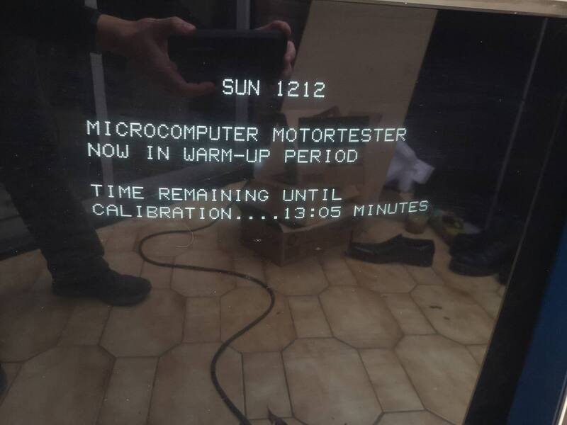

Basically this has the same scope functionality on the left hand side as on the old Crypton unit - though what's different here is that instead of a glorified multimeter on the right, there's a CRT hooked up to a rather primitive microcomputer.  This allows you to do quite a bit more detailed analysis of the data gathered.   Including stuff like recording the current drawn by the starter motor during cranking to give a rough estimation of the relative compression ratio of each cylinder.  In addition there's a CO% and HC exhaust gas analyser built into it.  This is an optical type as well, so there's a good chance that with a proper service that it will work just fine.
Here's an example showing the display in action (from the user manual).  This is the earlier version - identical as far as I can tell aside from the cosmetic differences.
Rather looking forward to getting that in the garage...been a while since I've had a decent tech project.

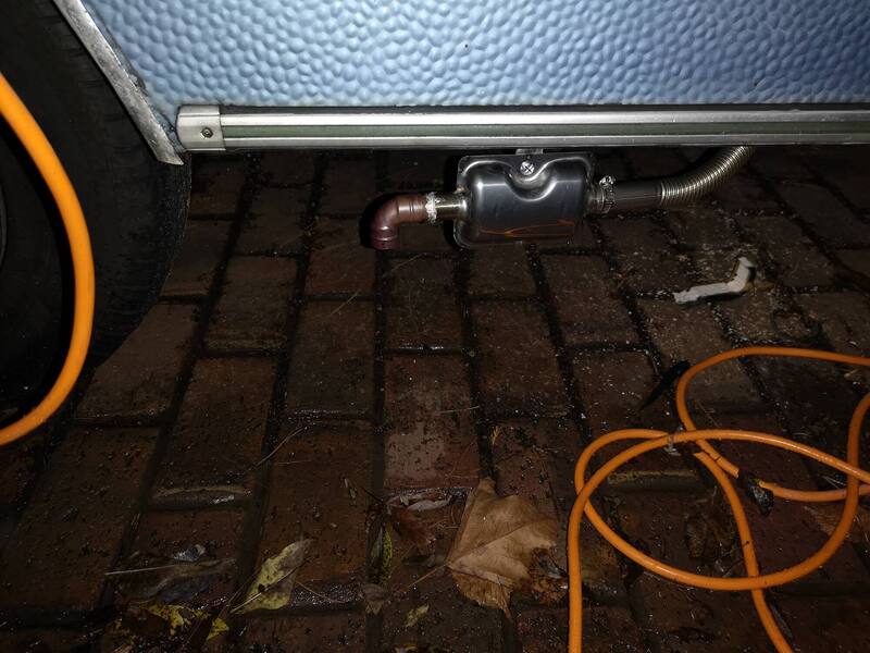

Done a little more work on the heater install in the van.  One thing which was bothering me was that the exhaust was pointing out to the side...the gases expelled from it are HOT and I was worried that it was a hazard that someone was going to burn themselves on.  It also had a serious habit of pointing exhaust directly at my mains hook up cable.  The pipework didn't want to let me point it downwards...so I had to improvise.
Discovering that 22mm pipe was a perfect snug fit in the silencer outlet made things easier.
Though the question springing to mind was whether the solder will melt...no idea how hot the thing runs.  Only one way to find out is to hook it back up and fire it up.
Yes... it's melted the solder.  I'll just replace the elbow with a compression fitting tomorrow.  Not too worried about the pipe into the silencer as that's a very snug fit, and a quick tap with a hammer and punch should make sure it's never going anywhere.
 Still really impressed with how quickly it warms the van up...and glad to report that the comedy smoke cloud on startup has stopped being produced now the fuel pump has been properly primed.

After six and a bit hours in the most horrible van I've driven this decade (and I've no idea how many times I was flailing around beside for the seat for the gearlever and trying to pull off in second because the gears are in the wrong place), this has arrived.
Only *nearly* killed me and my husband getting it in the door.
Will give it a quick wipe down this evening, tomorrow we will try to get some basic testing done.
Yeah...the 1215 is just a beautifully made bit of kit.
Has had a really quick wipe down...not touched the faceplate yet though.  This like the Crypton has the graticule for the scope on the outside...so I'll need to be damned careful cleaning that.
Overall the initial inspection shows it to be in pretty exceptionally good shape compared to most of them I've seen.
If filthy.
Quick wipe down has helped.
Flipdot indicators built into the buttons for the win...
Will give it a proper clean tomorrow and then get some testing done.  All the attachments are here, just currently piled in the corner to make it slightly less unwieldy to move...it was heavy enough without it swatting me in the face with cables every five seconds.
i think i would be inclined to set the silencer horizontal rather than vertical like it is now for clearance issues if nothing else
these heaters may smoke on start up if they didn't "run down" properly as there will be excess fule in the burner
It's mainly initially been situated where it is because the manual was adamant (to the extent of saying it in capital letters) that it should be horizontal with the condensation drain hole at the bottom.  Secondly the pipework doesn't have a massive amount of flex in so the location is pretty constrained.  I may well rotate it through 90 degrees so the flat profile is horizontal (yes, ignoring the instructions) as you suggest to make the profile a bit lower.  In reality though, the van has ridiculously high ground clearance and if that's getting in the way I must be doing something wrong!  The actual vehicle exhaust and step under the door are quite a bit lower than the heater exhaust.
This is pretty much the same spot on the opposite side.
Sadly I need to go out and do boring stuff like grocery shopping now...but couldn't resist a quick test just now.  Did a quick sanity check with the Megger (mainly so I didn't have to go reset the damned RCD again) and then powered it on.
Judging from the shape of the CRTs this doesn't have many hours on...
It's actually sharper than the photo makes it look.
The computer display keeps cutting out though (seems like a display rather than computer issue itself as it comes back without any disruption to the actual data displayed) so it unsurprisingly needs a bit of attention.
Hopefully will be able to get a closer look later today.  Definitely looks encouraging though.
Yay! happy to see it seems to be working :)
im most curious what lights up the signage on the top? :)
(im guessing some sort of fluorescent tube but what's currently fitted is what im wondering!)
Will indeed be fluorescent I'd think, sadly that doesn't appear to currently be working.

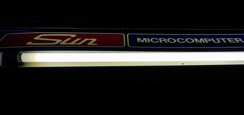

Well this afternoon I wound up running around like a headless chicken so ended up with very little time to actually look at the 1215.
Before I locked up for the evening though I was determined to investigate at least one issue...being me of course the first item on the list was the backlight for the sign.
Looked simple enough to get into, the brightwork strip under the sign is just held in by three machine screws.  Something immediately became apparent...no wonder this thing weighs a tonne!  Was expecting a little bit of pressed tin...
That bit of trim probably weighs a couple of kilos.  If this is the sort of build quality I have to look forward to we're not going to have many issues!  The sign itself is a *really* snug fit in the front of the machine, so I didn't attempt to move it further than I had to.
The light was utterly dead...not a flicker, nothing.  Have to wonder if this tube is original...
Of course curiousity just got the better of me...August 1995, so no.  It's been changed at some point.
Only 3' tube I had to hand was a yellow Narva which I'd had in service at Halloween.  This was enough to prove the ballast at least.
It appears to be a pretty aggressive instant start ballast given it lit the tube when it was only half inserted.

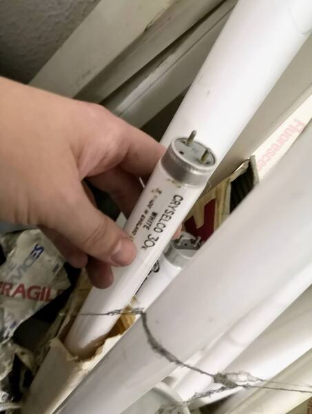

Took me a bit of digging but did find a suitable tube in the stock.  One of the stack of NOS tubes from my old work building found by the demo crew.  That poor old building keeps on giving.
Off we go.
Back together.  Looks the business.
*Hopefully* I might actually get a chance to look at it properly tomorrow afternoon.  Would really like to at least get the back cover off before we leave for the weekend on Thursday morning.
of all the tubes, I have to say I was not expecting an F30T12!
they are very rare in the UK, but funnily enough most "commonly" found on buses (contrary to popular belief the F30T12 and F30T8 do have different electrical specifications, one of those being the F30T12 is easier to strike up, hence why you find it in buses on their transistorised low voltage ballasts)
and in stuff imported from the US, is the thing from the US or something any idea how old it is?
looks like its outside etch so April 1994 (if the dash is under the E and 9 dots ignoring the 2 on the far right, with the dash under the I indicating it was made at the bucyrus ohio plant :) )
real shame its seemingly dead, also very interesting to hear it has some sort of electronic ballast, would not expect that in such old kit, would be very interesting to see what it is
reminds me that I must add some of those to my collection, I wonder how many tubes i can fit in a Model 70 :)
These units were quite popular in the USA, and honestly wouldn't surprise me  if I found it running from a 230-120V transformer internally...we'll see when I get into it.
Dating the sucker properly is very much on the to do list.  I *think* we're looking at early 80s though.  The 1215 was launched at the very tail end of the 70s, though this facelifted one came a few years later.
Sure we could find you one of those 3' Cryselco tubes.  Can't remember exactly but there are at least half a dozen of them.  They're from 1972 if I remember the date codes correctly.
did not realise the system went that far back, I was thinking late 80s early 1990s!
since the GE date code is on a 10 year cycle it could be April 1984 as well which would make it original (the 1980s was the transition from inside etch to outside etch so that rules out it being 1974!)
and id actually be more inclined to think 1984, as 1990s GE tubes had a bit of a bolder etch IIRC
the question im wondering is where these made in the US/by a US company and then shipped to the UK or was it done differently? if they where made in the US then shipped over it would explain the US tube etc
and id very much appreciate that :)  its just getting the stuff home thats stopped me from scooping up some previously, hence the question of how much stuff can we cram in a Model 70 :)
(I wonder how quickly id get pulled over for having an 8ft tube/fixture poking out the window LOL)
1984 would probably be about right I'd think.  Would actually make a lot of sense given the serial number starts 0984...so September 84?
