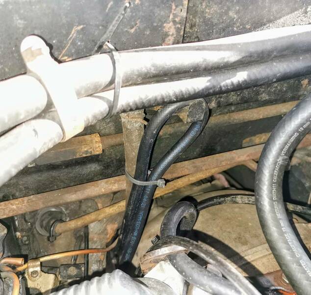

First thing I noticed was that I'd missed trimming the cable ties underneath the car.  Oops.

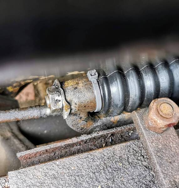

Some of you who have followed my trials and tribulations with the Rover will remember me finding this floating around in the back of the engine bay not attached to anything when I had the heads off.
My guess was that it was a breather which should be attached to the gearbox proved to be correct.  Somebody had obviously removed it at some point and never hooked it back up.  Why I'll never know.
This isn't something you really want to leave open to the elements for obvious reasons.  However reattaching that original line wasn't going to be easy.
Can you see where it attaches?
Zoom...
Zoom further...
There it is!
Yeah, there's no way I'm getting the original moulded nylon line back on there.  Maybe if I had the car properly up on a lift and I could get two hands in there from underneath, maybe.  On the driveway, not a chance.  After fighting with it for about half an hour I gave in and fitted a rubber hose instead.
You'll have to take my word for the fact that it's attached at the gearbox end.  Should do the same job just fine though.

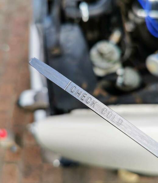

The fluid level was also a *little* on the low side.
Took this to get it up to what looks to be the correct level (the handbook has the fluid level check procedure marked down wrong), saying to check it cold with engine off...not warm with engine running as is correct.  Prior to adding that fluid we had nothing on the stick at all when the engine was running.
Also worth noting that these gearboxes do NOT take normal Dex II/III fluid.  They need type F fluid.  Surprisingly, Mileham's had a few (admittedly rather dusty) bottles on the shelf.  Don't imagine they'll be bothering to re-stock those!  It looks, feels and smells the same as what's in the box so I'm reasonably confident this hasn't been filled with the wrong fluid at least.

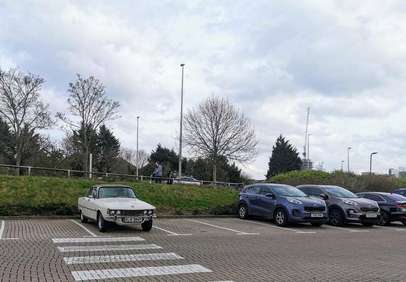

On 03/06/2023 at 01:04, Zelandeth said:
I had hoped to speak to the owner of this Rover but sadly never caught them.
An increasingly rare bird these days.  We did end up parked next to each other after the event though which pleased me.

I just wrote those plates off as modern reproductions, but I do note the font is the proper full size which modern cheap repos rarely are
so thats what Stuarts trying to figure out :)
(PS: speaking of Rover number plates did you manage to get measurements of the P4's front AC Model 70 style number plate before it sold?)

The next task on the pre-MOT was the steering rack gaiter.  Seems simple enough.  Remove the end nut from the rack, separate it, remove old boot, clean, re-grease, fit new boot and reassemble.
Yeah...the two parts aren't too interested in separating after 39 years.  Ideas?  I've left it soaking in Plusgas overnight.  Guessing heat is probably the answer, albeit very carefully both due to not wanting to damage the rack itself and given the proximity of the fuel tank.
Once that's done and I've given the headlight beam alignment a tweak we should be ready to head to the MOT again.  Hopefully!

Yeah, looks like I'll need to get a puller on to it.  I mean it's not something you want to come apart easily and from the locking washer it doesn't look like it's ever been apart before, so I can't complain too much.
Okay, let's have another shot at getting this steering rack to track rod bracket apart.
Attempt number 1.  This failed.  The puller would always slip off well before getting any real torque involved.
This wasn't actually in use, I just stuck it on there for the photo, so yes I know it's not lined up right.
The correct tool for this job is essentially just a big ball joint splitter.  However buying one of those would require spending more money than I really wanted to, and waiting for something to arrive.
Instead, take one £15 splitter from Halfords and spend ten minutes mutilating it with a grinder until it fits.
Remember, it's not stupid if it works!
That let go with one HELL of a bang.
