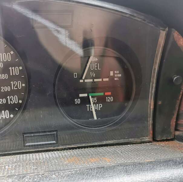

On a related note I investigated the temperature gauge - and there's no life from it.  Nor any voltage getting to the sender.  Given that both the fuel and temperature gauges are showing absolutely zero signs of life this makes me suspect that we may have issues with the voltage regulator in the instrument panel.  Of course I don't have one in stock currently so will need to get one ordered.  I also need to look up how to get the instrument panel apart as it's not immediately obvious and I don't want to go pulling on or levering things given that we're dealing with plastic which has probably gone quite brittle by this age.  I need to ascertain if the clock is getting power as well as that's also on the "not working" list at the moment, so that's another reason I need to get into the panel.

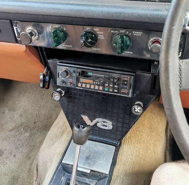

One thing I did successfully do however was fix the radio.  Yes I know that was about item number 3498093453798 on the priority list...but it was an easy quick win I could tick off, and I wanted to know if the head unit actually worked.
Which sounds precisely as bad as you would expect it to through what appear to be the cheapest speakers that anyone could find in the late 80s.  Someone has already cut a couple of holes in the parcel shelf, so I'll probably (discreetly) fit something a bit more modern there to do the heavy lifting (and to fill the holes in the shelf).  Not going overboard though.  At least that's what I'm telling myself.
There was no power getting to it from its original feed (which was spliced into another factory looking line I need to hunt down on the wiring diagram - as that could be the source of our short potentially), so I nicked a feed from a mystery wire which looks like it goes to some long-dead alarm type unit buried behind the dash.  At least I know exactly where that's coming from rather than relying on mystery wiring.
Bit of a shame it's lit amber rather than green, but given the panel above it is also lit white it shouldn't look too jarring at night.  Obviously I'll need to update that photo once it's dark too.

Pet. Res. = Petrol reserve?
Surprised they continued with that tradition if it is! Probably the last rover with it?
Yep.
Has exactly the same thermal controlled choke light setup as on the P4 as well.

Switch panel being green over white helps make it not clash.
Definitely something funky going on with the headlight wiring or switch.  Mainly in that the headlights come on in dip mode as soon as you move the switch to the sidelight position.  Plus only one headlight is working.  Will investigate that tomorrow.

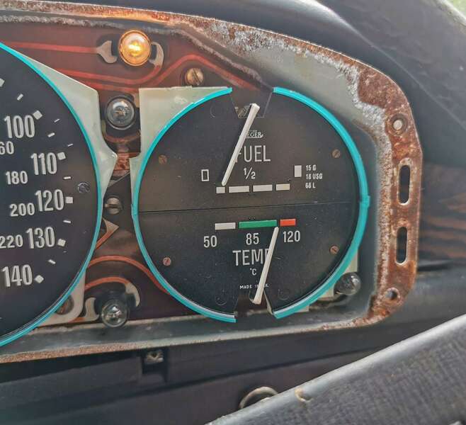

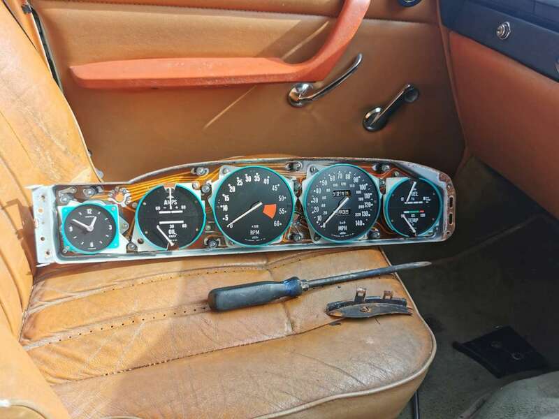

In we go to have a shot at getting the dead instrumentation working.  The manual I've got doesn't give any information in to how to remove the binnacle...however the handbook does!  Imagine that on a car these days...

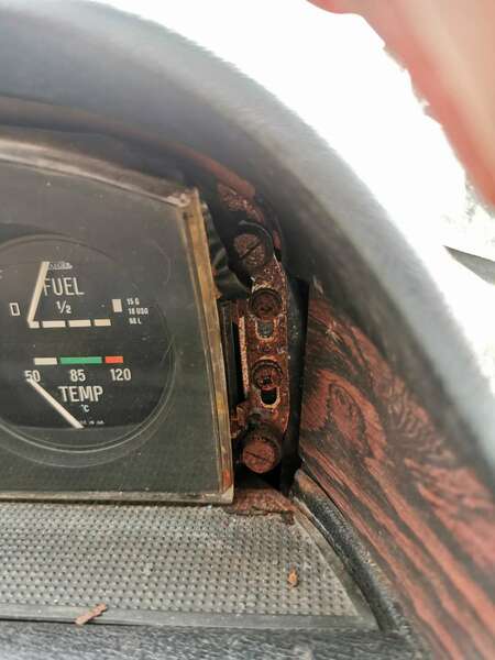

Hmm...Why do I get the impression that we have, or at least have had something of a water ingress issue in the car?

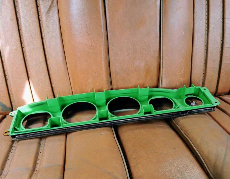

Those two flat head screws there out and an identical two at the other side out and the faceplate comes off.
Which is actually all you need to remove to deal with any issue with panel lighting as the lamps are all replaceable from the front rather than having to faff about removing the whole panel for that.
Four more screws (the inner Philips head ones) release the panel, and once some cable connections and the speedometer drive are disconnected it lifts out.  The speedometer drive comes in from the side to a bevel drive arrangement which actually makes it really easy to get to...which baffled me somewhat as that's usually the single biggest headache when removing/installing an instrument cluster.  I certainly learned new swear words trying to reattach it to the speedometer in the P4.

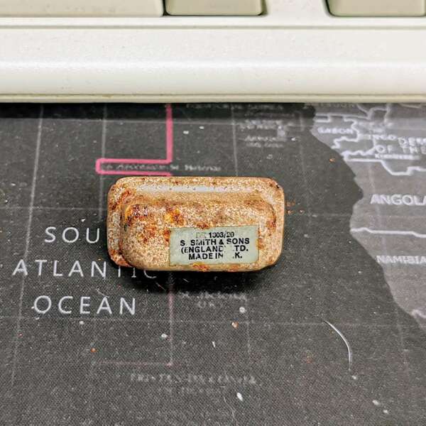

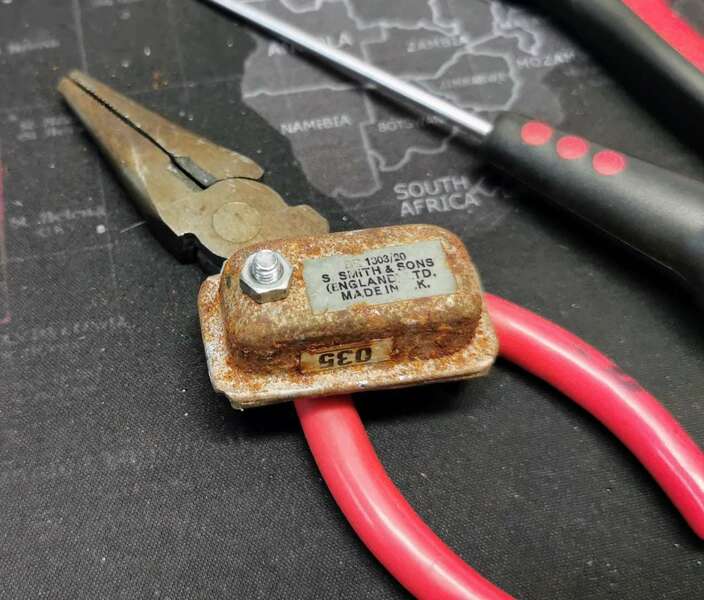

Our suspect.

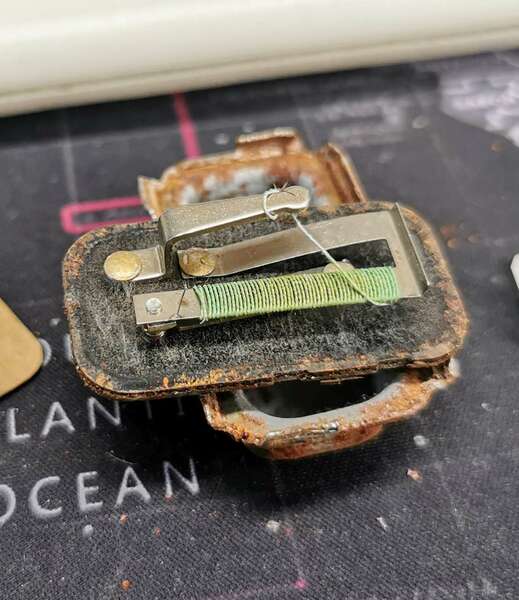

Which sure enough when tested on the bench turned out to be dead as a doornail.  The heater was open circuit so not just a case of cleaning the points.  This is all that's inside one of these.
Just like a thermal flasher unit...which is basically all it is.
The innards of this one were stripped out and an L7810 10V regulator was attached to the inside of the lid to take its place.
I could have just used flying leads to hook it up and either attached it to the back of the panel or to the bulkhead, but I preferred keeping the original case at least.  Plus this should hopefully be a fit and forget solution.
With everything connected back up and the sender shorted to ground the temperature gauge (very slowly) started to climb just as we had hoped it would.  So the gauge itself and the wiring to the sender is fine.

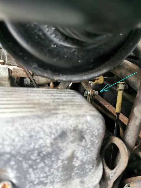

Under the bonnet I set about reattaching the kickdown cable to the throttle linkage.  I don't have a roll pin the correct size to hand, so a bolt and lock nut has been used for now.

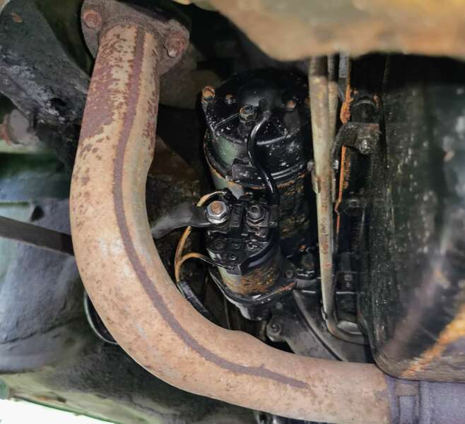

Likewise the starter motor looks pretty recent.  Not new, but it's clearly been replaced in living memory.

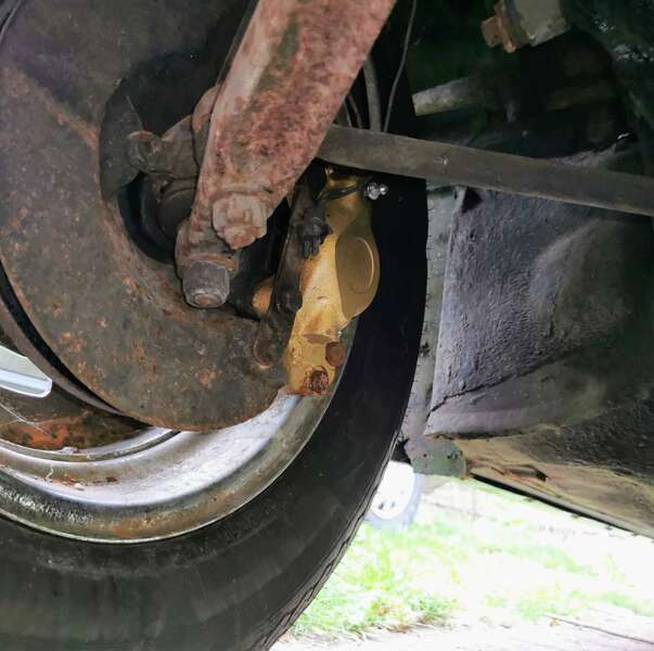

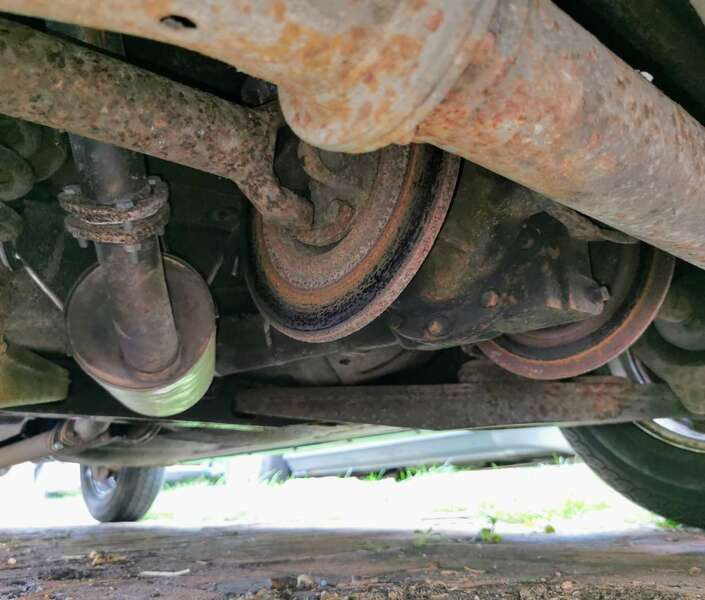

Rear brakes aren't exactly pretty - but there's evidence that they have at least been doing *something* - which given the car hasn't been properly driven in forever isn't the worst start.

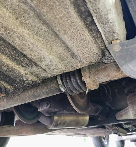

The boot on the Di-Dion tube looks to be in decent shape and there's not oil peeing everywhere...though admittedly that may also be because there is no oil *in* it...Haven't got as far as checking that yet.
Again, the condition of that hose clamp to me suggests that's been worked on pretty recently.
I think the rear suspension likely will need some attention though given that the car seems to sit lower on the driver's side than the passenger's side by a good inch or so.
The braking system passed my patented "stand on the pedal with as much strength as I can muster and hold it for 20 seconds" test without any drama.  So with this all in mind I decided to take advantage of the lull in activity around here between the school kick out madness and rush hour starting and went for a slow, careful bumble around our block.  This literally amounts to a roughly 300 metre square all on 20mph roads.

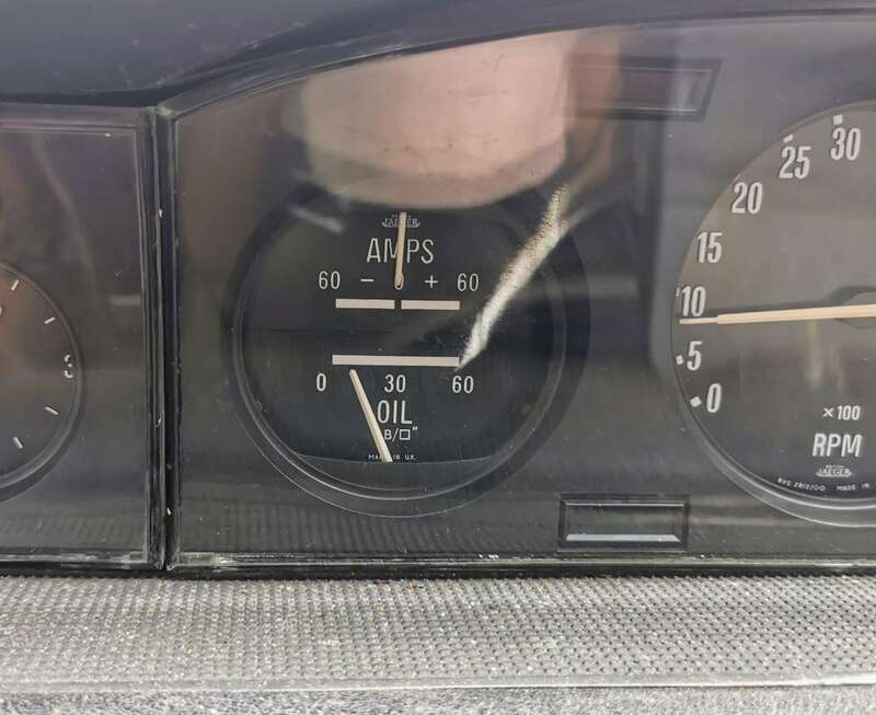

Hot oil pressure?  Meh, we have some.  Which given these engines and the fantastic accuracy these gauges are reputed to have I'll take as meaning "good enough."  The warning light goes out instantly when the engine starts even when at temperature so I'm not worrying about that.

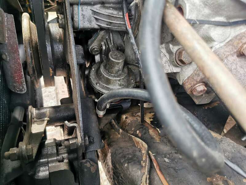

Also on the subject of fuel, a replacement for this (or a rebuild kit) will be getting ordered this evening as this could also have been a major contributor to why our oil was so badly fuel contaminated.
The diaphragm is highly unlikely to be ethanol resistant unless it's been recently replaced anyway, so it's a job that would want doing anyway.

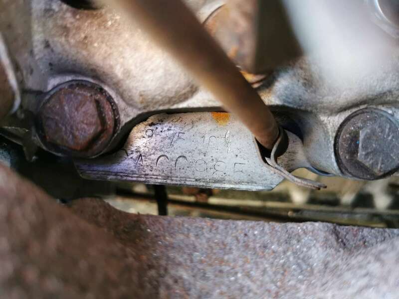

The fact we can clearly read the compression ratio as 9.75:1 helps a lot as that narrows things down a lot.  The only engines I can see which have both that compression ratio and a number starting "?0A" with the right number of digits.  I'm open to correction there from folks who know these engines better than I do, but that's the result my own deductive logic has brought me to.

If the rear brakes look at all neglected then a rear caliper rebuild is recommended. I had a seal blow on one in my 3500 auto and it was alarming how quickly I lost all braking!
Could have been a lot worse, I was on my way to a holiday in the Lake District at the time with the plan of crossing hardknott pass...
They don't need (or have) any oil pressure at hot idle. I know it's unnerving seeing the gauge resting on zero and the light on, but they're working on volume, not pressure.
I remember @PhilA telling me that too about his Rover V8.
solder fuse has blown, easy fix
Yeah, thankfully while I've not actually done much work on these engines, I have driven a fair few things with them - both well maintained and...otherwise.  So provided it's not knocking its arse out I'm not too worried.  We know it's not the original engine, so really haven't the slightest idea how many miles it has on it.
There probably is no oil in it. Later cars had greased tubes. The two types are interchangeable, so take a peek on the top (approx in the middle) to see if there's an oil filler. If not, greased.
That would do it!  I'll have a look.  It isn't mentioned on the lubricant/fluid chart in the engine bay which is otherwise pretty thorough, so possible this is a later type.  Fact that it's still referred to in the handbook doesn't mean nothing I imagine given that Rover weren't always so big on updating things like that.  No idea for that matter if it's the original handbook to the car either.
