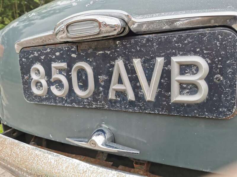

Can't remember if @LightBulbFun was still after close ups of the rear plate.
If so, there you are!
No markings I can see at a glance on the front.
Oooh thank you for those close ups! I am actually after a detailed close up of the front number plate (including a measurement of the digit hight if you can? we are wondering if its 3 inches 1/8th, or 3 inches and a half digit hight?)  as I am pretty positive the front number plate to be of the same "make/model" that AC used for Pre Jan 1973 Model 70's and beforehand, note the same 8 and 5 as seen on KPF385K, sadly we have not yet been able to nail down exactly who made these plates and what their trade name was, but I am hoping in time that with enough data points gathered it can be figured out :) (shame there is no maker stamping on the boarder or such, guess that would be too easy!)
but the rear number plate shots are very interesting in their own right! at first I thought ok standard bluemels plates, but I saw the "White Bronze Ltd Croydon" bit stamped on there also and I thought "oooh Is that the supplying dealer of the car? I mean 850AVB is a London Croydon registration mark" but I had never seen such an old plate with dealer markings! thats only something I have seen on later plates, so I then wondered maybe thats the company who made the backplate or such? so I thought "ok lets see what I can find on this company" I did a bit of research, and I came across this very interesting writeup about the place/company,
https://london-road-croydon.org/history/0192-behind-kidderminster-terrace.html
which talks about White Bronze Ltd, which confirms that they where just a number plate manufacturer, but as being taken over by Charles Wright Ltd a another completely different number plate manufacturer at the time!
so one has to ask where the hell does bluemels come into it all! I have obviously forwarded my findings to Staurt (who's other interests Invacars aside is also old number plates :) )  so it will be interesting to see what his thoughts are on it
especially as this is not the only set of "crossed plates" I have seen, Stuart has another plate that he says is pure Charles Wright style, but is stamped bluemels! but thats a munch later K suffix plate, so dont know if the same shenanigans are afoot or different ones!
as an aside, thank you for remember about my interest in the number plates! so many times I have asked for a just a quick photograph or detailed shot of something to help with my research and it just gets brushed aside or forgotten about! its nice to be remembered for once :)

I heard back from Stuart about it, and he knew much the same as I did, of that White Bronze Ltd being taken over by Chas Wright, however he was able to provide a more exact date of when the take over happened which according to his notes happened in 1964, (and likewise, as side Stuart has never seen a 3 inch 1/8th White Bronze plate, they have all been 3.5 inch hight, which the rear 850AVB is obviously also 3.5)  however he says its the latest white bronze plate he has seen (the Rover being from November 1963 is obviously from just before the takeover)
he further went to say he knew that White Bronze Ltd raised digit plates before the takeover used Bluemels letters/numbers (or a clone thereof) which is what your plate is also, its a Bluemels Pyramoid in Satin Silver
but until now he had never seen white bronze plate also explicitly stamped bluemels, so thats very curious! like to me, this plate is a very fascinating item in his own research as well :) and we are both wondering what the hells going on! here it seems white Bronze and bluemels where in bed together, and then Suddenly Charles Wright just swoops in and takes over, but there is no mention of Bluemels in any history accounts for white bronze, but there clearly was something, first by way their use of bluemels digits and then your plate with Bluemels quite literally stamped on it! so yeah its a right curious flustercluck of companies!
its worth noting that White Bronze also had a range of Pressed plates, and these notably where (as far as we know!) their own font/design, its not a bluemels font or anything, so its not like White Bronze was completely a bluemels sub-company or such!

3 hours ago, LightBulbFun said:
the Serial number is the number going round the top  like so
I dont actually know exactly what the long string of numbers in place of the issuers stamp is exactly but with that I dont think i have seen the long string of numbers on anything pre-computerised, so I think its a computer related number (a transaction ID or such?) however id have to conduct further research on that to verify it all
you did actually sort out the one on TPA after I made mention of it, so dont discredit yourself on that! I mean I was pleasantly surprised you knew that tax discs did otherwise in general have a validation character on them, its something I see most people miss out on when they make reproduction discs for their car, hence why I feel the need to mention it now since you do clearly care for the fine details :)
https://autoshite.com/topic/41948-my-replica-tax-discs-now-free-all-the-time-webshite-optimisation/page/2/?tab=comments#comment-2273091
anyways before someone chucks a brick through my window enough Tax disc rivet counting! and onwards to number plate rivet counting instead :mrgreen:
and ill just tag @MorrisItalSLX in on this, I am curious if you have any white bronze plates in your collection :)
so yeah its a very curious one!
