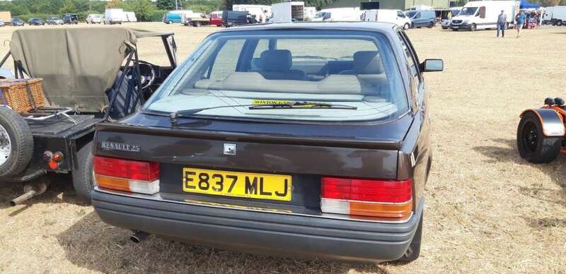

I wonder if this is the other 25 Monaco still on the road.
Spotted at Newark jumble in July this year

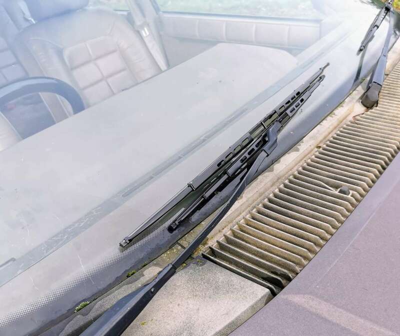

The wipers fitted were utterly shot, and *slightly* too small.
There was an 18" blade on the driver's side and 16" on the passenger side.  They should be 22".  The one on the rear was completely devoid of actual blade so that was swapped too.

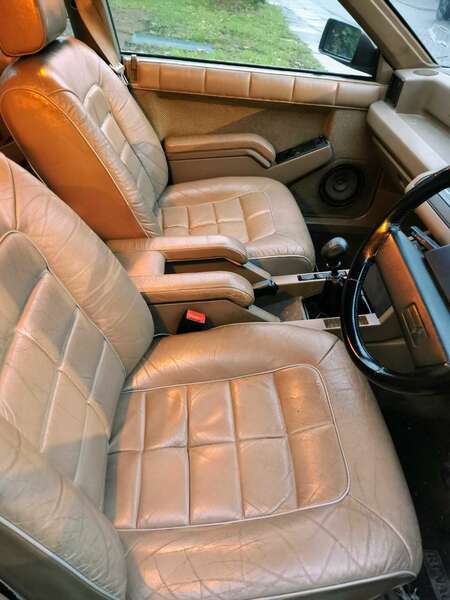

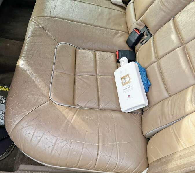

Also started chucking some leather conditioner at the seats as they've obviously not been cared for in forever.
Yeah, haven't seen them slurp it down that quickly on the first application in a long while.

Sadly the heavens opened just as I finished the first pass on the back seat.  There will likely be three or four applications needed before it's back to how it should be I reckon.

Edit: Got another dry five minutes so all leather surfaces have now had their first application of conditioner.  Already looks miles better.
Also means that the interior now smells exactly like my old one inside now.

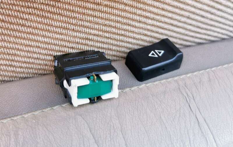

The central locking is now working reliably on three doors and the boot.  It's just the offside rear that needs manual assistance now - so simple lack of use seems to be the key issue there much as anything else.

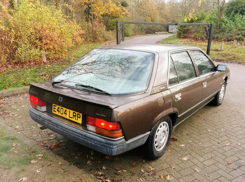

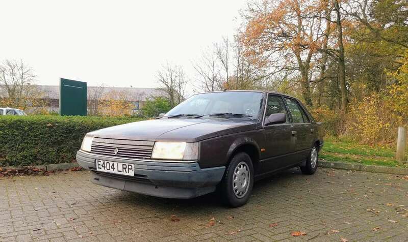

Also grabbed a couple of photos when I was out, slightly less horrible backdrop than our building site of a garden.
Does look a good buy.Amazing to find the right one so close to home that's up and running. Strangely, mine started life in MK. I hadn't noticed, but when I came to a Fod last year, Quicksilver soon picked up on it. I'm a bit jealous but I do like my automatic and can't imagine having to change gears. Sort of like driving a motorised three piece suite.
It was the realisation it was so local was one of the things which really spurred me into figuring it had to be worth a look.  The odds of one of such a rare care popping up so nearby were so small.  Especially when you keep in mind last time I looked for one was in about 2010, and the link to this popped up in a Telegram chat that I don't check massively regularly, so the odds of me even seeing the post there weren't great to start with.  By all rights I never should have found it.
It's a car which was plainly really intended to be an auto given how far away from you the gearshift is!  It's really not a huge chore though once you're used to it, especially as this engine is really torquey so it's not massively fussy about gear choice.  Plus there is a nicely satisfying growl from the exhaust around 3k ish.
The high velocity squidgy leather sofa school of motoring is something I'm a great fan of.  I greatly enjoy many other types of vehicle, but don't think I've ever come across another car which is quite so perfectly matched to just what I *like* than the R25 - Which I was already pretty convinced of when I had my first one.
Looks like a real French luxury barge. Look forward to meeting at FOD one day😁

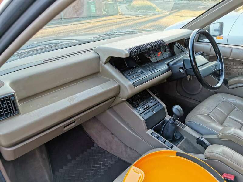

Sweet. Stereo works. Well, sort of.
Tape does anyway - which was probably the most important bit. Radio appears to be dead.
Neither the upper control panel or steering column controls do anything. So the radio *may* actually work, but this system as I recall has muting if off station, and the seek controls are on the upper control panel, not duplicated on the head unit itself so I can't currently try to tune into anything or switch bands.
Could it really be as simple as a dodgy connection or someone not having plugged things back in (I have an invoice for the 12V outlet having been rewired, so this will have been out to access that)?
Not holding my breath, but would be a nice surprise if so.
Also, yes it still sounds bloody decent, even on the original speakers, must have been absolutely epic back in the late 80s.

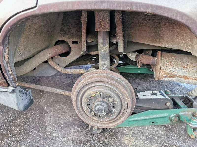

No particular horrors under here.
Drop links are definitely baggy based on how much I could wiggle them by hand.  So hopefully changing those will get rid of the rattle.

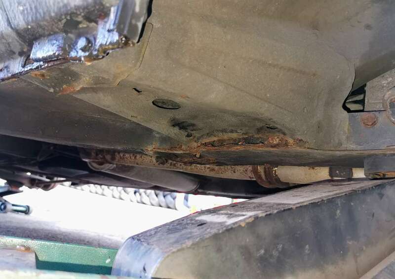

Looks like exhaust work will be in our near future.
Given how precise the routing of this system needs to be to make sure it doesn't foul on things and make a racket I rather doubt I'll be looking at eBay cheap specials for this.
To give an idea of this, note the routing in this area.
It runs about 2/3rds the length of the car in a channel along the nearside sill with about an inch of room to play with, then does that nonsense to wind itself around the rear suspension and chassis.  I can just imagine the amount of swearing involved in trying to fit that even with a perfectly accurately shaped system.
We did spot one bit of grot on the underside that I missed when looking at the car, though in fairness I'm not massively surprised.  I was concentrating mainly on the sills, areas around suspension and subframe mounts and the like.  The rest got a pretty quick glance over while I was trying not to get run over by passing traffic.
Really not too bothered to be honest.  Won't be too bad to sort that.  Most likely because someone has jacked the car there in the past I think, especially as the other side is spotless there.

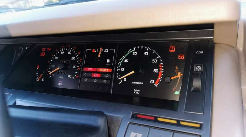

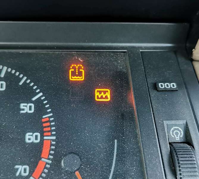

Edit: Hey look, the list of warning lights which are coming back to life is increasing.
First time I've seen that one show up for it's self test routine.  Does go out properly though and stays off while driving.  For those not familiar with the symbology Renault used, this is their answer to what became the check engine light.  Which on my previous 25 had a bit of black electrical tape over it.

Further to the photo of the engine management light earlier, I think we actually had a full compliment of everything we should see on startup earlier this evening (of course plus the sodding washer fluid light, we'll get to that soon as it's bugging the hell out of me).
We *may* still be missing a coolant temperature warning light, I'm not 100% sure if that should come on with the ignition.
Odds on all but one of them having gone back into hiding tomorrow?

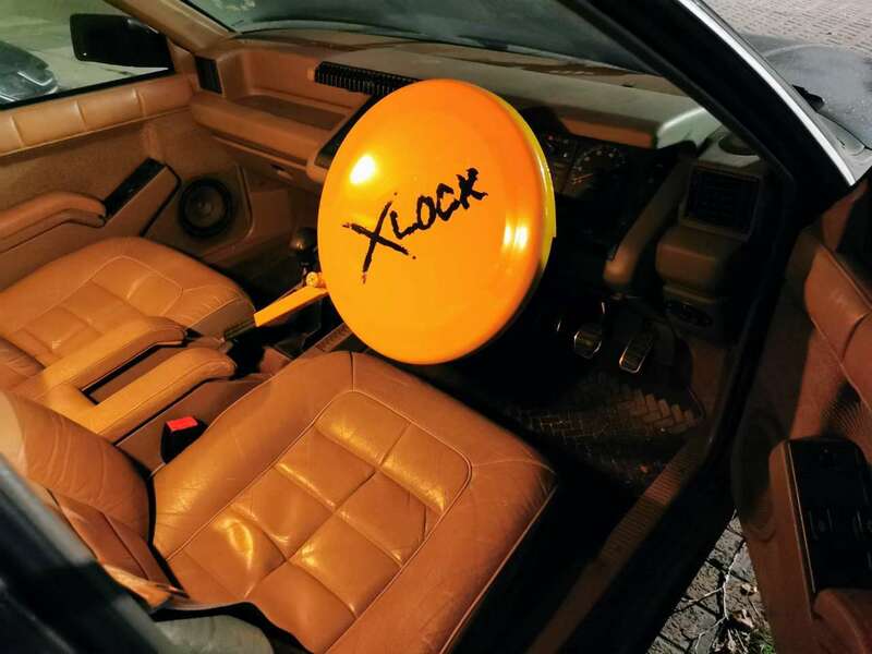

Also added a bit of equipment which I think may be indicative of my intentions for it to be a long term fleet member.
Given this car predates modern security measures and that the rarity factor means that whatever any payout from an insurer might be I'm unlikely to find another one it just seemed sensible.  Would have preferred an actual Disclock but nowhere locally stock them in anything but the smallest size which won't fit, so we'll make do with this.  May upgrade it at a later date.  To be fair it is mainly as a visual deterrent to some undesirable who might be looking for a quick joyride than anything else.  If a properly organised car thief wants something you've got it may as well already be gone.
Most other cars on fleet have either fallen under "has sufficient inherent security, hidden features I've added, or meh it's insured." Well aside from TPA, though she lives in the garage blocked in by two other cars so it's less of a worry there.  Really should get a wheel clamp before we go on any more overnight trips away I think though.

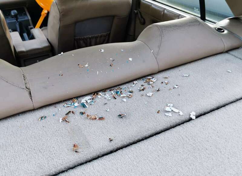

Sadly that's had it though and more of it lands on the back seat every time I close the bootlid.

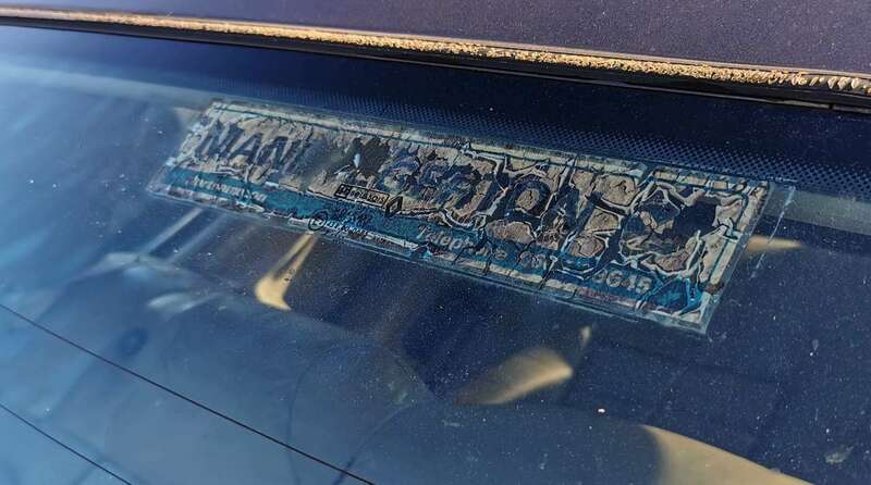

Only actual car related job I was determined to get done today was to make it so that I could actually see out of both the Caddy and Renault.  The Caddy had developed a horrible greasy film on the inside of the screen which I was reminded of every time I was driving into the sun.

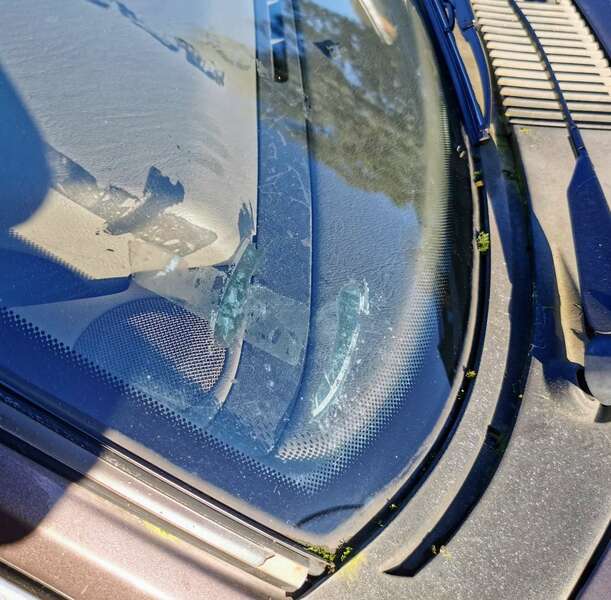

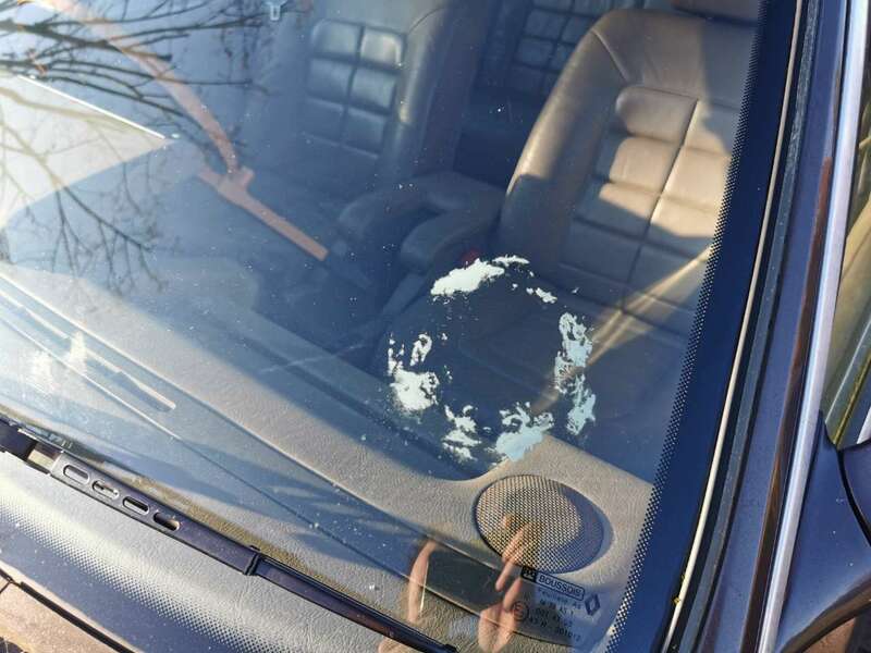

The Renault screen was just absolutely filthy inside and out.  Plus had these marks left from stickers etc in the past.
That one on the driver's side was an absolute swine to remove because of how close to the base of the screen it was.
Also removed what was left of the old dealer sticker as it was just crumbling away to nothing.
Then gave the car a really quick hoover to get rid of the bits of sticker than ended up everywhere and gave the dash a *really* quick wipe down.
I'll need to get the sticky stuff remover involved to try to get the tape residue off the dash above the glove box.

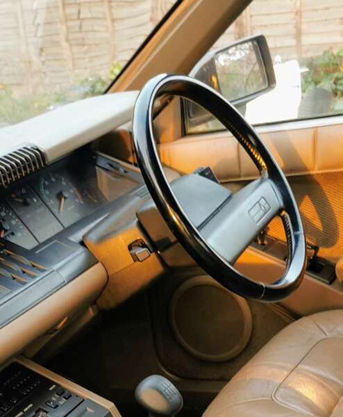

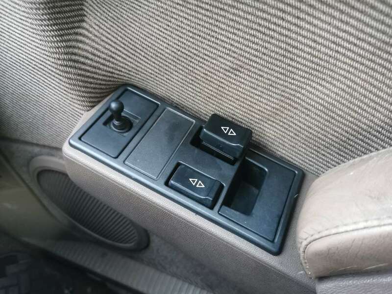

More surprises for me. Keep fit rear windows and manual mirror adjustment, same as my GTS.

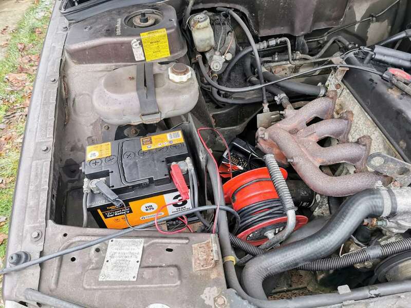

The battery in the Renault has always sounded a little low so I stuck it on the charger for a few hours.  Helpful to have this much open space in an engine bay...
Was showing as full within a few minutes, so either the battery isn't at it's best (given how little the car has been used that wouldn't surprise me - and it is a Halfords cheapie), the connection to the starter could be a bit better - though 80s Renault starter motors have always tended to sound like they're struggling to some extent in my experience.  I'll check the obvious candidates though just to be safe.

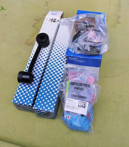

A package arrived which contains a set of lower ball joints, drop links and anti roll bar bushes.
Hopefully some combination of these things will deal with the knocking the current suspension is doing.  I'll be chucking the car at a garage for that though, sod crawling around doing stuff like that at this time of year.

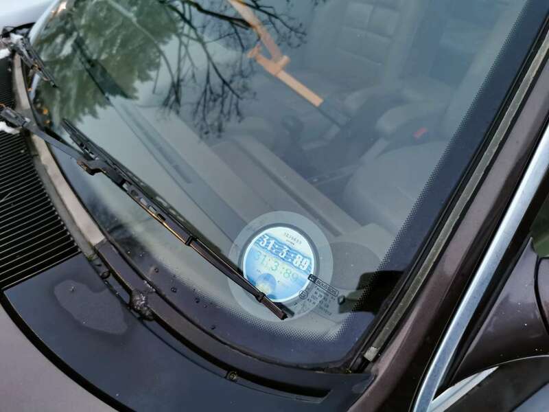

One small detail was added today.
Well nearly.  Turns out that the Amazon cheapie disc holders are apparently useless - especially when you're trying to fit them while it's -3C.  Think I need to get some better holders.
I know I don't need a tax disc, it just seems odd to my brain if it's not there, so I figure one with the month and year it would have had when new makes sense.

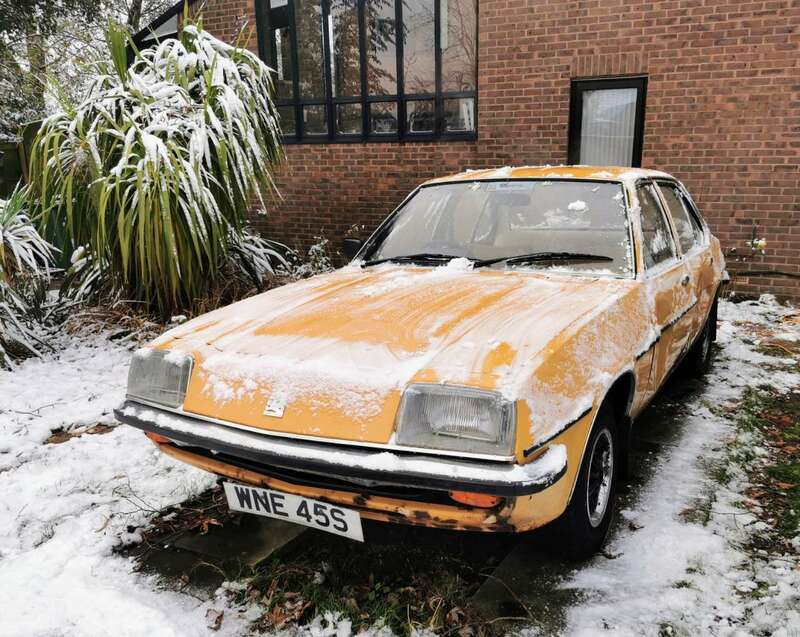

First task of the afternoon today was to brush as much of the snow off as possible and defrost the Cavalier as much as practical so the potential buyer could actually see it when they visited later in the day.
The potential buyer said yes, so it will soon be off to pastures new.  I'd have loved to see this one through, but I just don't have the room.   The R25 appearing meant something had to go, and that had been on my wish list for longer than the Cavalier.
She will be staying in the forum though which is nice.

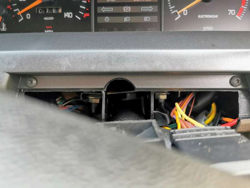

Some of you may have noticed on the interior photos that something is amiss with the steering column shroud on the R25.
Aside from bugging my OCD, it means the wiper and indicator stalks aren't quite where they're meant to be, and the back of the wheel scrapes the plastic when turning.
Given the ckear evidence of this car having been broken into (passenger front window has obviously been replaced and I've hoovered out a bunch of cubes of glass), I had a hunch that was likely connected to that event.
Yep!
Someone has had a really good go at breaking the steering lock - no idea if successful or not. The whole top of the column has been rotated to the left by the force distorting the mountings, meaning the ignition barrel isn't where it's meant to be.
That's a job for further down the line. I suspect a whole upper steering column from a breaker is going to be the way to go and bash the mount back closer to the right shape when the dash is apart. I rather doubt I can get things back where they want to be by applying unreasonable force in the opposite direction.  I just wanted to take a closer look today to see if my hunch was correct.
