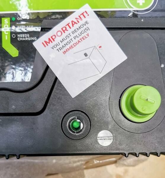

Huge box from Tayna Batteries arrived earlier.
That people, is how to pack a battery.
A good 3" of padding on all sides, foam wrap and double bagged inside that lot.  Took me the best part of ten minutes to dig my way into it.
State of charge indicator shows charged.
I note that the "remove label for battery maintenance" text has been removed from the label since my previous one was made.

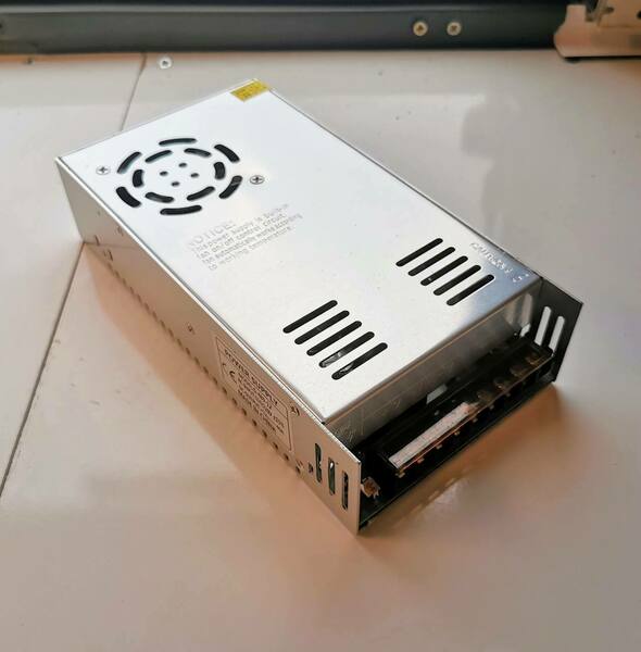

About an hour later another box arrived with this in it.
It seems to work at least, plus side it's got a manual adjustment for output voltage which means I can bump it up a little from 12V closer to what you'd expect to see from a charged 12V battery.
Not exactly hard to figure out how to hook it up.
Not exactly the last word in quality in the fit and finish department, but I can't see anything that rings any alarm bells.  For £22 delivered I've zero complaints.
I'll probably make some standoffs for it to attach to so it doesn't struggle for airflow - the fan draws in from the bottom and sides so if I mount it flush overheating might be an issue.  Not that it will generally be running anywhere close to it's rated capacity for any period.  I'm also going to be mounting it to a vertical surface (probably rear wall of the "electrical locker" as I refer to the rear of the space under the sofa/bed) so if we ever have any issues with water ingress through the outer hatch just forward of that area it should be kept well and truly clear of it.  Just seems like a sensible precaution...the old school transformer and linear regulator setup would be rather more forgiving of damp than a switch mode supply like this.
Need to engage my brain a bit with regards to wiring things up, but pretty sure I can get an automatic switchover sorted out with a handful of components and some brainpower...quite possibly a single double pole relay could do it... Absolutely sure I can do all the switching on the 12V side...mains can just be left "on" to everything permanently (I'll incorporate a switch anyway for service purposes, but you get the idea).

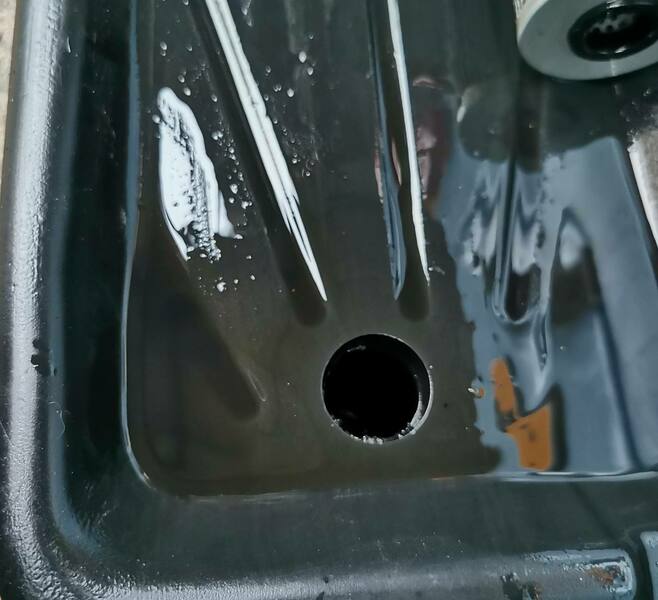

Oil dropped from the S123.  Pretty much the same as previously seen as I more or less expected.
Looks like the filter has picked up a bit more detritus, but I was expecting that following the head work.
New filter element in.
Really do appreciate this being a car it's dead easy to do an oil and filter change on without spilling a drop.
I'll leave this in there for a couple of hundred miles and then do another check - hopefully we'll see at least a reduction in the amount of glitter then.

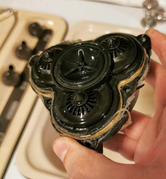

That is the coupler which should have the hosepipe on one end and be fastened to the pump itself in the pressure washer at the other.  It has detached from the pump.
When it did this it did so with quite some force, launching itself a good portion of the way across the driveway.  It was still attached to the hose, and now no pump body...so was essentially a free running hose with just enough of a restriction to ensure a decent jet of water was being sprayed.  Of course it then took off like a racing snake across the garden, taking me a good thirty seconds to catch it, while getting utterly drenched (it was between me and the tap to cut off the water supply).  A poor innocent passer by also got thoroughly soaked during this event unfolding...I don't think I've ever been quite so embarrassed in my whole life.  Thankfully they saw the funny side of it, which I count as hugely lucky.
Unfortunately the *reason* it launched out of the front of the pressure washer is that a chunk has broken off the pump casting itself, so there's no tab there any more to hold the clip which should hold that plastic part into the metal body.  Of course it's the metal (aluminium) bit that has failed rather than the easily replaced plastic part.
That is now two identical pressure washers I've had where the metal pump casting has failed...first one cracked, dumped the gearbox oil and eventually catastrophically failed as a result of loss of lubricant.  This one has had a large chunk of it just break off without any obvious cause.  I mean the second one was a freebie replacement from a forum member, but it's disappointing that there seems to be a definite quality control issue there with that part.  It also means I can't cobble together one working one out of the two as it's the same part which has failed on both of them.  I wouldn't be so surprised if this was some generic cheapie or a Karcher, but I tend to expect better of Nilfisk.
So now I once again am in the market for a new pressure washer.

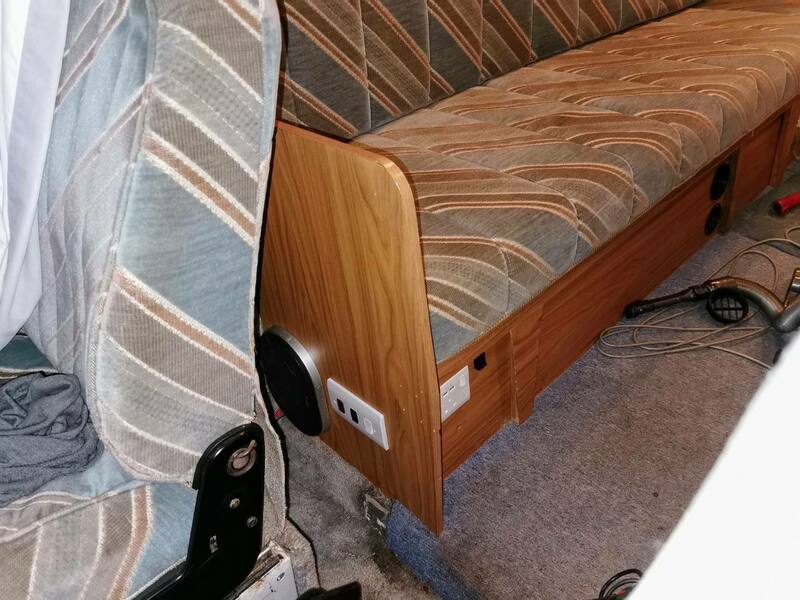

There aren't a huge amount of places I can really put them without adding in unsightly surface mount boxes, the obvious spot being in the forward facing sides of the seating/lockers immediately behind the cab.  I'm loathe to go cutting holes in things...but improving audio is high enough on my list I'm willing to do it.  If some future custodian really wanted to undo it, at the end of the day it's just two panels of plywood laminate they'd need to replace.
Nearside is easy enough.

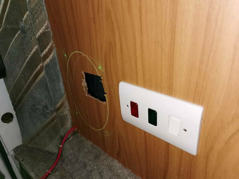

Offside I realised was going to be trickier on account of me already having installed hardware in that area in the form of the inverter outlet and switch.
Right in the way.
New plan...move the outlet and stick the speaker here.
That bundle of wires you can see there is on my list of bodges I inherited with the van I hopefully will get rid of shortly.  I'm planning to vastly simplify the DC wiring when I add in the new power supply and charger setup.  Currently every circuit has its own feed all the way back to the battery, instead I'm going to install a beefy cable to a distribution point in the locker right next to the power supply, where it can then split off to the relevant circuits.  The current setup is just a mess, for all I have removed quite a lot of bodgery compared to when I first got the van.
I hadn't been in the nearside locker for a while...like in a couple of years.  As evidenced by there still being a mains fan heater in there... I've had working heating since sometime in 2019!
It will come as absolutely no surprise to anyone who has ever been unfortunate enough to witness me undertaking anything resembling carpentry that things pretty much immediately descended into farce.  Eventually we got to this point.
You are not getting to see what's behind the panel.  It is seriously ugly.
The other side first required me to remove the socket, but followed a similar theme.
Likewise, you're not getting to see the carpentry.  Especially as a fair portion of it had to be done by hand as I couldn't get in there with the jigsaw.
I'll reinstall the socket shortly, probably directly under the switch.
I may go back and add a cover of some sort behind the speakers, partly as protection for them and partly to hide my absolutely hideous carpentry.
Will be curious to see how this sounds - has to be an improvement over the tiny dash mounted ones though.   No I've not discounted the idea of adding a sub in the future.  That's a job for the future though.  Would really like to get some better ones actually in the cab too, though that's difficult without actually cutting holes in metalwork which I'd rather not do.

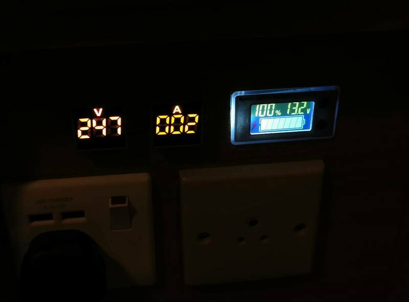

Last job for the day was to give the new power supply a test run.  With everything on and the heater in preheat mode and the leisure battery disconnected the line voltage stayed rock steady at the voltage I set it to.
So looks like that will do the job just fine.  The fan speed is load dependent, but even at full chat (well, the loudest I've heard it anyway), it's just a distant bit of white noise once the locker is closed.  Definitely won't be objectionable for the intended use.
The little round pin socket, before folks ask is a DC outlet.  Only thing I generally use it for is the water transfer pump for filling the onboard tank from the portable one.  Though as part of the electrical improvements I might install a cigarette lighter style outlet in the locker so I don't need to run in and out of the van during the filling operation.

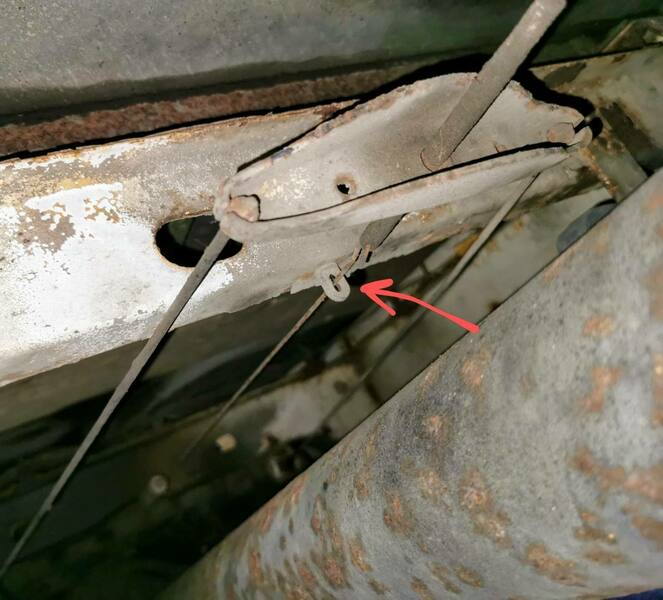

While crawling around I had a hunt for something which has been bugging the heck out of me since the day I bought the van - an extremely annoying rattly buzz (or buzzy rattle) which appears whenever the engine gets anywhere towards the top end of the rev band.  Which equates to any road speed above about 55mph.
Finally tracked down the bugger.
Precisely what to *do* with this information I'm not 100% certain.
For now I've stuffed a couple of cable ties in the hole to make it a bit smaller and slathered it in grease.
We'll see if that's made any difference whatsoever tomorrow.
I'll need to see if I can find a parts diagram to see if there should be something else there - it feels like there should have been a rubber boot or something to prevent this being an issue - as it seems like it will always have done this.  I know mechanical refinement was never really the top of the priority list for a vehicle like this, but a noise as maddening as this surely never would have been considered normal.
EDIT: Thinking about it, what I'll probably do is find a small spring and hook it around the return cable (the middle cable there is attached to a spring and is what pulls the handbrake off) and that hole in the chassis cross member above it.  Game will be finding one that's strong enough to stop it bouncing around but not too strong to interfere with the smooth operating of the mechanism.

One issue I noted while out last week with the van was that the freshwater pump had sprung a slight leak.  The leak was tiny, however it meant it kept losing prime.
A bit of digging found a seal kit for £30 odd but couldn't actually find any in stock...or for literally £7 more...
Whole pump, delivered in less than 24 hours.
Made in Mexico rather than China which these days is a bit of a surprise.
Also picked this up from Mercedes.
Which is a heater control valve for the S123.  I noticed while doing the head work that it was weeping a tiny amount from the driver's side temperature control spindle when it was moved.  Only a tiny leak, but that's the sort of thing which I always reckon it's smart to do *before* it becomes a big problem.  Still quite surprised to see dual zone heater controls on a car this old.  Especially one without A/C even having been specified.
Old leaky water pump... I'd forgotten the pipework in here was still such a mess.
Old and new next to each other to make sure everything matched up.  Yep, aside from the label they seem to be identical.
The silicone sealant oozing out between the two halves of the pump casting suggests to me that someone has had a shot at sealing this up before.
New one in, correct way up this time round.
Needs a bit of tidying but is working fine... reckon the old one had been struggling for a while as this now primes several orders of magnitude faster than the old one and provides a much smoother flow.

The old water pump had definitely been got at with silicone and instant gasket.
Old pump was rather full of gunk, evidenced here by what was built up on the pressure switch.
Eww.  Kind of glad I pulled it now...definitely think the system will be getting rather more aggressively treated this year as I don't want that stuff growing in there.

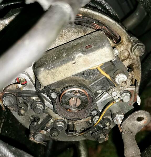

Right...time to quit putting it off, the alternator needs sorting on the Jag.
By the standards of this car it's not actually too bad to get to.
Though of course that oil cooler line set is in just the wrong place so makes things a bit awkward.
Said oil cooler lines will also make actually removing it from the car interesting as I don't think the alternator will fit past them.
Step one obviously was to disconnect the battery.
Doing any work on this system without that would be a recipe for disaster.
Not all that many connections to it.
Those two little screws required a bit of digging around to find a suitable tool for, I believe they're a BA size.
Back cover off meant I could get a better look, albeit via the camera as my view was of course obstructed by the aforementioned oil lines.
I ended up removing the brushes complete with the regulator (rectangular silver box above centre frame).  Had to cut one wire as I couldn't for love nor money get this bolt to come out.  That black wire is attached to a ring terminal.  If I can't get it out I'll solder and heat shrink the new parts on to it.
There we go.
Compared to photos of new brush sets for the Lucas A115 alternator the brushes don't look *massively* worn, but there's a good 5mm difference between the two which can't be good I reckon.
Equally suspiciously there are signs in the potting compound that at least some of the magic smoke has escaped.
A new regulator isn't expensive and it would be silly not to replace it given the situation.  Especially as the alternator has been obviously weak as long as I've had the car.
Guess we'll see when it goes back together again!  *If* I can figure out how to reassemble it!

New brushes and voltage regulator for the Jag's alternator arrived today.
Comparison of the new and old brushes shows there definitely was a fair bit of wear to them.
Now getting this thing back together is definitely up there on the "Jobs I never want to even entertain the idea of ever doing again" list.  What an absolute faff.  Trying to get the brushes, the springs, the insulation pad and the screws all back in place - especially bearing in mind that the forward brush retaining screw *also* secures the regulator (which wouldn't just sit in place) was a massive headache.  It would have been fiddly and annoying and tried my patience on the bench, but trying to do it with the alternator in situ was a massive pain.
Eventually though we got there.
There's one missing securing screw for the plastic cover because I dropped it.  I'll have a dig around tomorrow with the car moved and see if I can find it.  If not I'll just have to find another one that's roughly the right size.
Have to admit I was slightly nervous when I hooked the battery up given how much of this job I did blind.  However after a couple of minutes nothing was on fire or trying to be on fire...so I upgraded to turning the ignition on.
Ignition light works...that's a good sign as it means we must have continuity through the brushes.
After starting up we initially had a bit of erratic behaviour but this wasn't entirely unexpected as the brushes will obviously need to bed in against the commutator.  After a 20-30 minute run round in circles though things looked healthy enough.  So I was brave enough to go get some fuel...which at the current prices stings a bit in this car.
That's from around 1/4 a tank.  Nowhere close to warning light territory.  Ouch.  That's probably good for around 200 miles on a good day!
After that trip we were showing this on the gauge, at idle with the headlights on.
Which actually equates to...
... because the gauge reads a little low.  Previously this would definitely have dropped off charge under these circumstances, requiring the revs to be held up over 3000rpm for a couple of tens of seconds for the charging system to wake up again.
It still struggles at idle with the headlights on, rear screen heater and heater blower on high...but given it's only a 55A alternator I think that's not necessarily a concern, as soon as the revs are brought up to 1200rpm or so it comes up to an acceptable range.  Not sure what the rated running current is, but I'm pretty sure that *each* blower motor is fused at 30A.  So assuming around 20A flat out, there's a fair old chunk of the rated output on the heater blower alone!
I need to make a few errand runs tomorrow so will take the Jag for that and keep an eye on the performance of the charging system.  Fingers crossed this stays fixed as I REALLY don't want to have to mess with the alternator again!
