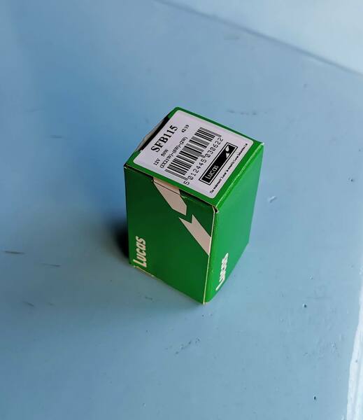

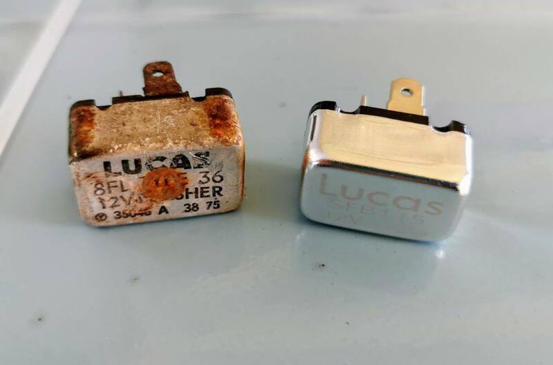

Package arrived this morning that I'd honestly forgotten ordering.

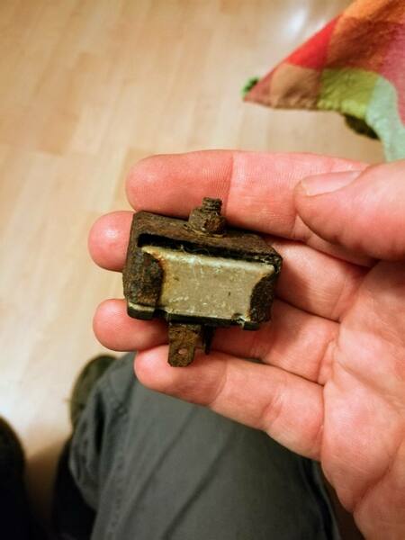

I had noticed when out in TPA after dark that the indicator flasher was struggling when I had the headlights on.  It was fine otherwise, but once the headlights were on the indicators basically just stayed on constantly save for the occasional blink every 40 seconds or so.
I was honestly astonished this thing even worked bearing in mind it looked like this when I found it back in KPL!
I'm pretty sure I shook a not insignificant amount of water out of it too.
New one was all of £3 from eBay.
Indicators now flash even without the engine running with the headlights and brake lights on, so looks like problem solved.  It's still a thermal flasher though so we should still get the old school variation in flash rate depending on system voltage (and ambient temperature) we're used to.  The old one has been stowed in the "tired but serviceable" spares box.

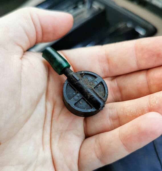

Next task was to refit the wiper mechanism to the Jag...having checked that it was still behaving properly after I reassembled it (it was).  This went fine right up to the point at which I snapped the hose barb off the check valve for the windscreen washers.
I uttered some quite unprintable things when that happened.  No huge problem, replacement was all of £2 from Motorserv, but it was just annoying.  This has been one of those jobs which has just been determined to take as long as possible.  At least once I've got that fitted I can properly bolt the scuttle cover grill back down and hopefully forget about that for another couple of years.

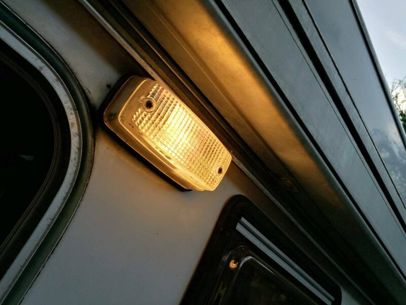

While I was putting things away I stumbled across an LED P21 retrofit bulb I discounted using for actual vehicle lighting a while ago and realised that I did actually have a good place to use it.
That's far more useful than what used to be in there for a fraction of the power usage.  We've found we do actually tend to use that light quite a bit in the evenings in the summer if we're sitting under the awning and/or when tidying stuff up.  So having actually useful output from it is definitely a bonus.
This is a pretty accurate before photo if you were actually looking straight at it.

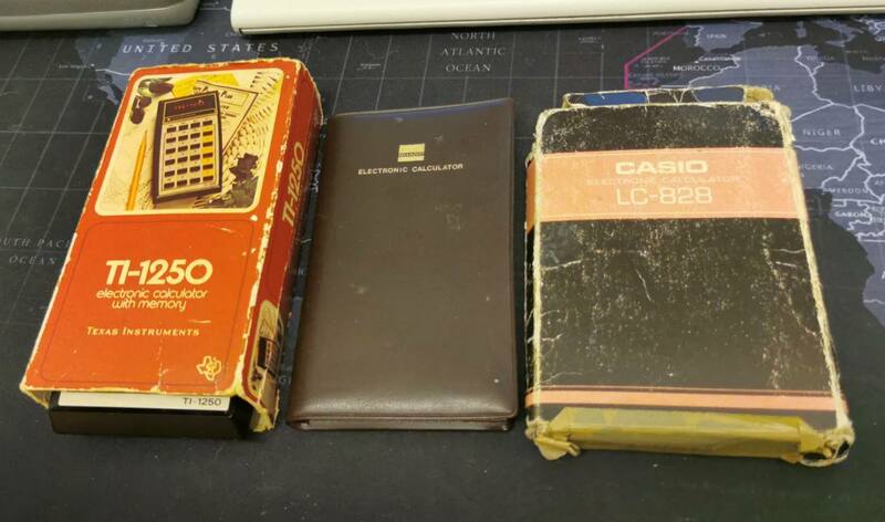

There was another little vintage electronics care package waiting for me on the doorstep this morning.

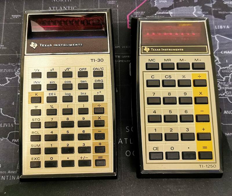

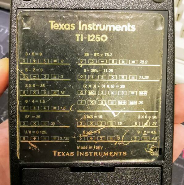

First up, the Texas Instruments TI-1250.
This was a low cost calculator dating from 1975.  The TI-1200 (which I have one of already) is identical but doesn't have the memory functions - well...it actually does.  It just doesn't have the buttons fitted!.
This one is pretty much immaculate.  The only visible wear anywhere is on the label on the back.
Here it is next to my TI-30 for scale.
Nicely this one seems to be mercifully free of the key bounce issues which plague both my TI-30 and T-1200.

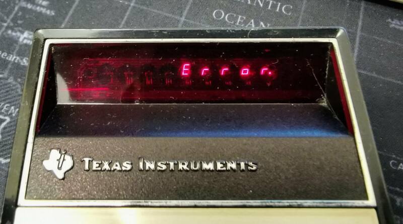

It's noticeable that this doesn't have the "screensaver" mode that the TI-30 does which blanks the display aside from a single chasing dot to save battery power.  Also when the TI-30 encounters either an error or an overflow condition it actually prints out "error" on the display like so...
...Whereas the TI-1250 simply flashes the whole display to signify such conditions.
This display is also about twice as bright as the TI-30.

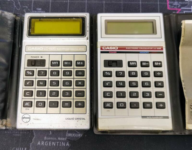

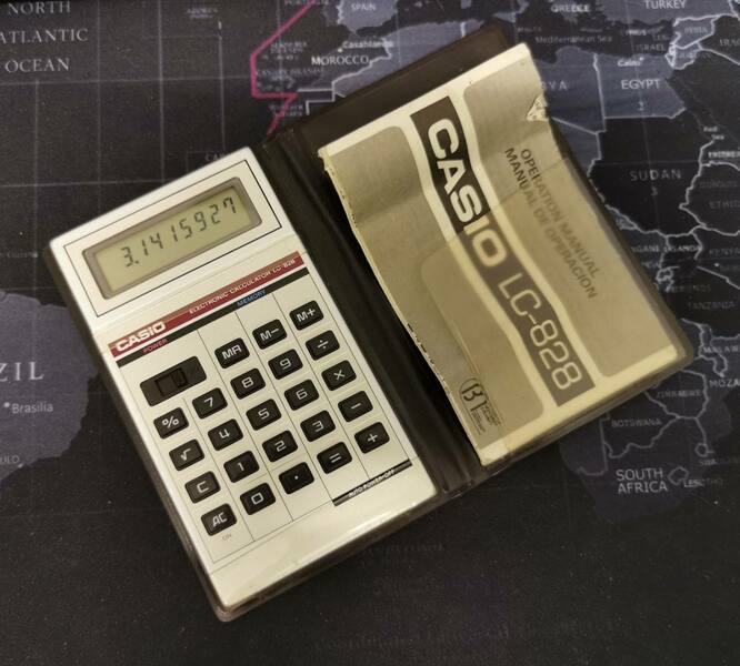

Next up is the Casio LC-828.  Again still with its admittedly rather battered box.
While the box may be battered, the contents are immaculate.

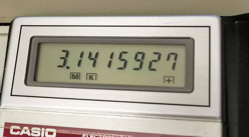

Launched in 1985 this is a carbon copy of the LC-826 from 1979, simply using more modern LCD technology allowing the yellow filter to be dispensed with and with the case graphics having had a slight refresh.
Display seems to be identical even down to the border around the function symbols.

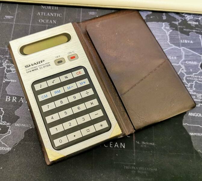

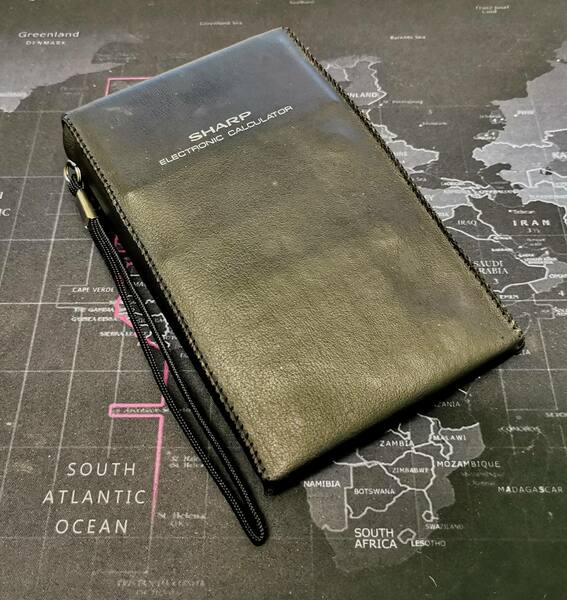

Now for the main reason I grabbed this little trio though, the Sharp EL-8130A.  I'd not seen one of these before.
First impression on picking this up: "This feels expensive."
It basically feels like a solid slab of brushed aluminium that someone has just carved a calculator out of.
I was expecting this to be mid 80s...but a bit of research shows this to date from 1977-79!
Look how thin it is!
That's 0.5cm right there.

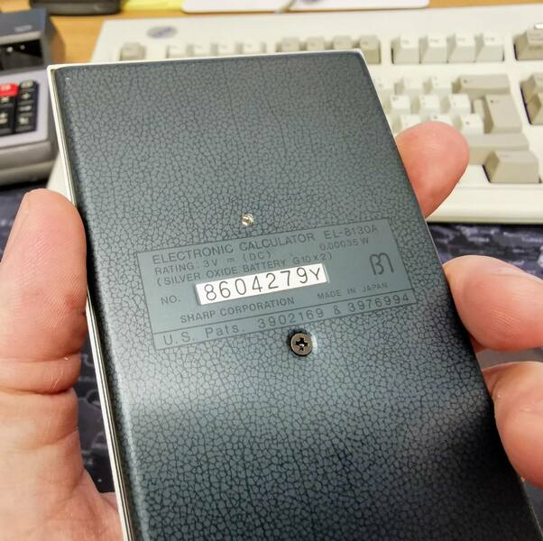

Even the texture printed on the rear of the case looks classy.
Guessing from that serial number this one dates from 1979.

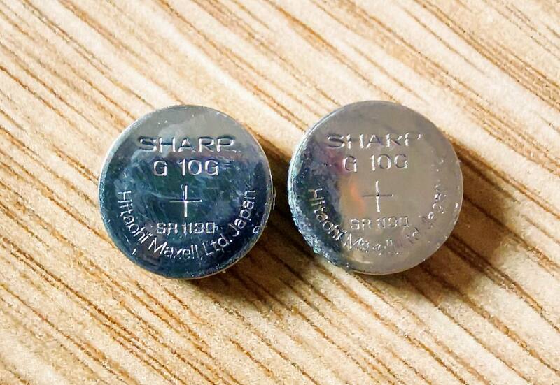

I'm waiting on batteries to arrive for this before I can test it, though I've confirmed it does work.  Still had the original (very dead) batteries in, being Sharp branded they're almost a museum piece in themselves.

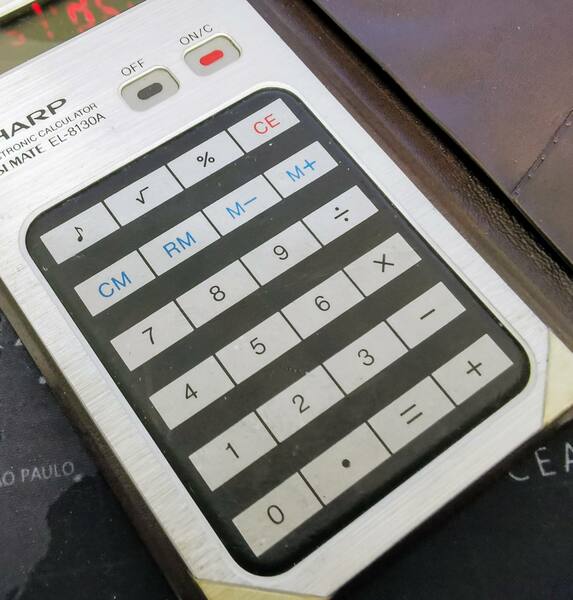

The flat panel keypad looks just like your typical touch sensor, but has an almost leatherette sort of texture to it and does deform just enough to know you've actually pressed a key - miles better than that Tandy (Casio made) PDA I got hold of last week!  It also has the option for a keypad beep, which with any membrane keypad seems a sensible option to have.  Turning that on or off is what the key with the musical note on is for.
An interesting little time capsule from the era where there was a distinct race between makers to create the thinnest possible calculator.

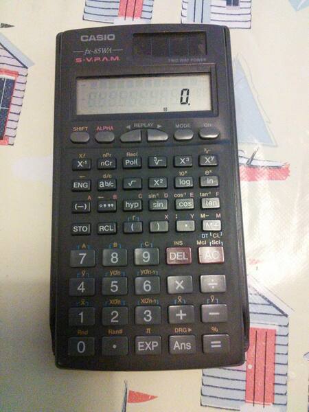

I think the oldest calculator I have is this Casio, from the late 90s. I had a fx82  or two before that at school, but I think it got nicked by a classmate*

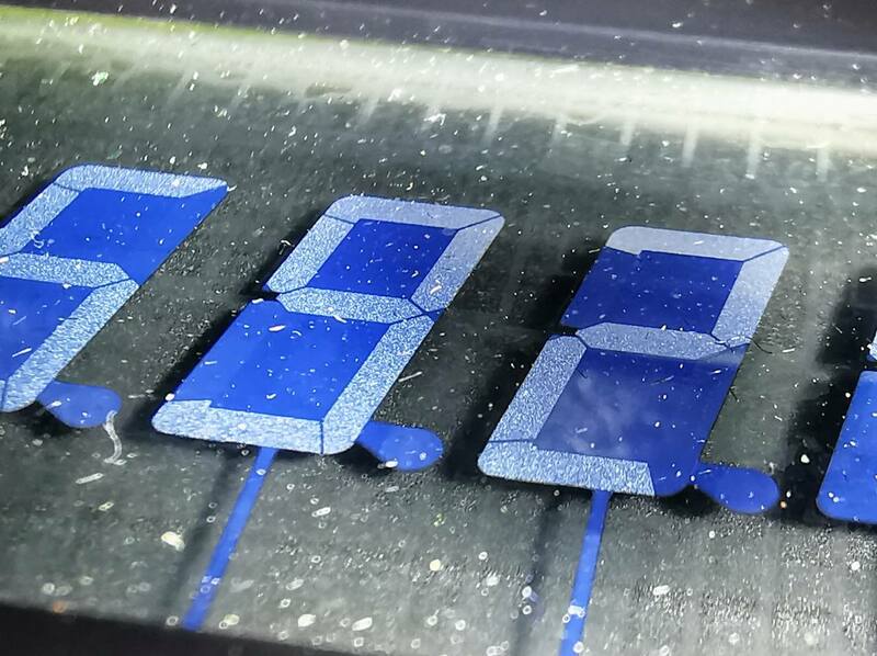

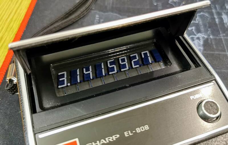

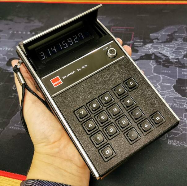

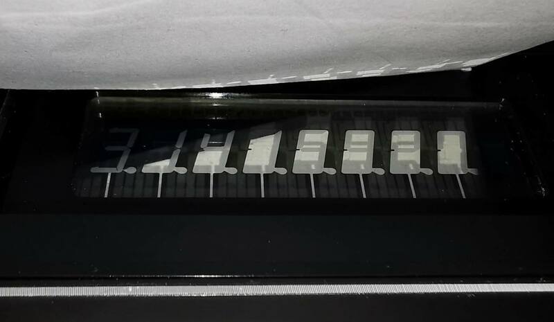

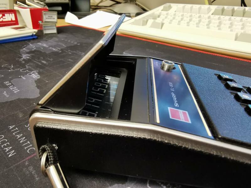

Okay... I'll really need to reign in the vintage tech acquisition a little, but have one more on the way.  Most notable in that this allows me to tick off another display technology - in this case one I've never actually seen in person so far - one of the first generation DSM LCDs.
I never even realised they were so functionally different to "conventional" LCDs in their operating principle...I just assumed they had the polariser flipped.  Never realised the digits were actually opaque when powered until a couple of days ago.  Will be really curious to see it.
Yeah, something with the Itron display is probably going to be next on the list I'd think.

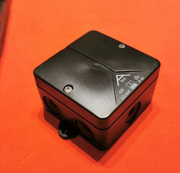

- Need to tidy up the distributor.  I'm just going to get a small enclosure and mount the condenser externally.  The replacement I've fitted is far physically larger than the original.  It'll be painted to match the engine cowling so you wouldn't know it wasn't just meant to be there.

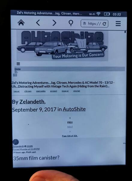

19 hours ago, PhilA said:
35mm film canister?
Probably just going to use an off-the-shelf IP65 enclosure.  Will be a bit bigger than I need but it'll do the job and will be a lot easier to mount securely.  If I position it on the nearside chassis rail it'll disappear as that's where the battery, start solenoid, coil, voltage reg etc all is anyway.  I *really* want to fit a remote starter switch in the engine bay as well so may well use the same enclosure to house that.

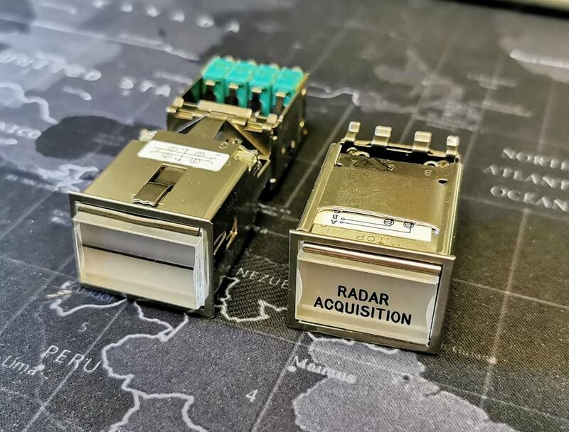

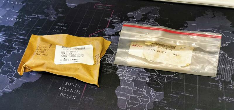

Finally had a package from the US arrive today - which was posted well over a month ago.
This was a very random purchase from a while ago which very much appealed to my inner geek.

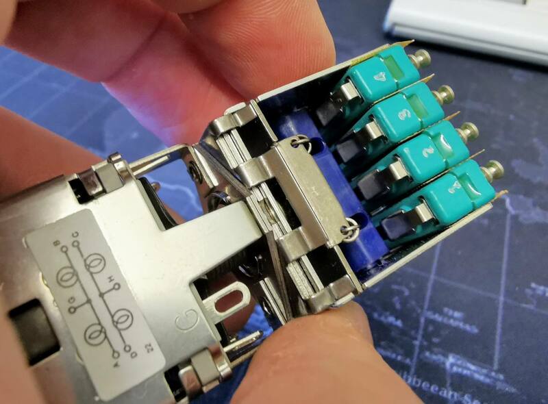

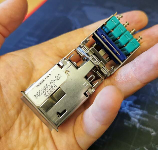

These bags contained these bits of hardware.  One switch and one indicator.
While these are both from the 80s I believe, the designs haven't really changed hugely since the 60s.
The number of components in this thing for a four way latching switch is absolutely ridiculous.
From an engineering perspective it is simply a thing of beauty and a joy forever.
Now need to figure out something to do with it...Probably a master power switch for my workstation as I can use the split indicator (one side is red, other is green) for something useful then.
Yes, those are the same style as used in the Nasa control rooms from the Apollo era onwards (these are a slightly later style, but very similar).  The one labelled Radar Acquisition is actually made by the Master Specialities Company who produced the original Apollo era kit, the unlabelled one is made by Unimax, but they're a very similar setup.  Main differences are in the panel mounting method and the exact design of the ratchet used to latch it.
I've always been a major Apollo enthusiast, so the moment one of the YouTubers I follow identified what the switchgear in the old MOCR (which everyone calls Mission Control) actually was I was on eBay hunting stuff down within minutes.
The seller I got this pair from has THOUSANDS of mil spec bits of switchgear and instrumentation in their eBay shop - I could quite happily have spent a small fortune in there as it's basically an entire shop full of stuff I WANT.  I have precisely zero use for 99.993% of the stuff I'd buy, but that doesn't stop me wanting it!  The only thing which saved me from going utterly overboard was that postage costs a small fortune from the US these days.  If I'm ever in that area in a future visit to the US though you can absolutely guarantee that probably half my luggage will be full of stuff from that warehouse.  I will seriously be like a kid in a sweet shop.

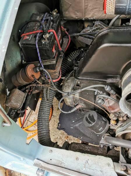

Nothing huge to report today, but the enclosure I'll be putting the distributor condenser on the Invacar has arrived.
Nothing fancy, it'll do what I need it to just fine though.
I'll probably tuck it away underneath the battery tray in the engine bay so should disappear once it's in place and has got a bit of dust and grime covering it.

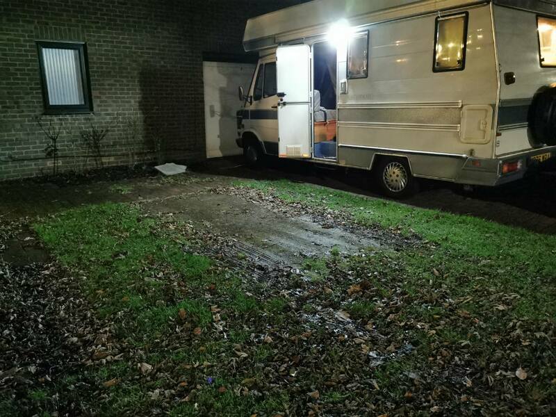

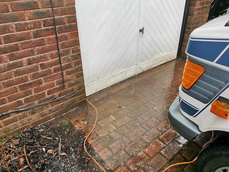

Nothing to report car-wise today thanks to the non-stop rain.  Aside from nervously watching as the run off from the driveway made it into the garage - thankfully only by a few inches.

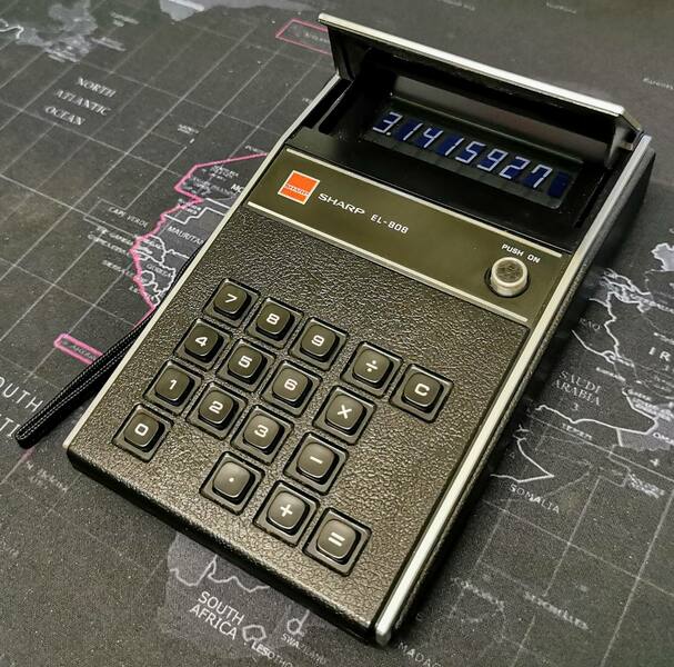

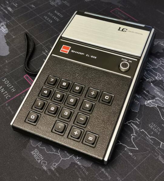

Did have the last arrival I'd been waiting for in the old tech category for now though.
Didn't spot from the eBay listing that it still had the original slip case, that's always nice to have for something in the collection.
At a glance it's just a very basic four function calculator, by 1972 when this dates from that really wasn't anything to write home about.  What was the standout feature of this example though was the display.  This was as far as I'm aware only the second model commercially available which made use of a liquid crystal display.  Though it's not quite an LCD as you know it (unless you're into this sort of stuff...though even then I'd not seen one of these in person until this evening).
So it's got the light/dark flipped...what's the big deal?
Oh no...It's much more than that.  This is a DSM LCD - or Dynamic Scattering Mode LCD.  The Twisted Nematic LCDs you're used to seeing work by changing the way the polarise the light depending on whether a segment is subjected to an electric field or not.  These are very, very different.  For a start, no polarisers anywhere here.  The way these work is that in their rest state they are completely transparent, however when current is passed through a segment here the crystal structure is disturbed so the segment becomes opaque, taking on the appearance of frosted glass.
The way Sharp used this actually to place the display segments in front of a mirror.
The inside of the hood on this calculator is lined with a black felt which is what the mirror behind the display reflects so as to give a good visual contrast.
It's a challenge to photograph clearly!  However the display is every bit as clear as it looks in the photos.  The really interesting thing is that if you look close enough you can actually see a sort of shimmering effect within the LCD segments due to interference patterns set up within the crystals.
There are far less decent photos of DSM displays out there than I expected, so here's a few.
That's where I've slipped a bit of paper in between the hood and the display so you can see how the digits actually do appear like frost on the mirror rather than anything vaguely resembling the appearance of any other type of display I've ever seen.
That almost retroreflective like texture on the surface of the digits isn't a camera artefact - it's not static either.  The digits do actually shimmer very slightly whenever the display segments are powered.  It's quite beautiful to observe through a powerful macro lens.
I'll need to do some experimentation with a macro lens and natural light to see if I can do better.
A video showing some absolutely gorgeous super-macro video of these displays in action can be found here though:
On a completely unrelated note to display technology, which is why I bought this thing...Is it just me, or does this thing seriously look like an Original Series Star Trek tricorder?
The quality of this thing is worlds apart from anything like this nowadays...Absolutely everything about it just *feels* expensive and just oozes quality.

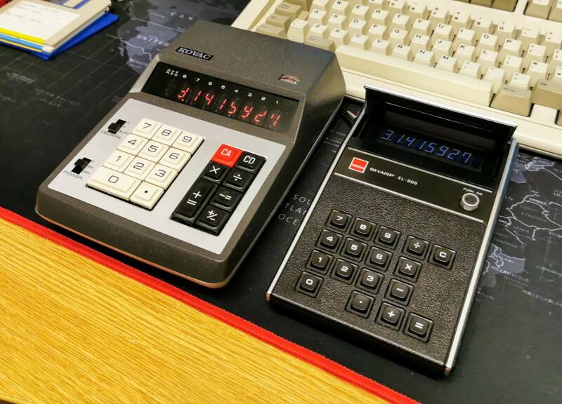

Quite a bit smaller than I thought it was, here's it next to the Kovac which turned up a week or so back.
Yeah, this one is going to be staying on the desk full time I think.
That pretty much gives me *nearly* full coverage on display technology now I think...
[] Nixie: Check.  Fine, it's a benchtop multimeter, but Nixie calculators are EXPENSIVE.
[] Panaplax: Nearly...The Kovac has a segmented neon display which is nearly there.  The only calculator I'm actively looking for just now does have a Panaplax display though.  Compucorp 324G or similar if you happen to have one floating around...
[] EL: No...Though I don't *think* anything as small as a calculator has ever used an EL display.  They were more of a competitor to plasma displays in the early days of laptops I think.
[] LCD: All three generations, check.

Yeah I too wonder if I had seen some without realising it, since as you say they look a lot like just an inverted LCD at first glance
and yeah iv not looked into it, but thats one of the reasons I mentioned those windows I cant think how else you would do it!
but that does remind me tho, do these count as their own display tech? (and did anyone make an E-Ink calculator? LOL)
Interesting question... I'm not *aware* of one.  Though I know Motorola did produce at least one mobile phone which used an e-ink display.  I'm sure someone will have used one in a calculator - though these days probably out of novelty or because an OEM in China suddenly found they had suddenly ended up with a surplus of 100,000 displays because of an ordering balls up, rather than as a demonstration of technological prowess as with the first LCD calculators.  Only thing I can see working against them would be bulk as e-ink displays are a lot deeper than an LCD - the two devices I've had to bits with them in (Kindles in need of battery replacement) have had displays that were about 5mm deep, so pretty much on par with a TFT panel.
Never had a chance to play around with those memory LCDs, though I did look into using one for a project years ago.  It just didn't make sense though unless the display spends a huge amount of time static as the power required to actually flip the state of each pixel was higher than for a bog standard TN display - for which the power requirements are pretty much negligible anyway.  I'm sure there are applications where they'd be very well suited though.
I *think* the memory LCDs are sort of a hybrid LCD/electrochromic job...but we're talking memory from me rummaging through datasheets back in 2005 or earlier...so I'd suggest having a poke around Google and see for yourself.

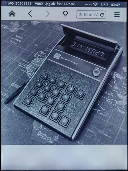

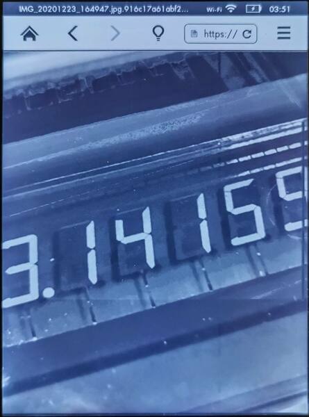

...Just because it appeals to my sense of silly...have a a picture of a DSM LCD displayed on an e-ink display.
No huge surprise the browser doesn't render this site too well...
To be fair it was always buggy as hell, and that was back in...2007(?) I think when I bought this thing and I don't think they ever updated it!  Only thing I've ever used it for was downloading files over the local network anyway...WiFi is never on otherwise.
