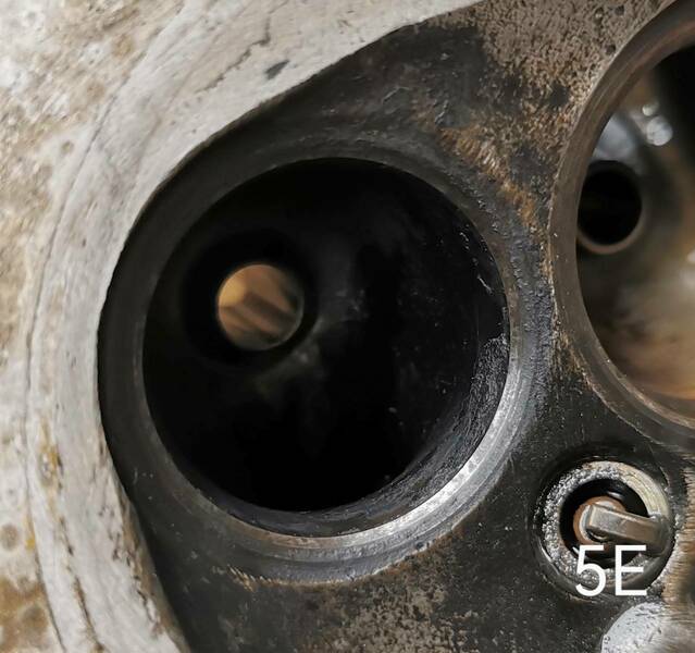

Cylinder doesn't look too bad.  Little tarnishing on the top of the bore about 3/4 up the stroke, but nothing drastic and no scoring of note.  I sprayed the area down with oil before I left it yesterday and where it had pooled in that cylinder it wasn't draining down any quicker than the other three.
That exhaust v/v looks like an obvious culprit; a new valve and bosh it back together, no need to make work given the other compression readings were fine.
Paraffin for leak down testing. Very low surface tension and will leak past any imperfections.

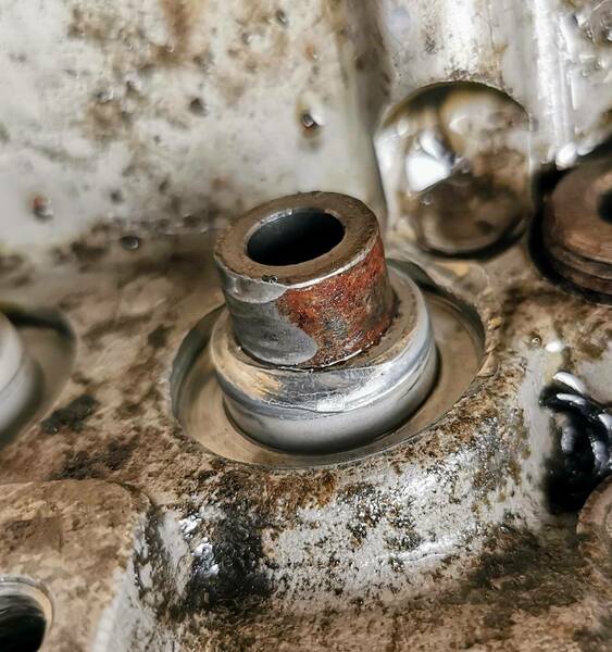

From memory the engine shouldn't have any stem seals, the machining was accurate enough and the stems aren't in a position to let oil pool and subsequently be drawn through. I believe there's an aftermarket kit that allows you to put seals on but I found I lost much more oil past the crank nose seal and past the rings than via the valves.
Those O rings are doing nothing and do not belong there, beside potentially breaking up and getting into the oil.
Check the valve stems for true, you never know who's been monkeying around in there over the years. For the price of new ones it may pay just to get a set of exhaust valves, they lead a very hard life. If that one's as pocked as it is, I'm guessing it's drawn something into the engine in the past that it shouldn't have. I ounce dropped a grub screw down the carburetor as the engine was running- luckily it came shooting out the exhaust pipe... don't make adjustments on a running engine, I guess.
Otherwise, looks good. None of the usual signs of trauma you see on these. Clean it up, slap it back together and enjoy.
I read that, and thought WTF but have since looked in the genuine parts catalogue and can't see any evidence of the seals.
However, Rimmers do list them (for the same part Nos valves as in the cat), for all P5 & P6 V8's - item 18 here: https://rimmerbros.com/Item--i-GRID800024
Part No. ERC 7865 doesn't show up in the numbers list at the back of the cat either, so may be the aftermarket kit you referred to.

Couldn't help but notice the cup in the valve head is rather odd centre...3 and 7 are both like this, 1 and 5 aren't.
These valves also lack any numbers stamped into the stem, unlike the rest.
3 Exhaust.
Possible historical evidence of a dropped valve in the head by this valve seat?  Nothing on the piston, but I'm tending to think this is the old heads dropped on a far newer/rebuilt block based on my findings so far.

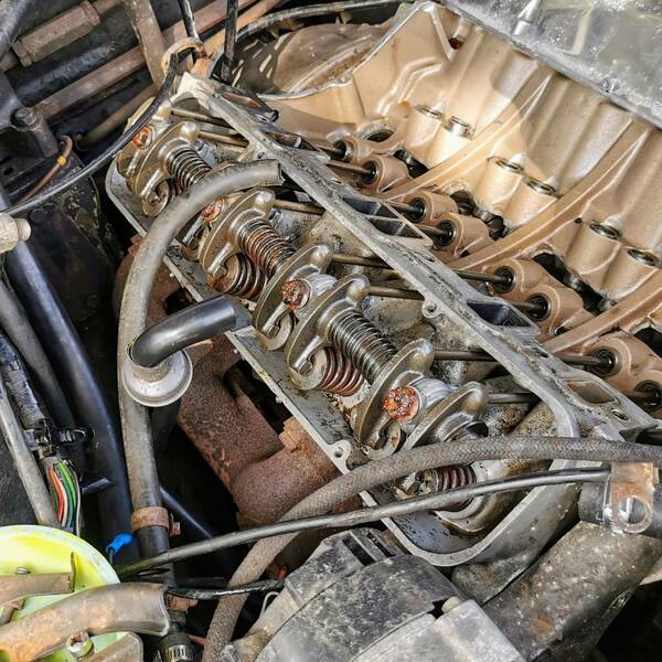

Head all looks pretty clean.
Second head is now off.
That was several orders of magnitude more awkward than the left hand one because a couple of fasteners were more difficult to get to.
The rear most exhaust manifold bolt in particular was an absolute joy...
From underneath with my hand wedged between the chassis rail and the starter motor was the only way I could get a tool onto it, undoing the thing 1/32 of a turn at a time.
Managed to find another problem which definitely wouldn't have been helping us.
Broken valve spring on no 1 intake.
*Submits yet another order for parts...*
I'll remove and inspect these valves later and report back anything of note, but I don't think you need to see closeups of another eight valves unless there's anything noteworthy - they're being replaced anyway.
That certainly makes it justified pulling that head.
The front piston is remarkably cleaner than the others... signs of HGF on that cylinder as it gets effectively steam blasted?
Always nice when something is physically broken and suddenly the work is worth it even if that broken spring is additional to it's woes!
I can only assume that valve was being pushed shut by compression, or the spring was allowed to fall fully apart when the preload from the tappets was released, as it's totally floppy now.  However I didn't have a miss on that cylinder when I checked!
There's no visible signs of the head gasket being breached (on either side), but given the amount of moisture in the engine it certainly wouldn't surprise me.  Both coolant and oil levels were spot on when I got the car for all that means, and there was no sign of it pressurising the cooling system when running - though admittedly I've never subjected it to a sustained run under load yet.  That is of course right next to one of the coolant passages, so if one was going to ingest water that would be a likely candidate.
Glad I bought a full valve set now given that though it looks fine on a cursory inspection there's every chance that one has been whacked by a piston a bunch of times if it was hanging open.

Valves and the replacement valve spring for the P6 were both dispatched first thing this morning so hopefully should be here tomorrow.
Yep, that spring has seen better days and definitely won't have been helping anything.
Judging from the wear on the side of the guide where it's been rubbing this has been an issue for a while.
Thankfully none of the damage is actually anywhere in contact with anything and the guide itself doesn't seem to have been compromised.  The valve actually does appear to be undamaged, but it's getting changed as I don't trust it.
