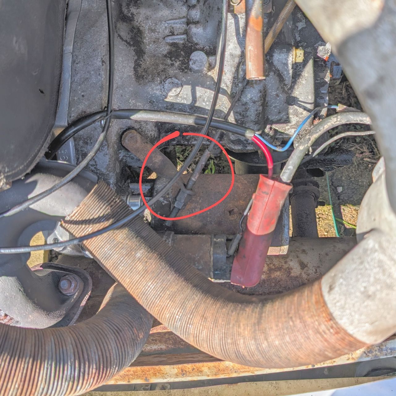

Something which made itself known at the end of last week on the Trabant was an absolutely bloody horrendous rattle from somewhere up front.  This was plainly a "something external touching something it shouldn't" rather than anything that was actually a sign of impending failure.
Sure enough a bit of poking round today found the culprit.
The metal adjuster collar on the throttle cable had come into contact with the heater box.  Being a pretty lightly built tin box this did a great job of amplifying this into an extremely annoying din.
This has now been rerouted to keep it well clear - though I did scratch my head a bit as to how to keep it there as there wasn't really anything obvious to tether it to.  Eventually I figured out I could trap it under the sound deadening jacket and that keeps it exactly where it needs to be.
Hopefully that will be the end of that as it didn't half make a bloody racket.

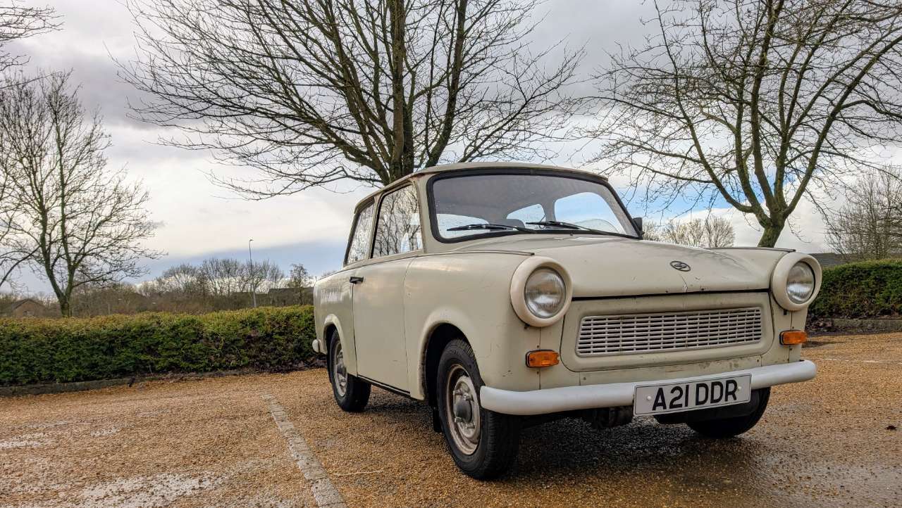

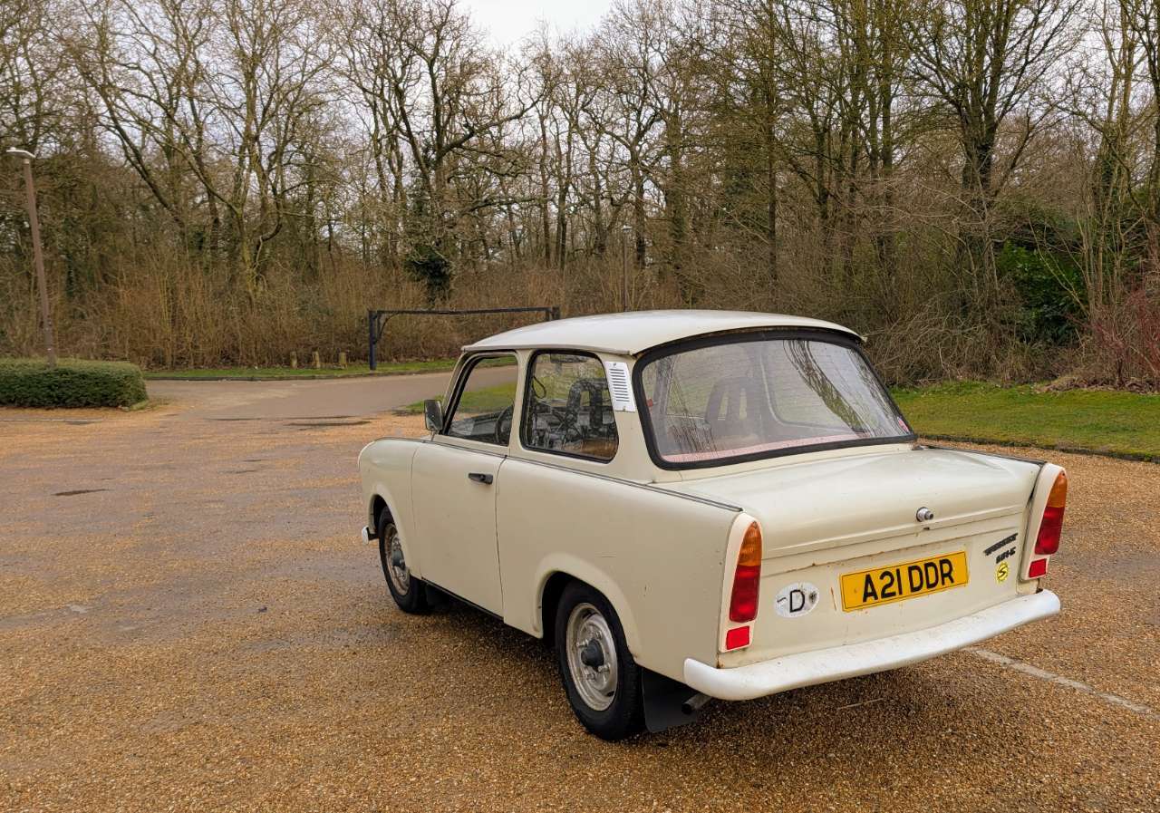

Stick those bumpers on the ifa FB group,for some reason they are always after them to make their car look older,they will go quick
On the topic of de aging it, have some pictures of it from before it was  aged, also pre DDR plate too
Definitely looks better with the standard bumpers, even more so with the bumpers body coloured rather than black.
Expand
It does look really odd with the bumpers in black!
Done a bit of bodging today to help stabilise that pinholed and cracked bit of exhaust until I come up with a proper solution.
I'd rather have used jubilee clips to get uniform clamping force round the whole thing, but Halfords didn't have any.  Like none, zip, nadda.  By that point I couldn't be bothered making an hour's round trip to the factors I usually use, so made do with this.  I did think "I'll just grab one from Toolstation" as well but couldn't even get into the car park as the industrial park was swamped by people getting to Subway and KFC for lunch on the other side of the car park.
You can see where this is going from those components, can't you?
Slathered it all in exhaust goop then clamped it together.
I need to take a closer look at the condition of the silencer before I make a call on what the next step will be.  If it's just this mid pipe that's a bit crusty I'll see if I can track down a replacement somewhere in the UK.  They're not actually expensive to buy, just for a single bit of pipe you're going to more than double the price by the time you've shipped it from Germany.
If more of the system looks crusty I'll need to have more of a think about what's the most sensible way forward...if I'd noticed this sooner I'd probably have just ordered a new system along with the engine (and probably been tempted by upgrading to a 45mm system given it probably makes the most of the extra displacement).  Component I'll be looking most closely at is of course the heat exchanger given the safety aspects of any potential failure there.
