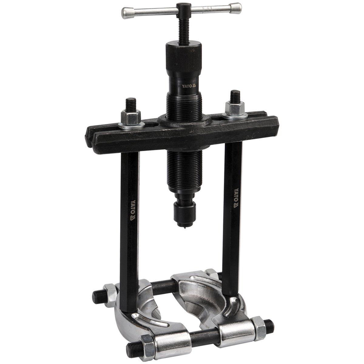

Any proper* mechanics out there who can suggest how I can remove the inner race of the inner wheel bearing from the stub axle on the rear hub?
It is a taper roller bearing and there is only about 1mm between the back of the bearing race and the backplate, so no room to get a puller on it.
I have tried to pull it off using a three-legged puller on the backplate, but it just bends the backplate.
The backplate will not come off until the bearing is removed.
The bearing face is tapered, so nowhere to grip that.
Since it is hardened there is no way I can saw it off.
I could maybe grind it off, but I am afraid I might damage the stub axle.
Maybe heat would help?
I have a 2000 watt heat gun which gets pretty warm, but probably not hot enough to make any difference.
I could try a blowlamp, but the hub is directly below the petrol filler and I really don't want to have to remove the petrol tank if I can avoid it.
I do not have access to any sophisticated* stuff like oxy-acetylene, but I do have several big hammers.
Thanks in advance for any (constructive) suggestions.
Because it is hardened, it's brittle ... nick it with an  angle grinder,and belt it with a cold chisel . Pipe freeze spray'll help too !  Wear goggles  :-D

I have ordered this set of pullers as suggested by Six-cylinder:
http://www.ebay.co.u...~AAAOSwEetV-pW2
It's HongKongese but for £17 it's worth a punt.
Will let you know the results when it arrives. They say by Monday but I'll believe that when I see it.
Can't really justify the first one at £130. That's more than I've spent on all the parts so far.

This looks the same as Six-cylinder's other ebay suggestion, but at £19.99 instead of £14.99.
I am sure it would do the job, but the other one is a set of two different-sized pullers plus various extra extension rods and stuff, for only another three quid.
Like I said, I'm still a tight git!
Thanks for the suggestion.
Removal of the rear inner wheel bearings requires the use of several Renault tools.
Fit the centralising sleeve of the Rou. 370 tool (17mm Stub axle) or Rou. 370-1 (20mm stub axle).
Fit the half shells around the bearing and hold the asembly together with the clamping ring.
Fit the Rou. 15-01 protective end cap to the stub axle and then use a suitable puller to extract the
