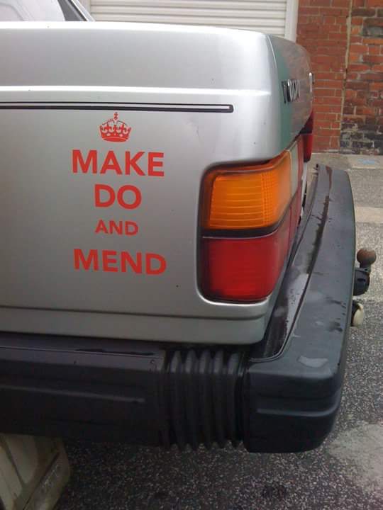

Sigmund Fraud Posted July 31, 2017 Posted July 31, 2017 They're amazing cars - if you buy a good one and look after it, it can literally last a lifetime ! Mine was a neglected heap of shite with over 200K on the odometer that I had bought for £175 : I kept it for two years, during which it was used for commuting, trips to the continent and collecting various parts for my other heaps of shite from all over the country. It never failed to proceed, and required little other than routine maintenance. I've been a big fan of boxy Volvos ever since ! Do remember timing belts are cheap and easy and non-interference [pedant] True about the B230, but the B200 is an interference design. [/pedant] scruff, Shep Shepherd and danthecapriman 3
