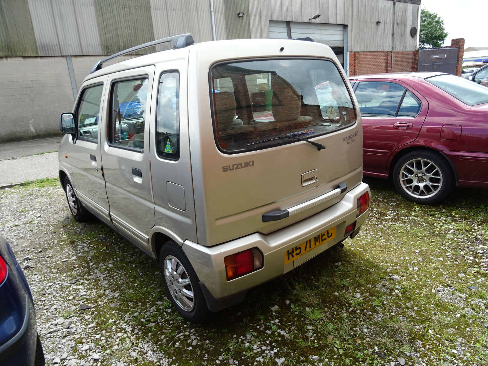

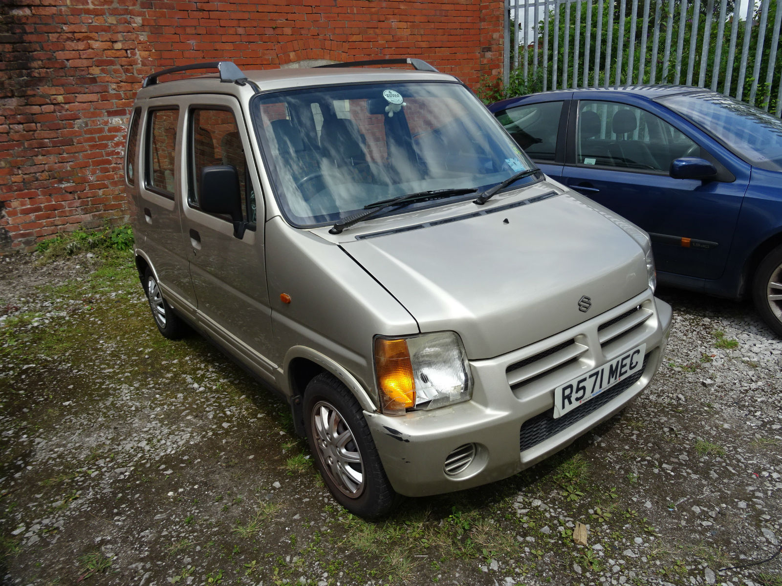

new car collection,true elderly chariot,wagon..
off to collect, :-D :-D even has air-con....

right,it may have air-con,more hot than cool,headlight not a failure,have seen 1.00 repair jobbie in poundshop,cant go wrong at that price,only done 51000 miles,got the great powerfull 1.0 non timing belt version,saves money,radio dead as dodo,ariel none,broke off,more to follow,off poundland,lidl...

cheap chinese radio ordered 8.99,ariel aswell,managed to get last tin of baurfix black anti-rust paint,got plastic headlight repair from poundshop,sills have been prev welded,seems to be pretty neat job,just needs good overcoating,...drives ok for what it is..

Is that sawn-off roof bar on the boot lid standard fit?
It's one of those grab handrails, like you see fitted next to house doors so old people can help themselves up the step. In this case they fit them so that Doris (other old lady names available) can hang onto the car for balance before transferring her grip to her tartan shopping trolley.

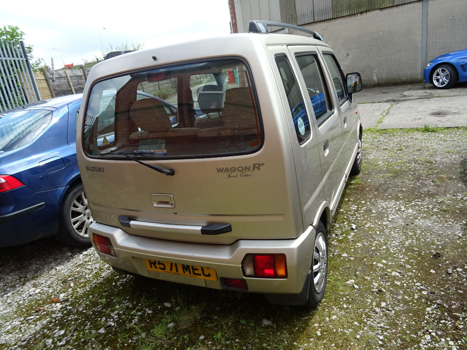

post-19591-0-78324600-1500994295_thumb.pngmore pictures tomorrow,got the welder out sunday,drivers door had bloody big gap your could put your hand through,top door hinge was prev welded in 2015,but had not welded the hinge all round,so off came the door only four bolts,than had to remove the front wing,quite easy to come off on these,grinded,than cut off previous repair,put door back on temp,gap better,than tacked on hinge had to keep an eye ,as in hinge is fuse box,wires...removed door again,then welded all around hinge,slapped on some black underseal,thats done,than rebolted door back on,air-con belt 3.43 from japparts in london,and oil filter,changed belt what pita,than noticed from crossmemeber,anti roll bar area couple of holes appeared,more welding tommorw,rear silncer blows slightly,another plate tomorrow..picturs than..
