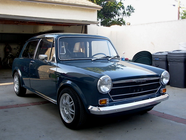

That is a very worthy contender for paint. What are the wheels, Rostyles?

Those are Honda Civic wheels....VTEC YO!!

The Austin needs to be yellow. Bright yellow.
With a black vinyl roof?
