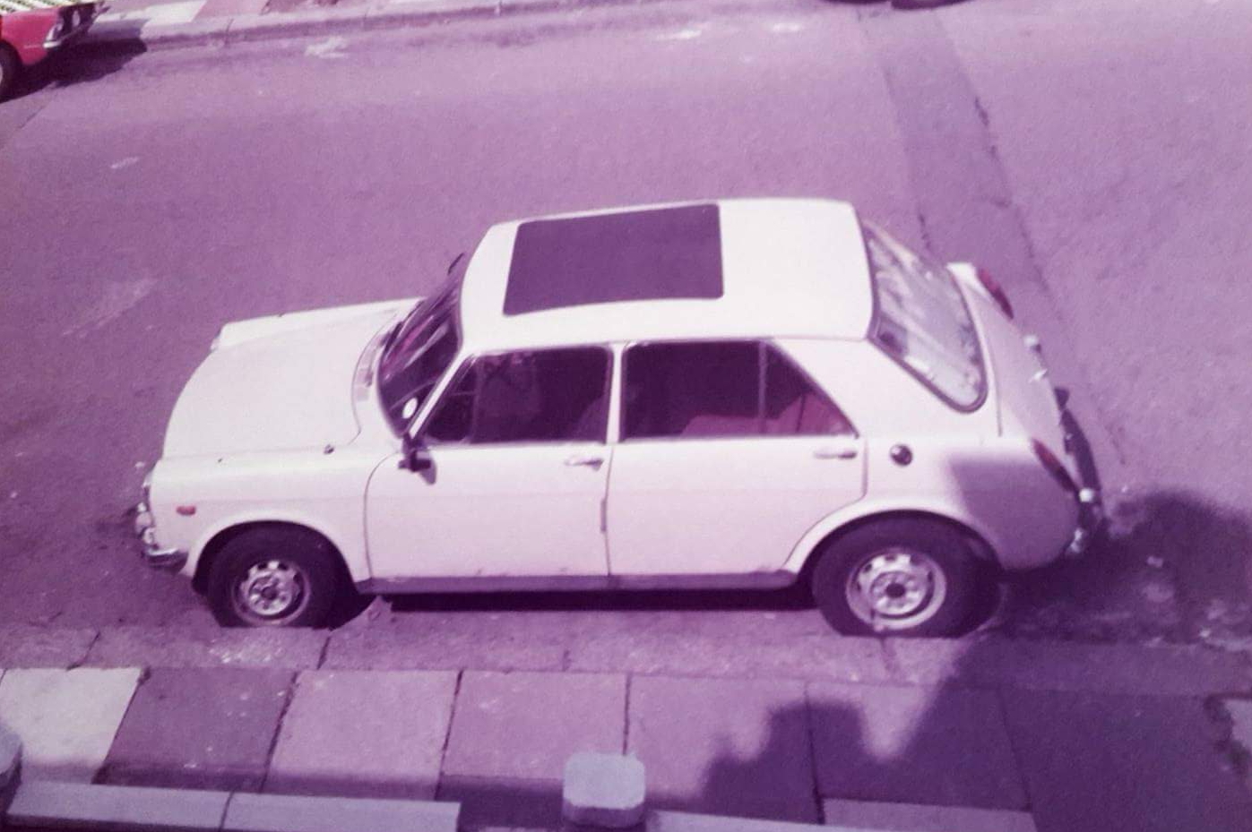

Ooooh Webasto :)
I love the way the Instamatic? camera has distorted the proportions of the cars.
What are those mirrors off, a Dennis Dart?
Something you don't see so much of these days,unless a Land Rover has parked up, and that's  all the oil drips in the road ..  :-D
What's that?
Beetle?
They look the same as my Reliant Rialto ones.
