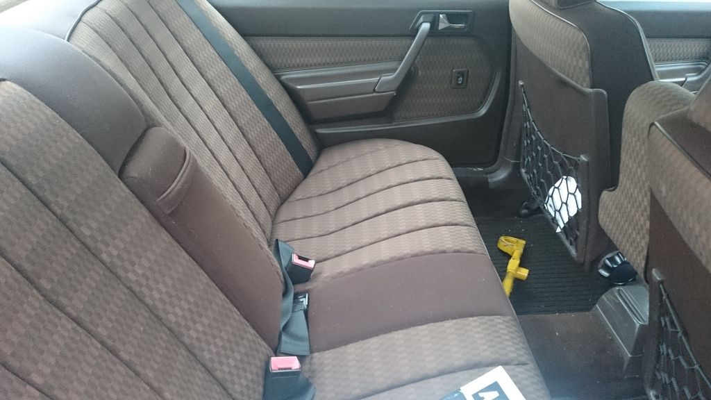

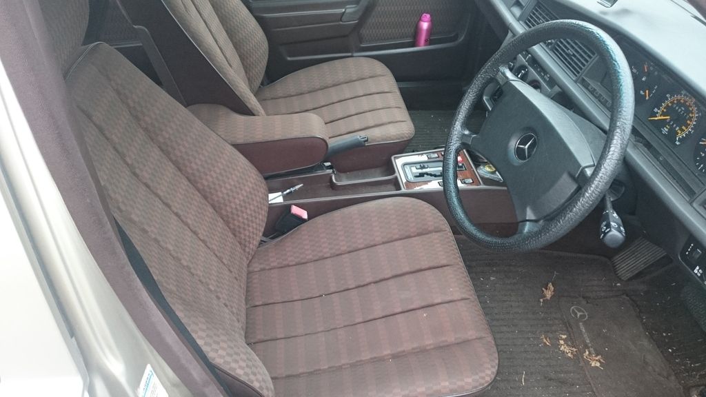

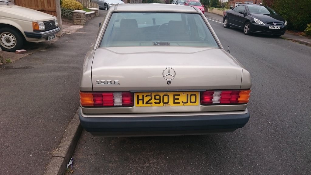

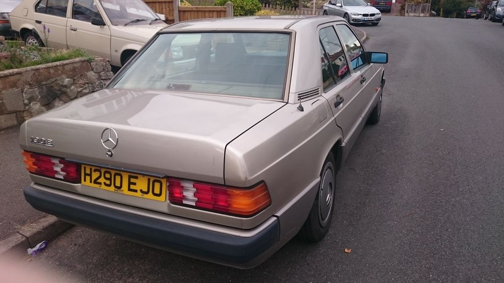

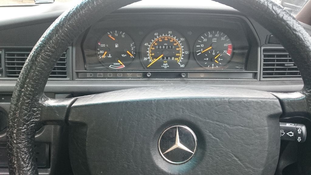

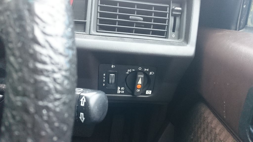

I have had the Mercedes for one week now. It is very smooth, quiet and comfortable. Definately a car more suited to wafting around in, I am looking forward to trying it on the motorway. It has softer suspension than I was expecting for a Mercedes. It has a nice spec though, electric sunroof, windows all round and central locking. Strangely only two front speakers for the stereo. I wouldn't say it was fast although is okay if you put your foot down and send the econometer into the red. I haven't tried sports mode out yet, if it is anything like the Peugeot 206 auto I had, then all sports mode will do is use more petrol!
DSC_0672_zps1tilc9mb.jpgDSC_0673_zpsi0ag1dy1.jpgDSC_0674_zpssqhtcbq0.jpgDSC_0675_zpsps29n56l.jpgDSC_0676_zpskvvi2gib.jpgDSC_0677_zpsl2mbyamb.jpgDSC_0678_zpsfwwuz7iv.jpgDSC_0679_zps7f2fccsl.jpgDSC_0680_zpsz9kq79nx.jpg
  • Like 24
I had an Allegro which was silver on the log book but was definately gold. The Mercedes has silver on the log book but looks gold to me!
Well bought chap! I'm having to get rid of mine.
The colour is called Smoke Silver - we had a 1.8 in that with brown interior just like that, with the 8 hole alloy wheels. That brings back memories. :grin:
