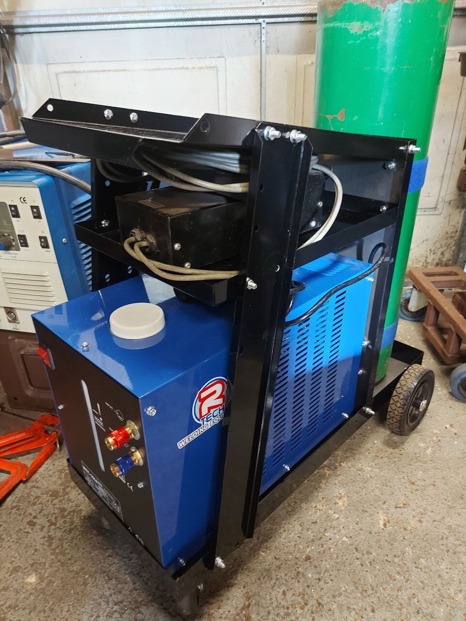

Went a bit mad on the R-Tech welding site this morning, water cooler for the Tig l have been mulling over for 17 years just getting by with the horrendous sized WP26 air cooled torch for hot alloy work and a WP9  which us a lovely size for intricate work. Had to buy a WP20 torch, the water cooled version on the air cooled WP9. Then a sheath for the cables, a big teflon gas lens and 10ltrs of coolant. I have spent more on tools this week than either of the S211's cost me!

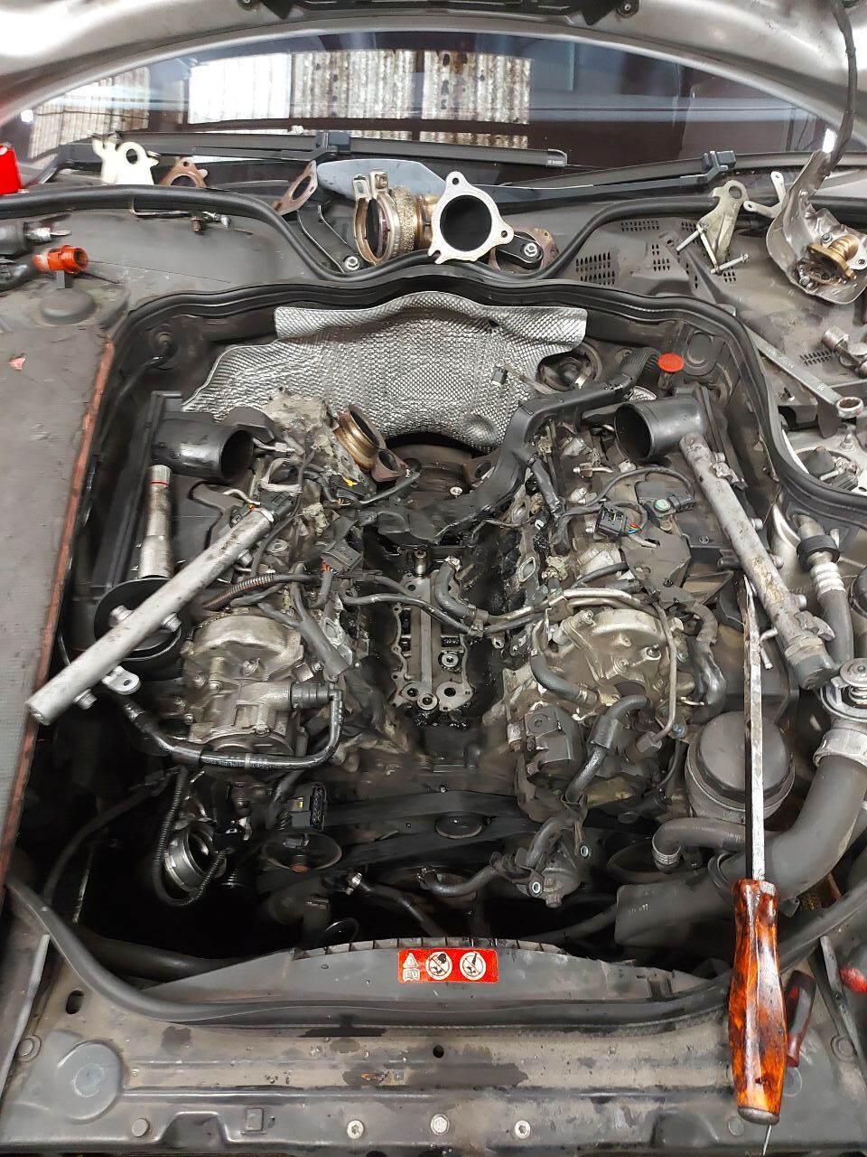

Late V6 OM642 E320CDI in the workshop today Jon is dismantling for oil cooler seals. Sod having ABS and V6 over the scary SBC system and straight 6 if that needs doing a couple of times during the engines life!
Water cooler kit for the Tig has arrived, keep thinking l should build a complicated air to water intercooler.  Then l found a nice Garrett air to air core just the right size to be mahoosive but inconspicuous. 🙈

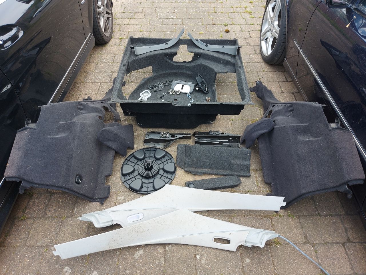

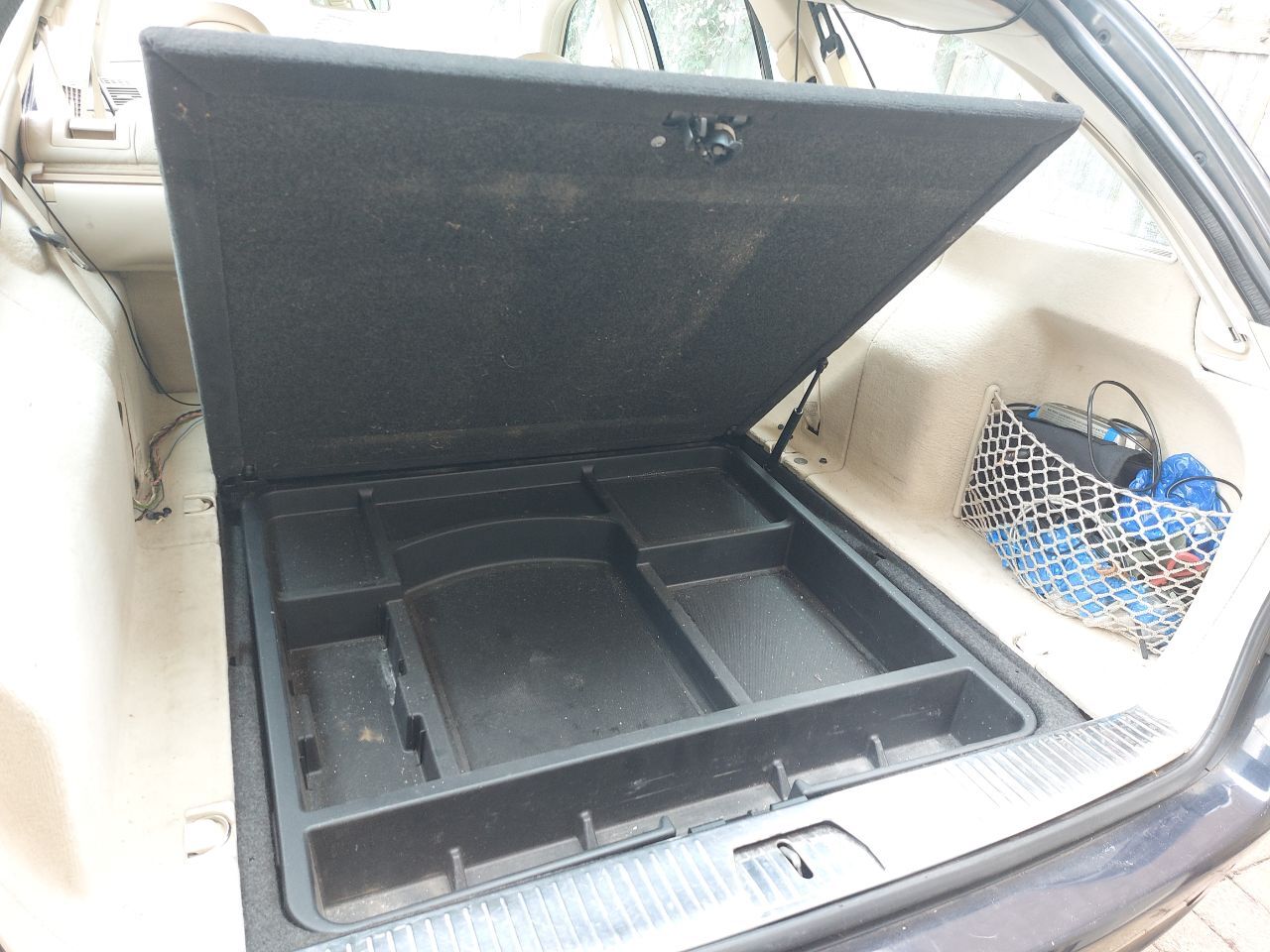

Had a wee fiddle with the S211 today to see what's what in removal of the 6th & 7th seats.
Came with everything from a standard car to convert, most of this l do not need other than to match the Designo interior from my spares S211 in dark grey. Basically a few panels that eliminate the seat belts.
Just need to have a good look at the parts schematics and see if anything major is missing.

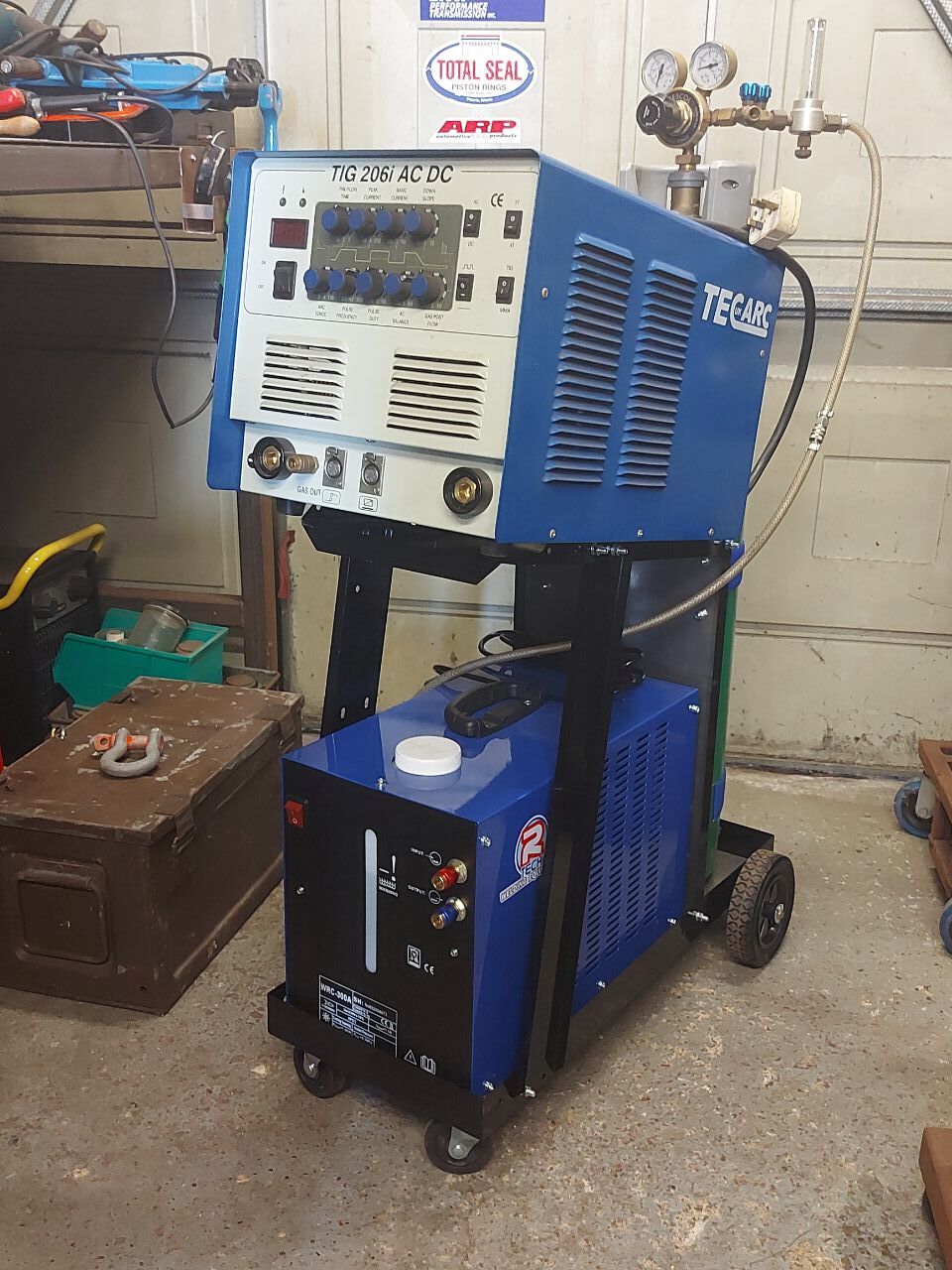

Cheap sub £40 Ebay welding cart for the Tig welder and cooler currently undergoing modification with the addition of 2.5mm strengthening plates.
Had a play using the new torch and cooler, definitely an improvement over the WP9 air cooled torch on alloy. Looking forward to a bit of creative fabrication on the welding bench.

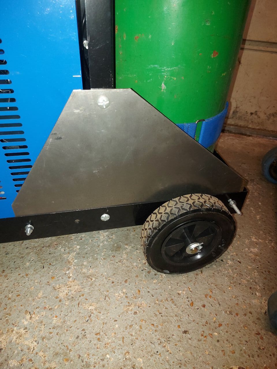

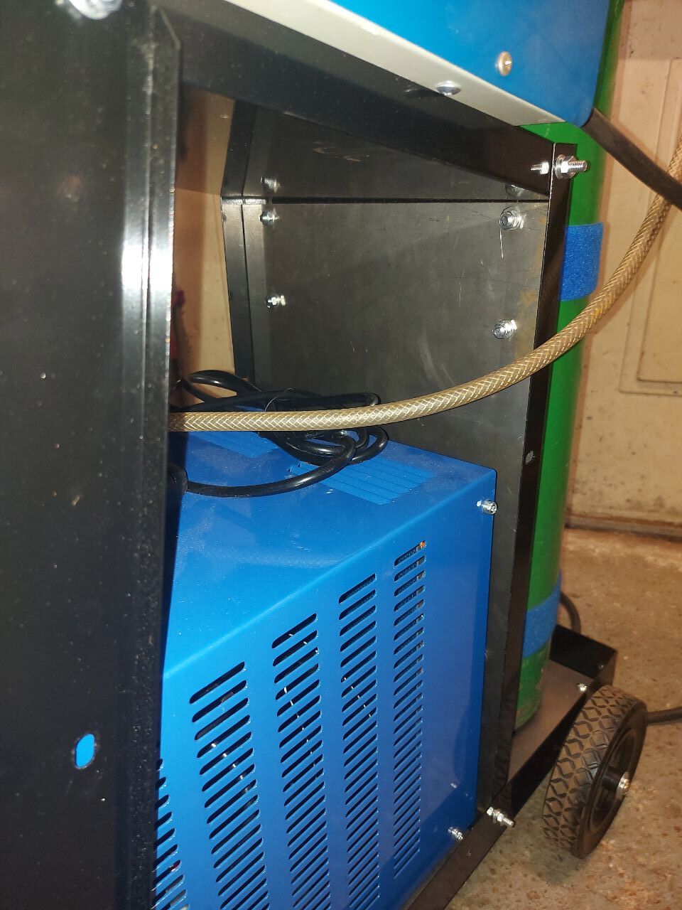

Added in a fair bit of 2.5mm sheet to strengthen the weding cart, much stronger now. (I have a stack of 2.5mm sheet that was going for scrap  so cost nothing.) Tig brazed the little U bend plates for the Tig to sit in. Found a set of velcro bottle wall mounts l was given and fitted them in place of the chains supplied. Still a bit to do but l can sit on a stool to work on it when my legs and feet are hurting, a side effect from one of the chemo injections.

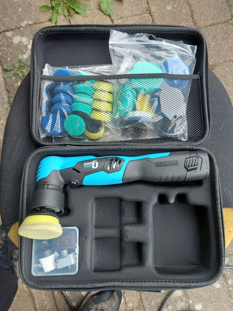

Had a play with a couple of new toys today  a short gun for the pressure washer and a Nano polisher. Gave the car a wash as there was bird poo, dirt and cobwebs on it then polished the left headlamp as the right is much newer and brighter. Slight improvement but it will never come up like the newer one.
