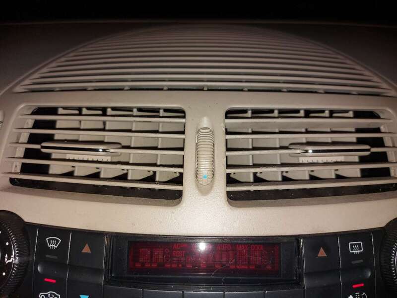

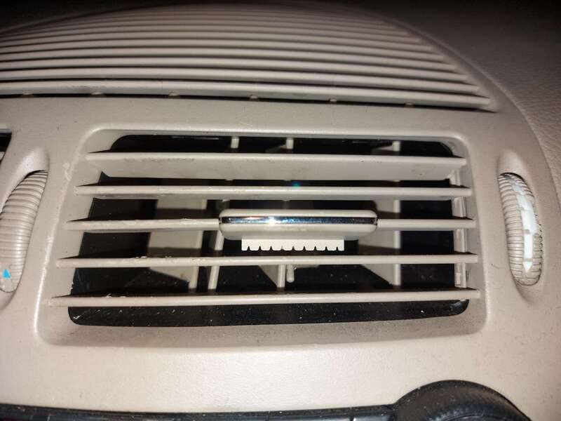

New code on the air conditioning, flap stuck and motor fault. 🙈
These flaps have been floating about in both central vents since l bought the car but l left them thinking they were broken. Closer inspection reveals apparently not just displaced probably by either a phone holder or air freshener. 5 minutes with some wee pliers and they're back in place. :) The code cleared too.
Full flaps and all working smoothly. Only two fault codes showing for both memory mirrors that are not fitted, I bet it won't last until Friday!

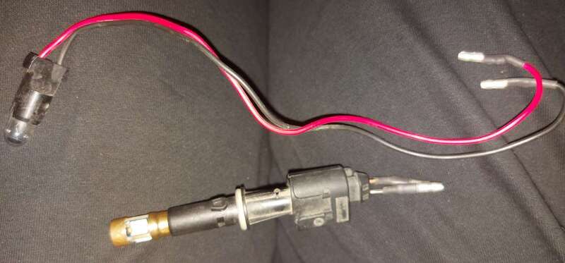

They did all that initially, l wired another bulb holder in parallel cable tied to the loom in the engine bay using the original bulb as a load resistor.
(If the LED fails you can swap the bulbs back until replacements arrive.)
I did a fair bit of searching for a suitable adaptor to fit these H7 LED bulbs and if anyone had managed to fit them, most seem to be a hack job just to fit them with seemingl not much attention to the focal length being correct.
