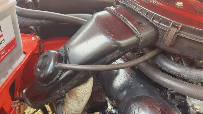

First thing I found was a slight vacuum leak from the line running between the carb and the airbox.  The airbox is very old so I wasn't surprised, blocked it off and adjusted the tune.

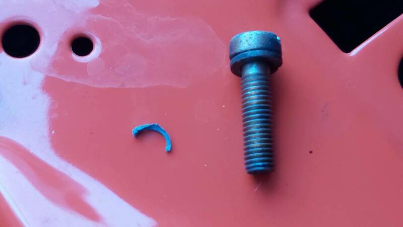

With the ignition system out of the picture it must be fuel related so I took the carb top off and removed the float to check the jets.
Wedged in one of the main jets was what looked like some blue gasket sealer.
No idea where that came from as I didn't use any on the restoration but there it is.
The rest of the carb was squeaky clean so I put everything back together and went for a drive.  It was indeed that starving the engine for fuel.  I reckon I've picked up 15HP!
