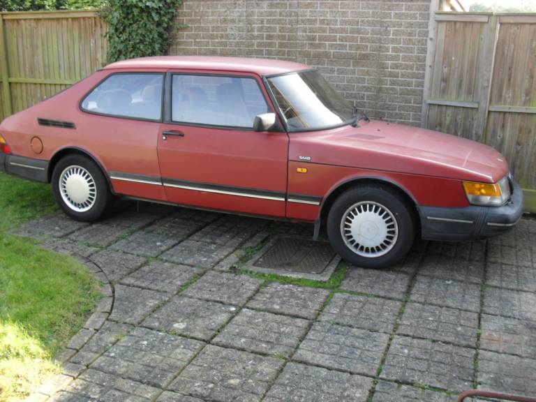

Vantman Posted August 17, 2016 Posted August 17, 2016 Why bother polishing it,keep it as it is,my 1990 Saab gets more attention like it is than all my polished cars ever did. Stanky, strangeangel, Coprolalia and 6 others 9
