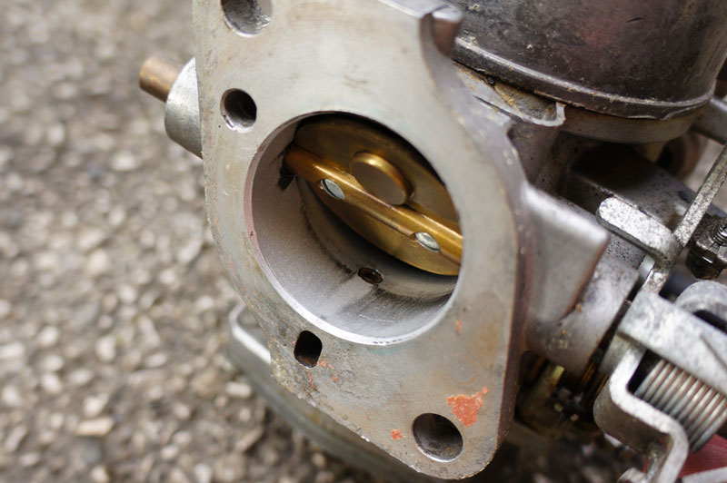

Today's fun adventure was to change the split CV boot, which I didn't take any photos of. Then I thought I'd pull the carbs off to investigate the missing vacuum advance take off. Here's where it should be:
These might not be the correct carbs for the car. Their identity tags are missing, so I don't know what car they're from. But it's not as simple as pulling out that brass piece, it seems to go all the way through -
So that remains unfixed for now. But I did figure out why the choke is so difficult to operate - it wasn't the cable, as I suspected, but this bit of the linkage which was set up so tight it was jamming.
