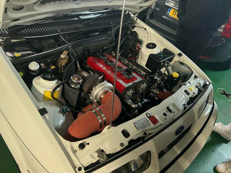

@GingerNuttzhas been working his magic on this. The Duratec is in and mounts are made up.
533190236_81e8084a-a4e5-4b07-83c9-6c5381a922be(1).jpg.85684d35b463fd704c1d24864d11dcbe.jpg
I dropped off some Land Rover V8 engine mounts to Davey today. The may or may not fit so I may need some advice on other mounts-I'll post up if that's the case to wrack the collective brains.
Other than that the rust is  pretty much gone and he's nearly ready to fit the bodykit. Amazingly for a 40 year old car things seem to fit not too badly so far.
