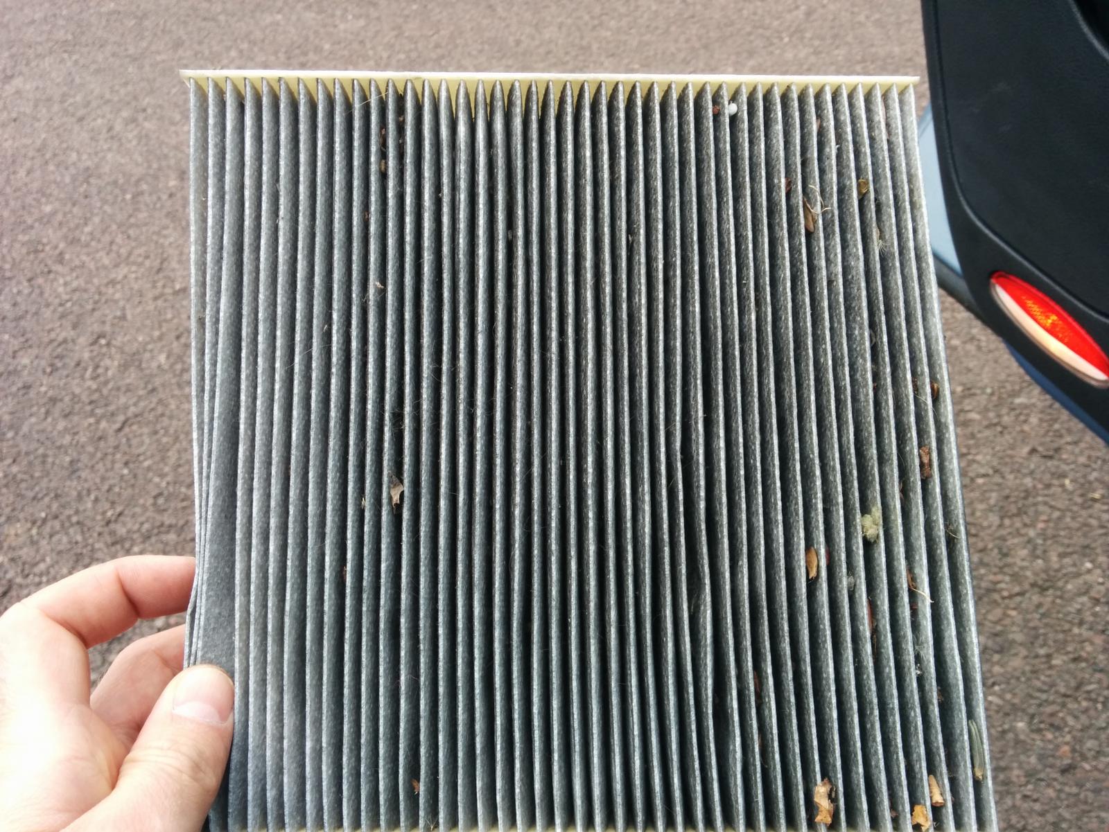

First step, remove old pollen filter...
Hmm looks like someone has been in here before.  :blink:
Renault say "unclip it". Helpful when there are no visible clips. After a bit of wrestling and brute force, I persuaded the cover to come off.
Filter itself wasn't actually that bad.
Removed the old filter, put the cover back on and then stuck the aircon cleaner in with the fans on blowing. 10 minutes later, opened up the car again and stuck the new filter in.

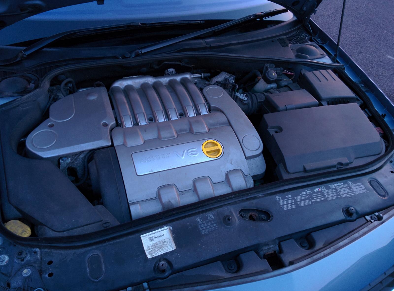

Obligatory engine shot. Not actually had a proper root around and nose under the bonnet yet. Pretty tightly crammed in there, but not as bad as you might imagine though.
