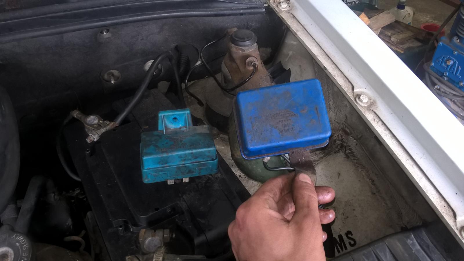

I got up early and fixed a couple niggles. A glowplug control unit borrowed from Babushka, the XUD Niva, sorted the lazy cold starts.
