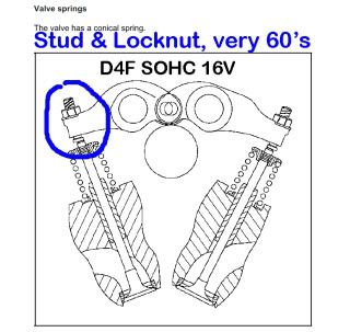

1.4 is DOHC 1.2 is SOHC with finger/roller followers operating a pair of valves >> due to the Inlet mani coming off to get the cambox off, the valve settings [old skool Screwwie + locknut] are not done and closed up valves burnout/lose comp & FTP en route to fragg.... :?
