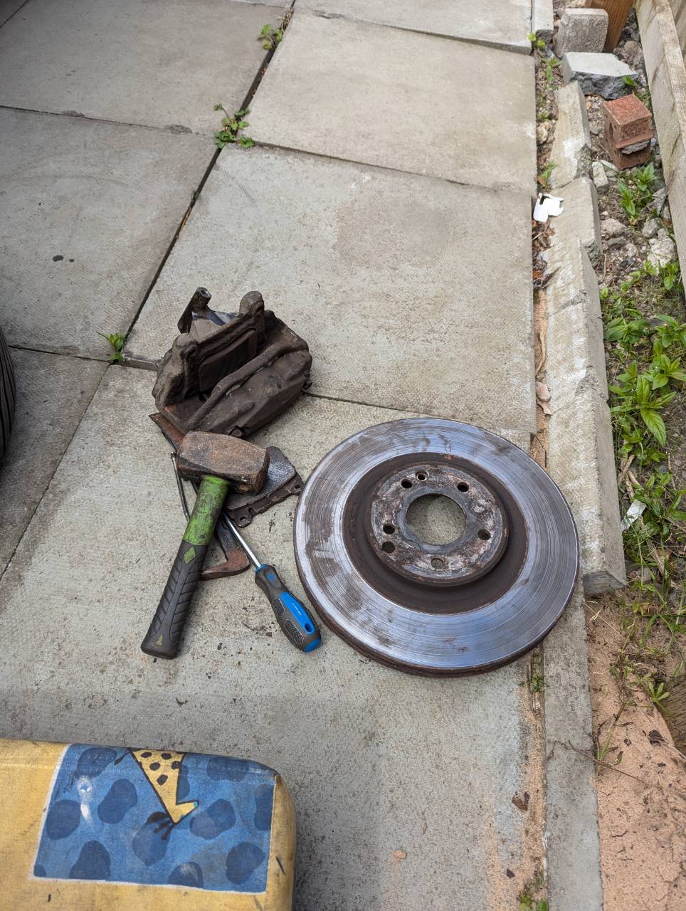

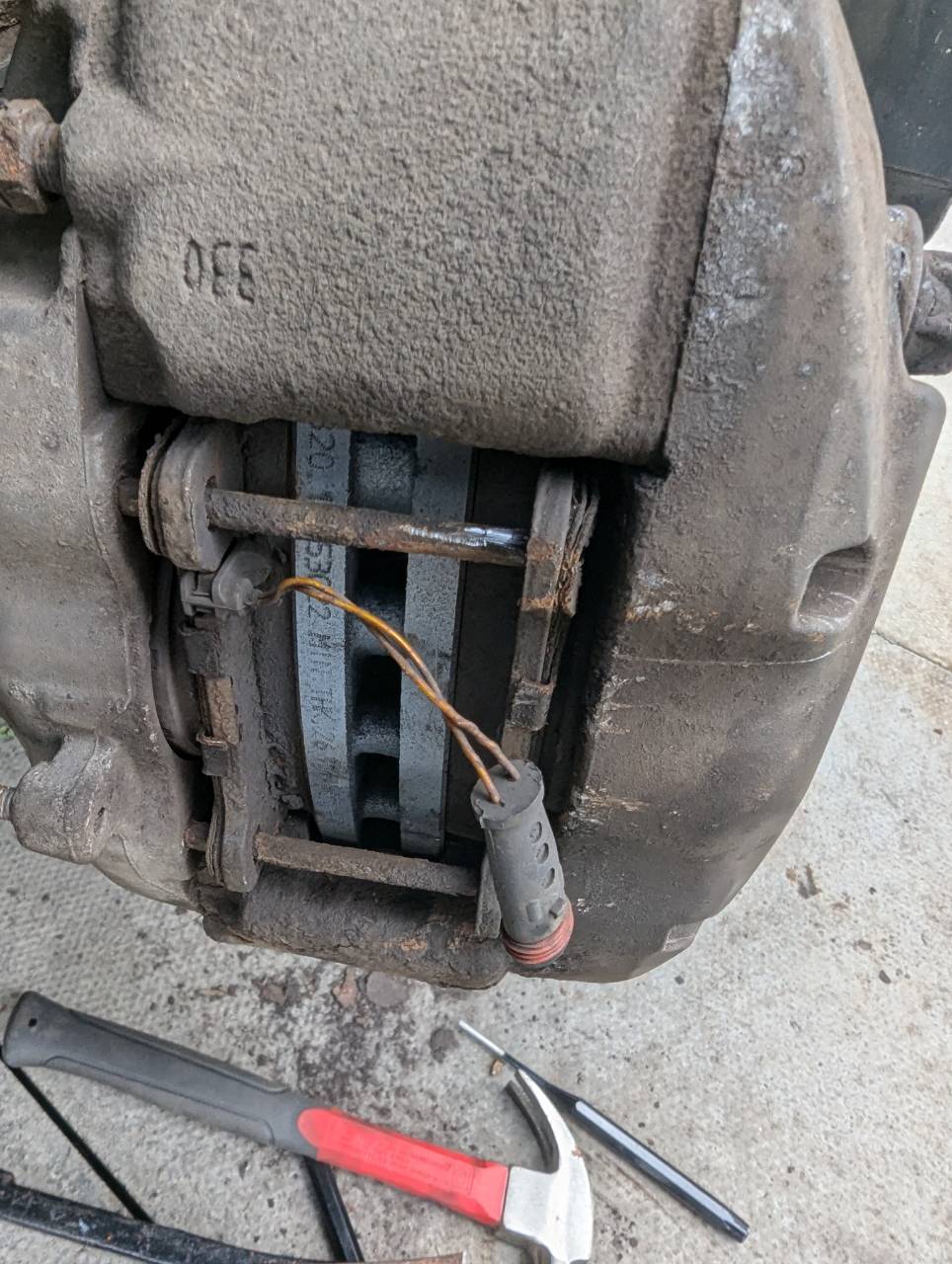

Front discs were warped so ordered a set with new pads to get them changed.
Life and rain got in the way, but seeing as doing big trip in it on Wednesday thought it was about time to do the change.
Early signs weren't good, someone had mullered the retaining screw so had to use the death wheel to get it off.
Except the pad pins were solid.  Drifts and a big hammer did fuck all.
I don't have any map gas or similar.  In the end I bit the bullet and got a new pair of calipers for £130 delivered.
Based on the discussions on here I even got proper slippy line for the brakes
Things are flying.... Er no.
PXL_20240629_110153454_MP.jpg.d563dcdf758b0967b79f3678b4e68eab.jpgThe discs supplied were correct but the pads aren't!
Quick hunt online and Euro is open til 4pm on sat in the glorious town of Kirkcaldy.
The car had advisory for loose wheel bearings, they are adjustable so tightened them up following online advice.
Pads purchased and in.  All the naughty bits removed. PXL_20240629_142055860_MP.jpg.3a5a2af4be7345141aacf26a30b8c65e.jpg
All back together but a 1 hour job took most of the day.

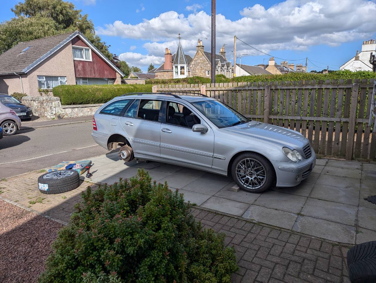

New wheel day for the Merc.
It currently sits on 17 inch staggered Merc alloys, but the front right wheel is slightly buckled and they could do with a refurb.
Seeing as it is Missus Moogs car, I offered the choice of refurb wheels or new ones.  She went for new ones - so ordered them from alloy wheelbase.  They came with 15mm spacers, but due to big brakes I had to wait for them to send out 20mm ones to clear the front.
After autotesting at weekend and seeing everyone with big boy jacks, drunken will ordered one so as to fit in!
What a game changer.
Wheels were ordered with new all season tyres as the Merc does a lot of motorway runs in rain.
Not my favourite wheels, but look ok, are straight and importantly are paid for by someone else.
Will stick the original wheels up for sale, the fronts have pretty much brand new tyres on them.

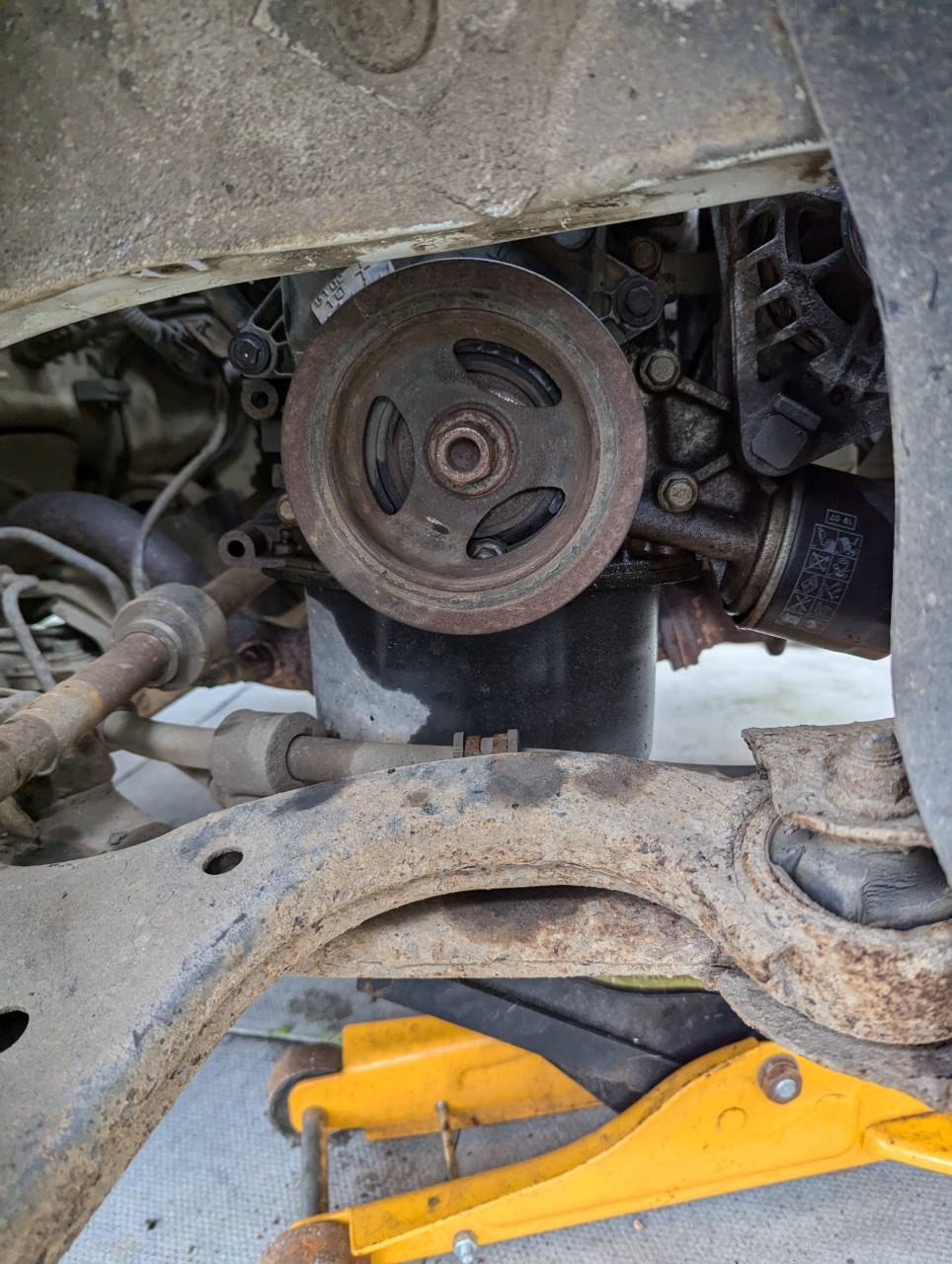

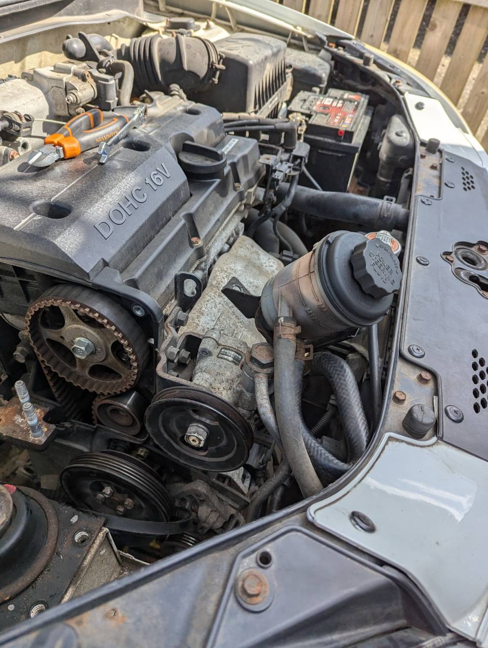

The Kia is going to be put up for sale this weekend, but has no history that I could find.  I think to get best money it is worth sticking a new timing belt on it and service the car.
Jacked the bad boy up

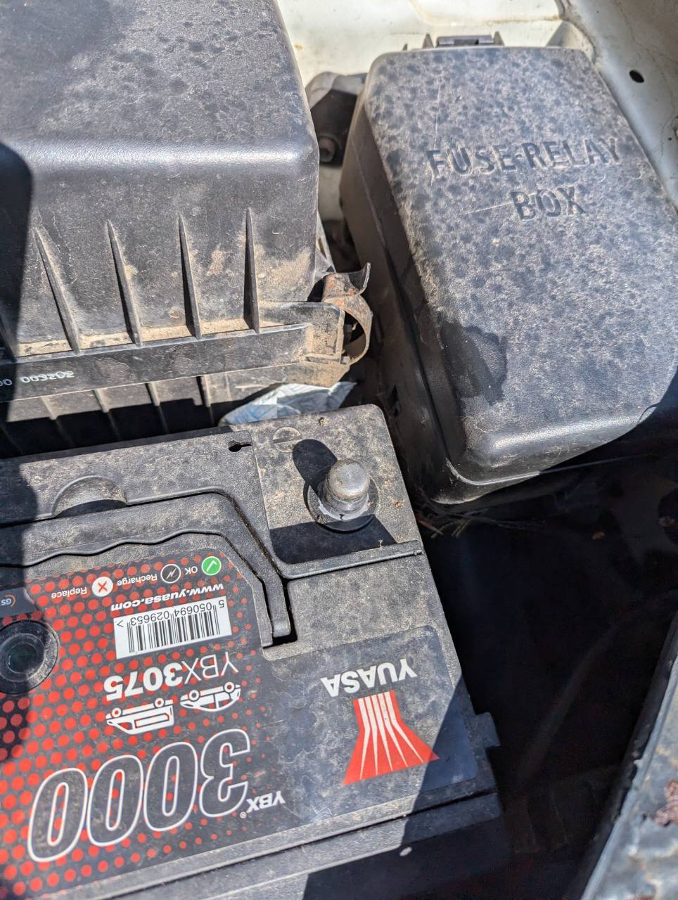

Battery disconnected

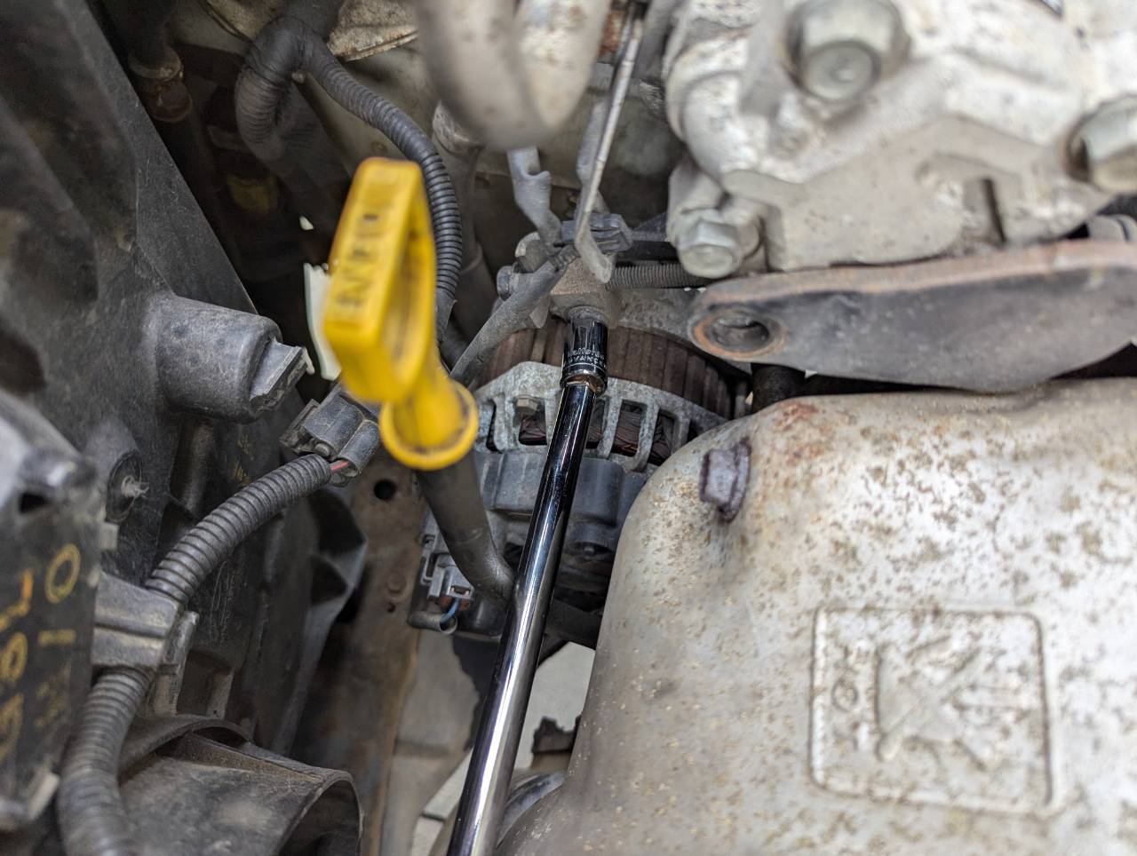

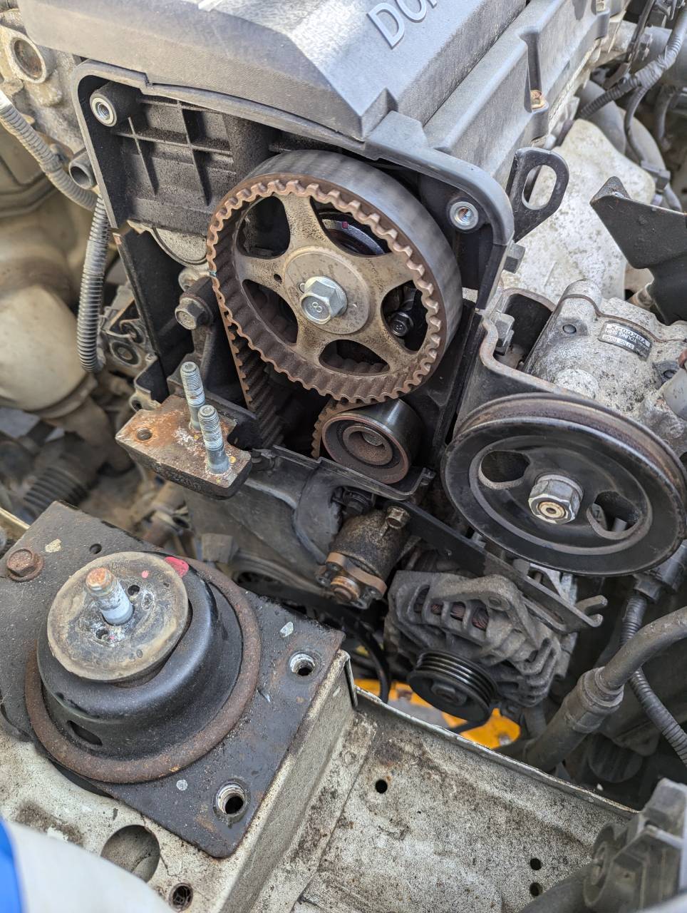

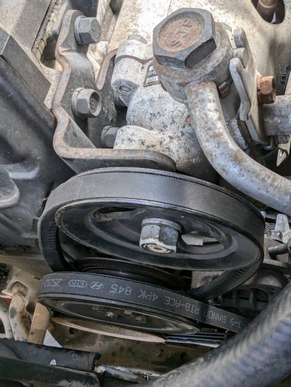

Then on with taking the bits off. First up is to loosen PAS pump.
Then alternator, although this bolt is a right pain to access
Before the water pump pulley belt is loosened, these four 10mm need to be cracked off.
Next on the list was the top engine mount
Followed by top timing cover
Moved the PAS reservoir
At this point the magnetic pot was filling up nicely

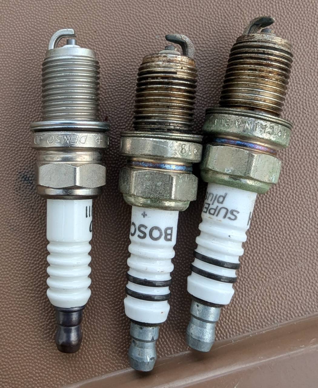

Sparkplugs out so easier to turn over the engine
Then checked the timings
PXL_20240822_114006509_MP.jpg.e9c1e89ff48c636b4aea7726a5215578.jpgPXL_20240822_114013533_MP.jpg.b3948042e7f8e6aa2ef2fb7de92560c7.jpgPXL_20240822_114037502_MP.jpg.42ca9cba52fe384b32bcfc88b80f9124.jpg
All good, it was time to crack on with taking the tensioners and idler off
PXL_20240822_114952152_MP.jpg.110f4f26a2f0dec3eb26b0961c326d74.jpgPXL_20240822_114607501_MP.jpg.7c7cc9f2a9d5a590dae0fd2ef0e8d690.jpg
Alll swapped over and new belt on.

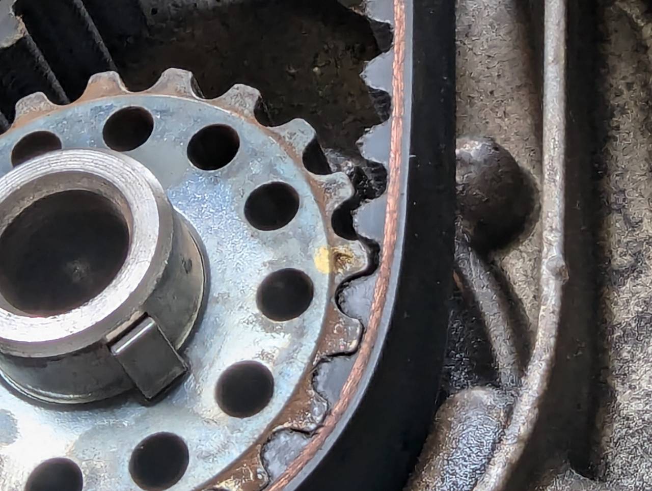

Cup of tea time before turning over the engine on a breaker bar. So glad I did.
New tensioners had moved the crank slightly
PXL_20240822_123027728_MP.jpg.4147762362f278990e6f34d51387ca93.jpgPXL_20240822_123032872_MP.jpg.c46fab4e2a27939d4e5d7c00f231c312.jpg
You can see it is a tooth off here. I had to take it all back off and retime the engine.  The red mark is where it is supposed to be
Didn't take many photos putting it back together but these pulleys were a little bugger to get back on as room was tight and they are free floating

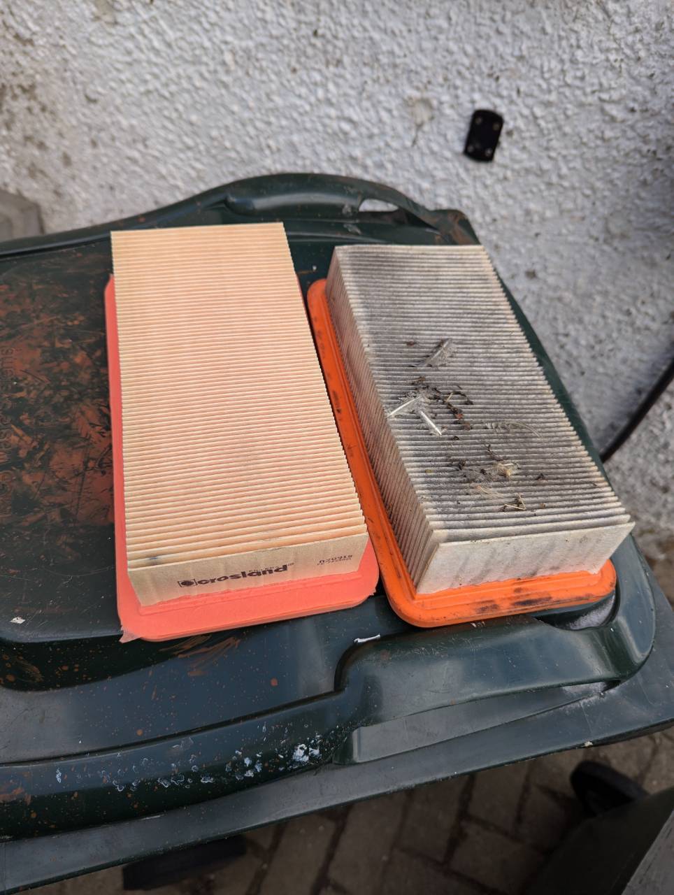

Swapped the air filter and plugs over, then it was the moment to start PXL_20240822_142953358_MP.jpg.8b34d5279957cd7b00e1cea77ee5bd71.jpgPXL_20240822_143403551_MP.jpg.2c9a3ae4122201b0637f10f6794f61f8.jpg
Luckily it started first time and after a quick run up the road everything seems to be good.
Treated it to a new oil filter and finest shell helix oil.
Tomorrow is get it cleaned then i will brave FB market place.
I was missing an ugga dugga so bought a cheap one from eBay to see if it would work on crank bolt.
£29 and whizzed the bolt off first go. Highly impressed with it.
