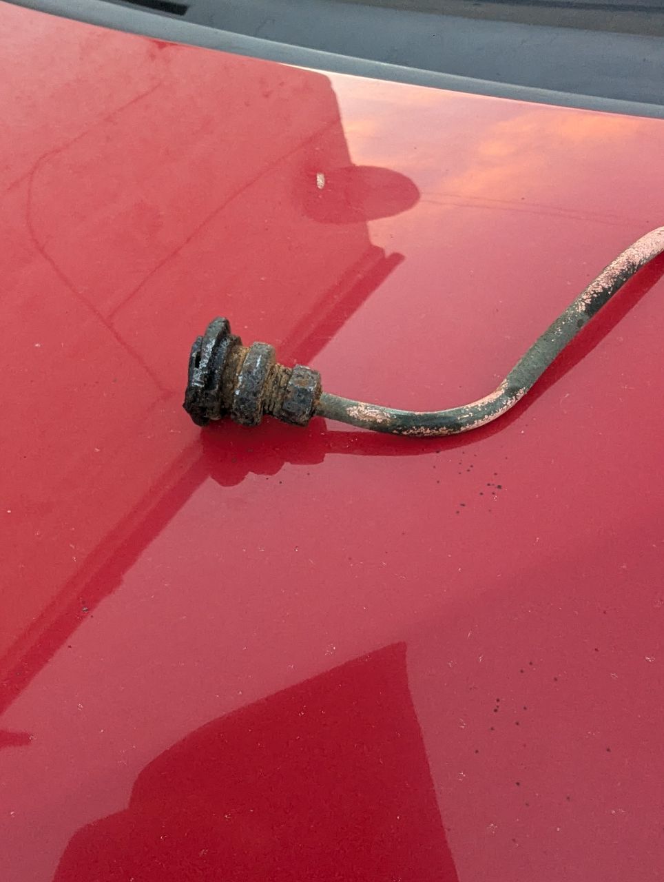

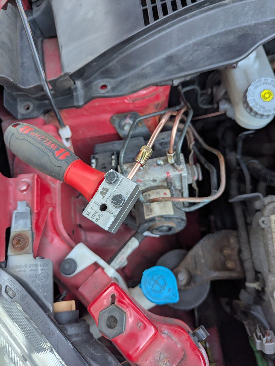

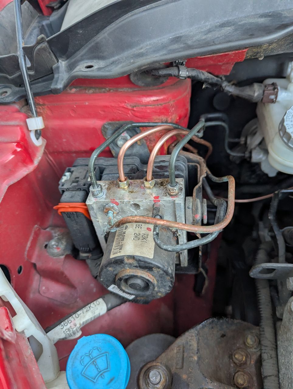

The other pain is that the brake flexis were rusted to buggery.  So this meant new brake lines to be run to the abs module.
Once everything is in, I will clip the brake line in securely.

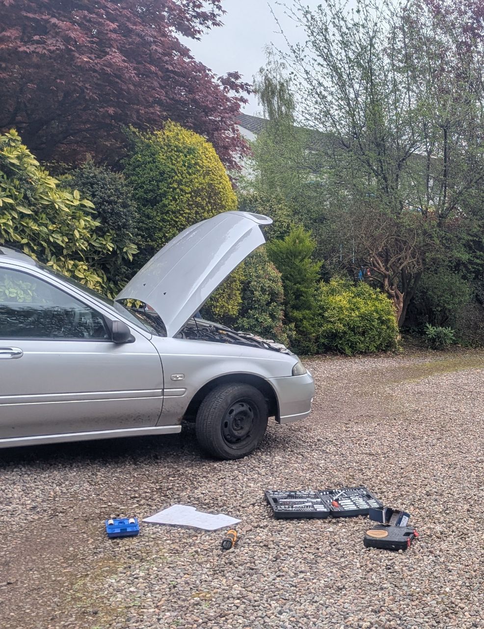

The passenger side is in progress, but instead of trying to undo bolts just cut the fuckers straight off. PXL_20260504_194140425.jpg.f8ce04f1df69901373ad5583ef2b3ddd.jpgPXL_20260504_192718437.jpg.4cd9a1d6496d81b53fef08f9d2e45495.jpgPXL_20260504_193928813.jpg.f20e3b8b19948ec23ea2879239409bcd.jpg

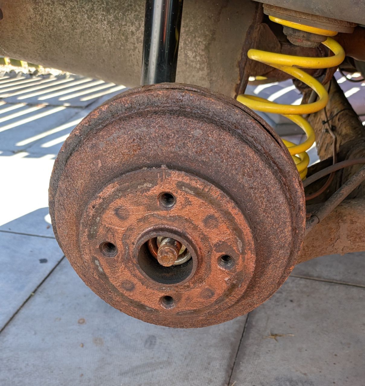

That will just leave fitting new rear drums and rear brake flexis.  They can wait until after the track day.

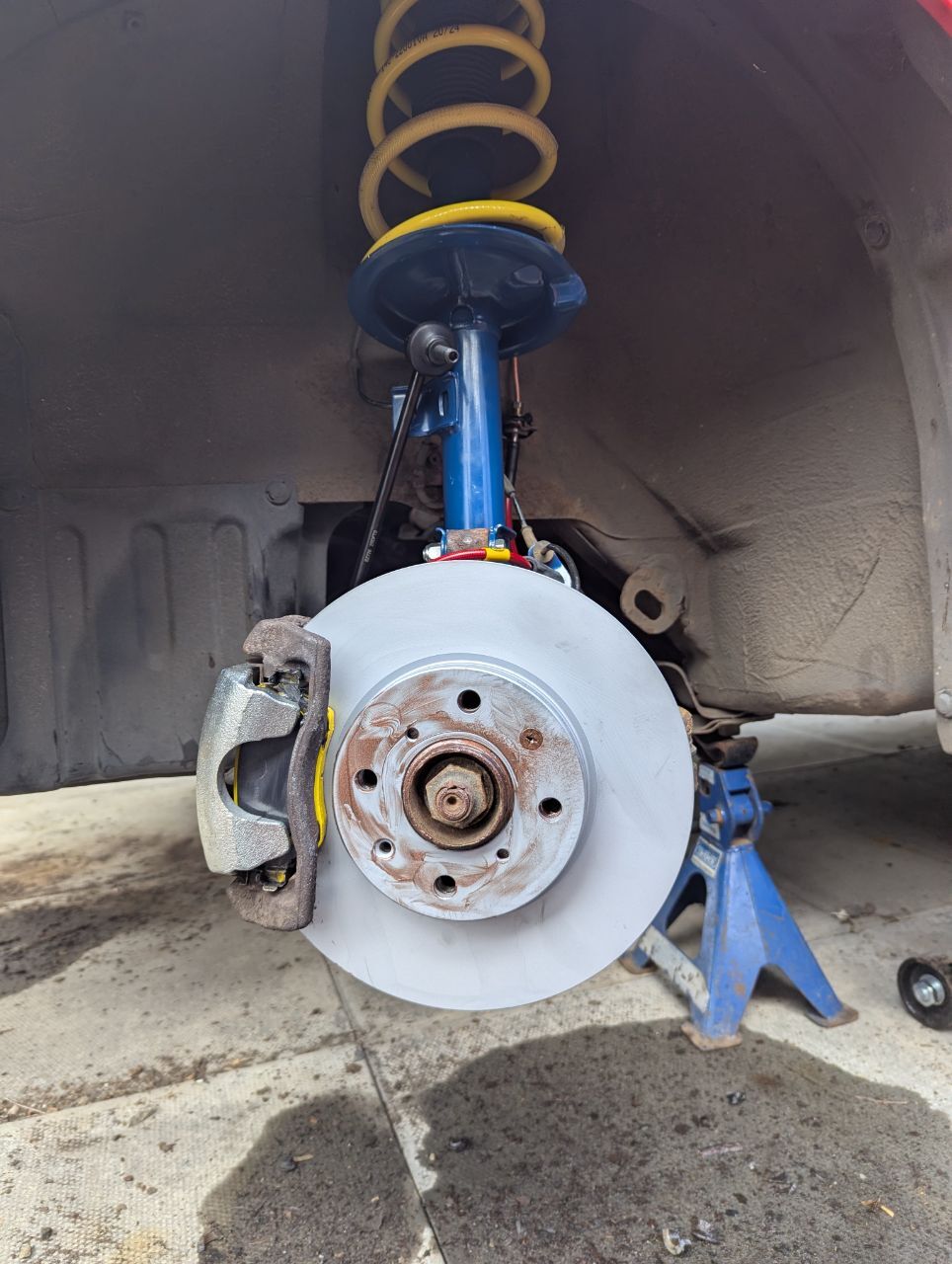

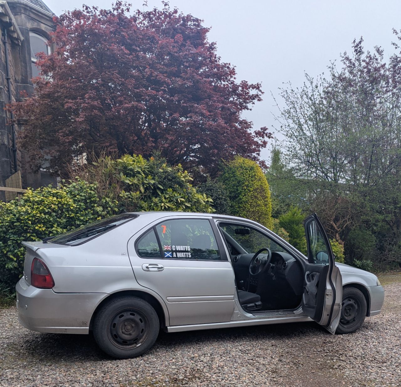

In other car news I took opportunity to stick some new brake pads in @NorthernMonkey steed for Sunday, as they were of unknown history PXL_20260503_131044978.jpg.866c06ca14106c67af9ddc3365c8787d.jpgPXL_20260503_132314512.jpg.9c299132aff9e901a4f0c02bda26afd4.jpg
I reckon he will have the fastest Rover 45 there on Sunday!

I also checked the old shocks.. there is pretty much no life left in them.

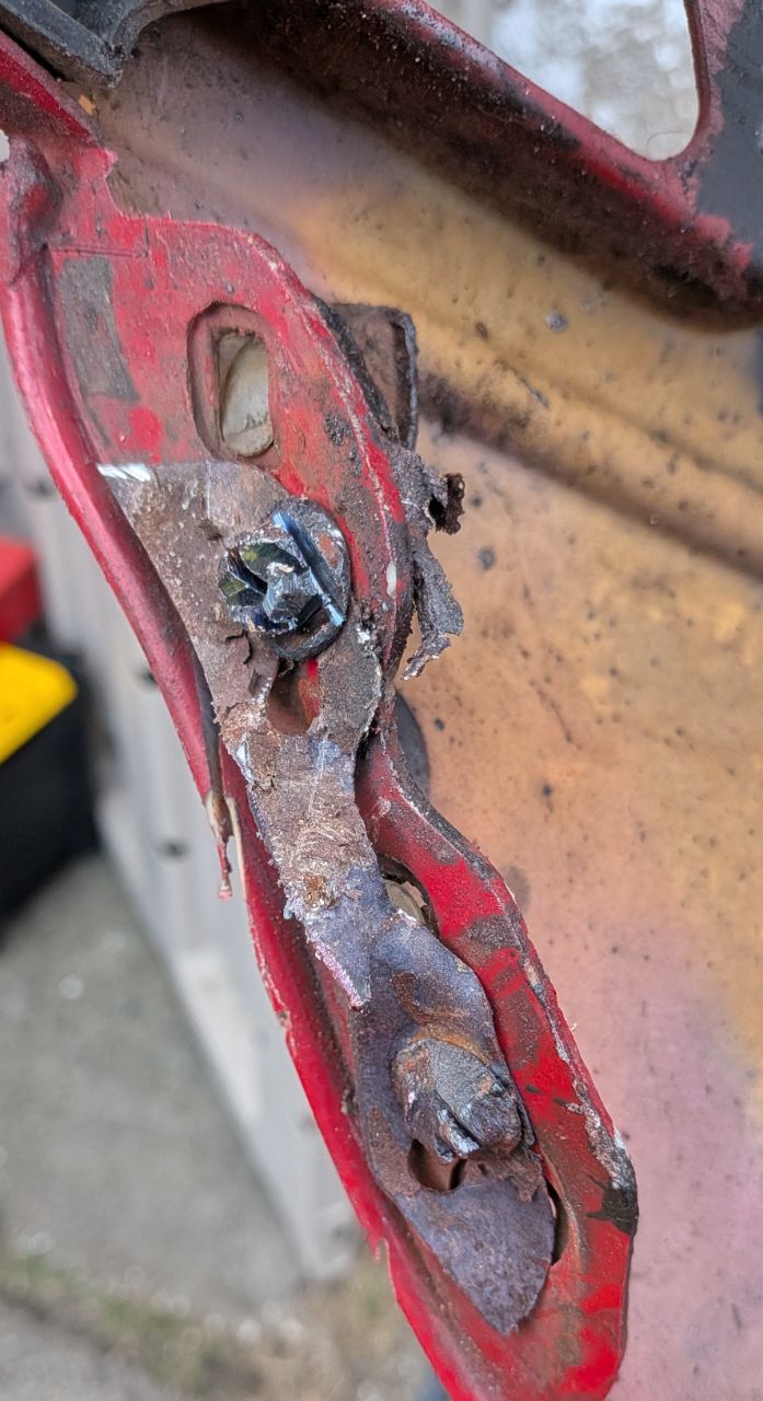

AHH bugger.  Someone has had a bump and then got rusty.  PXL_20260601_104256242.jpg.fc5dc2704653a73ec1e3b5312e7d909b.jpgPXL_20260601_104256242.jpg.fc5dc2704653a73ec1e3b5312e7d909b.jpg
I can't in all good mind leave it like that.  I sourced a spare from Silver lake which was better. But still needed a bit of love.
Grinder action
Jenolite

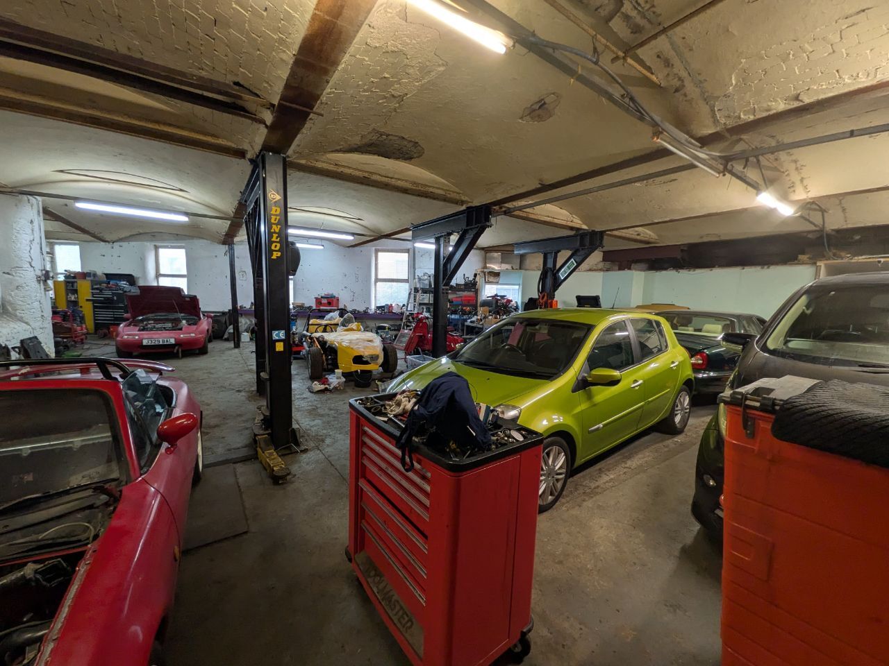

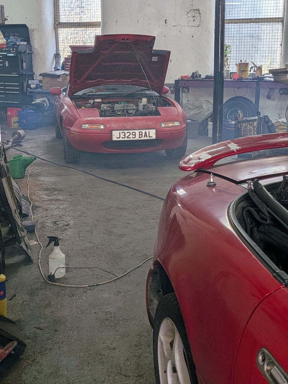

As noted before the mx5 headed south and took up a temporary residence in colne to be resurrected.
The capable @NorthernMonkey and his frank Spencer apprentice @The Moog decided it was success or scrappage!
The mx5 has run right, so I have taken it back to na for now, removing the turbo bits to keep it simple.

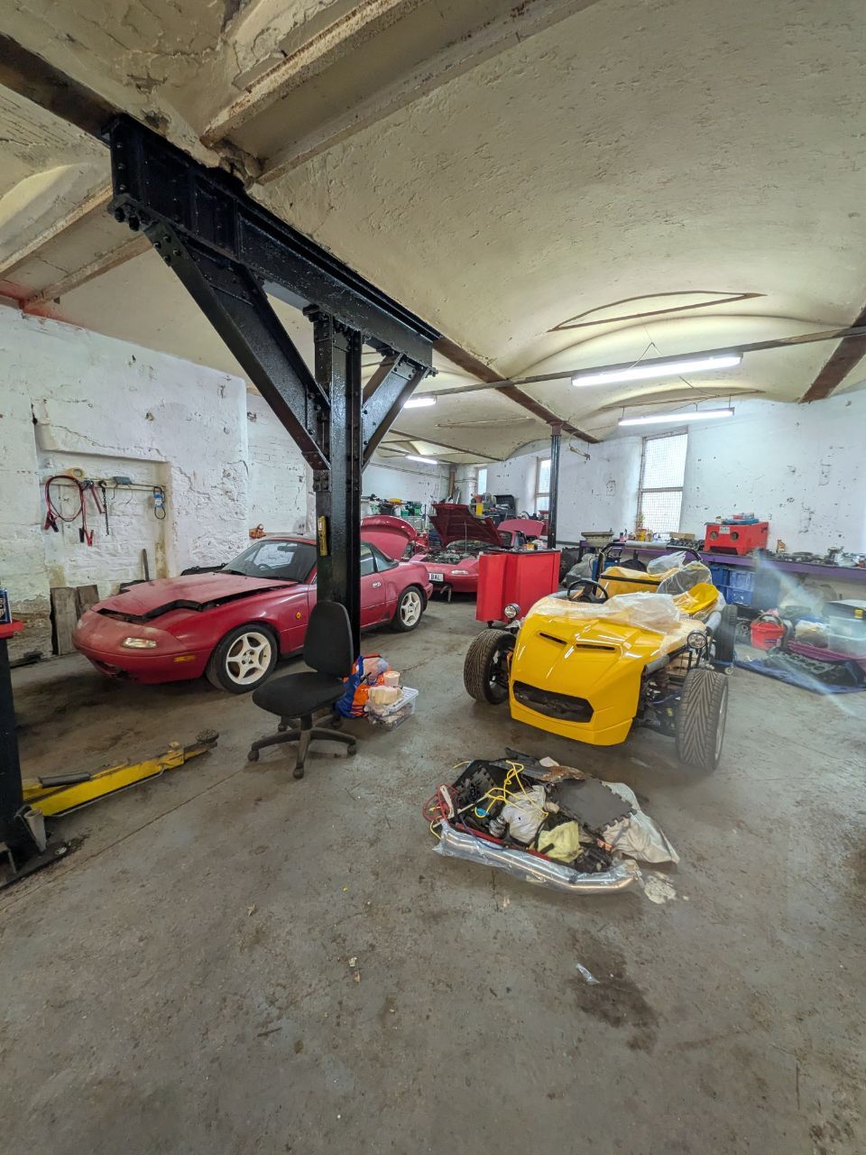

When I arrived Neil had already been fiddling with his mx5, ripping out the annoying immobilizer

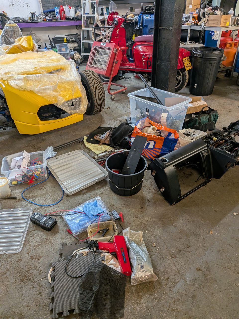

The garage at this point looking like it was breeding mx5 variants
PXL_20260616_150237110.jpg.edfd6a67b130e97728816070eca230c1.jpgPXL_20260617_064710955.jpg.230884fd96535bee71544ce992d83cf6.jpg

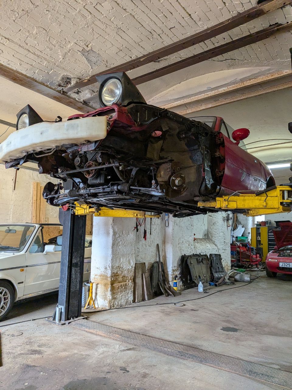

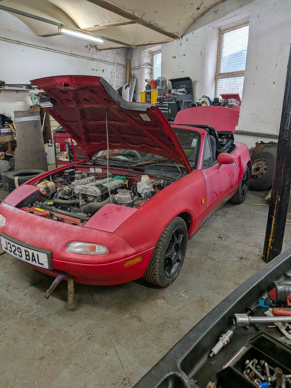

First up was bonnet off
A day spent fiddling, testing and fault finding was frustrating.  We weren't getting a spark or the fuel pump running.
Many bits were removed from the car.
Leaving a semi naked mx5
Neil ripped out the immobiliser on mine (so pleased with this) and I learnt more words to describe people who use scotchloks.
Also probably removed 3kg of random wires in the car that seemed to go nowhere!

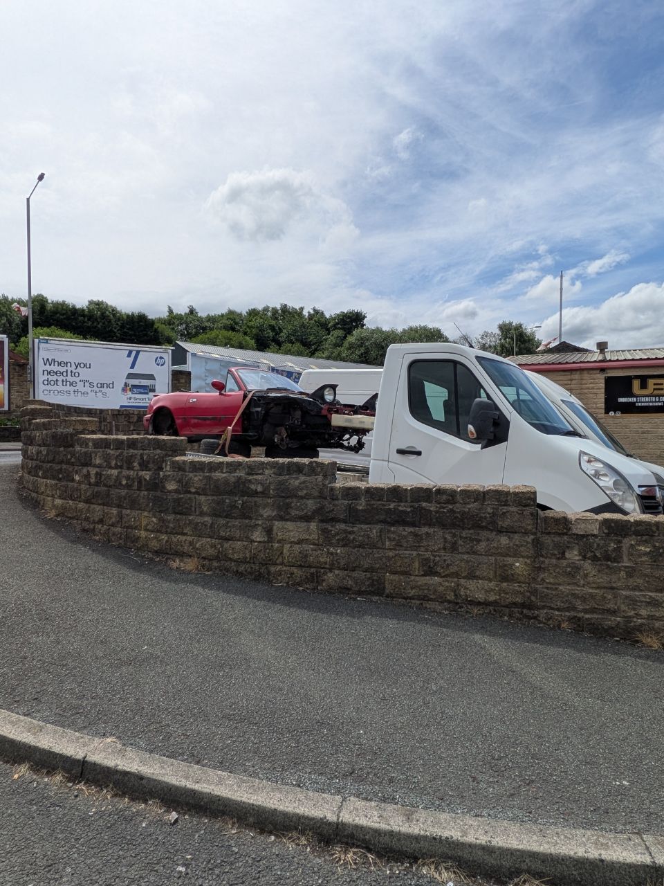

The power of Facebook marketplace produced a guy in Preston who fixed and broke mx5s.   I got an exhaust, ECU and main 100 amp bolt through fuse of him for get mine back up and running.
So this left us with a running (ISH) mx5 with no exhaust and no MOT.

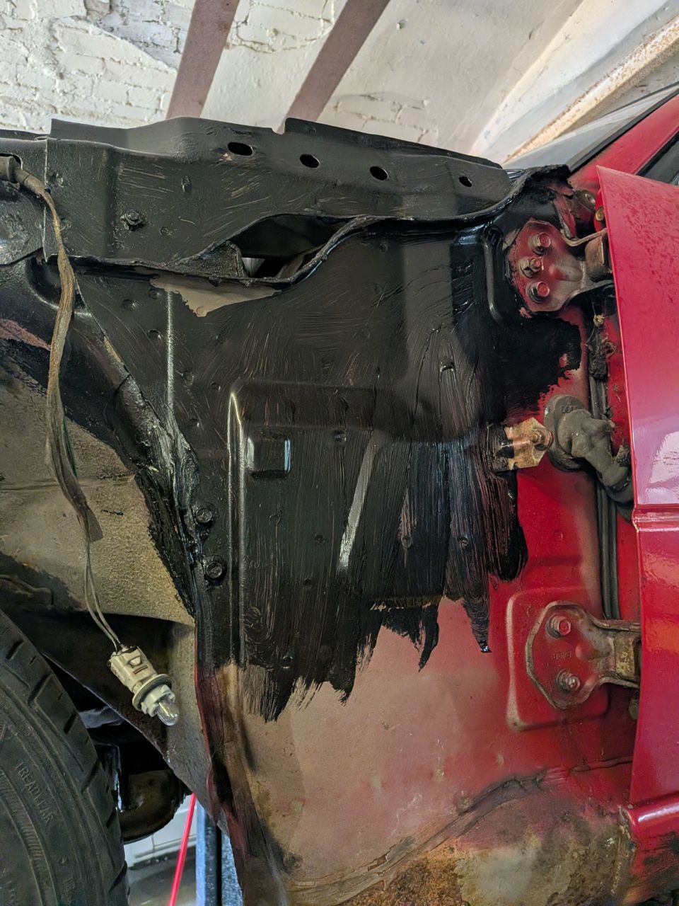

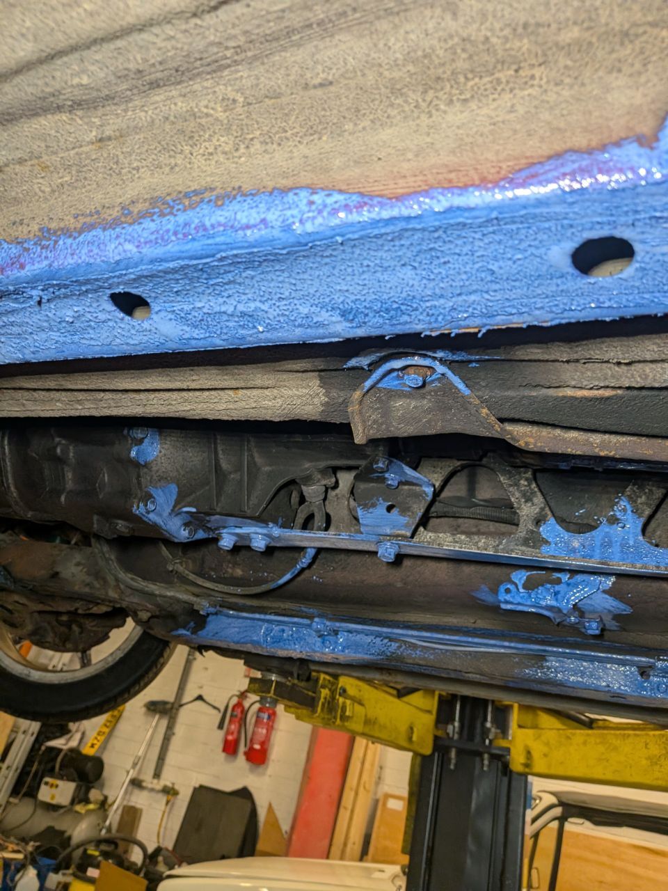

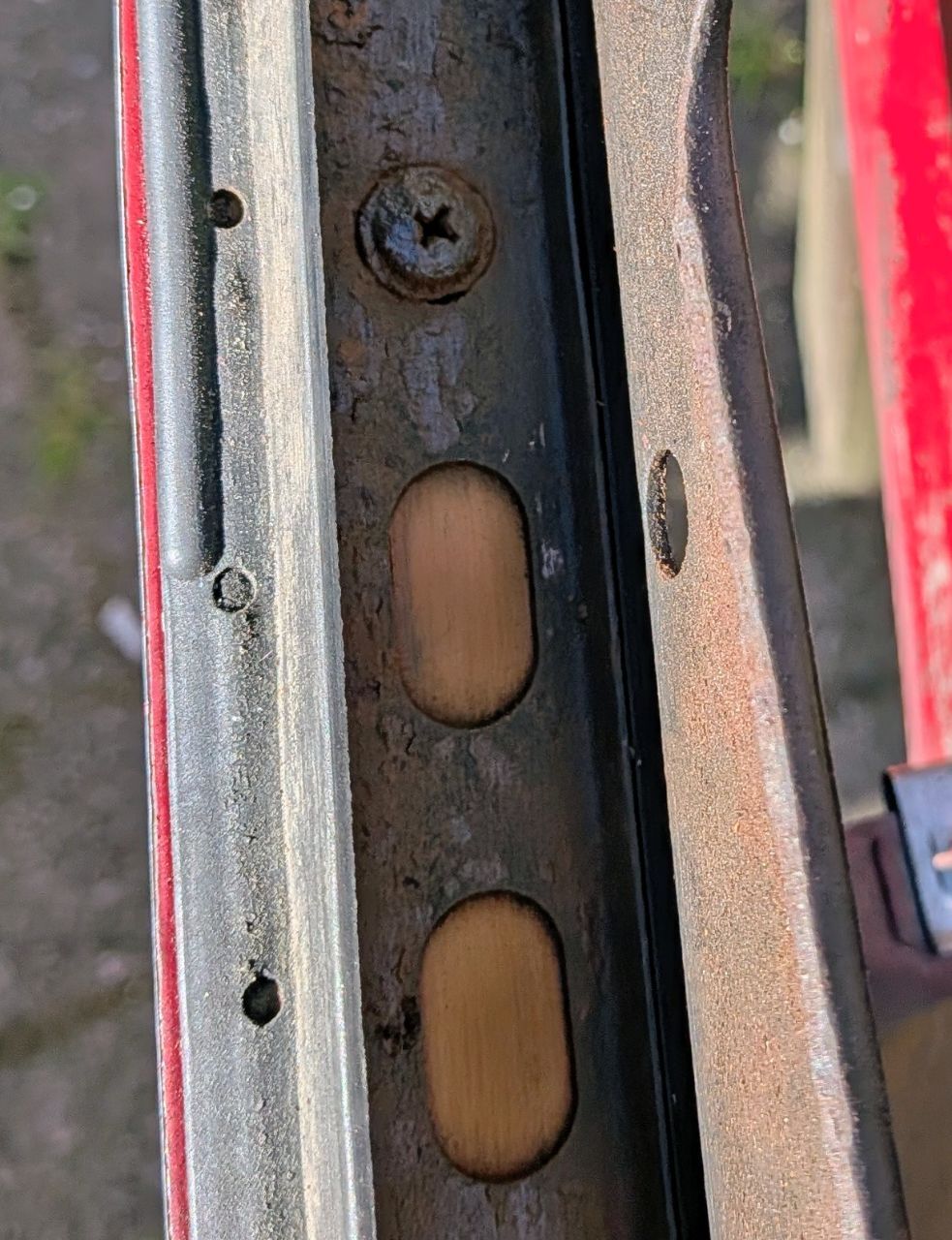

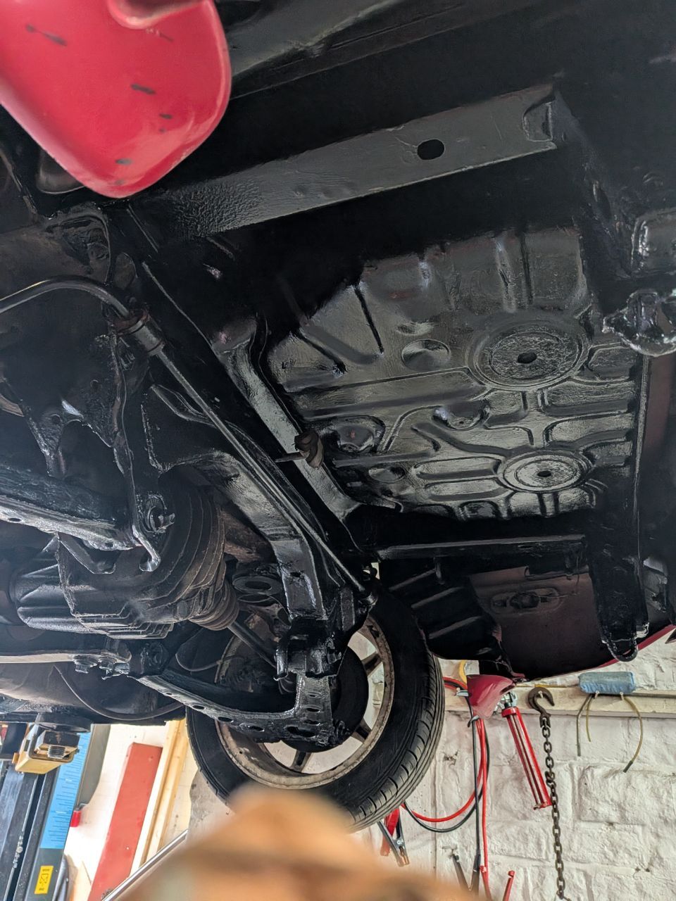

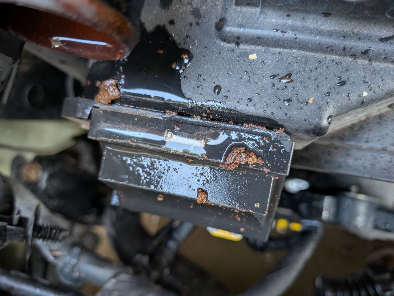

Up on the ramps and a thorough prodding revealed that welding might be needed.
All the leaves and rubbish had not only rotted the bottom of the doors but the end of the sills
PXL_20260618_210820629.jpg.f871034b444bf2d8df06b9be9e72b51d.jpgPXL_20260618_200217233.jpg.69e2a116700b9953be6994dd7827036b.jpgPXL_20260618_200218671.jpg.ebcaab2d83dd188ddbff41ee77bc3c3b.jpgPXL_20260618_211122831.jpg.1d1eca0e13b663b0275b4ee5e50fdbb6.jpgPXL_20260619_083714392.jpg.6bcd192e6f2758bfe2e750abf43ee9f7.jpg
First up was to wire brush, then vatcan the underneath before giving a coat of black metal paint.
My time was up, so Neil has kindly offered to weld the holes.

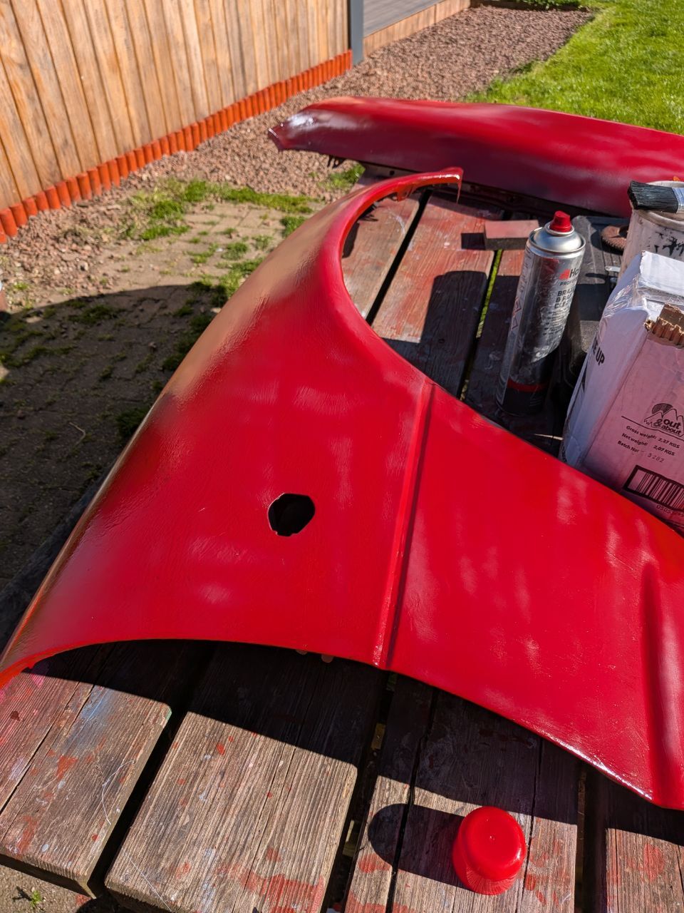

More car progress this week.
First up was sorting out the wings. I bought cheap red gloss from eBay.  I wish I hadn't had the coverage was shit.  But it will do for now.

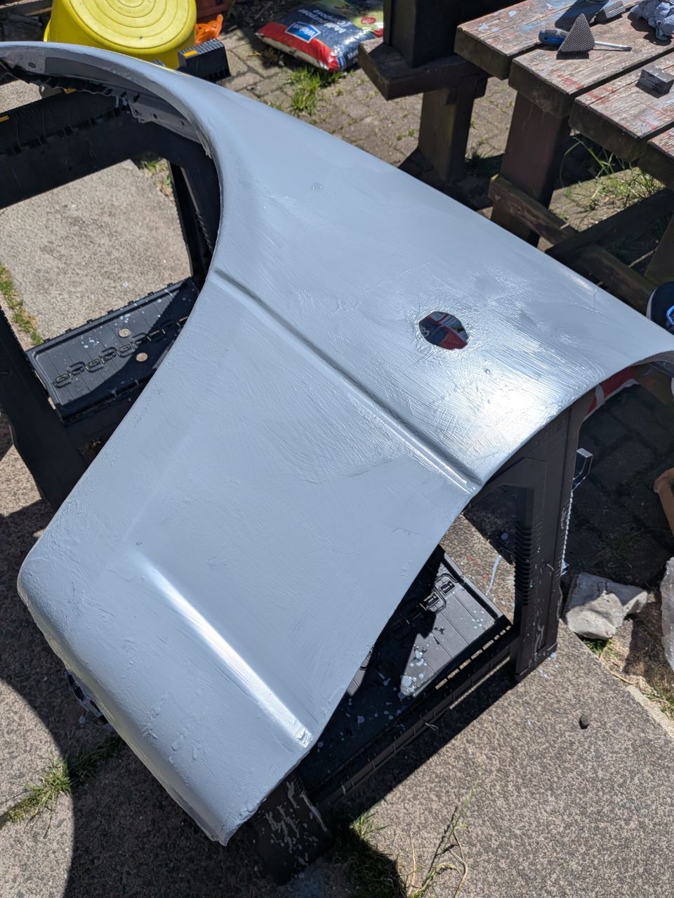

I also brought the nose cone back with me.  Had to cut off what was left of the old wing
PXL_20260623_1628540862.jpg.c2529da4fa0cb0e4fd8a21914117f892.jpgPXL_20260623_180427050.jpg.b1b9616e82262b1cb89b291f1c65d64c.jpg
I have ordered replacement panels for these
Then a quick sand and more coats of red gloss

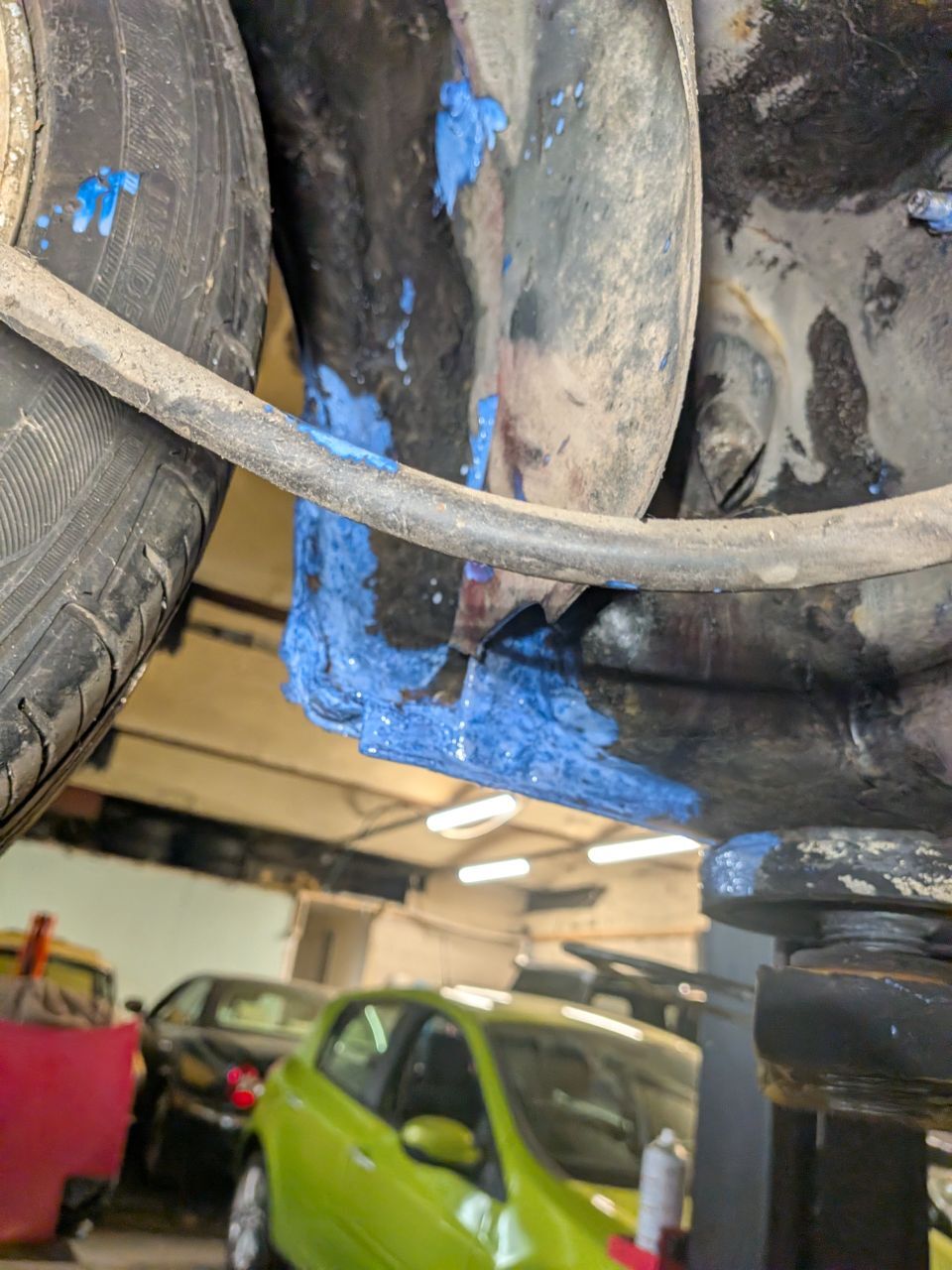

Round 2 on the mx5 this weekend. Departed at 3am to head south.
@NorthernMonkey has filled the rusty bit with some new metal.

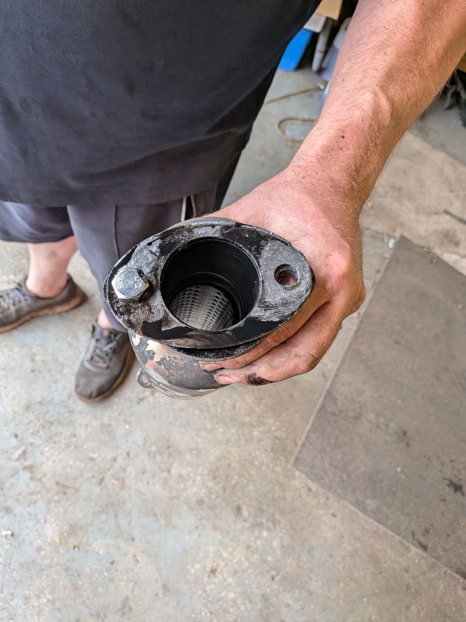

First things first was fitting an exhaust. That was a clusterfuck with loads of different sized bits. Luckily found something that worked and got the exhaust fitted. Also slapped on a pair of new rear calipers.

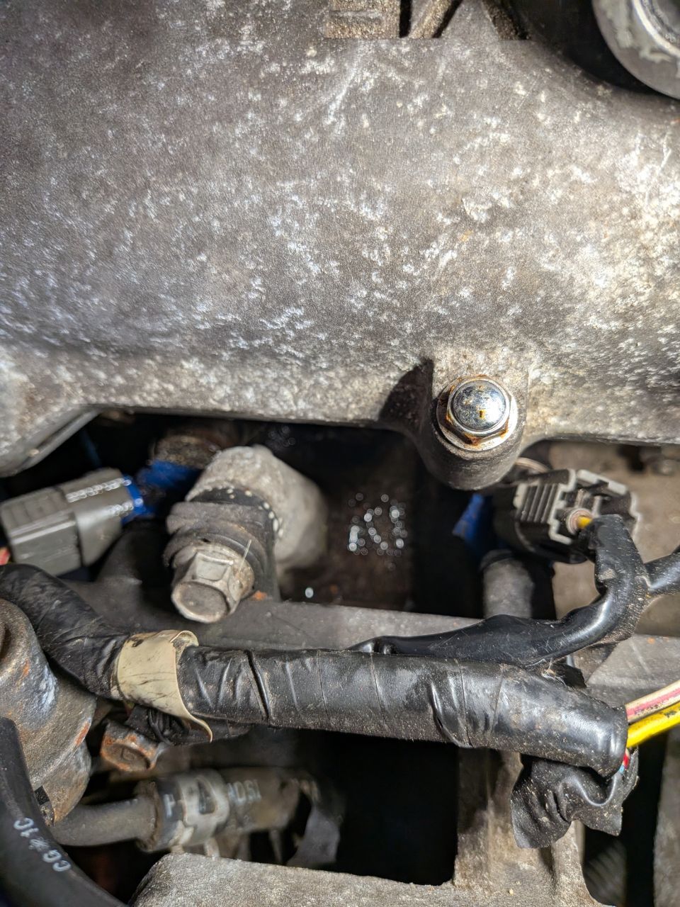

Started the car up and it ran ok.  Then noticed the smell - fuel leak.
Pulled the injector rail, and the oring had gone on one of them.  Managed to swap over the seals from my spare set

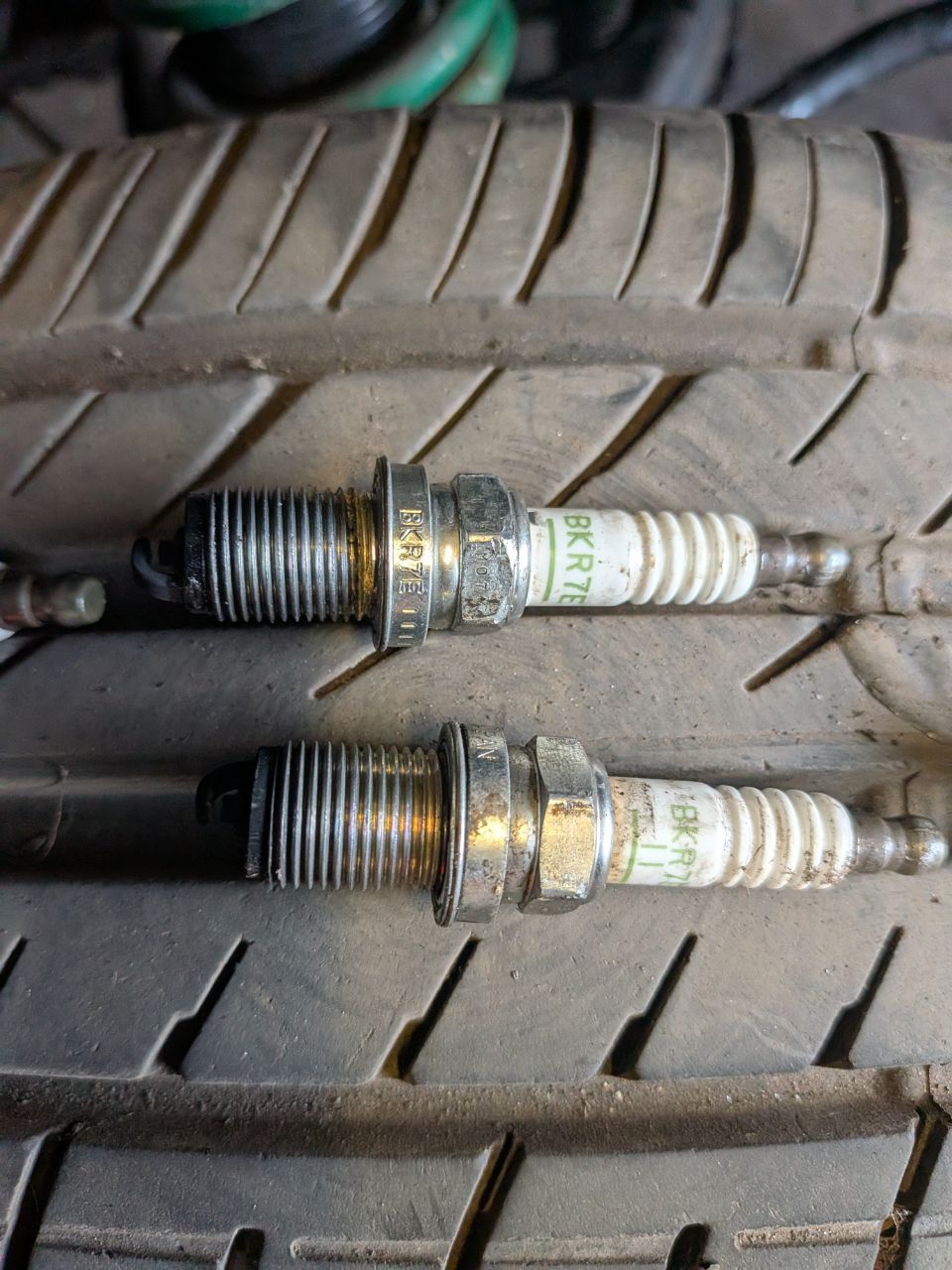

All done, turned car off.  Started it up again and it had gone to shit.  Wouldn't start, felt like it was misfiring.  White smoke out the exhaust PXL_20260627_165416476.jpg.e7760d3da2d1370cca629fca973a4aee.jpg

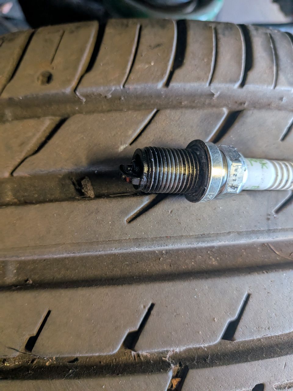

Pulled the plugs
PXL_20260627_164303472.jpg.8e1072766f77ded455325b706184ca6b.jpgPXL_20260627_164300554.jpg.d1319f94266a0fe53fd8440cec0565b5.jpgPXL_20260627_164301590.jpg.6ba6eec1dcb9b709104a8f2e1fbf2b07.jpg
Then did a compression test -200 across all cylinders except one was 190. So not too bad.
One thing that was noticeable was smoke out of plug 3
At this point we decided that it was a new engine time.  Taking into account everything the action was to strip all the good bits of this one.   They could go on Bal and make a better one.
Removing the exhaust showed it was full of oil even in the short time it was running
When Neil drained the oil, it was basically half fuel.   So piston rings or cracked something.

 And so here endeth my mx5 journey as NAs are a bit too much money for me now
It’s a shame as there’s fewer and fewer of these left but unfortunately, it’s not got a lot going for it.
The engine has excessive ring wear as oil consumption is horrendous, especially in cylinder three and four.
On top of that, the wiring loom has been butchered throughout, all the body panels are damaged throughout and the roof is knackered.
I was prepared to let Will have my (his) old one which is mechanically sound but when we got it up on the ramp, the underside corrosion is extensive and both rear wings are rotted away at the base. It’s been decided that some of his fancy go faster MX5 bits in PX along with some repair panels he’d bought that will give my old NA a new lease of life. That way, at least one Mazda can live on from the pair of them.

I set about the golf today, the new rad is a high flow version.  It was a returned item so was a bargain.
The old one was knackered and leaking. PXL_20260702_125923924.jpg.b2d53f4ea87b5e7587c6e77300f094db.jpg
The bolts that I had taken out, I forgot to stick them in evaporust to clean them up.  Plop them in and set about replacing the lower front wishbones.
Drivers side was ticking along nicely until one of the subframe bolts snapped.
PXL_20260702_150612419.jpg.ef2d801dabb7694f6b5a7bd54af4b56b.jpgPXL_20260702_141811390.jpg.c4c51e54787b63bebb945e7af1aaa0b2.jpg
I did big swears and packed the tools away.  Ordered replacement bolts for both sides and also a secondhand bracket they bolt into.
I will try with a stud extractor at the weekend, but might just swap the bracket over.
Should be plenty of thread there to get it out with a double nut method?
Hope it will come out, the threads are shagged.  Was pretty seized, so for a cheap subframe bracket as insurance I will give it a go with a stud extractor which should grip it!

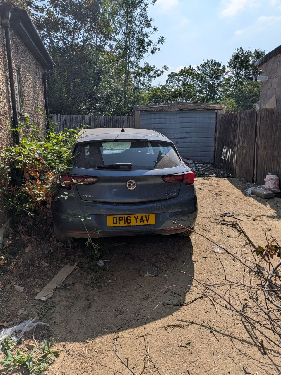

Yesterday I went to view a car with a potential to do a buy.
Firstly I needed to go all Alan Titchmarsh ..
Jump pack on and it purred into life
Need hazmat to get in though
But luckily someone had foresight to leave handbrake off

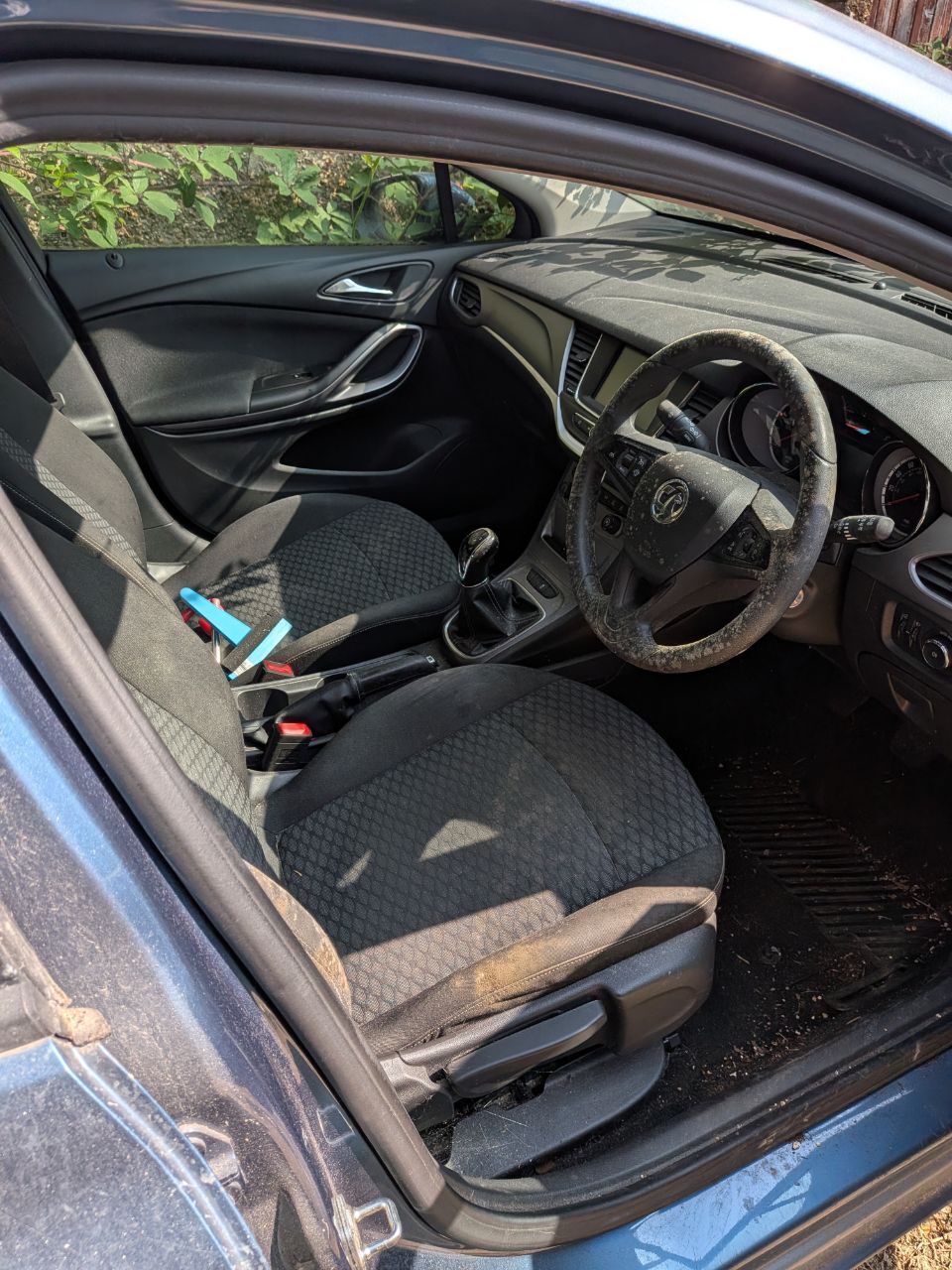

No fault codes and idles well
PXL_20260718_090026497.jpg.caa645c90abd64abb4e6b0a126ab8033.jpgScreenshot_20260718-100021.png.4fbb86a902c09708436e8ba5184e70e2.png
Battery is properly shagged so will need to be replaced but boot looks good
Coolant is nice and pink

Then found this in the coolant to expansion bottle hose PXL_20260721_152936216.jpg.6e133c685dbfcc491a28f266d4e699a3.jpg
It is a piece of rubber. I am assuming it is something like the thermostat gasket.  All runs clear now, but will swap out the hoses then see if it is fixed.
