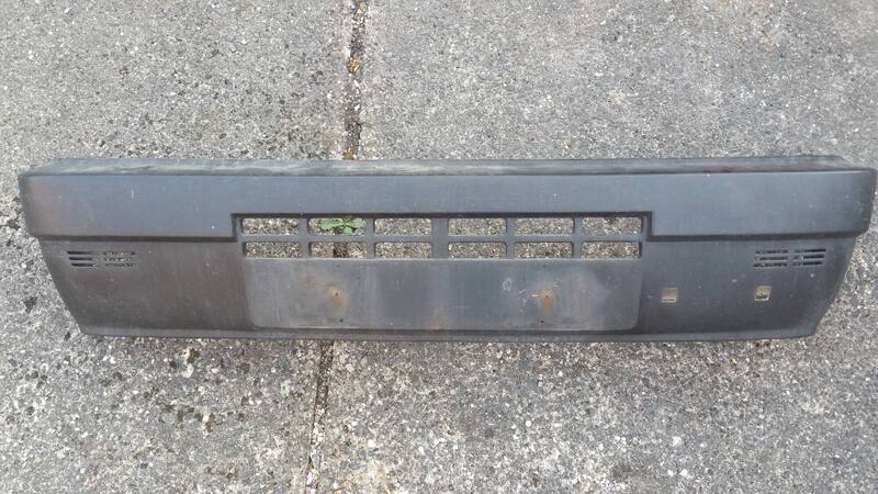

The front bumper was minging, so I have it a good wash them a quick wipe over with WD40, it looks 100% better.
Unfortunately one of the side fixings on the inside of the end had broken, so I glued it with some magic glue I had in the van.

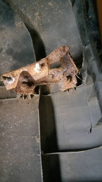

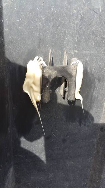

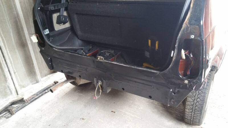

The rear bumper has never sat straight, it's had a knock on the drivers side rear corner and it's pushed the bumper in, the mounting brackets are a thin pressed steel sort of parrallelogram affair, all* I needed to do was whip the bumper off, straighten out the brackets and job done...
20200429_152424.jpgerr, no.
As you can tell, from the photo above of the better one of the two, they're knackered. Unbelievably they're available new from various sources, I've ordered a couple, I could have made something up but with them being entirely hidden alignment would have been tricky and I've got plenty to get on with. They're held on to the bumper by a bolt with a large square head that sits in a plastic slot moulded into the back of the bumper, of course when I tried to undo them the plastic just deformed. My preferred method of removing nuts like this is to drill down the side of the nut, usually once is enough to weaken the hold but in this case each of the four nuts needed drilling twice, even when I'd done that I had to lever the nut away from the metalwork of the bracket, it was comprehensively rusted together.
20200429_155043.jpgThey did all come off OK, I should be able to run a die down the threads and re-use the bolts. Because it's a Fiat there was a little rust proofing to be done. It's not too bad considering its vintage but there were a few places that needed attention. I got busy with the wire brush and then the Kurust stuff. With any luck I'll be able to give it a coat of paint tomorrow, then it'll be ready for the bumper to go back on when the brackets arrive.

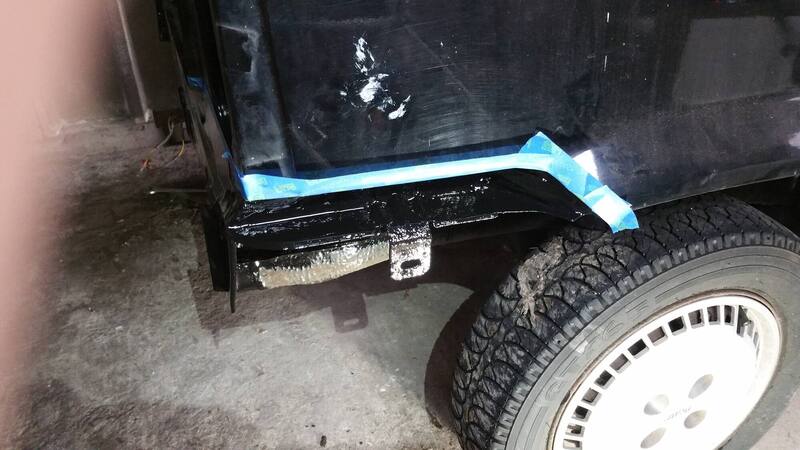

I gave the rear panel a coat of paint, it's black but doesn't match the original colour, it doesn't really matter though as it's all hidden behind the bumper, what's important is the corrosion protection!
The new bumper brackets arrived after OMGcovid19postaldelayexcuse and I fitted them using new stainless nuts and washers. I haven't got my tap and die set at my place so ended up cleaning the threads on the special bumper bolts using a needle file... It was a tiresome job!
After giving the rear light clusters a polish and cleaning up the number plate lights I got giddy reassembling the rear end, as a result I forgot to take any 'in progress' pics, so you'll have to make do with the one I took at the MOT station.
I'm still not entirely happy with the bumper alignment, even after three attempts, but realistically it's a bottom of the range Fiat from the '80's, so it's probably better than when it came out of the factory.

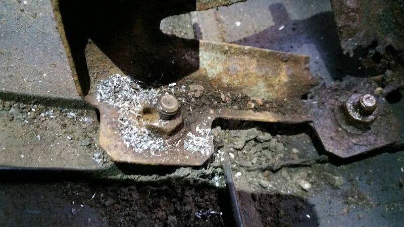

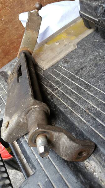

I didn't want to waste the afternoon so I thought I'd tackle the spectacularly floppy gearshift. Part of the mech features a rod that rotates in two bushes, at the top of the rod are two flats and a tab locates on these flats and transmits the rotating movement to the gear linkage at the gearbox end.
Unfortunately the flats had begun to round off and allow some play, although not much, it was greatly magnified by the long gear lever. To further compound the difficulty of fixing it, the nut that holds the tab on is prevented from undoing itself with a blob of weld, why Fiat chose this instead of a nyloc nut is beyond me. Anyhoo, let's have some pics and a video!
I came up with a couple of methods of fixing it but was limited with the tools and materials available.
Recently I've fitted quite a few shower screens, (bear with me, this is relevant), they come with a 2.5 mm drill bit to drill through the wall profile.
I have loads of these drill bits in the van, so I used one to drill in between the top of the rod and the edge of the tab, possibly better illustrated in the pics above, then I ground a small length off the chuck end of one of the bits and used it to make a 'key', I'm sure there's an engineering term for this.
It worked, really well, I don't know how long it'll last bit of it starts to go floppy again, ooer matron, then I should be better placed to make a different, hopefully more permanent repair.
Apparently an axially drilled cylindrical key is a Scotch Key or a Dutch Key according to Wikipedia; it doesn't explore the etymology though. I've used this a few times myself when short of the 'right' materials.
Cheers, that description is much more clear and concise than my drivel!
I think the right material to use would be silver steel, but I'm guessing the end of a drill bit will suffice.
Even cheapo drills are high speed steel these days, so more than tough enough and better than silver steel which is just high carbon steel usually supplied in a polished and semi-hard state.
Seem to remember my Panda was slightly earlier so not sure this, which is keeping the spiders amused in the garage is any use to you.
Can't picture quite what you both mean but at work when a bore is sleeved to return it to a size, the sleeve is shrunk in and then as a belt and braces the gap between the two is drilled and tapped in a number of places and then grub screws put in. This is what we know as scotch keying something.
@busmansholiday that's a really kind offer, I'll take you up on that please, I'll PM you, thanks!
@Matty that's pretty much what's going on here, except it's not a threaded grub screw, just smooth. It's held in by the washer and nut on top. It's a genuine engineering 'thing', just not executed in a manner that would please a genuine engineer, if you get my drift.
You can just about make out the flats on the end of the threaded section, circled, the metal tab is fitted in this picture and is pointing to the top left. The arrowed part is the end of the drill bit that I used as a key. Ideally it would be exactly half way across the threshold of where the two parts meet, but working in the back of my van, using the tool box as a bench and drilling with a battery drill was as ideal as I could manage! It works though, so it'll do until it starts getting sloppy again.
I hope that makes it clearer.

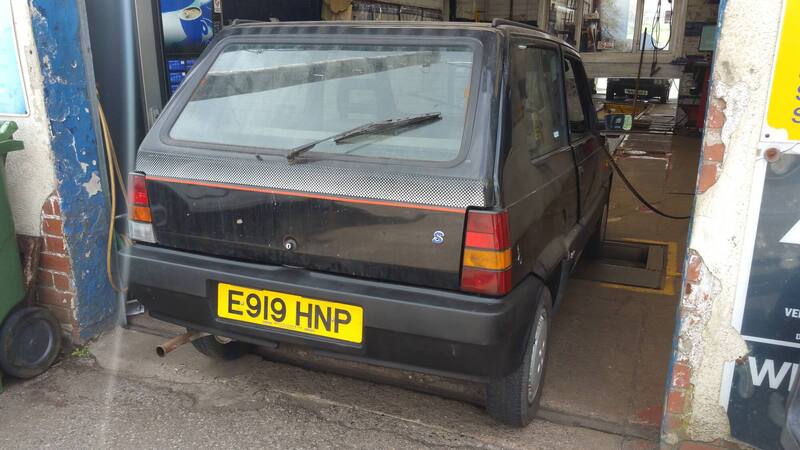

Wow! It's been 20 years but earlier in the week this car passed an MOT! As detailed in an earlier installment, the drivers side rear brake cylinder was seized and there was a damaged dust cover on a front ball joint. Miraculously the brake cylinder came off with no drama, the new went straight on and bled up easily. The dust cover wasn't much more difficult, just a little persuasion needed to separate the ball joint.
Having got the car back I decided to wait until June 1st to tax it, mainly to spur me on to do a few more jobs on it.

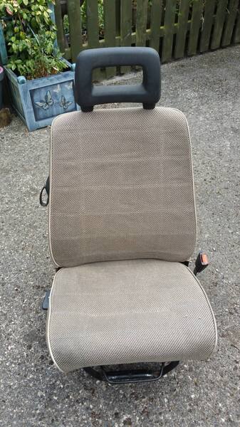

Previously I'd taken the back seat out and cleaned it, it came up well and I decided to take the front seats, the drivers in particular had acquired a thick layer of grime, like somebody had been driving it wearing greasy overalls.
I elected to take the seats out and remove the covers, it didn't take long and I put them in the washing machine, 40° easy care, in case you wondered. I have them a good scrub first using upholstery cleaner.
The difference in real life is even greater than the pics, I did both front seats and also cleaned the door trims, I'm really pleased with how it all came out.

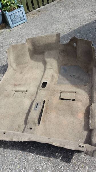

After removing the front seats I pulled the carpet out too, it's a 15 min job and it too was filthy.
Again, I'm not sure if the pictures show how much better it looked after cleaning.

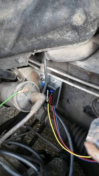

On the recommendation of another forum member in a different thread, I ordered a Gammatronix Power Driver, it's a little box of electronic gee gaws that is triggered by the points but without them having to carry a lot of current, it also replaces the condenser. I couldn't try it out as the battery was flat when I got to the car and wouldn't charge, I'll pick a new one up on Tuesday.
Anyhoo, I whipped up a little ally bracket to mount the box of tricks on and bolted it up next to the coil.
Everything shrinks with age; those things were massive in the 80s.
Ha ha, I remember those!
The thing I've bought was only about £30, I can't remember how much the Sparkrite was but it'll have been more than that, even in the '80's.
