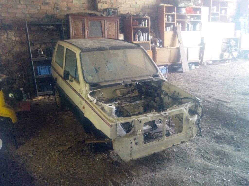

Those with a long memory may remember me talking about a mkI Panda 4x4 project a while back?
Well, my brother in law had the idea to buy one with sound body and in need of mechnical work to fix it up. They are getting rare and prices are on the up here.
Well, he found a "solid" one and bought it. Turned out his idea of solid differs from mine.

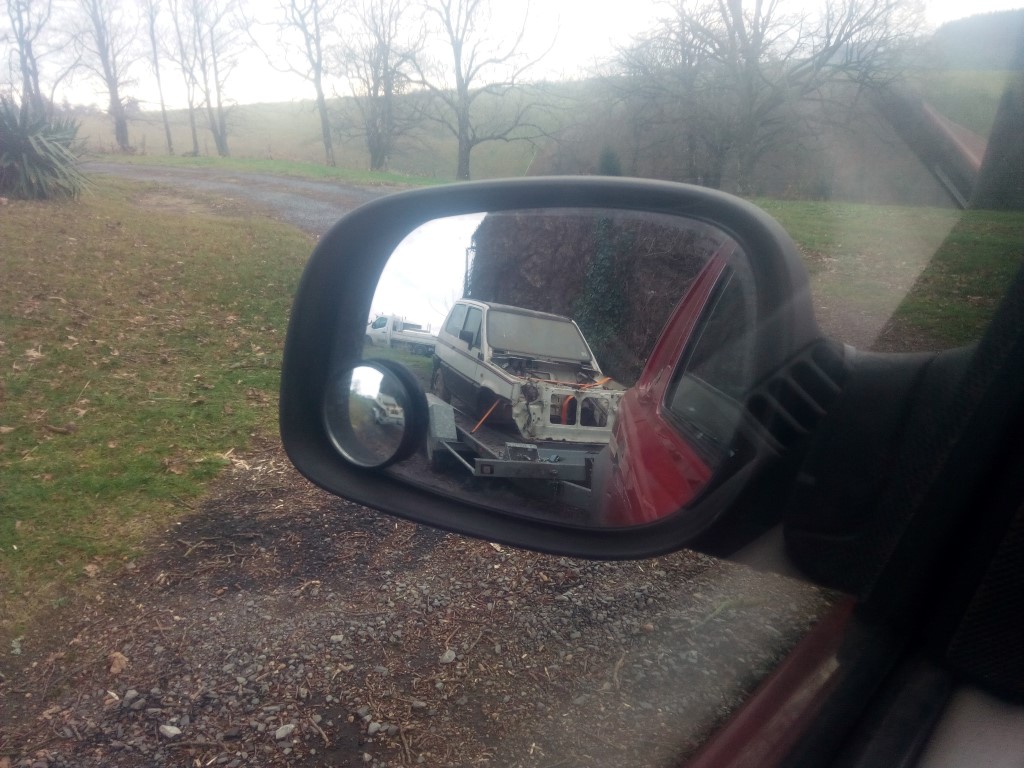

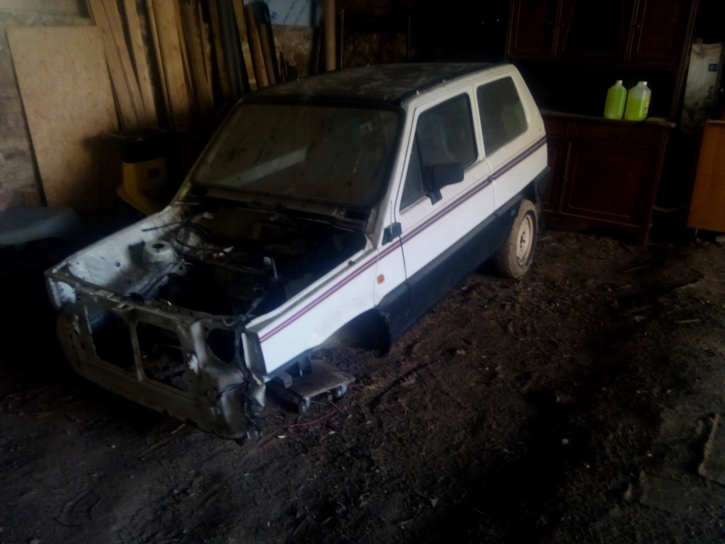

The numpty then took it to bits the day after we brought it back to the farm and its sat untouched ever since. That was May 2014.....Thats poor progress even by my standards.
How it looked then....
Since then, nothing has been done. It has collected a lof of dust and Kevin the farm Peacock likes to stand on it and shit on the roof.

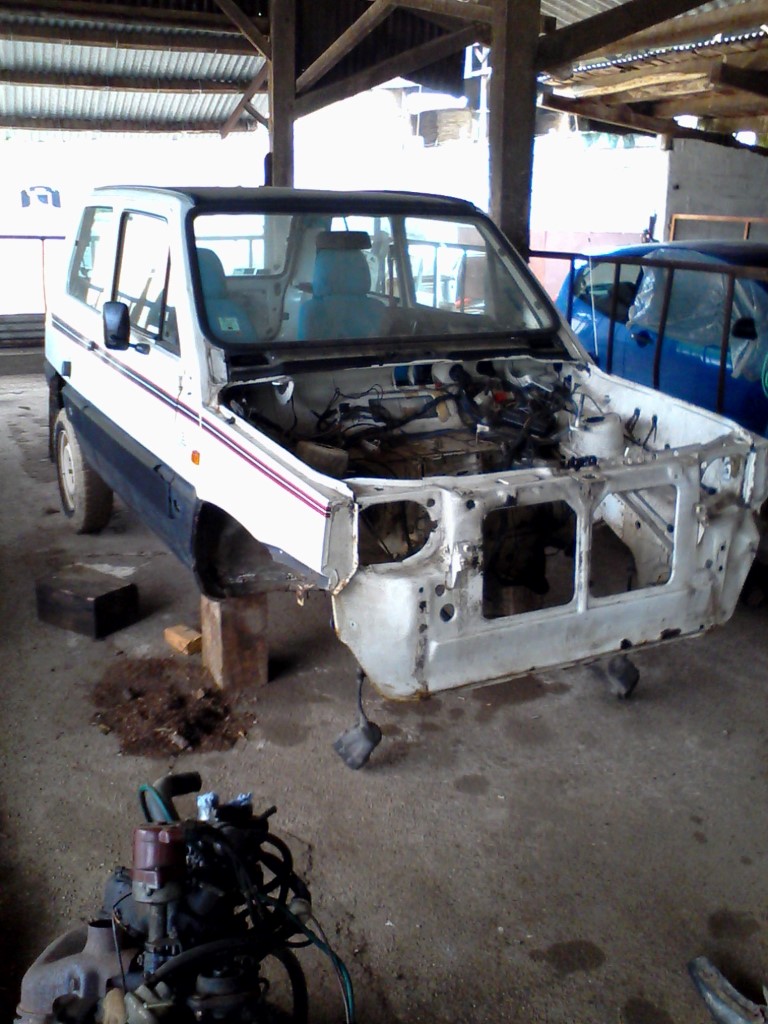

Brother in Law has realised he will never do anything with it so handed it off to me. First job today was to shift it to my garage, which would have been a lot easier if the fanny hadnt taken the wheels off - not only the wheels but all the boingy bits that the wheels fix to. So lots of huffing and puffing and it was on the trailer, balanced rather precariously right on the tail end, but its only a mile or so, so no problems.
Deposited chez moi. Those plywood boards with castors fitted would be great for shifting it if my garage floor wasnt just fecking dirt.
More huffing and puffing and its found its new home.

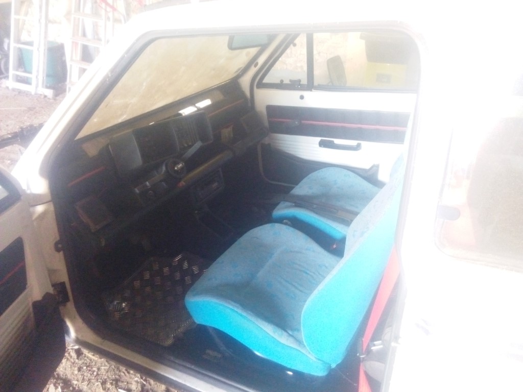

The interior... Not original seats.

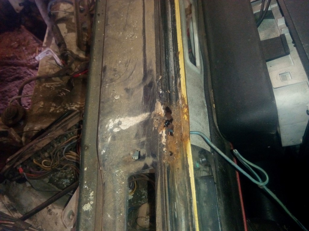

A very quick initial survey shows metal insertion required in various holes.
This hole at the bottom of the windscreen is only small, but we all know that once the screen is out its bound to be much worse...
Inner wings need work.;;

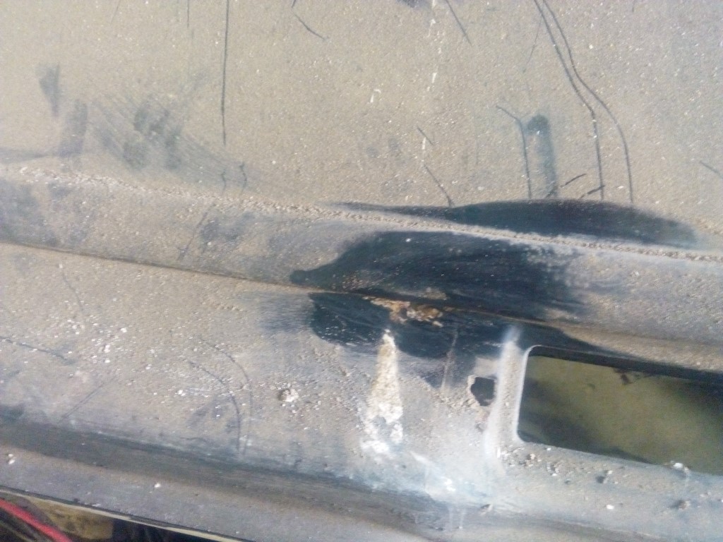

Front valence...

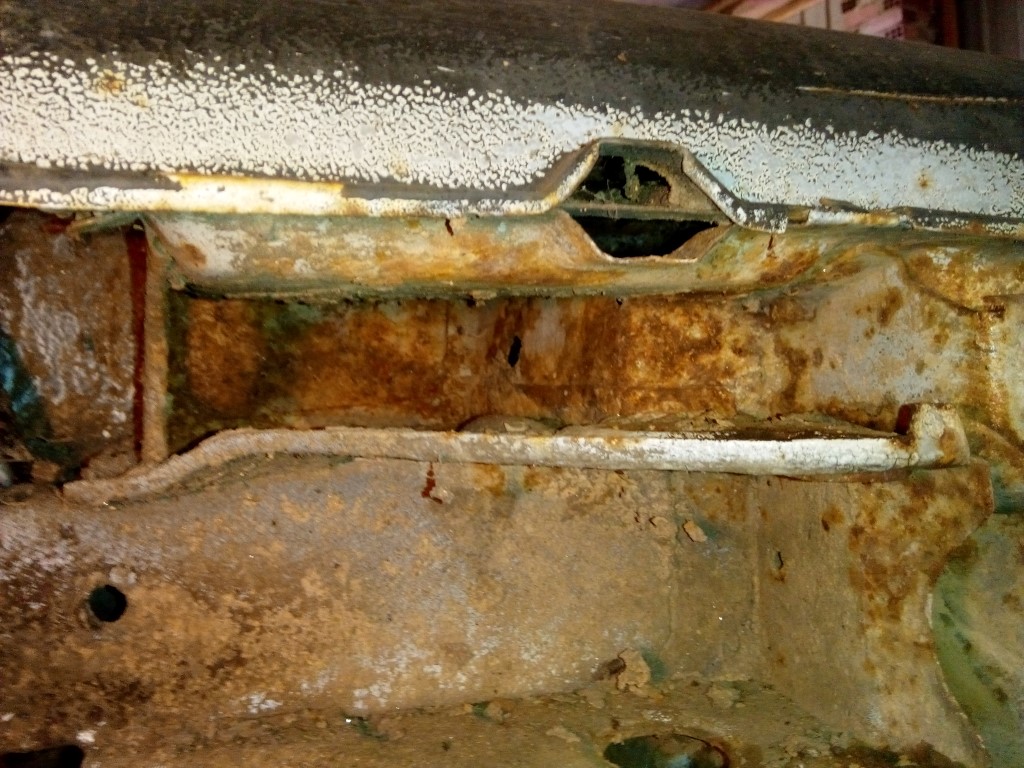

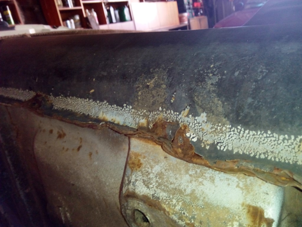

The end of the sill on the front wheelarch...

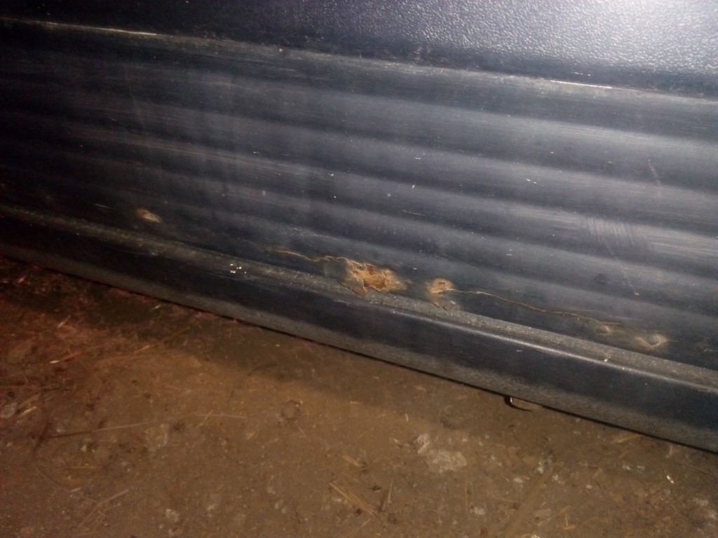

Bottom of the door....

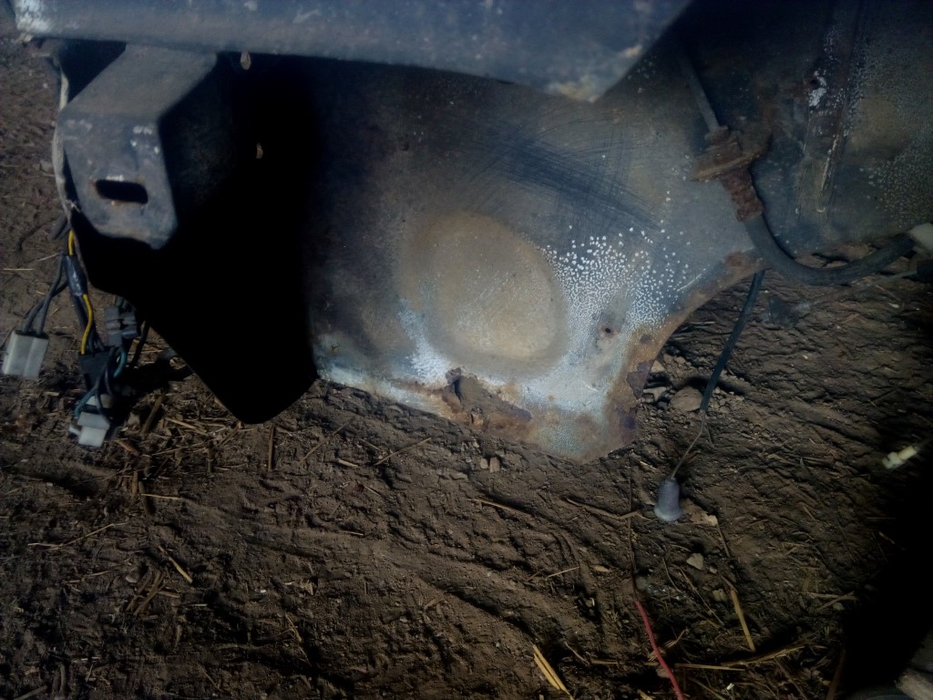

Inside the boot, the rear wheelarch....
The sills qnd floor seem solid but will need proper investigation.

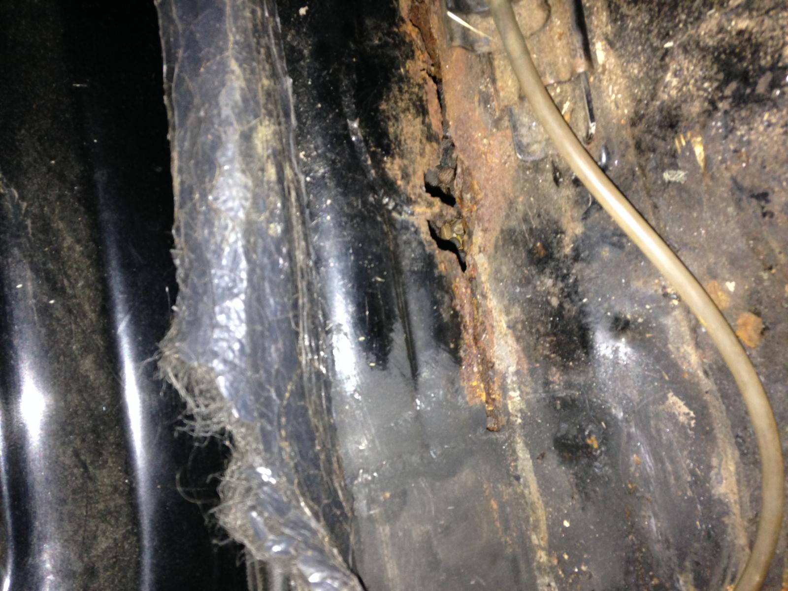

That doesn't look too bad from what you've posted. The usual rot spots but not too far gone yet (fingers crossed...)
Take the carpets out and check the inner sills where they meet the bulkhead. They rot from the inside as crap gets in behind the '4 post lift' point. Same for the rear sill alongside the leaf spring mounts. Also check the boot floor where it joins the rear wheel tubs, another common spot...

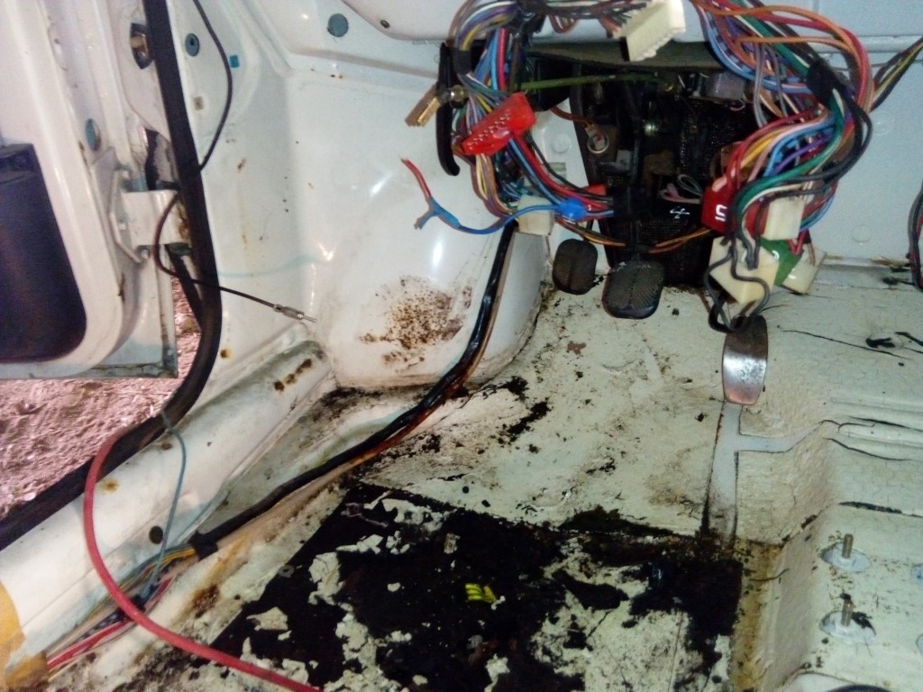

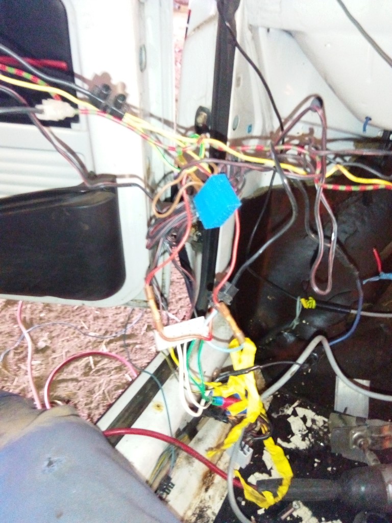

As an ex stereo installer, stuff like this gives me The Rage. How can anyone look at this and think "Yeah, job done. That will never cause intermittent faults or catch fire."?
Speaking of potentially catching fire....
This was the wiring for four halogen spotlights on the front bumper, drawing nigh on twenty amps through this spaghetti and a teeny wee rocker switch.
Oh God, please make it stop.....

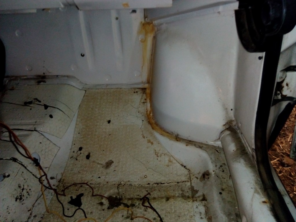

Some staining from a water leak. The carpet and sound proofing was piss-wet, which probably was actual piss since the car has been under cover for a year and a half.
Boot floor is nice too. Dirty, but solid.
Windscreen removal went exactly as anticipated.  :roll:
The rust hole is where a wee drain tube should be under the seal. The other side has surface rust starting.
Not too hard to repair, I should think.

Its all very solid. Lots of surface rust though, so looks like it was caught just in time. It will clean up nicely with a wire brushing and rust treatment.
Sills are fine apart from the lip suffereing from careless jacking in the past. should straighten up ok though.

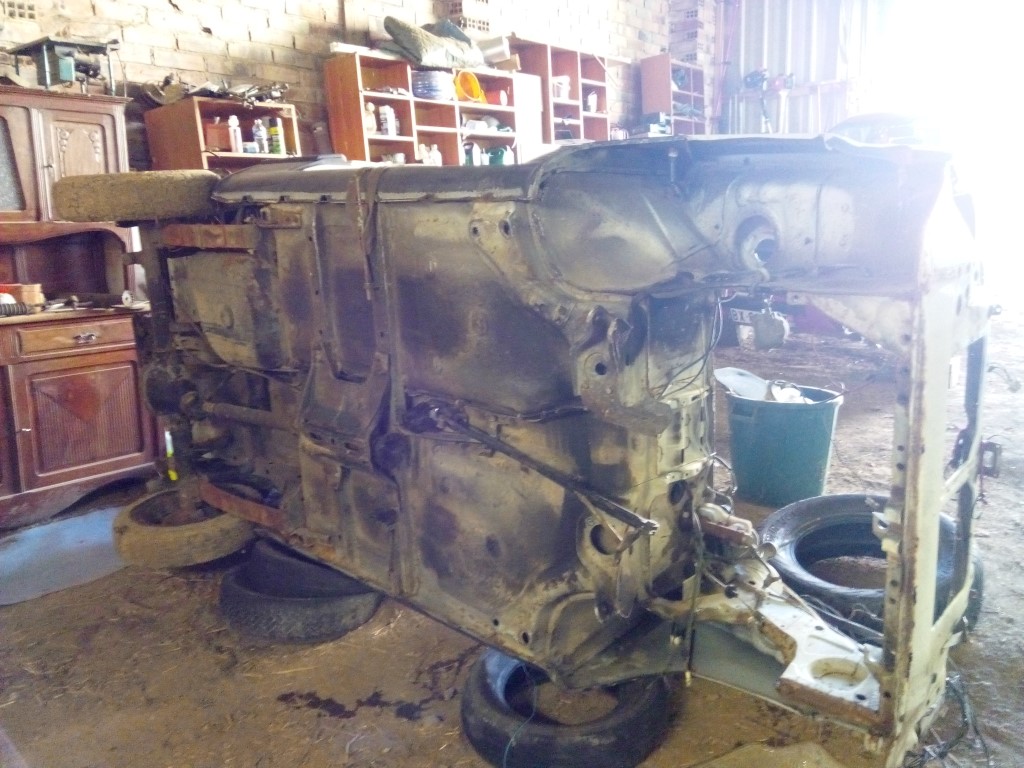

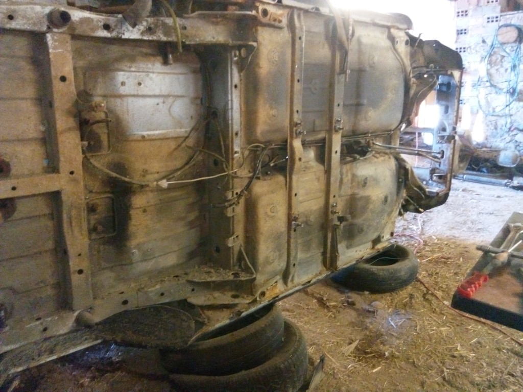

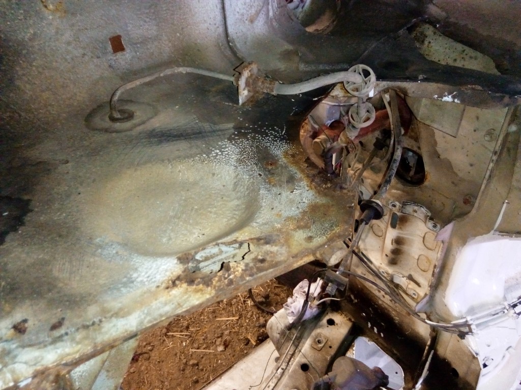

I then fired up the MIG and repaired the hole in the front end of the sill and the rear wheel well. This just leaves the valence and screen surround, which I will do once the shell is back upright.
I then put goggles on and went at the floor with a knotwheel in the grinder. In the end it only needed a light skim to get the crud off as it still has most of the original rubbery underseal stuff. I then wobbed the first layer of paint on the floor....

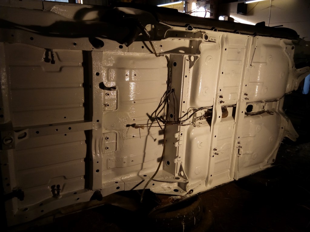

Its Rustoleam gloss white and once the second coat is done should look minty.
So tomorrow will see the second coat done then I will have to wait for it to dry until I can turn the shell over the other way so I can weld up the left hand inner wing.

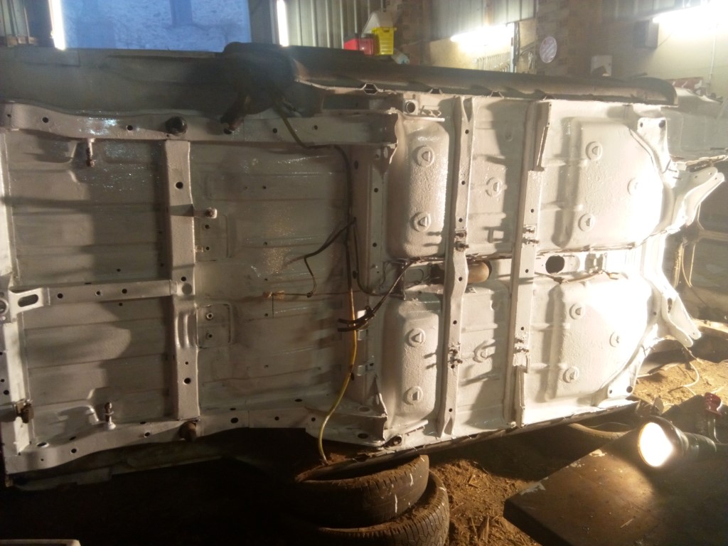

Second coat on the floor is done.
Photos look much the same as before but coverage is much better in real life. Its probably going to be a couple of days until its hardened enough for me to flip the shell over the other way and set about the rest of the repairs, so in the meantime I started tarting up some of the other bits.

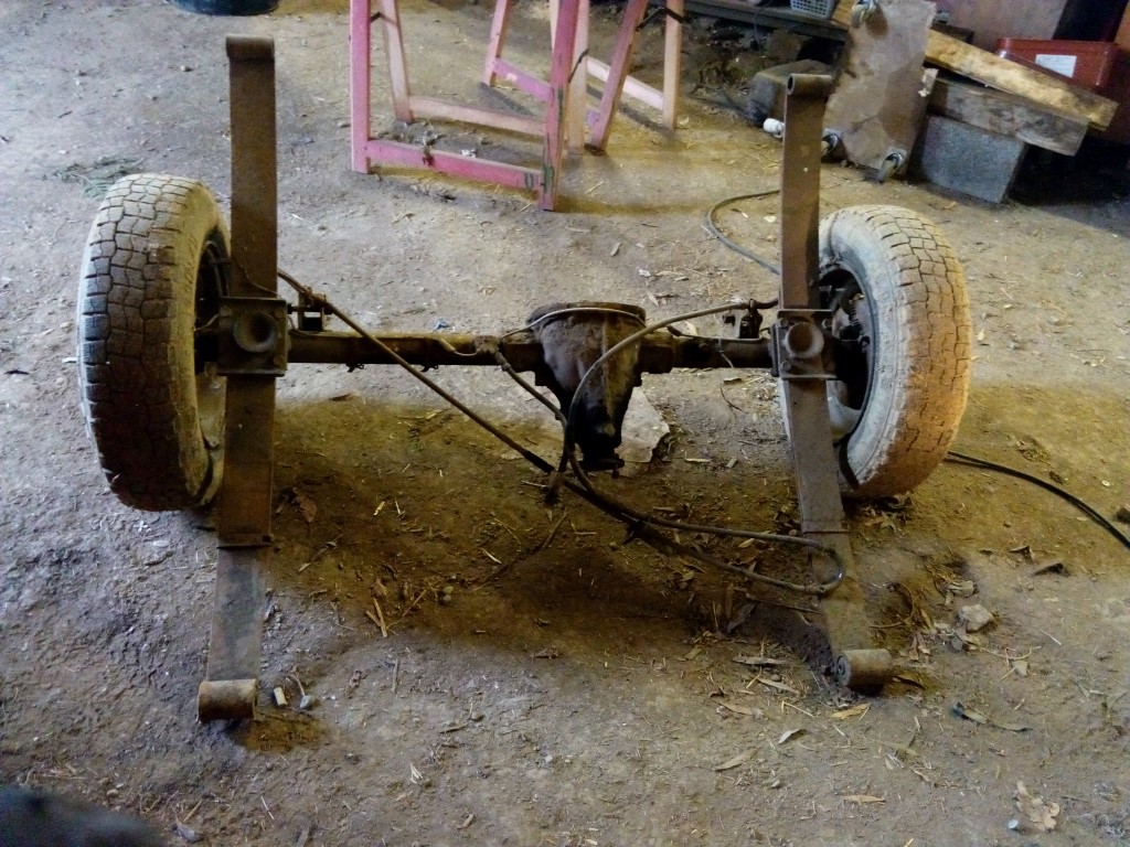

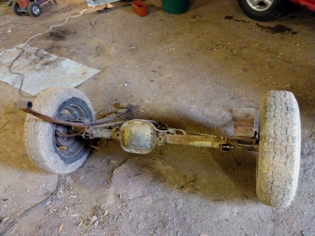

Rear axle time.
It looked like this.....
With the drums off, everything is in pretty good shape, no sign of fluid leaks and the shoes are ok, so a good clean up, wire brushing, degreasing and then a dose of black.....

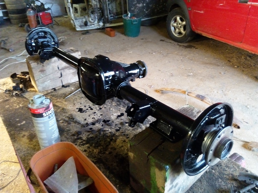

Another coat this evening, then I can re-assemble it.
Im not sure what to do about the leaf springs - I guess I will paint them black too.
Whats weird is this clamp has been welded to each leaf, which I would guess is not original. Neither leaf is broken and the weld doesnt look like its burned in deep, but still.....not ideal IMO.
I think the clip is original to prevent the leaves splaying apart but mine have been welded on. I dont think you are supposed to weld spring steel.
Whatevz....It lasted this long, it can stay like that.

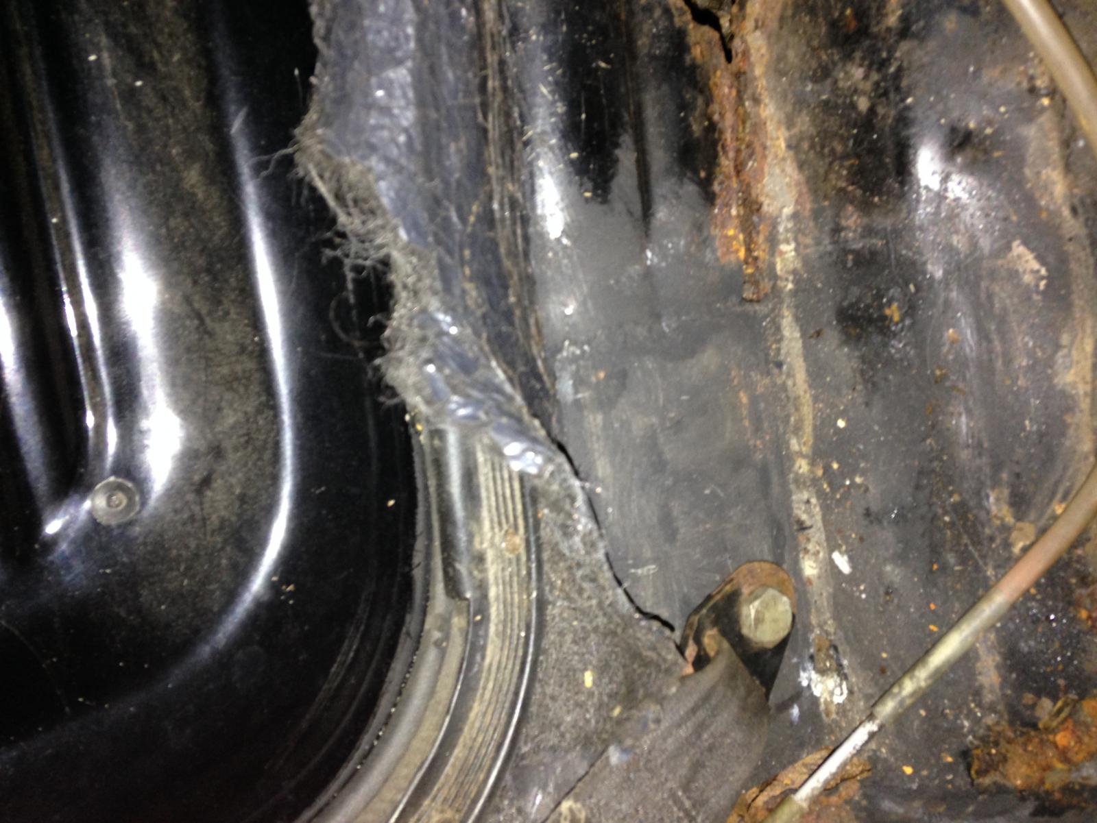

And found this bit of seam in the rear wheelarch which is starting to go.

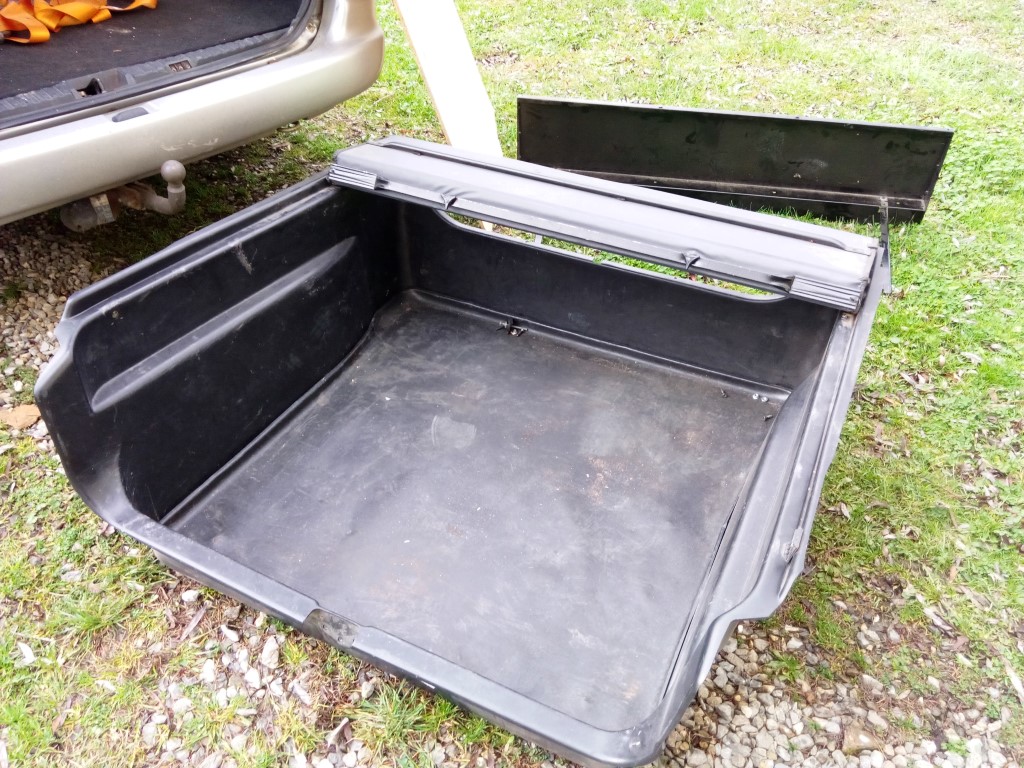

All thats fine and well, but the exciting* news is todays adventure. I saw an ad on LeBonCoin for something I wanted so I fired up the Escort and slogged through to Toulouse. Uneventful trip with the only on the road spots being a Renny 5, and an old 2CV wheezing along the autoroute.

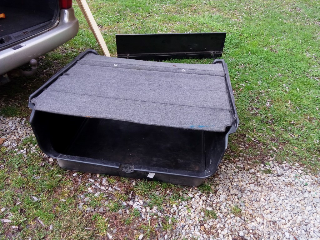

What did I buy? well its a specially made load liner for a two seater Panda! Apparently EDF bought a load of 2 seat Panda 4x4s for linesmen to use and these boot liners were made for them.
Its a hefty plastic thing with a double floor for strength that fits the whole boot and rear seat area.
The top load cover concertinas back out of the way.
There is a metal bulkhead of sorts that goes just behind the front seats.
The wood against the car is a base for the load liner to sit on. this is snapped in half but easily replicated in a new bit of plywood.
I am dead chuffed with it, its in better condition than I expected.
