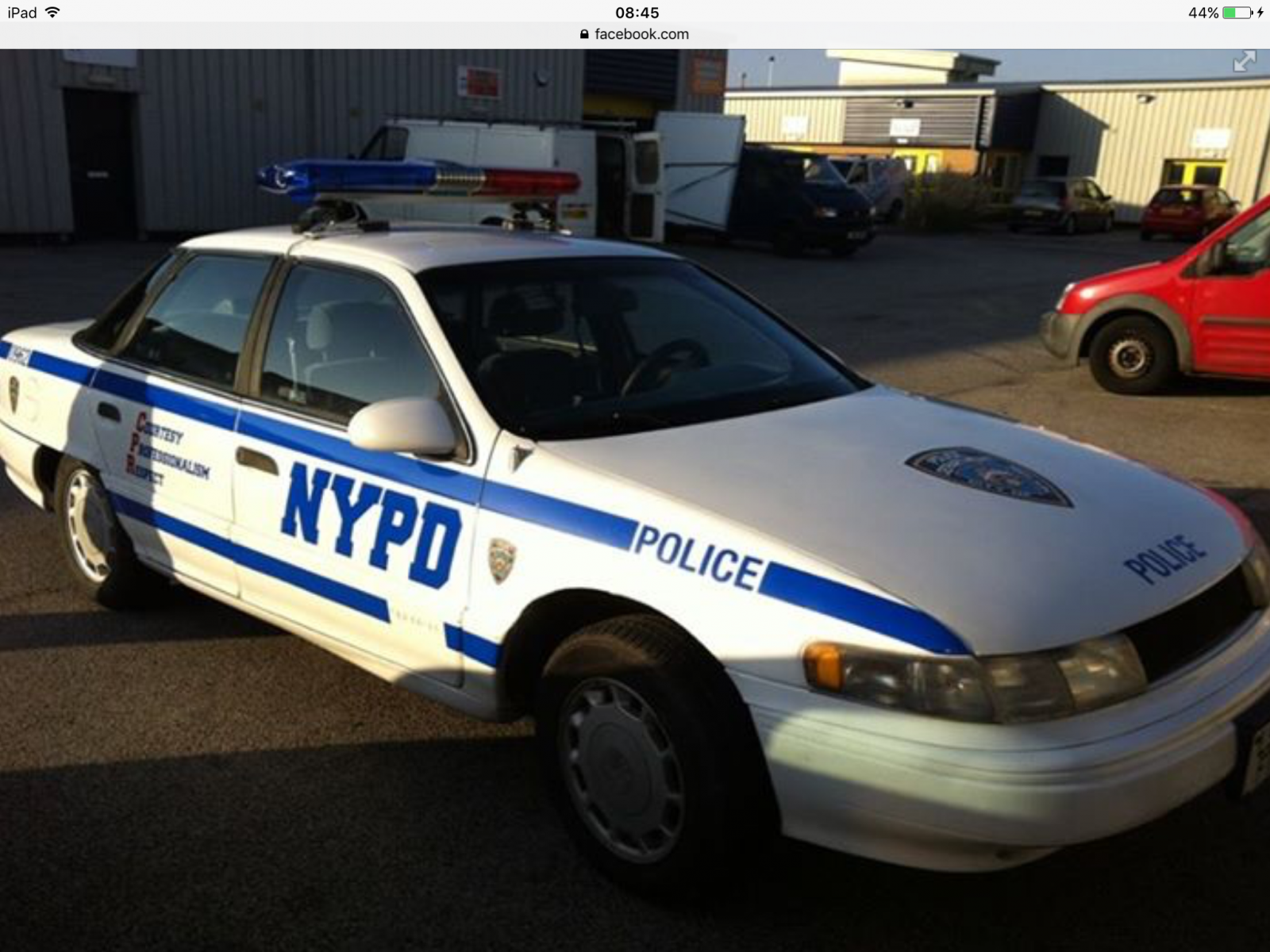

I used some rattle cans made up by a local paint supplier (Martin Brown in Blackpool) to paint the repaired areas on the Mercury. Took in a door mirror as a colour sample and they made up the paint to match. It matched very well TBH. Two 400 ml cans for £30. A good gloss without lacquer, although may flat it back and apply lacquer when the weather is warmer next year. Think the paint is acrylic. Apart from that, no idea! The whole bonnet, front and rear bumpers, drivers door and part of the lower half of the os wing was painted using it.

Actually, Im bloody impressed that he got a bonnet, door, two bumpers and half a wing on a large-ish barge done from just two cans.
I reckon then another 4-5 cans could do the entire car then, not bad for £100ish quid.
Actually a bit misleading in my post. It took four cans to do the above. I had to go back for more!
