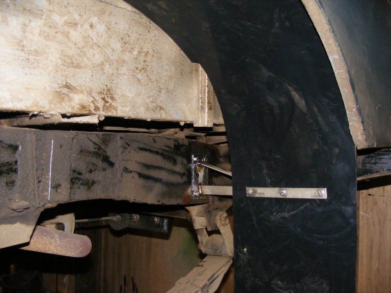

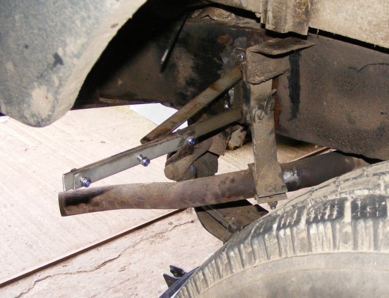

As Mr Panhard65 points out, some unfathomable 'features' on Landrovers. I finished my modifications late last night- they're not pretty but I've had in mind a lot of what has been mentioned here. First the 'hose out' isn't an option for me. In the winter my road is often deep in shit, and I'm not going to do it often enough to stop the salt festering away.
  The point about mudflaps trapping mud and adding to the problem has hopefully been addressed by taking them all round the wheel so theres nowhere for it to go.
First off I made brackets out of bits of stainless flat and bolted them to the chassis.
I had to cut the exhaust pipe and turn it through 180 degrees as its standard route takes it nice and close to the wheel to collect plenty of muck and rot off in a couple of years.
The flap is cut from a sheet of polypropylene which I shoved up into the wheel arch and bolted at the front to the chassis outrigger with more stainless bolts.

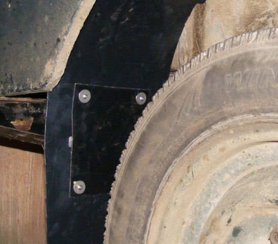

Here it is with the wheel on and an extra bit of material to reinforce the point which will get the most stick.
Same arrangement will be carried out at the front.
A bit of an ugly mess, but it manages to look better than the standard landrover flaps. You can see in the last pic the paint has gone from the rear crossmember- only replaced 5 years ago, but impossible to protect as its cupped shape is normally filled with everything the wheel flings at it.

That's the beauty of Landies,you can do this kind of stuff and it looks all the better for it.

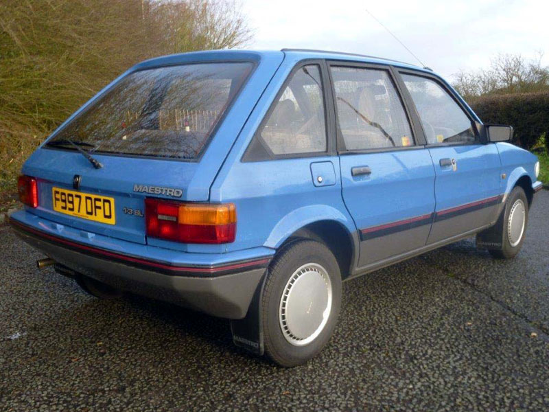

The Maestro originally had these kind.

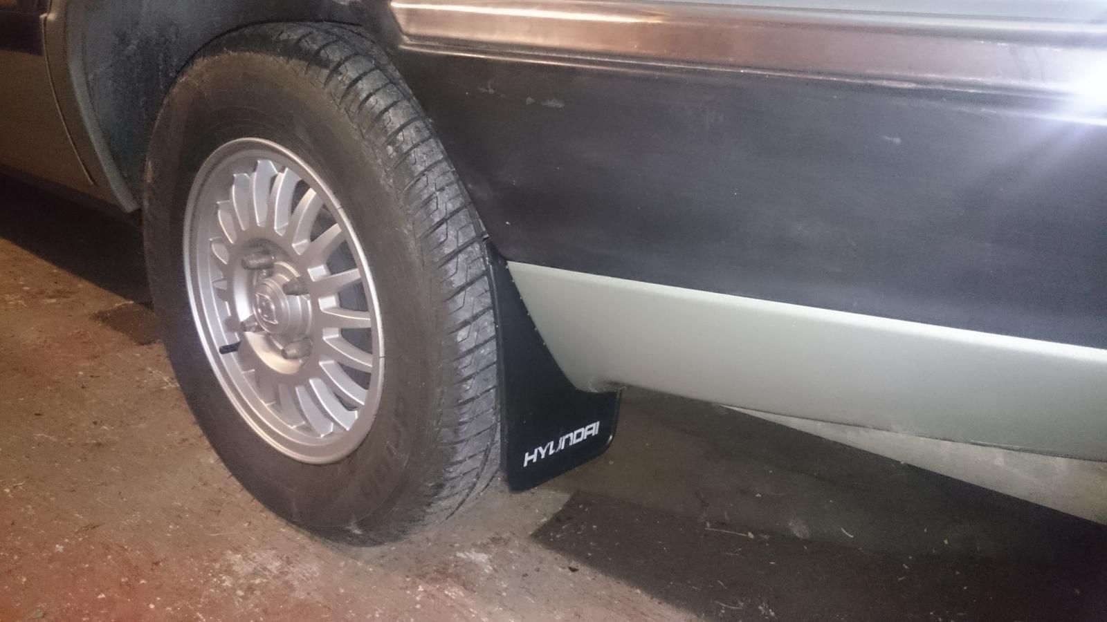

Although after 30 years the rubber was brittle and cracking, and the metal of the wheelarches had really suffered where they were bolted on. One of them actually fell off, complete with the remains of the wheelarch! After the restoration/respray, I ran it around for a bit without mudflaps before I found these in a local car accessory shop.
19994955416_b676fe598f_b.jpg1985 Austin Maestro 1.3 by Adam Floyd, on Flickr
Just had to knock up a couple of small brackets to get the rear ones sitting properly. I really like them!

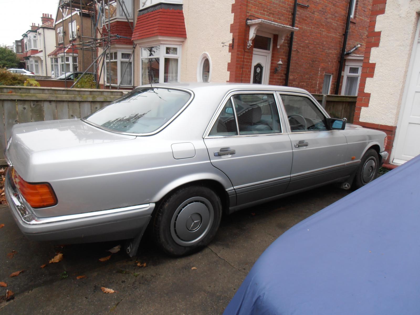

Most of my cars have had mudflaps, they do nothing to stop them getting dirty though! I just looked through various pics of my cars with mudflaps & toyed with posting them but in the end I CBA.
The Mercedes needed them as the road rash was terrible.

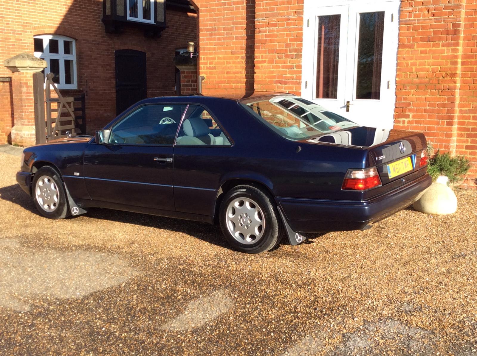

Which is the way to go with this? Recently bought with 3 MB flaps, do I replace the missing passenger side front or skip the other 3? I quite like them though to no one's surprise Merc mudflaps aren't cheap.
Yo Cros, admittedly your land rover flaps look like a proper job, nice work.
