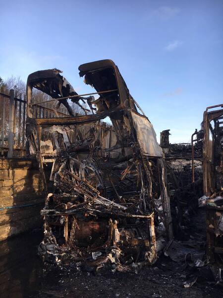

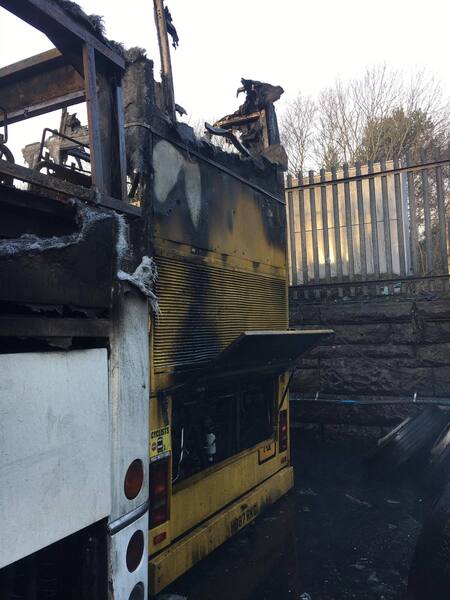

Then this (for those who don't already know) on the 29th of December
81207154_2442606019327494_8404457228186157056_n.thumb.jpg.d08ebff40b2945ac6cfc82a3f29542d2.jpg
81040639_515038439359864_5513110675020316672_n.thumb.jpg.3b2d56f46eec7e1a21819a447f3a151c.jpg
81668049_466878403998810_7396694477038944256_n.thumb.jpg.012a8ff316e6c4e532150234209c9f14.jpg
Arsonist bastards!
Insurance paid out a decent amount so that's something. More for the 205 fund.
This is the last I will talk of this matter.
