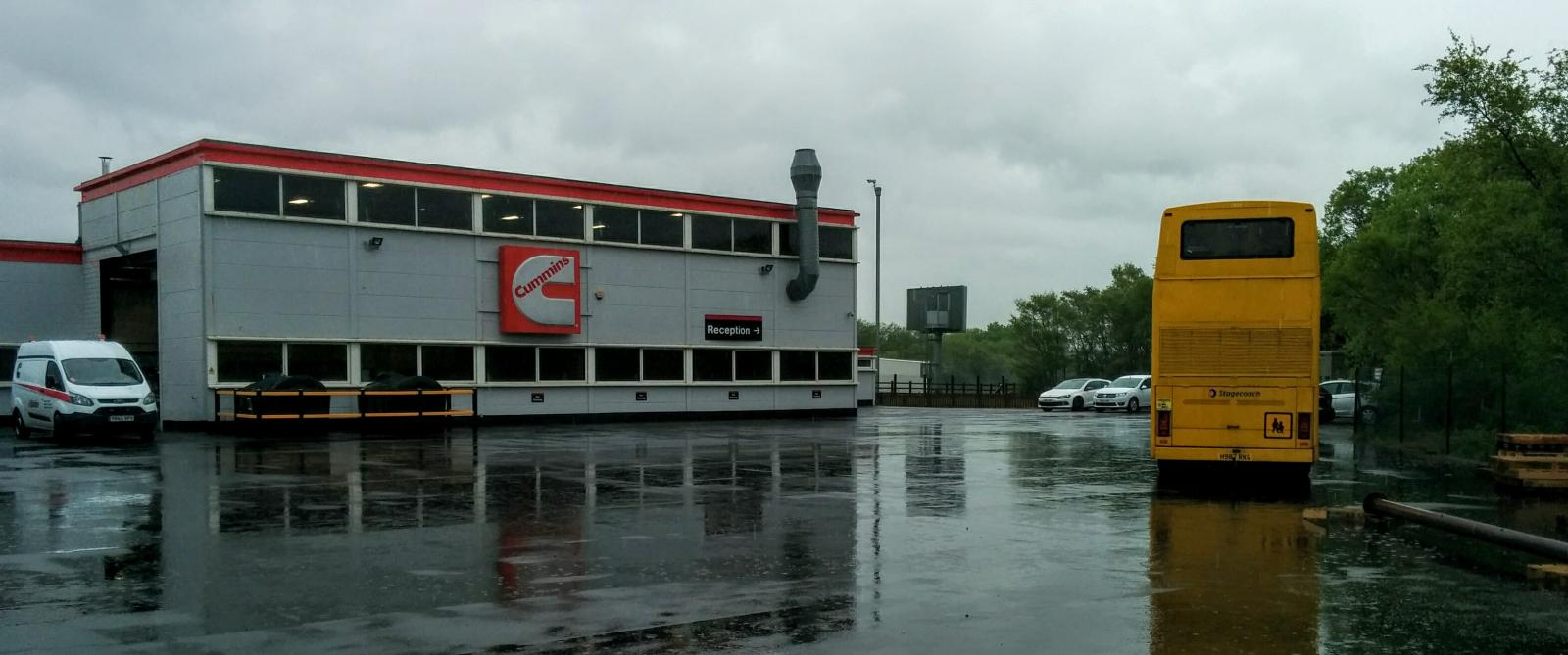

On that note I turned up at Cummins UK in Cumbernauld with an itchy bank card...
Anyone Home? by David Fowler, on Flickr
The engine fault was traced to a damaged fuel injector. Typical commercial engine set up on these injectors where the fuel pump supplies fuel at constant intermediate pressure to all injectors and the firing is actuated by a rocker arm pushing a plunger down in the injector like a syringe. Someone once likened it to a mechanical common rail system but when you look at the detail it's more like a mechnical version of the Volkswagen PD system.
I'm not sure about other manfacturers that use similar designs (Caterpillar spring to mind) but the Cummins PT system is pretty impressive when you consider the engine design is almost 30 years old (if not more) and that the injection pressures are approx 20,000psi. That's not a kick in the arse off the most modern common rail pressures.
Anyways the fault in the injector was that the plunger was seized in the down position and not springing back up. Naturally it wasn't doing any work. Thankfully someone had noticed this at some point and had completely backed off the rocker arm for the afflicted injector. This essentially disabled that cylinder mechanically and potentially saved the engine from much more significant damage to the pushrods and cam shaft. Good man whoever you are.
While they were in there they replaced the rocker cover gasket and also discovered that all of the tolerances needed to be reset.
So in conclusion...
My bank card is now £1200 lighter but the engine is now approximately 20% more powerful now that it's firing on all 6 rather than 5. Most of the cost was labour charge trying to get access to the top of the engine. Turned out the easiest way to get in to it was to de-rivet and remove the rear interior panelling and go in from the inside of the bus to the back of the engine.
Sadly, Stagecoach have at some point fitted a recon engine rated at 180bhp rather than the 245bhp engine that it should have so it's still not exactly what you call fast up to speed but it will still pull up a reasonably level motorway gradient at 65mph. The biggest improvement of course is the power delivery which is now balanced rather than being pushed along the road by a pneumatic drill.

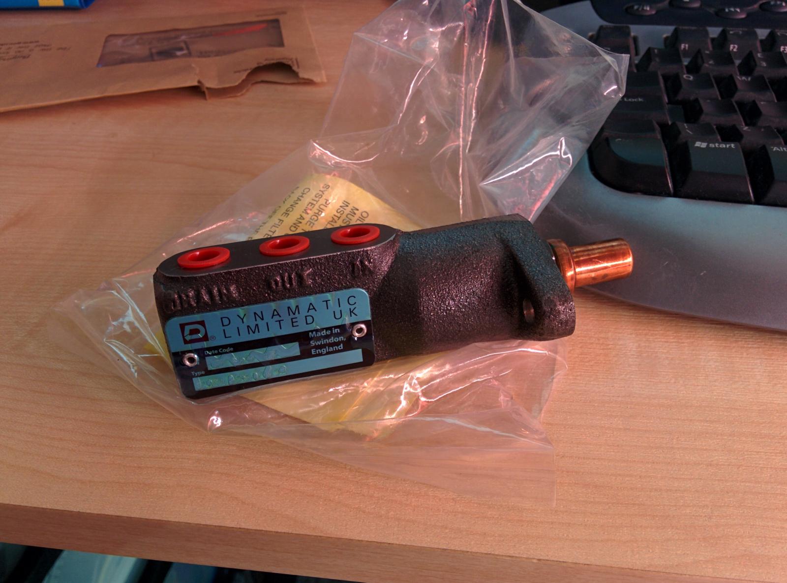

Ahh. More new bits.
Let's have a game of Guess the Part. What does it do?
More importantly let's do a guess the price as well...
Mr FPB7 and Mr cms206 need not apply.
Ahh. More new bits.
I'm guessing something to do with the brake system & it cost £250.
