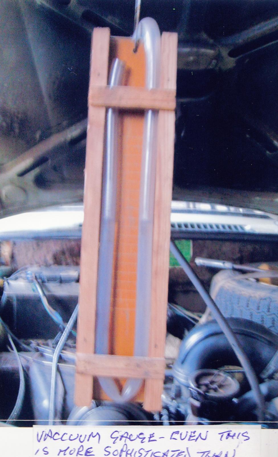

What's the oil breather like? Have you tested crankcase pressure with a manometer ( length of clear hose on a board?)
Don't be daft. Of course I haven't. Wouldn't know where to start. I did pinch the breather from Elly's original engine, which was about 50,000 miles old. It lost lots of oil be for that, but barely any on the Goodwood trip. I think I opt to reassemble as is, give it a bloody good clean and then monitor.

Phil
Photo and text from Keith Would.
water or lhm test gauge. get the engine ticking over, remove dipstick and push pipe into the tube and watch what happens between the two levels.
a new valve should give 20cm difference, citroen specified a min of 6cm. more than 10 is ok.
refit dipstick, remove vent pipe and place hand over  outlet.  if you can feel a powerful in and out rush of air or similar to the effect of opening the filler cap then the valve has failed and an in-line replacement may work. if on the other hand the flow of air is very weak then the valve is blocked and only a replacement will do.

I may even give the manometer a go, but I've got to get the engine back together before trying that anyway. Thanks Richard.

As RichardMorris mentions, the crankcase breather is probably past it. Use old 2cv plastic fuel line with a bit of the rubber line to join it to the dipstick tube, it takes 5 or 10 mins max. Add a drop of antifreeze to make it easier to see the level. Test at a variety of revs, make sure you don't suck water in once the breather is working right!
