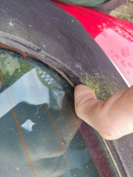

I bought the goop for this ages ago and finally got round to applying it today.
The back window has definitely seen some action before and was leaking through the bottom corner where the previous reglue had come unglued.
I had to make a call between pulling all the old sealant off and making a localised repair. I went for option A as I was hoping to make it look a bit tidier and less saggy.
The hood material is pretty ropey in places.
Expertly masked:
And still mostly made a bollocks of it.
It's better and hopefully watertight but still a bit saggy. It's just not possible to pull the material as taut as it would have been from the factory.
I've also got some hood cleaning and re-sealing juice in the Goods In pile so I'll give it a go over with that. If it can last this winter then I'll probably see about putting a better hood on, hoods don't seem to be mega expensive 2nd hand, probably because it's such a rampaging arseache to fit them.
