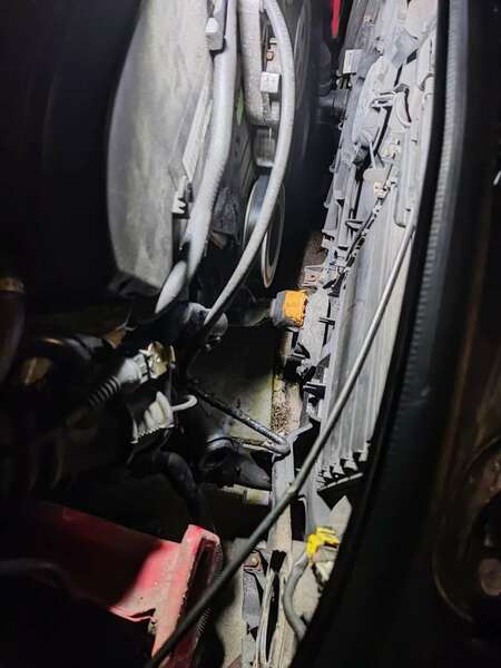

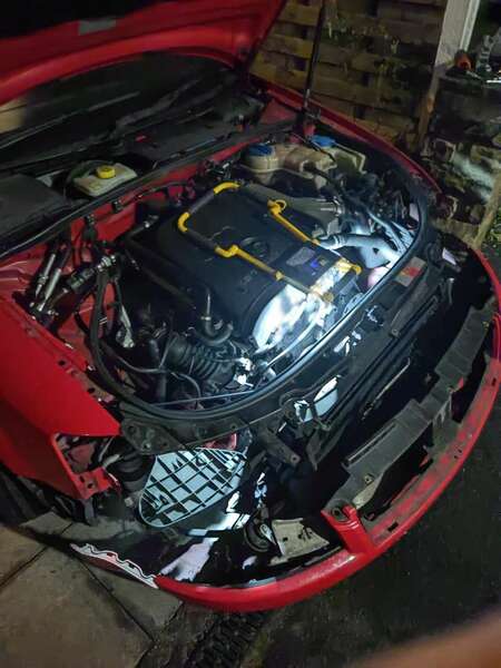

Spent my big Friday night assuming the service position to replace the BPV:
Already did the temp sensor which is easily accessible in the bottom hose.
Not been able to test drive it as hilariously managed to break a stub off a coolant hose by leaning on the front clip while it was detached.
TBF I think they advise sliding it out on studs or long bolts rather than just chucking it on the floor.
You can get a new hose for £25 or so but nowhere that will deliver anytime soon. Considering some sort of bodge with a bit of brake pipe or something or may go visit a scrapyard tomorrow AM.

Surprised the DV is down there especially given the size of the engine bay. The TT is up top and a five minute job max.

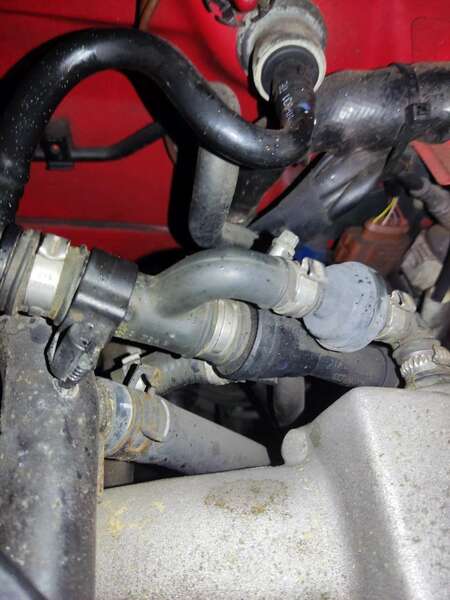

The DV is in the turbo outlet hose which comes out down and into the front panel to go across to the other side where the intercooler is.

I think in hindsight if you put it on axle stands and went in from underneath then you could get to it without all this, probably took about 15-20min to disassemble and less to put it back together, will get better with practice.

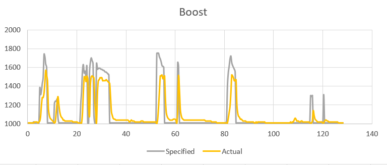

Been out for a drive and nothings changed, the pull up the hill was the same and I also logged actual vs requested for some general driving around:
This maybe gives a better picture of what is happening, actual is consistently less than requested.
I guess maybe the N75 is the next thing to look at? Or whether the wastegate is stuck partly open?
I did also get a new fault code of P0299 - Boost pressure regulation control range not reached.

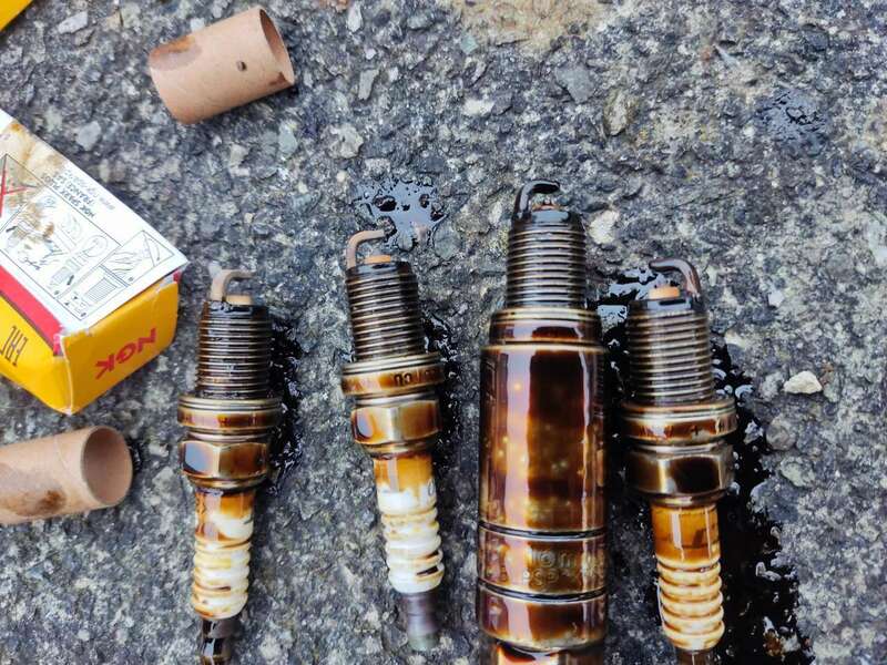

Also changed the plugs, the old ones were definitely old. Also, getting a mild vibe that I might need to change the rocker cover gasket. As well as all this oil on the plugs there is a smell of it when you stop as it's leaking down onto the manifold...

Then I guess a test with the N249 bypassed? Do I need to get some sort of connector to join the vac lines or just disconnect at the diverter valve end and plug it with a bolt etc?
What does the N249 do? Is it the valve that opens the DV? So with it bypassed I should get no boost leakage through my DV and sick turbo flutter bro?
Yeah N249 regulates the air into the DV. It'll work fine connected together bypassing the valve.
It also performs two other tasks. One it allows part throttle/cruising to bypass the turbo and increase efficiency when off boost. Secondly and more importantly, if the N75 has failed in a stuck condition, it prevents the turbo over boosting and over speeding. So if you're unsure on your N75 just go easy until you've watch the live boost levels. Sounds like it's boosting too low anyway.

Think I have some progress, I have fitted the new G62 and run the DV straight from the manifold:
This is a pull up my test hill from earlier. Originally requested boost peaked at 1500mbar at about 1500rpm, the actual was well behind and peaked at 1400mbar at 2000rpm, dropping down to about 1250 by 6500rpm.
Now we are requesting about 1750 and getting it (although a bit late) and maintaining 1600 through the midrange and at about 1350 at 6500rpm.
I do wonder if there is still some issue with the WG, N75 or hoses in that area due to the actual boost lagging a bit then slightly overshooting? Or is that just how the control system works?

Control system might be regulating boost with the N249 valve to prevent it overboosting which it can't as bypassed? Could log and graph N249 control value to see if that's the case for sure.
At least it's meeting it's requested boost value now.

Not sure on whether the N249 could make much difference as it can only bypass boost that is there? I would have thought the primary control is the WG via N75. Will log it though and see if it is trying to do anything.
I'm not sure I'd trust a cheap Chinese turbo to last. A used ko3s can't be that expensive from a TT180 though. Or go Ko4 but I think new injectors are needed then. Also I don't know what strength rods/pins these lower boost engines have. I know there is a point that is reached reasonably quickly where those bits need to be upgraded.
I'm thinking the N249 could be preventing the overboost peak at the start. Wastegate fully closed trying to get as much air through as possible. Turbo starts spinning and boosting. Revs keeps climbing from inertia, engine isn't consuming all the air provided and as it starts to overshoot/overboost, DV is opened to reduce a peak. DV react quicker than WG control by the fact pressure is instantly bypassed rather than waiting for the mass of a turbo to slow down. That's my theory anyway.
The period at the start where it's far under, is it not just the fact its turbo lag and it's still spinning up? 1000mbar start suggests it's not boosting and the compressor is probably stationary.

Driving to work this morning and got a rough idle, thought it might be because I had just unplugged the N249 and N112 (PCV valve I think) so swapped back to the original routing.
The good news is that the boost still seems OK so I guess the N249 is ok and it was the temp sensor all along.
The bad news is this little conical bastard seems to have become unstuck and was the cause of the rough running.
I've pushed it back together but think it probably needs some epoxy etc.
