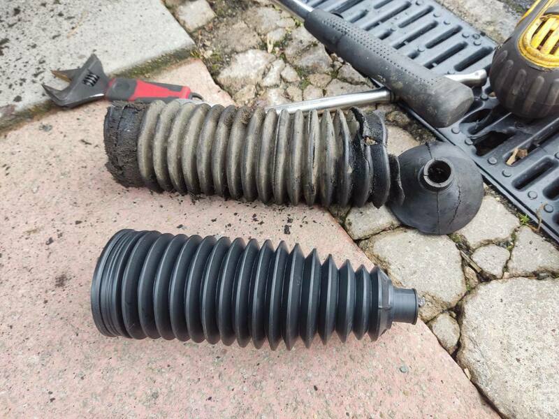

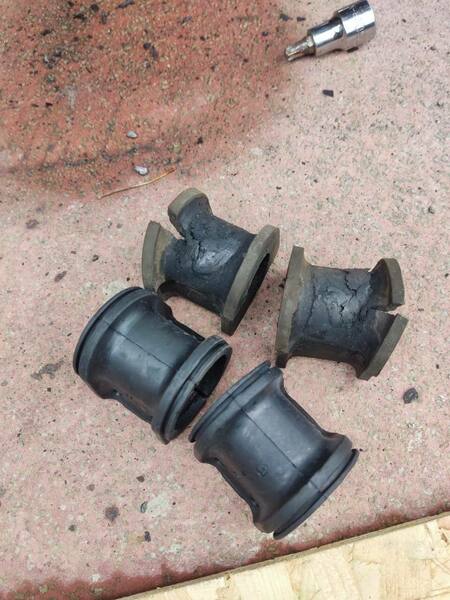

Dave_Q Posted August 17, 2022 Author Posted August 17, 2022 Better day today. ARB bushes: Gaiter: Changed gearbox oil: Old diff oil: New Vs old diff. The mounts looked like they would like up right but I swapped them over anyway, the new diff was off a 64 plate 130hp van. About 20% lower ratio. The 64 mount on the rear of the diff had different rubber bits, mostly hole rather than mostly rubber. Dunno if this is in the name of NVH or saving money. The front mount was a slightly different shape so that was swapped as well. Also had to pop out for a driveshaft boot as one was fooked. It's all back together and been for a test drive, I also fixed the sliding door with a new bottom runner. The diff is just about right, it's now sat at 2400rpm at 70 instead of 3000 which is pretty loud. Hopefully this will save my ears and maybe even help mpg a bit. Annoyingly there is still a knock from the front end going over bumps, I cannot find anything wrong other than the bushes I changed so it'll have to wait for the MOT man to tell me. Other than maybe fitting the front seats if I can summon the energy tonight, we're about ready to go. 320touring, Back_For_More, Stanky and 8 others 11

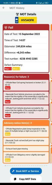

Dave_Q Posted September 15, 2022 Author Posted September 15, 2022 This really could have been much worse. I knew about the sills and I knew about the spring, just checking it didn't fail on lots more before getting it welded up. CreepingJesus, Dyslexic Viking and mk2_craig 3
