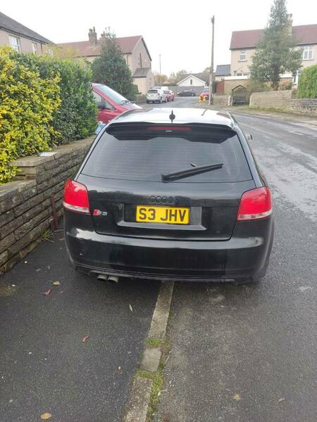

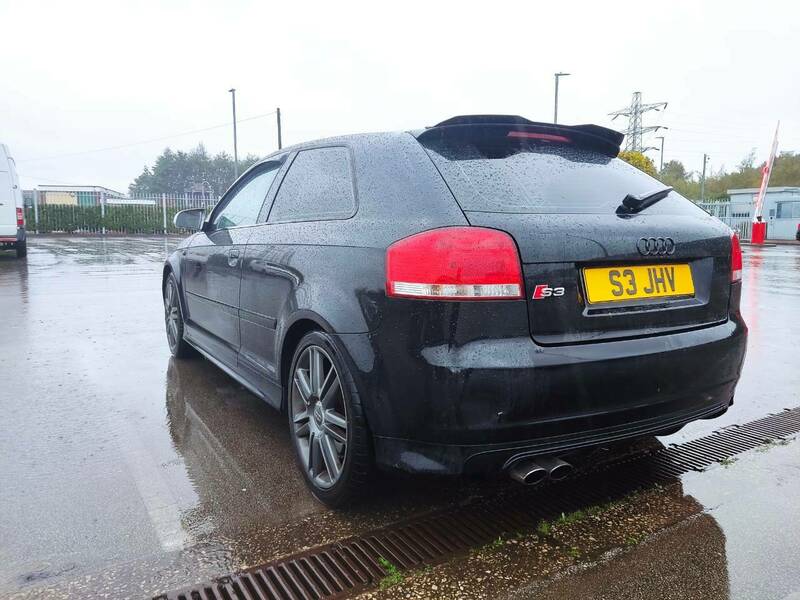

So yeah. over on @DaveDorsons thread I was alerted to the fact that these mk5 platform cars are getting towards the bottom of the depreciation curve.
I did start out looking for Golf GTIs but coming from a Quattro A4 I was concerned about traction. @SiC seemed to concur about the GR12ness of quattro.
I test drove this car and also a Golf with a stage 1 map. The Golf was a bit sheddy so perhaps not the fairest comparison but it could not get the power down even in 3rd on a rainy day in Rochdale.
I did want a 5 door really but sportback S3s were well outside my price range.
This was more than the 2-2.5k that most mk5 GTIs seem to be advertised for, but much, much more car.
This particular one came with a fat pile of receipts including a clutch and DMF this year, and a cambelt + chain last year.
I am told it's not been mapped (will check tho) and the only mods are a Ramair induction kit and a res delete. I have the original mid section to go back on if needed and I've scrounged an airbox of my mate who took it off his TT. Although, the airbox is meant to be mega restrictive on these so if it makes a noticeable difference the Ramair can stay.
Positives, as well as the service history its on recent Michelin PS5 all round, and has not been written off.
Negatives, a couple of bits of damage on the drivers wing and rear bumper, the ride is kinda crashy over bumps and it's very difficult not to drive it everywhere like a total helmet.

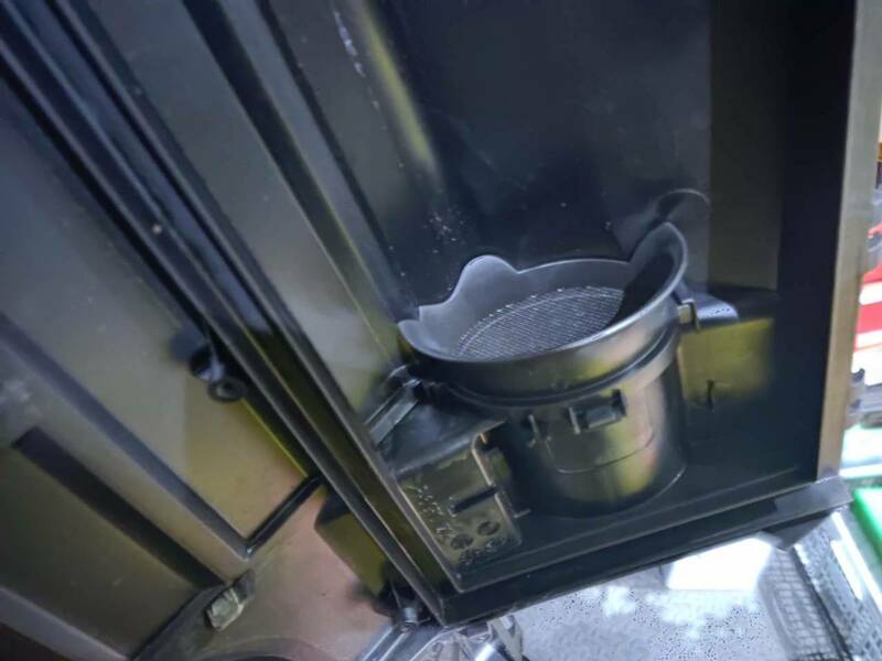

My mate said his had a Pipercross panel filter so I opened them up to swap it over, turns out both did so I used the cleanest looking one.
Had a bit of a mooch around the airbox, I'm happy this can't really be adding a restriction vs the cone filter. The AFM and pipe into the turbo has an oval cross section but without measuring I'm saying it's the same cross-section.
It also has a nifty little heatshield built in.
On taking out the ramair setup it looks like the filter house is far too close to the fan, if not touching already.
