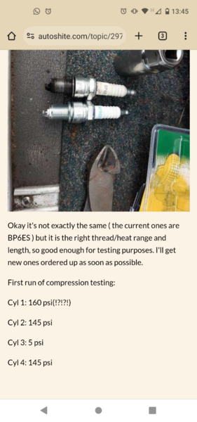

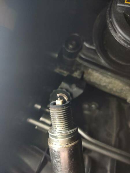

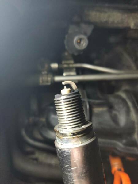

I checked the plugs a bit more closely, they all look good TBH and not fake. All a similar sort of colour and not oily or fuely which must be a good sign.
Another suggestion from the S3 group was the coil pack wiring loom, I opened it up and couldn't see anything amiss.
I started trying to compression test but it was a bit inconclusive as the battery wasn't turning it over fast enough.
On a first pass I got 135psi on cyl 1 and 150-160 on the others but then another try on 1 got me 145.
I've put the battery on charge to have another go tomorrow. Lightening started happening which stopped me doing anything else tonight.

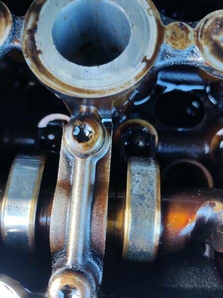

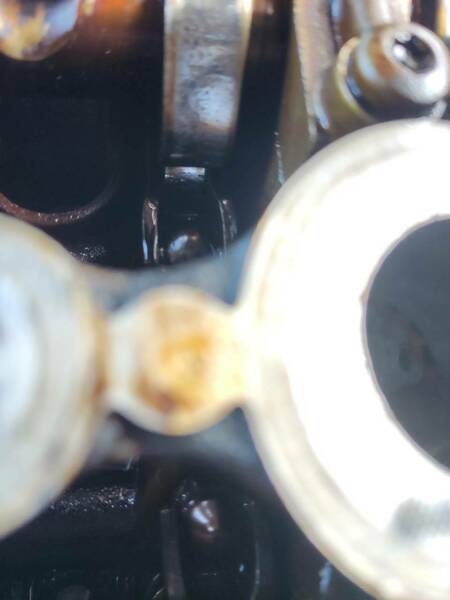

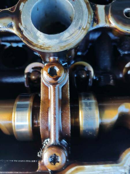

I also had a look at the cams and it's not great.
Hard to picture but the inlet cam is definitely pitted, I can't really feel it with my finger but maybe it's enough to affect compression? Again you can barely make it out but it does look like the rollers on 1 and maybe 2 are also pitted in places, maybe when the damage lines up right the valves don't open quite as fully on that cylinder? The compression test for cylinder 1 goes up to 140 psi but then down again which is bad, if all is well it should keep getting higher with subsequent cycles?
I don't think I can leave this having seen it, I'll start shopping for an inlet cam and a set of rockers. I am just slightly concerned that even after that I could still have issues?
Any thoughts welcome.

I guess that the damage to the cam could work both ways, if there are raised bits as a result of the pitting on the "closed" side of the lobe it could stop it sealing fully? As well as not opening fully which would also restrict compression due to getting less air in?
No idea really but I do know that the cam isn't right and it's only going to get worse from here with time so seems sensible to change it even if I'm not 100% convinced it will fully resolve the issue.
That amount of pitting isn't going to make much difference to anything.
A cam which is very badly worn on the nose will reduce the valve lift and retard the timing, but these will be minor effects and will not affect the compression very much.  Yes the cam is on the way out, but not at that stage.
If oil in the bores has made no difference, then it's a valve or head gasket problem.
Exhaust valves are more likely to be burnt than inlets.
