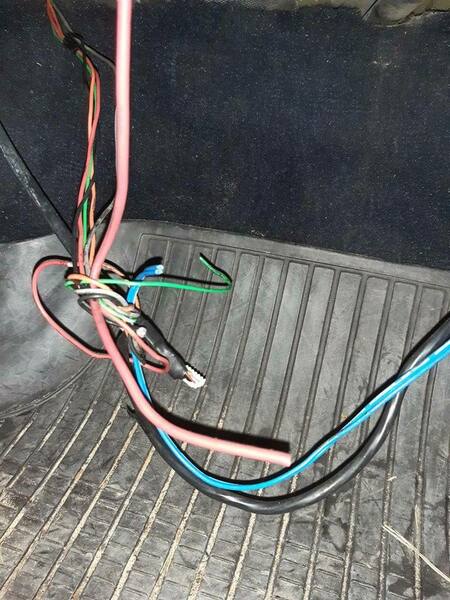

More bullshit wiring chaos. No wonder the cunt is senile.

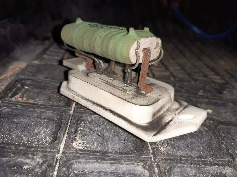

Heater resistor looking somewhat patinated...

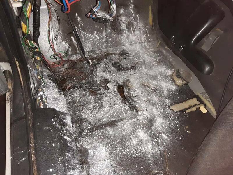

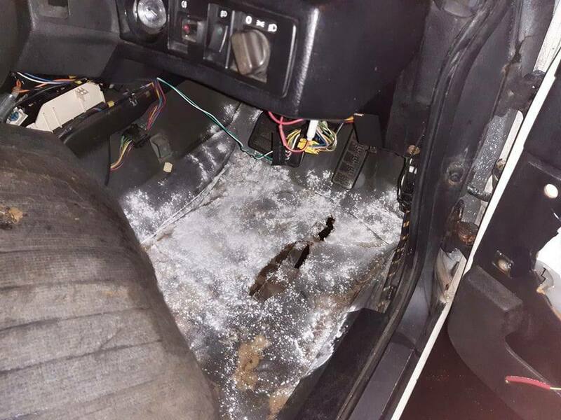

I also noticed the floor mat was soaked.
256556275_994599424422974_2198281296047920302_n.thumb.jpg.0885e99b058c12ef946621fbe7eb8a4c.jpg
The carpet was equally as sodden, so I pulled that back to reveal sodden soundproofing foam and a few more redundant wires.
257341374_285174830027754_2913004630497841356_n.thumb.jpg.75cb67a9bf6d7364678199f46104adb6.jpg
Buried down another layer to find this fucking disaster
257920742_373496701130763_1627896941827281638_n.thumb.jpg.ad237cbca3de72a08fe86e0103c9dc32.jpg
256725688_1273044883162572_4301502480394466691_n.thumb.jpg.4ee561cca9a16249d5f478de06c14b07.jpg
Disposed of.
The floor on that side is all fucked, same as the driver's side. The only thing stopping me poking holes in it is the factory underseal that is like concrete. I did poke a cheeky hole into the chassis leg which sounds fairly solid from prodding with a screwdriver.

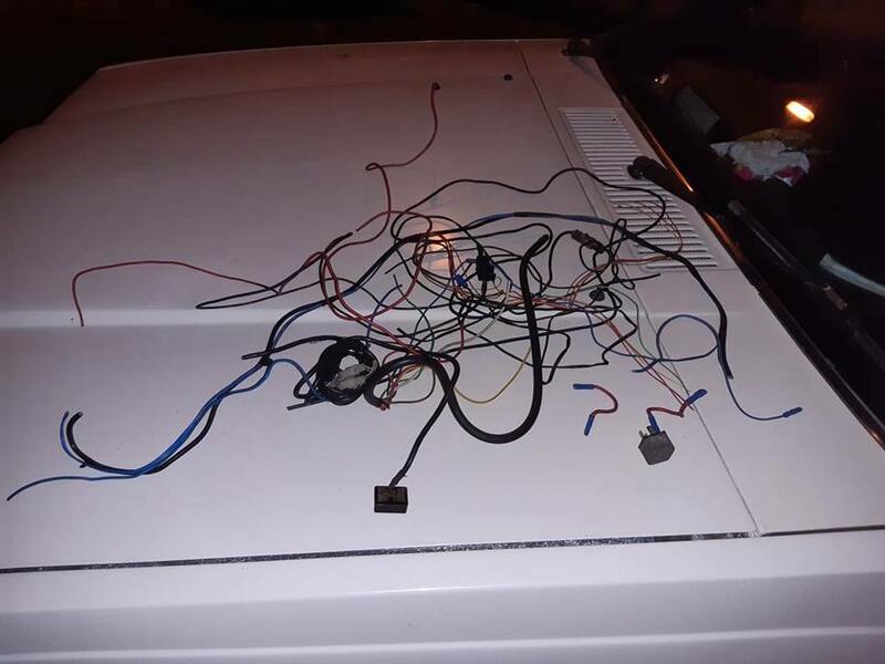

Most of my time was actually spent de-wiring, there was loads of stuff hacked into the fuse box which I had to pull out. There is still some shit away up behind the dash binnacle, presumably rigged into the ignition barrel, I haven't bothered to dig that far up yet. There is wiring running along the middle of the car beside the transmission tunnel and more running down the inside of the passenger side sill - Getting at that involves removing the seats, very much a job for another day...
256270884_230007445898423_4900695957028175686_n.thumb.jpg.aefcc2f1464aa168af334c83852dc607.jpg
I suspect what I've removed is largely alarm/immobiliser related. Yes, I have checked the car still starts... No, none of the fucked electrical systems have started working.

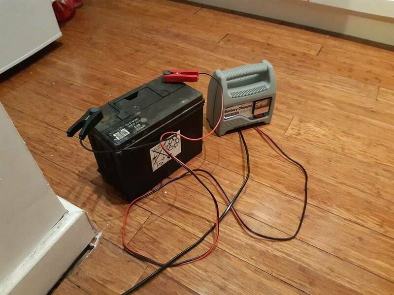

Acclaim's battery is on charge to maintain it's usability. My charger is very much dumb so will charge even a completely flat battery.
256552994_1051195825721771_2287946479965588283_n.thumb.jpg.401982140808af23fe05119a166de78e.jpg
The best kind.  "intelligent" chargers that have to "see" a battery before they put out any power are a pain when you're trying to charge a battery from completely dead.
So called smart chargers are a pain, one thing I have done is to connect a battery with jump leads to a running vehicle and give it 5 minutes from the alternator

Electrical faults are likely shit earths. It needs a good going over really, a lot of stuff is still clogged with dust from grinding and sanding paint because of the rush to get it MOT'd.
