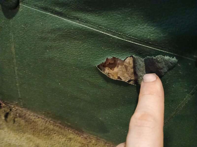

44 minutes ago, vulgalour said:
For that tear, if you can get access to the back of the fabric and even better pressed flat, you can bridge it with a scrap of light woven fabric and contact adhesive and while not seamless as a repair it will at least stabilise the damage.
This was pretty much my plan. All the door cards need remaking from scratch, the originals are warped and crumbling. Hopefully I can remove the original material by drilling out the old pins and bind it back together as it goes onto new boards. I have no intention of taking the car back to "as new" condition, it is beyond my abilities, budget and skillset. Repaired tears etc are fine by me, given I'm not painting it or re-choming all the ruined chrome I think a re-trimmed interior would just look weird and out of place.
The carpet and mats are/were wool and are entirely destroyed. Coverdale actually do a set for the E Series and sell matching stuff by the metre for doing doorcards. It'll be a while before I properly commit to that mind you... I'd not exactly feel awful about going for a cheaper synthetic carpet.

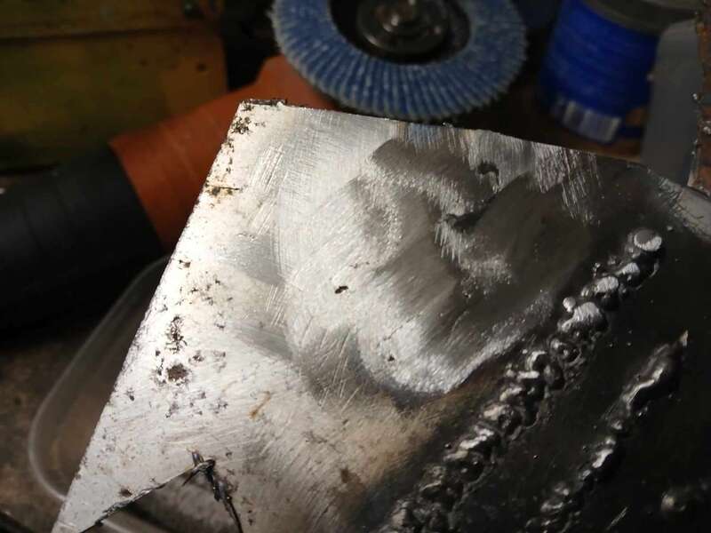

So, cut some slots in a bit of scrap 1.2mm steel I use for testing welding settings. Probably fairly close to what most pre 1980s cars are made of.
MIG on the right, gasless on the left. I actually blew a few holes at the start of the gasless run, wound back the voltage and went back over it.
The reverse side.
Ground flush.
Actually very different experiences to weld with. The gasless runs a bit hotter and doesn't sound how I'm used to, which is my main basis for how I got about fine tuning settings. It also leaves a load of white slag which needs to be wire brushed away. It looks fairly awful, I tried fucking about with settings for ages but the welds always looked pretty ugly. I dare say if I had @juular on hand to show me the ropes I could get a nicer weld out of it, but jumping from gas to gasless deffo takes a bit of getting used to.
I think it'd be harder to learn on gasless, mostly as even a strong weld always looks a bit shit. Although I think once you had a technique down you could do a significantly better job than me...
The gasless welds seemed to sit pretty flat, so were quicker to grind to a smooth finish. Penetration was decent but not pretty.
Overall I wouldn't swap gas for gasless, even if the gas bottle is an extra hassle/cost. The caveat being that I'm working indoors in a garage. If working outside the gasless would really come into it's own and I think would be well up to the task, even on a car's thin metal.
I am pretty sure if I was to replace my welder it'd be for an inverter one though, it's just so much lighter and easier to move around!

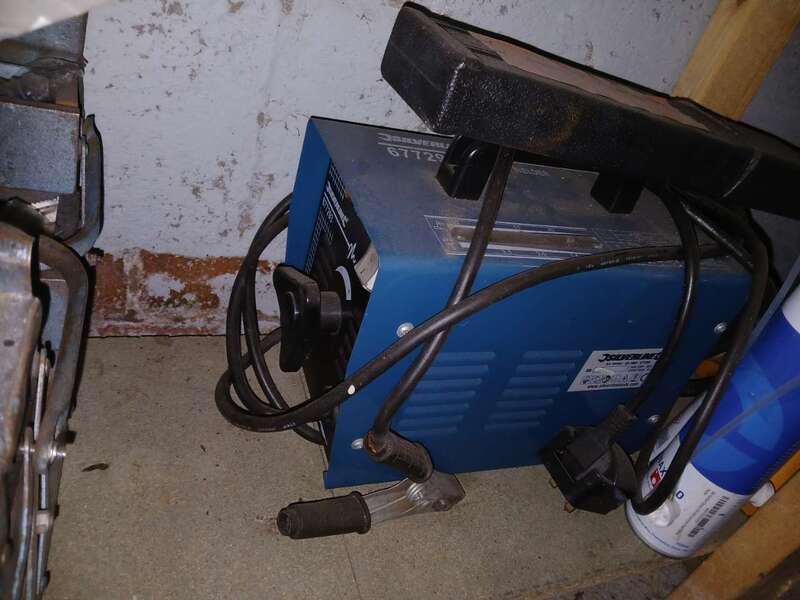

Haha, funnily enough…
Ive just been given one of those stick/arc welders, exactly the same as yours by the next door neighbour. Her other half had it for doing rough thick metal work but it’s sat unused for years. They split up and he passed away not long after so she’s been clearing out.
It’s absolutely covered in dust, the handle is melted and the earth is chewed to buggery but I got it working the other day. I did some arc welding years back on gates etc but not touched it since getting a mig set. I’d forgotten how much of a pain getting the rods started was! Doesn’t help that they’re all old and rusty of course.
No idea what I’ll do with it tbh, as it’s not really much good for cars but free is free!
Rusty rods belong in the bin; get some new yins if you're going to give it a proper go. I find Oerlikon Fincords are easiest to start but I've had good use out of Murex as well. If you've got a welding supplies outlet locally they will have decent stuff, if you ask they may give you a selection so you can pick which rod suits you best.
The ones I’ve got to test it with were ones I just found in the box with the welder. They’ve all been sat in an old shed for god knows how long. Some of them were literally just sticks of rust so I binned those straight away.
The better rusty ones did work but aren’t ideal to actually use. No idea why the handle grip has melted either, but it seems ok so far. Although all I’ve done so far is put it together, cleaned up a few bits and struck it briefly on a sheet of old steel. No idea if it’ll be any good in proper use though.
TBH buzz boxes are a bit miserable compared to even cheap inverter sets, they'll weld together gates, trailers etc but the duty cycle will be a bit rubbish and the arc stability not great.
My apprenticeship was all stick welding, so it's always my first choice now... no use for car bodywork though.  Did the last couple of exhausts with it as I had stainless rods in, but no stainless wire for the mig.  The wee 2.5mm rods worked well, although I find stainless a smoother weld anyway.
My cheapie stick welder went a lot better after it first cut out for overheating.  Once cooled, it was a different machine... easier to start and a smoother weld.  No idea why, and I can't guarantee it would work!
