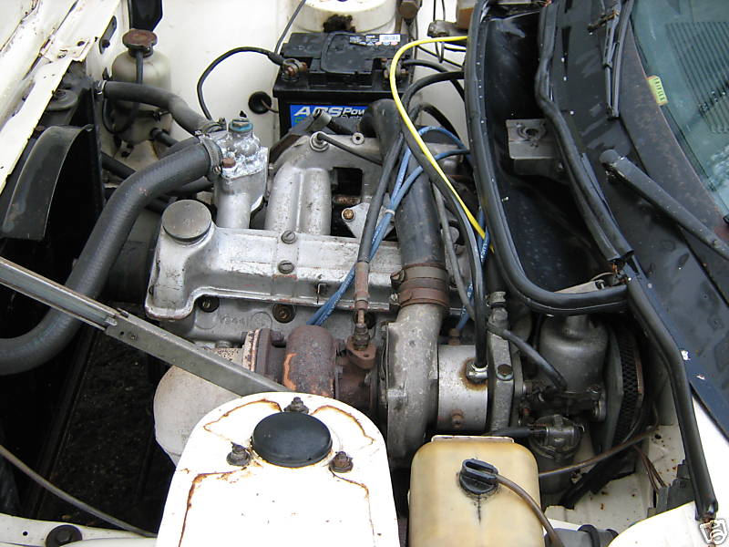

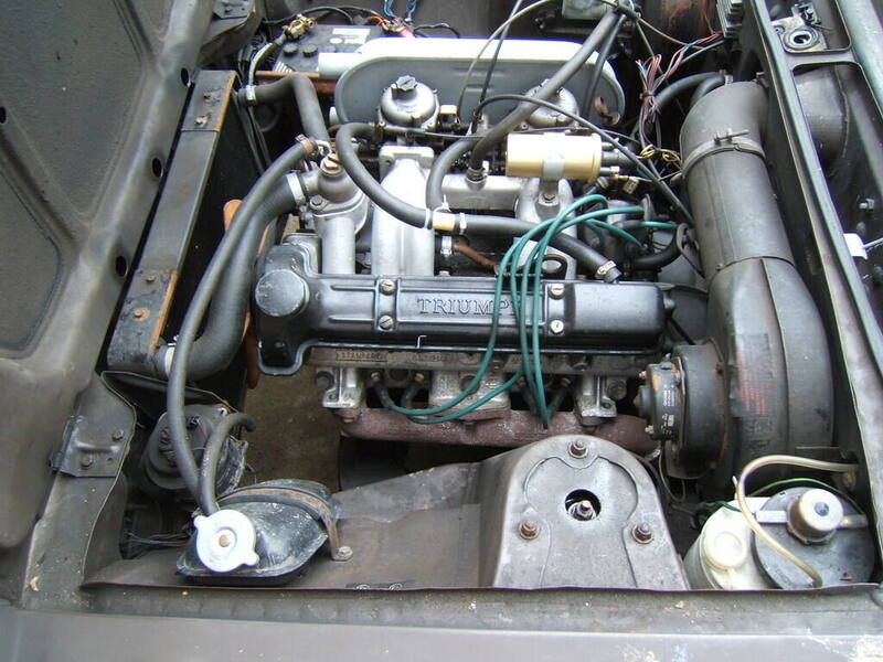

Something in  my dim distant memory tells me that Saab also used the Triumph FWD gearbox as the basis for the 99 but I wasn't sure if I dreamt this so I've just done a bit of googling.
Saab:

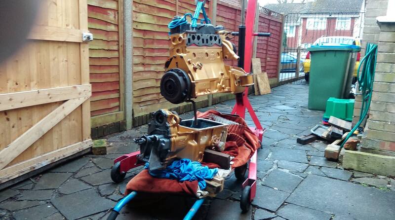

Triumph :
That's mine, best pic I can find at the mo.
The diff cover at the front is very similar, though a mirror image.

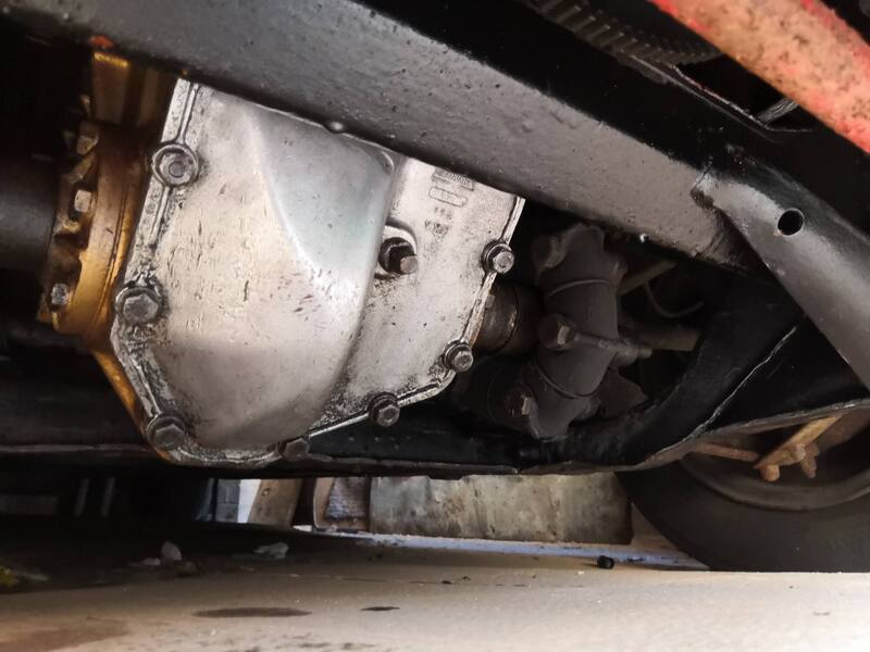

Saab:
Triumph:
I have literally just gone and taken this as I couldn't find a pic online. The subframe is in the way but there's no mistaking the similarity.
It's not actually the same in any way but the family resemblance is obvious. The Saab box looks ally where mine is stupidly heavy cast iron. The Saab uses a chain to link the input shaft to the gearbox below where the Triumph uses a line of gears but the overall concept is the same. Seeing as the Triumph gearbox could barely handle the 61hp of a standard 1300 (though that was mostly down to the input shaft and was rectified on the 1500) Saab must have done quite a lot but looking at that it looks like it would drop straight in my car with a nice Saab turbo lump on top. Hmm... just thinking out loud.

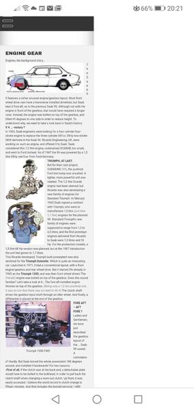

You're right. I found this Saab based article. They claim Saab turned the gearbox round to make changing the clutch easier as to leave it as it was would require having a removable plate in the front bulkhead. Which the Triumph has, of course, and my clutch is very simple to remove.
Screenshot_20200718_202159_com.android.chrome.thumb.jpg.ffa35f8084475c55dee7ef55dafc58f1.jpg
This even has a picture of the Triumph lump. But another thing I notice is, looking from above, the Saab engine leans to the right.
Screenshot_20200718_202218_com.android.chrome.thumb.jpg.22a8765202703cc79ea9bc16ac7b5cd2.jpg
While the Triumph leans to the left.
So I could just swivel the whole lot round 180° and we'd be back to square one. I realise it wouldn't be that simple and don't worry I'm not going to try it.
Another thing I notice from the above diagram is that where Saab have turned the box round the the engine sits forward of the front axle whereas the Triumph has the the engine almost entirely behind the wheels. That has to be better right? We could almost say it's mid engined. Alright, I'm dreaming now but I know my car handles really well, not just for a 1960s car, but by any standards.

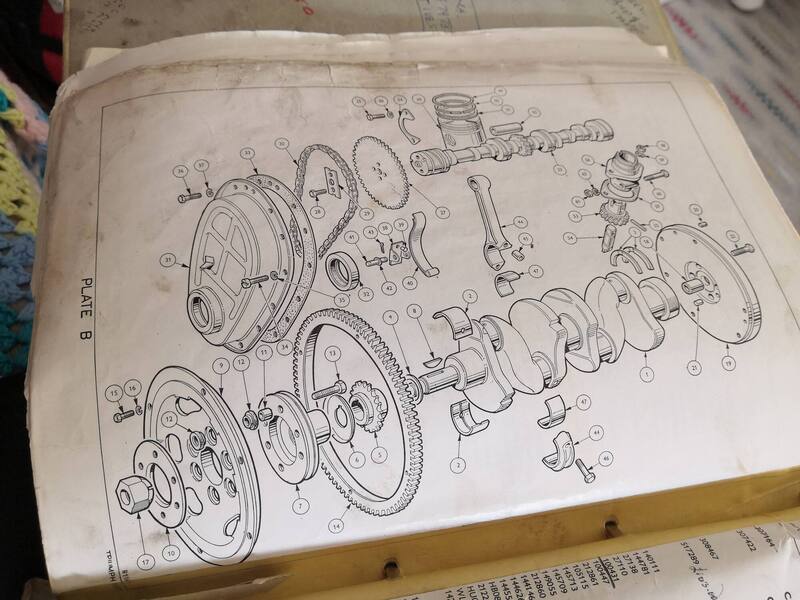

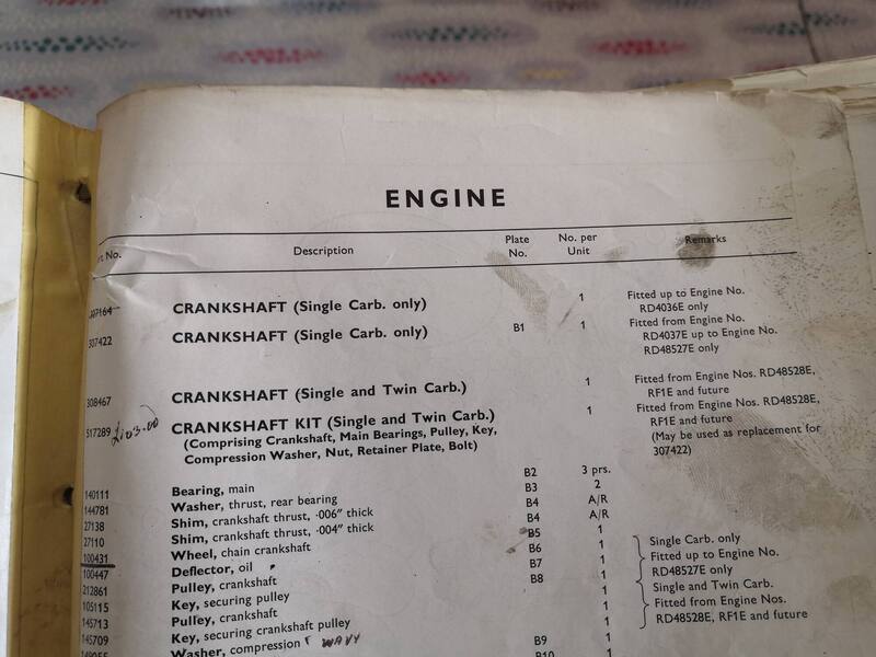

  On 30/07/2019 at 13:44, Yoss said:
Fitting an 1850 might be easier than trying to fit a 1300 FWD. The FWD crank is different. The front end is tapered (unless it is a really, really, really early one), to take the front flywheel/starter ring.
Expand
  Quote
Expand
  Quote
Expand
  Quote
Expand
  Quote
Expand
More info on this bundle of fuckery once I've eaten, I'm fucking starving...
