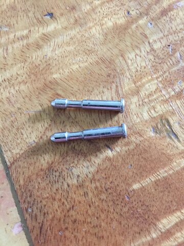

were you looking for a pair of these earlier this year to attach wipers to one of your fleet? Found them in the garage in a box of bits left by previous residents.
yours if you want them

Cheers for the offer but I've filed out the holes on the wipers to fit metric bolts, an un-reversible move!
May be of use to somebody though as they seem impossible to acquire easily.

No worries sir, I'll put them in the Freebies fred. Plenty of Rootes/BL/French chod that used them I'm sure.

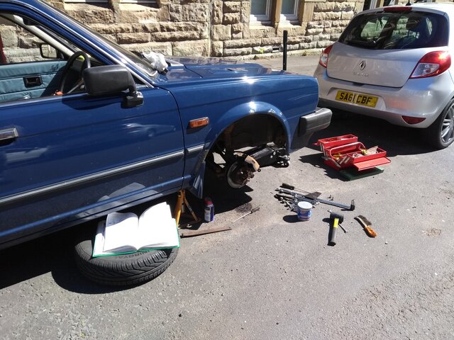

Started fettling the Acclaim in preparation for it's MOT. Fucked it.

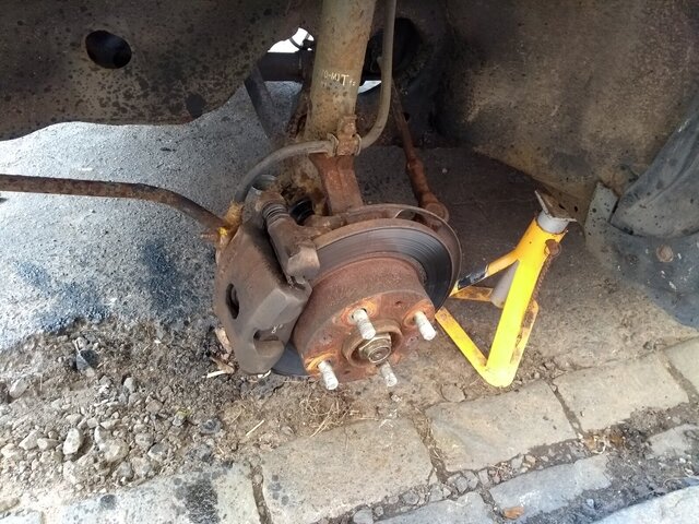

Essentially the front right brake kept squeaking and I wanted to know why. A glance showed the pads looked alright so I whipped the wheel off and set about taking the caliper off.

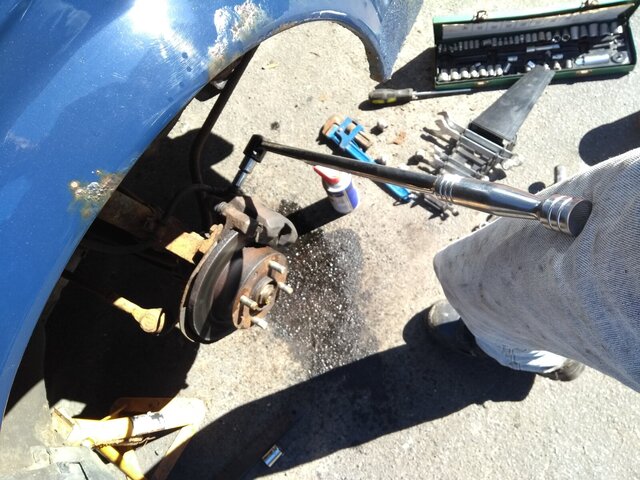

Firstly, it's amazing how much nicer they came apart than the Civic's and the slider pins were in perfect nick, but I ran in to some issues. Firstly the piston wouldn't return, secondly the bleed nipple was battered to hell and wouldn't budge.
Many tactics were implemented to try and get it to move including, but not limited to:
Using the breaker bar for maximum leverage.
Using a variety of metric and imperial spanners.
Hammering a smaller socket over it
Cutting some new edges into it with a hacksaw.
Clamping it with mole grips.
Swearing.
Due to this I had to loosen the flexi pipe to push the piston back and bleed the system. The result being the brakes are now utterly shit due to the system being full of air.
The other side all came apart fine. naturally...

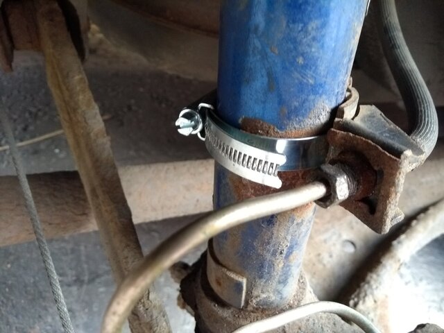

I then finally replaced the tie-wrap rear brake line bracket with a jubilee clip and re-jigged the variety of jubilee clips which hold the exhaust on which has reduced the rattling slightly. I also fitted new wiper blades and bashed most of the remains of the headlight splash panels off with a hammer as the rusty jagged edges looked dire.
Tomorrow I'm going to pop to B&Q after work and buy a blow torch as a final attempt at getting the fucking bleed nipple to move. One day I'll follow my own advice and stop buying Scottish cars...

Heat is your friend with the bleed nipple. I'm amazed it didn't shear off with the breaker bar! Trouble is that the heat could well melt the piston seal if you're not very careful. Normally this work would be carried out as part of a rebuild with new piston, seal etc.
When I was dailying a variety of fucked Reliants and working out in the open such as yourself,the blowtorch was my go to tool,after I got one I didn't know how I managed,they really do make undoing siezed nipples,nuts and bolts easier,and often the difference between snapped or fixed.blowtorch,mole grips,get some plus gas as well,wd40 is shite did this sort of thing.
If you can stretch to it MAP gas is the way forward for portable blowtorches. They are more expensive though.
The last one's I freed off responded to heat then spraying penetrant straight on to it, then leaving it for a few hours/overnight and repeating the process.
Also pushing a drill bit into the bleed nipple can prevent it from collapsing in on itself.
I don't think it's going anywhere... I suspect it has been cross threaded.
Time to buy a new caliper I think. Thus the act of checking the brake pads has cost £120...
May as  well try and drill it out now. I've never had to but always wondered if it is actually doable without ruining the caliper.
Don't have a drill good enough to drill it. Can't afford a drill good enough to drill it. I don't fucking know anymore...

I'd probably have stuck a drill bit into that bleed nipple and crushed a pair of mole grips as hard as I could on it. Then took all my anger out by whacking the mole grips with a mallet.
I did attempt that (with a screwdriver rather than a drill bit, but the nipple just twisted off. It really is stuck in there... I've never encountered a fixing so entirely stuck before. The only thing it won't do is shear...

Would be better to take the caliper off and pop the piston and seal out then properly heat it and quench it a couple of times......tap the nipple on the end plenty and then be surprised how easily it comes out with small stillsons.
or it'll break off
Good luck with the bleeding tomorrow Capitan, keep us posted!
Do not try to drill out the nipple, this always ends badly. Best solution (in the short term) is to get it bled via the banjo bolt. You may need to take the caliper off to make the banjo fitting the highest point of the caliper but it should work out ok. I'm happy to help with Mapp gas or welding a nut onto the remains of the nipple to get it out but it's not 100% guaranteed so the best way to keep you on the road and give you time to track down parts is bleeding through the banjo . Best of luck and give me a shout if I can be of any help.

Welding a nut on to the thing may well be a solution... I'm loath to scrap an otherwise fine caliper for the sake of one bastarding bleed nut but I'll have to buy one as a spare "just in case" regardless. Highly irritating. We'll see how the bleed goes tonight and work out a plan from there.

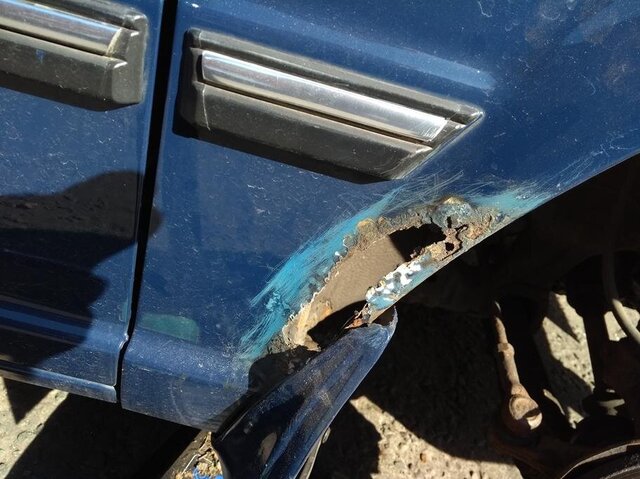

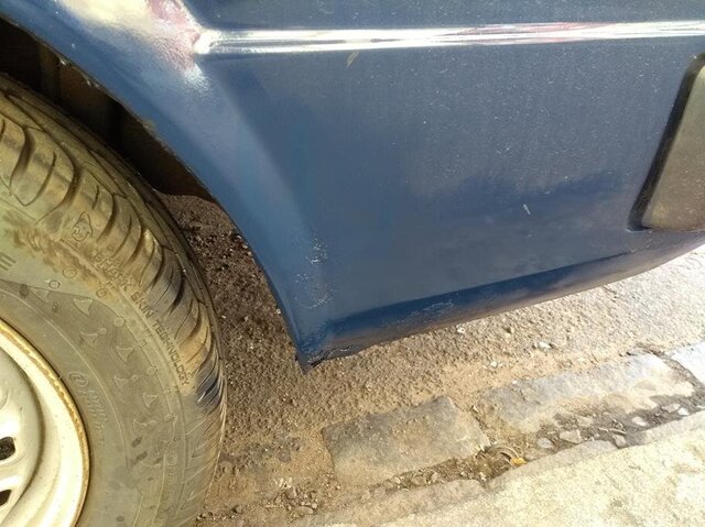

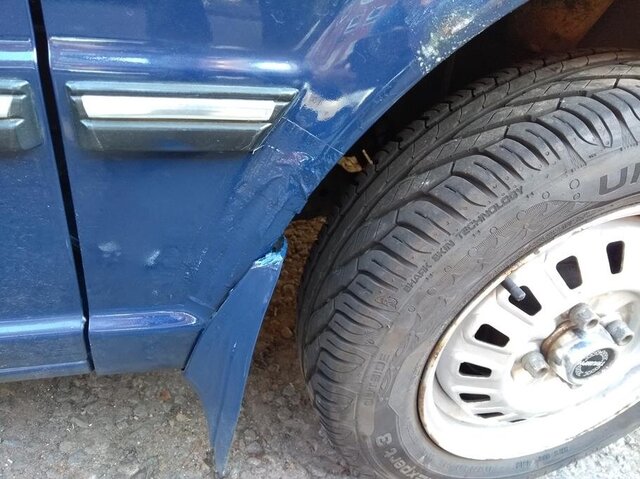

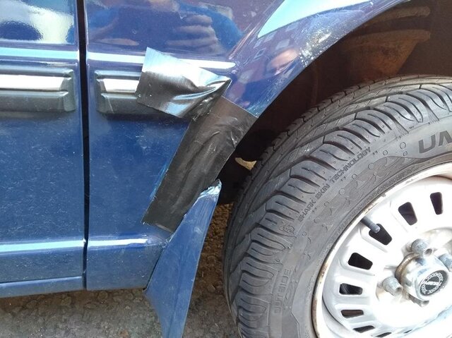

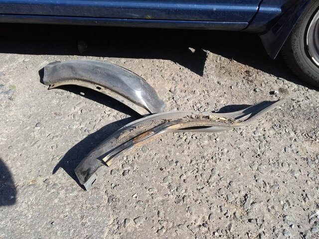

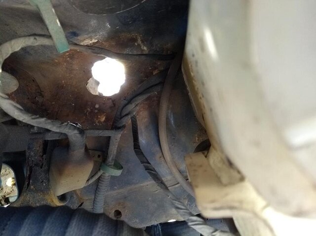

I also took the front splash guards off the investigate some wheel arch rust and check for nasties. Structure is good, O/S/F wing is scrap. Largely as expected.
1664451454_IMG_20190514_155858119(Copy).thumb.jpg.f3726e6bac08bc0d11bb3a52c8570855.jpg
1042420979_IMG_20190514_162723474(Copy).thumb.jpg.7ab0093803458f697c4f2410f226f5c8.jpg
1230269041_IMG_20190514_162718977(Copy).thumb.jpg.ea8265ce220a10f82e6805377287b0cd.jpg
Found a hole down near the headlights and have cunningly covered it up with an oily rag from above and the splash guards hide it from above. So logically it no longer exists.
2075268690_IMG_20190514_155907913(Copy).thumb.jpg.435312f139a3d1a896a7a600f474a056.jpg

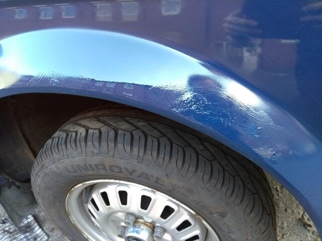

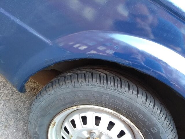

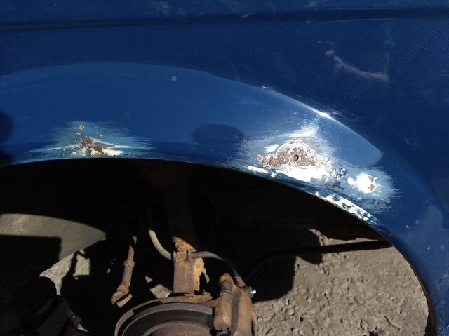

I then instigated some high quality repairs to the front arch and generally waved a rattle can at the worst of the rust blebs
1367707310_IMG_20190514_171148662(Copy).thumb.jpg.9052d211e230aa117e7790fafe788f11.jpg
398718629_IMG_20190514_171351507(Copy).thumb.jpg.cd6546100f4da4829c79af269694c6d2.jpg
649431384_IMG_20190514_173344346(Copy).thumb.jpg.b10a23ef01402932584e71aa1991750d.jpg
1903307421_IMG_20190514_173353266(Copy).thumb.jpg.f3f1a75b8ca6b6986f28521e3e5fe63e.jpg
547718701_IMG_20190514_173404367(Copy).thumb.jpg.bae3dd744cc18dc85fef64adc978f8fd.jpg
230097560_IMG_20190514_173407929(Copy).thumb.jpg.56295a60defbb233efa2c1b4535f3a49.jpg
