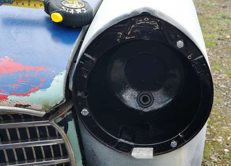

For the past few days I have been working on building up new headlights for the Peugeot 404.
Original style replacement LHD lights are available but cost over £400. They look very similar to 7 inch sealed beam units so I bought a halogen conversion kit at a fraction of the price. I wanted to keep the 404 special shaped chrome trim rings so needed the original base plate/bowl and invertabley the lamp unit fixings are different. I had to cut off the adjusting plastic base ring from the new bowl kit and screw it to the original headlight bowl. One of the new adjusters fouled the original bowl fixing so I had to move it by putting in a rivnut in another position in the wing.
I still have the other side to build up and the car came with a different style baseplate/bowl so will be similar but not identical. Then there is the wiring sort out if anybody facies do that for me FoD weekend.

I am doing something similar with the Dyane.
The standard headlights are adequate* at best, so I've bought some 3D-printed conversion rings from a bloke in the 2CV club and some Hella H4 lights to go in them.

Are they not the period standard 7000, 7002 or 7004 units?
I am not familiar with those numbers?
7002 was a 7" RHD sealed beam unit without pilot (side) light. Memory says there were 7000 & 7004 as well, can't find evidence but 7014 does have a window, I think, for sidelight.
They are both 7 inch round headlights,  Peugeot 404s uses different housing for SEV Marchal, Ducellier or Cibie so I have adapted mine so the adjustment/fixing is now using part of the H4 conversion kit. The H4 conversion kit does not directly fit the 404 housings.

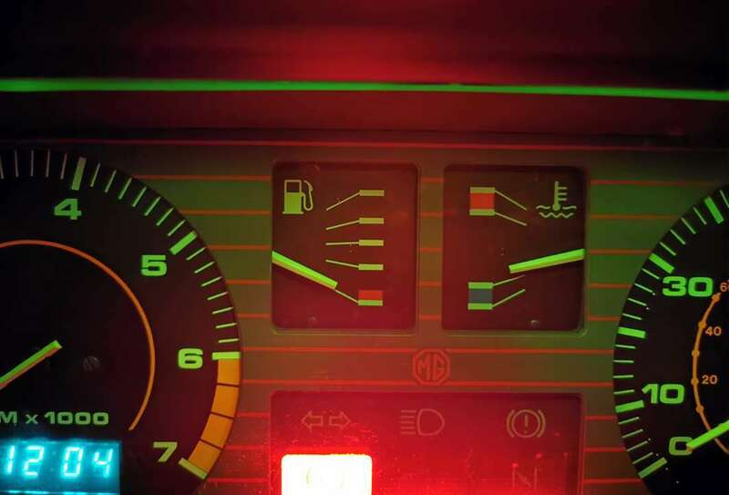

Going home I knew it was low on fuel so should I go to the first Shell petrol station on my route, go slightly further to Tesco for cheapness or go home and deal with it tomorrow. I did not make it to the first petrol station and ended up on a country road layby with poor phone reception. @Prince_of_darkness91 was at the show with me so I messaged him and nothing so walking away from the car to get reception I called Mrs6C. Prince of Darkness then messaged me and taught me how to drop him a pin so came to keep me company as Mrs6C was on route with petrol.
In my defence the fuel gauge needle drops quite a bit further at rest and I thought that would be at the point it ran out!
